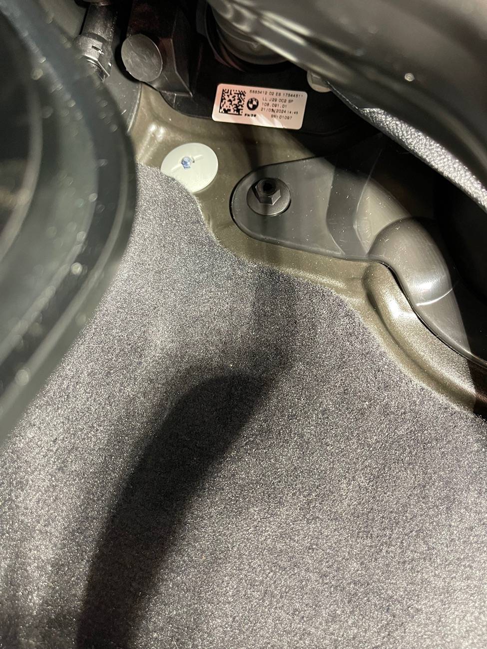

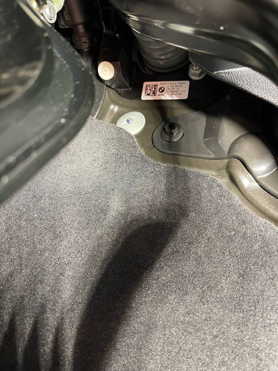

If you don't plan to DIY it, you might want to find a shop that will agree to do it before you order it. It's a PITA job and not all might be willing to jump into it. Not sure if it'll even show up for them to look up a book time on for a quote, might have to be an agreement ahead of time that it will be by the hour or something and they'll just do their best.

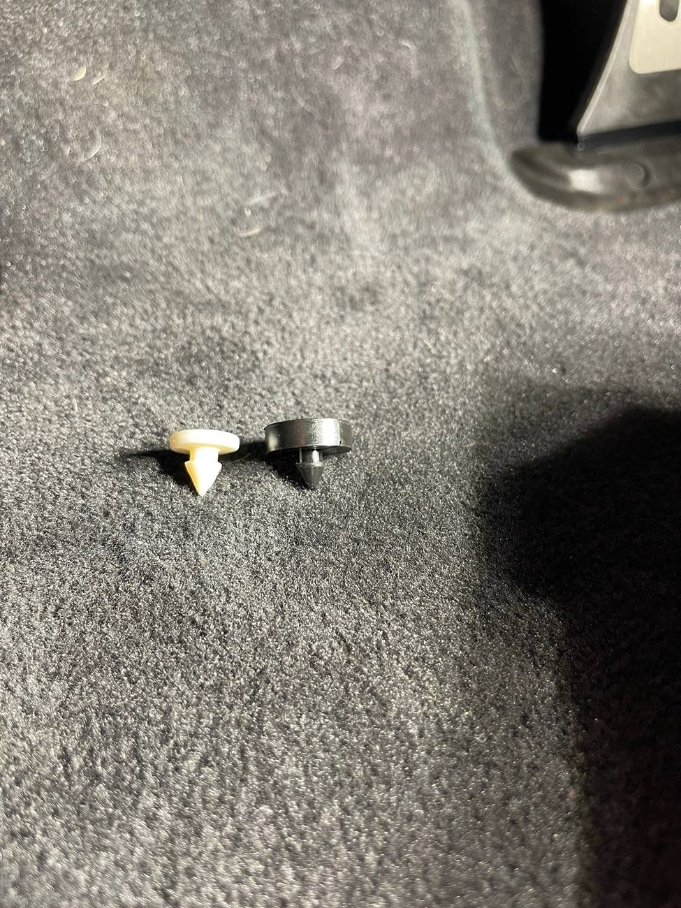

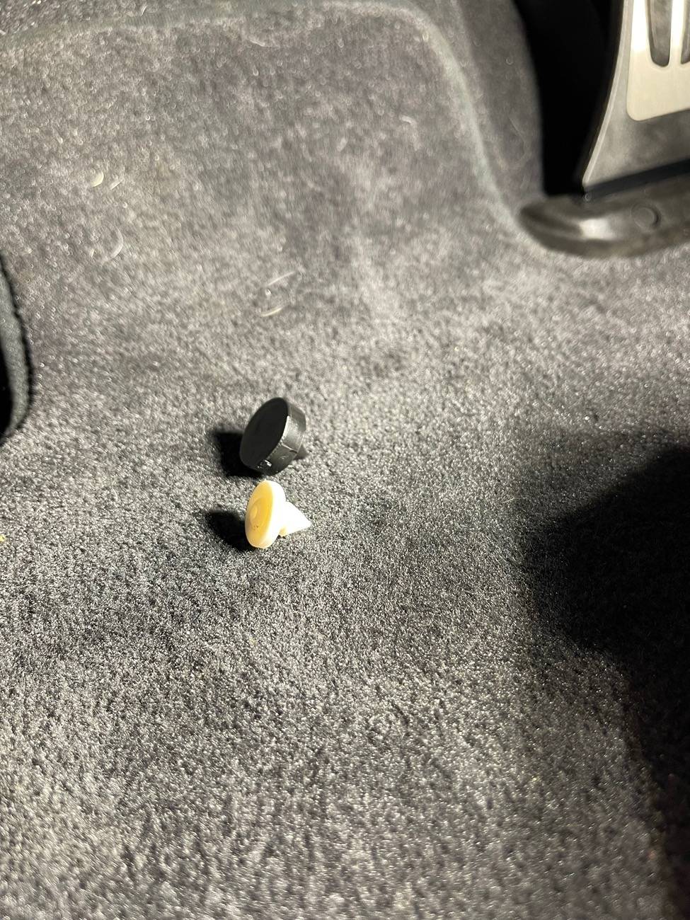

Also, the plastic pieces holding it together currently, 4 of the 5 pins total currently being plastic, means some of them may break on their way out. They have an interesting twist-lock kind of thing that once it's in place is reluctant to come out. By design of course to keep them put, but also meaning they'll fight a bit. Once you get started on the job you're somewhat forced to complete it. It's totally do-able, so it's OK, but FYI.
A note on that, part way into the job we could tell that the newer components tightened things up. Anecdotal / perception of course, not measured with calipers. But after it was put back together, it was less wiggly overall (side to side motion and other slop) than when we got started. There are enough other changes that it becomes part of the overall package, and I didn't have any complaints prior to the job about slop, and so I won't sit at a keyboard today and say it feels tighter. But as far as doing the work and being under the dash, and manipulating everything, things did seem to really tighten up. But not too tightly, nothing is binding at all, we checked for that.
Other random notes, for whomever - The kit mentioned using included lube, I didn't see any included but we had caliper grease on hand and put that in the bushings. And the airbag, probably should have disconnected the battery, but didn't. Maybe got lucky, not sure. Kept the car off the whole time so it wouldn't go check for it. Be sure step 1 is to push the seat all the way back and down, and lift the steering wheel all the way up, to maximize room. Have a few paper or shop towels handy when you get to the big compression spring, it's greasy AF and it'll be hard to hold anything else or keep your car reasonably clean afterwards.
