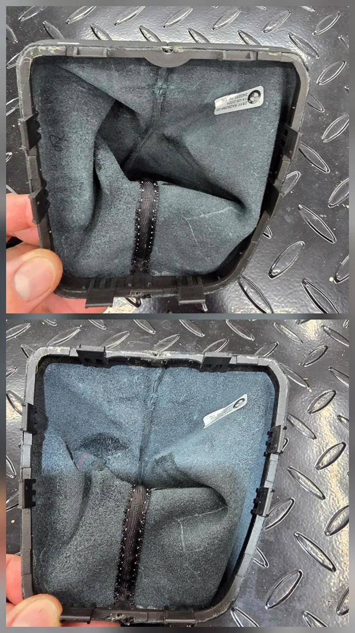

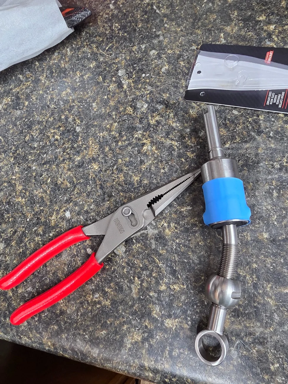

Couple of nitpicks about the short shifter. The most recent model I received looks a little bit different from the original pictures I've seen. The color of the wrap is blue instead of grey (no functional difference) and the pivot ball has cut out indentions on either side. The pivot ball also seems to be located a little lower on the threads compared to older photos. Also I ended up having to Dremel off some of the trim at the base of the shifter boot since it was rubbing the front in 1st, 3rd, and 5th gears. Mostly resolved with only a minor amount of rubbing/squeak in 5th gear.

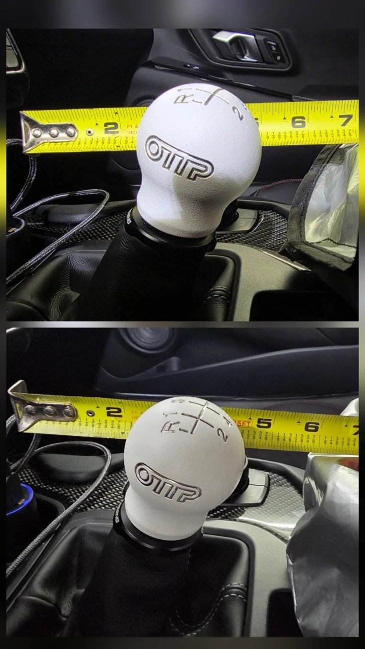

Overall extremely satisfied. New bushings and Rogue short shifter feel amazing. The throw is shortened a full 1/2 inch and shifts are much more crisp with a slight "schnick" when sliding into gears. No increased vibration/noise and shifts are just as smooth but firmer and more mechanical. Measured from 3rd gear to the back of the shift knob in 4th gear. Stock picture is on top.

... the pivot ball has cut out indentions on either side. The pivot ball also seems to be located a little lower on the threads compared to older photos.
I know I could email Rogue (they seem to actually reply) but will ask here first. Any ideas on either of these, the reasoning? It's interesting that the ball height is adjustable, it would appear you can set it wherever you want. You'd want to be sure things don't get too far out of alignment, otherwise it looks like you can set the height of that ball and the ratio of the shortening of the shifter itself. Spin the ball up or down and get a longer or shorter throw.
The grooves in the ball are also interesting, no idea on those but they are of course intentional. There's a chance it's related to machining the ball itself, some way to hold it during one of the operations. Maybe a spot to hold some grease but kind of doubting that.
I emailed Rogue but haven't gotten a reply yet. Seems like you'd be able to adjust the pivot point but the instructions say it voids any warranty if you do and the ball seems to be threadlocked where it is. Either way it feels great.
The grooves in the ball are so you can get a thin wrench on the ball and set/change the position on the threaded section I would imagine. The thread is either a tight thread class to stop it migrating or held in place with loctite I'd say.
Phil
Ben from Rogue replied and confirmed that it was a newer revised version of their shifter and meant to be that way.
