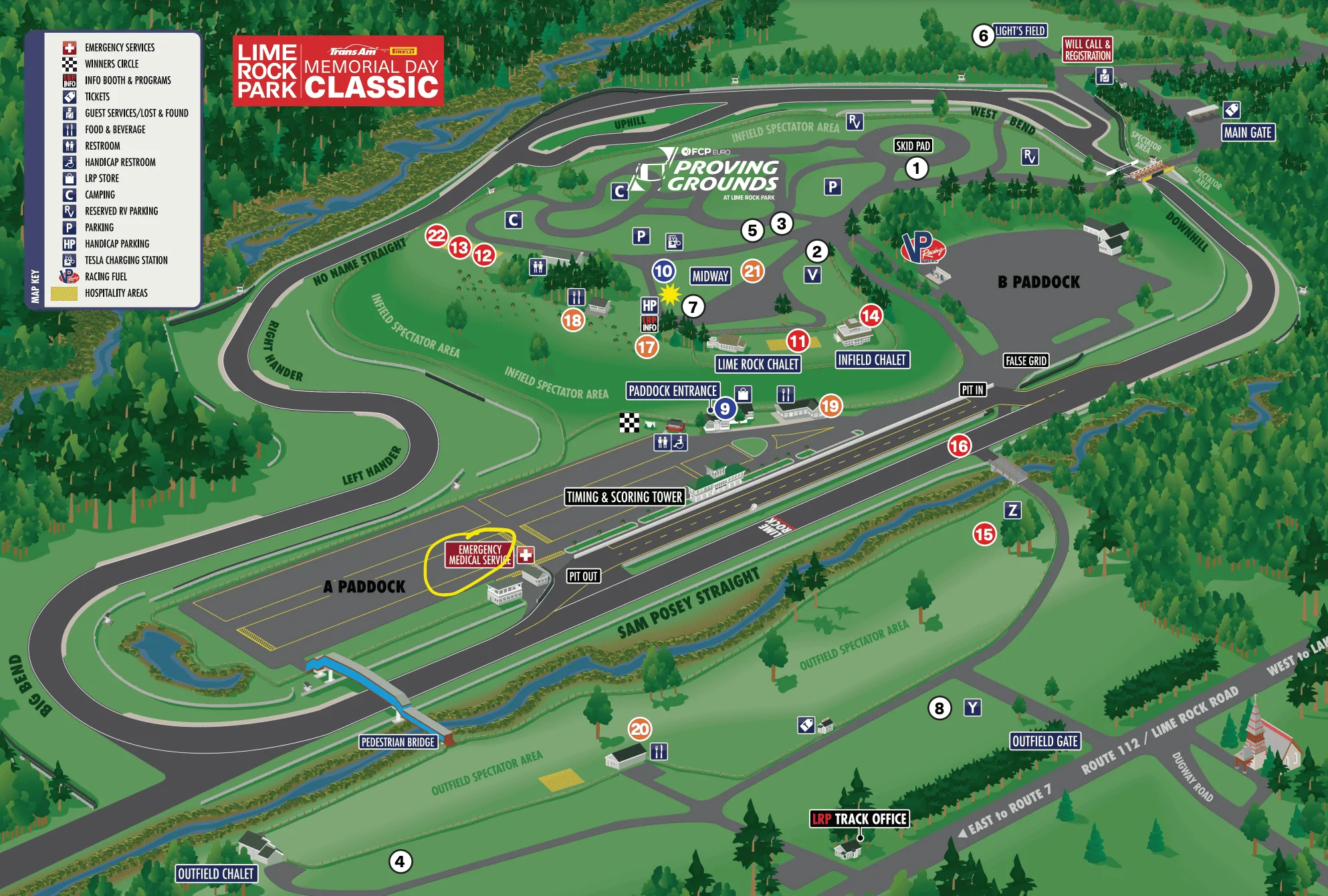

Should be good!
We usually park here (area I circled in yellow). Come join us!
