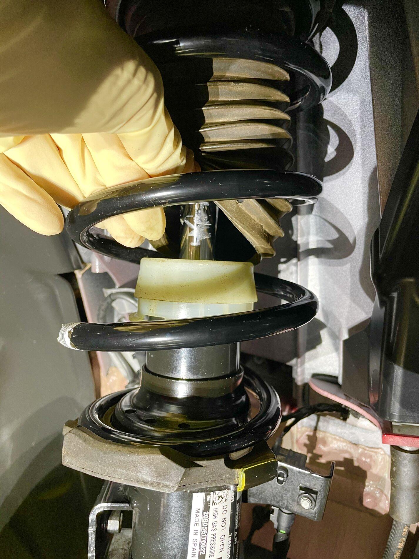

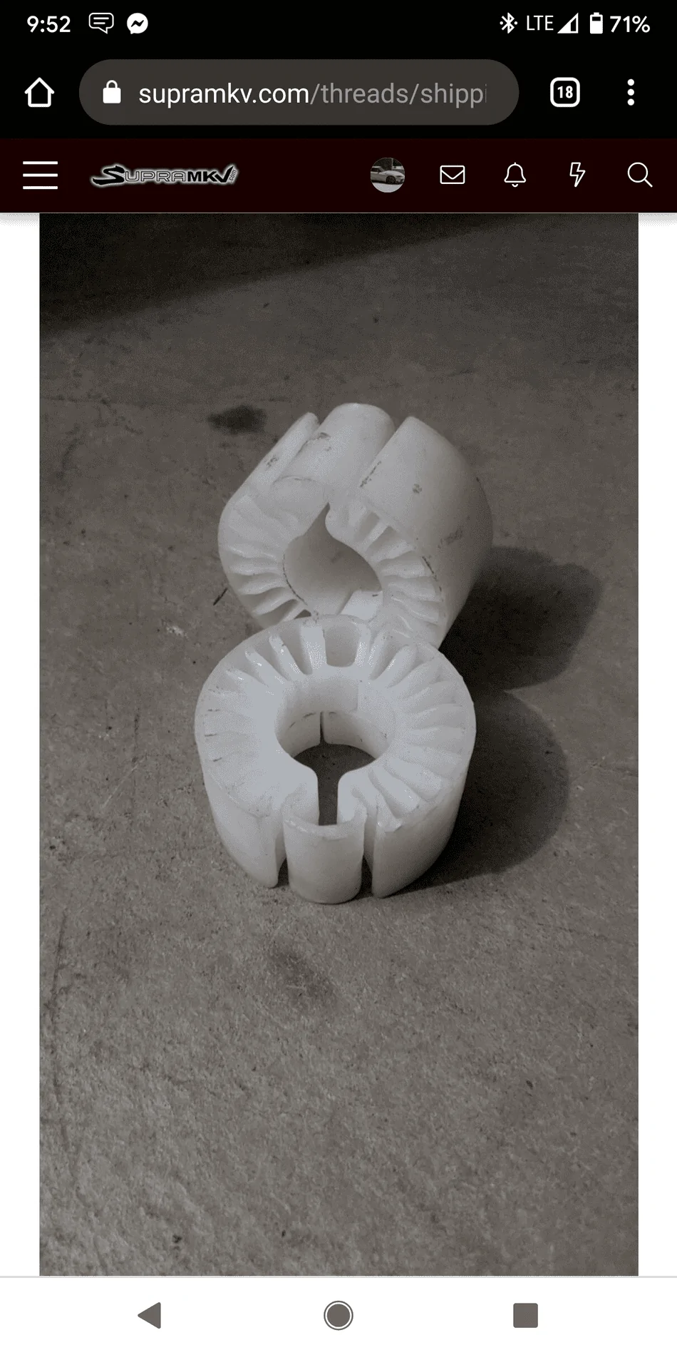

That’s not true. The spacing spacers come apart. You actually just need to Jack your car up and slide the boot up and pry them apart. No need to even take your wheels off, but of course it will be easier. Stop telling people the wrong information.
If you want to try prying them, be my guest. If you take a look at the photos it's a pretty sturdy plastic that is locked all around.

those spacers come apart, just needs a small flat head. I tried it myself. Can you imagine every car needing to pull the strut in a PDI and the alignment being off and you gotta realign it?

I just went and checked mine. They were removed by the dealer.

Did you use a jack to lift wheel and see inside the boot?
When I put my hand over front wheels and feel the boot cover it feels like something is behind it. Does not fill like metal rod but something plastic.
I am going to jack wheel tomorrow and see if I can raise the boot cover and properly see what is behind it.
I will be fuming if I see these plastic spacers.

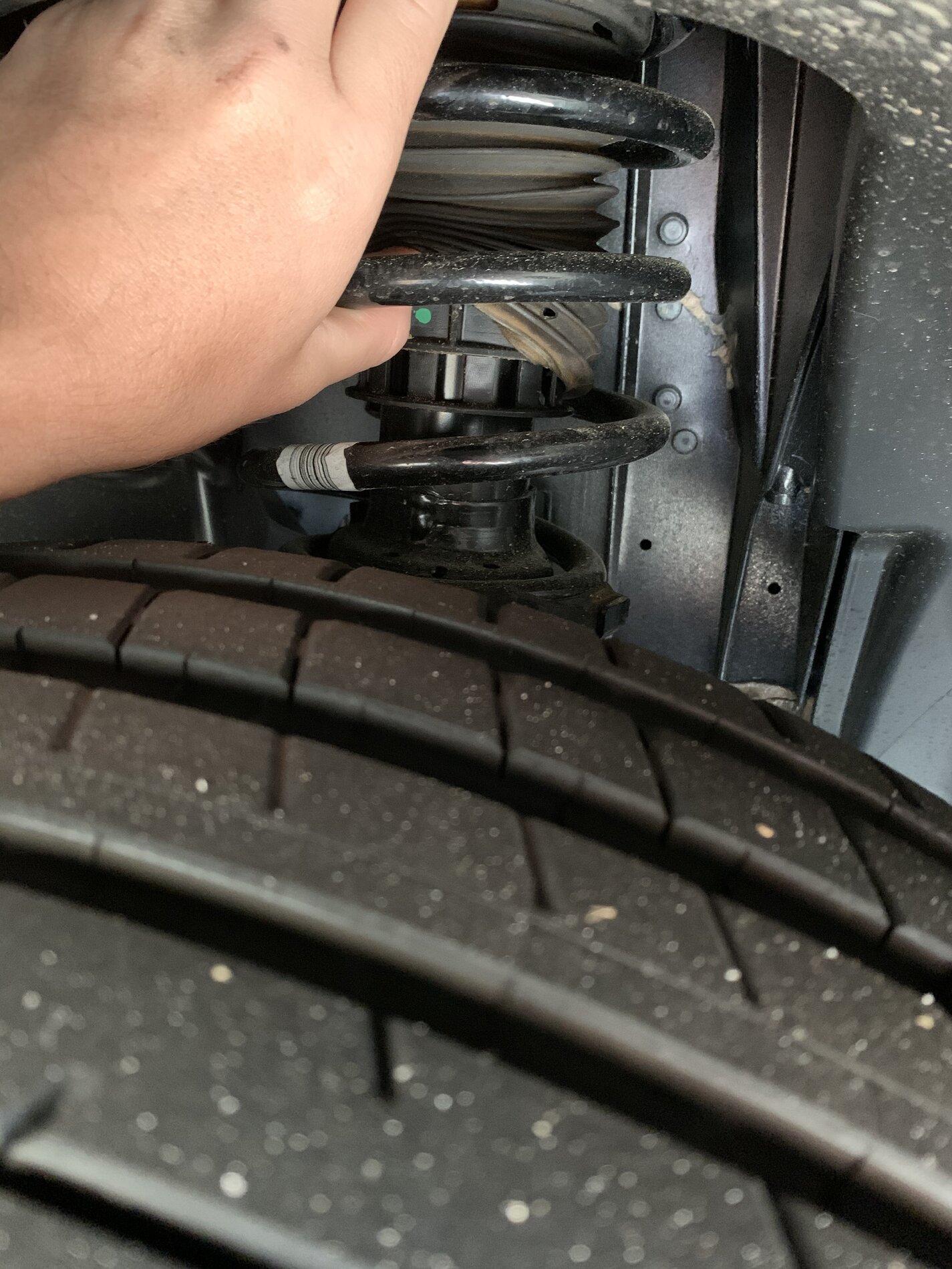

adhrutledge
Austin
Apr 27, 2021
Charleston
2021 Supra 2.0
Sorry you all, I’m ignorant and only do basic bolt ons and oil changes. Can anyone tell if I’m good or do I need to pull the boot up higher. What im touching is a black plastic piece..

3,434
Just wondering how many Supra's out there are driving with these spacers still attached.
My car is currently on jack stands so it was easy to check. I would be pissed too if I found they were still there.

That’s them then. The white piece right there. You just have to pry them off? Surely I would notice my car was riding a lot higher than it should be right? Plus I have lowering springs on it. I’m sure the guy would have said something to me about it then.
No, no, no, those stay on. If u look at the shipping ones on previous pictures, they look completely different.
Ummmmmm No...
That white plastic base is the boot cover holder.
You would see the spacers above attached to metal rod if they were still attached.
