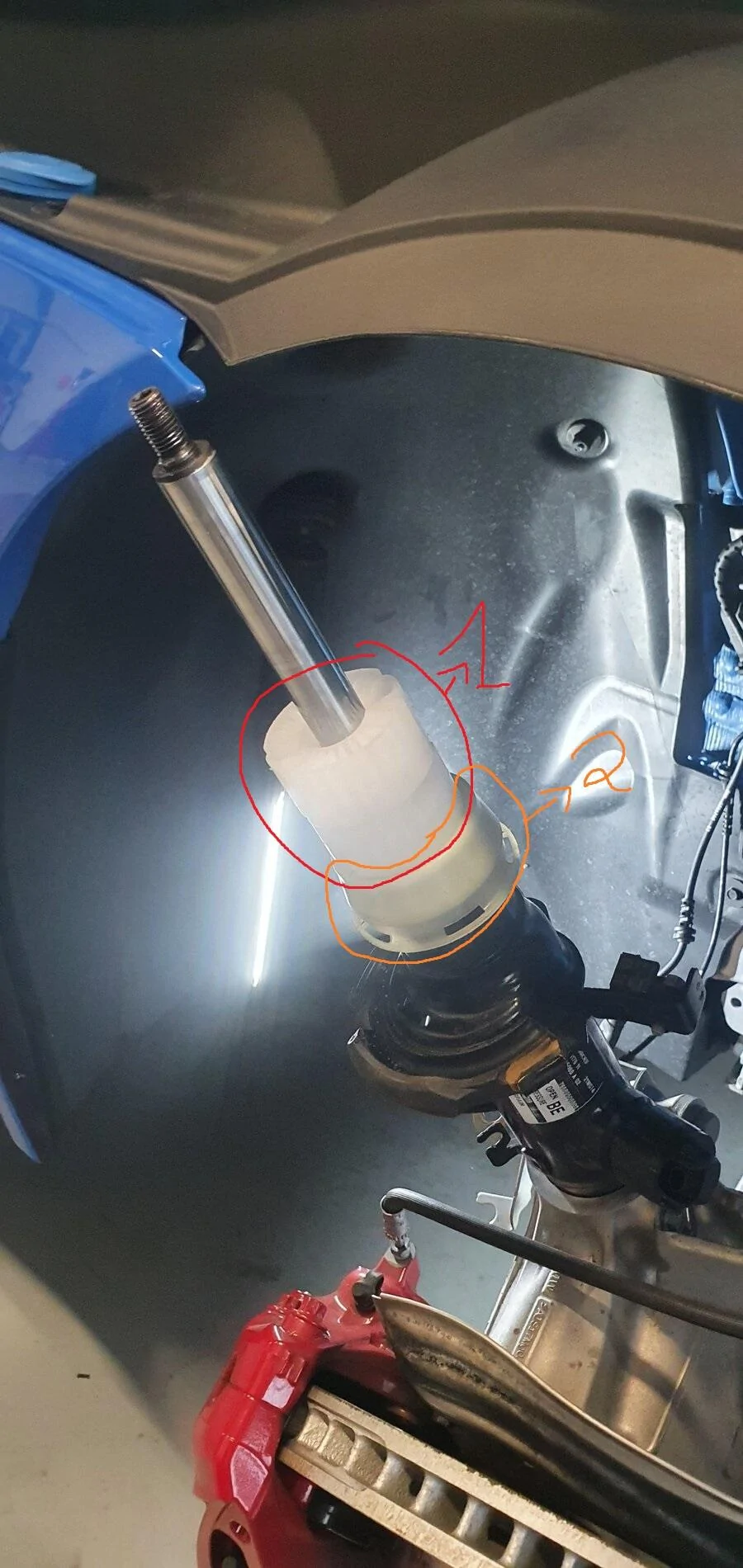

Of course I found them on mine too... awesome. One question, do I have to get only #1 removed, or also #2. I took the picture from f22bub, thats not mine, I hope thats alright.

Everything in circle #1. The other plastic ring helps keep the shock boot down.

Everything in circle #1. The other plastic ring help keep the shock boot down.
-RJM
Thank you for your fast reply! Alright, I'll remove the 2 "rings" in the #1, but leave the thing in #2 right there. And one last question, there are no spacers on the back right? I see a big gap to the tire in the front and it looks much flatter in the back. Also, I don't think anyone here on the forum has found any in the back yet, right?
The gaps should be almost identical unless you have a bunch of items in the trunk. No rear shipping spacers that I’ve seen on the Supras. Here is a side shot for comparison.

Thank you again! You helped me a lot. I was already looking for lowering springs and I was looking into installing them only on the front, because it looks very very unbalanced... So I had an eye on that "mistake" but I never heard of spacers, so I dont even tried to post my problem here. I get them today removed, I hope they haven't damaged anything :rolleyes:

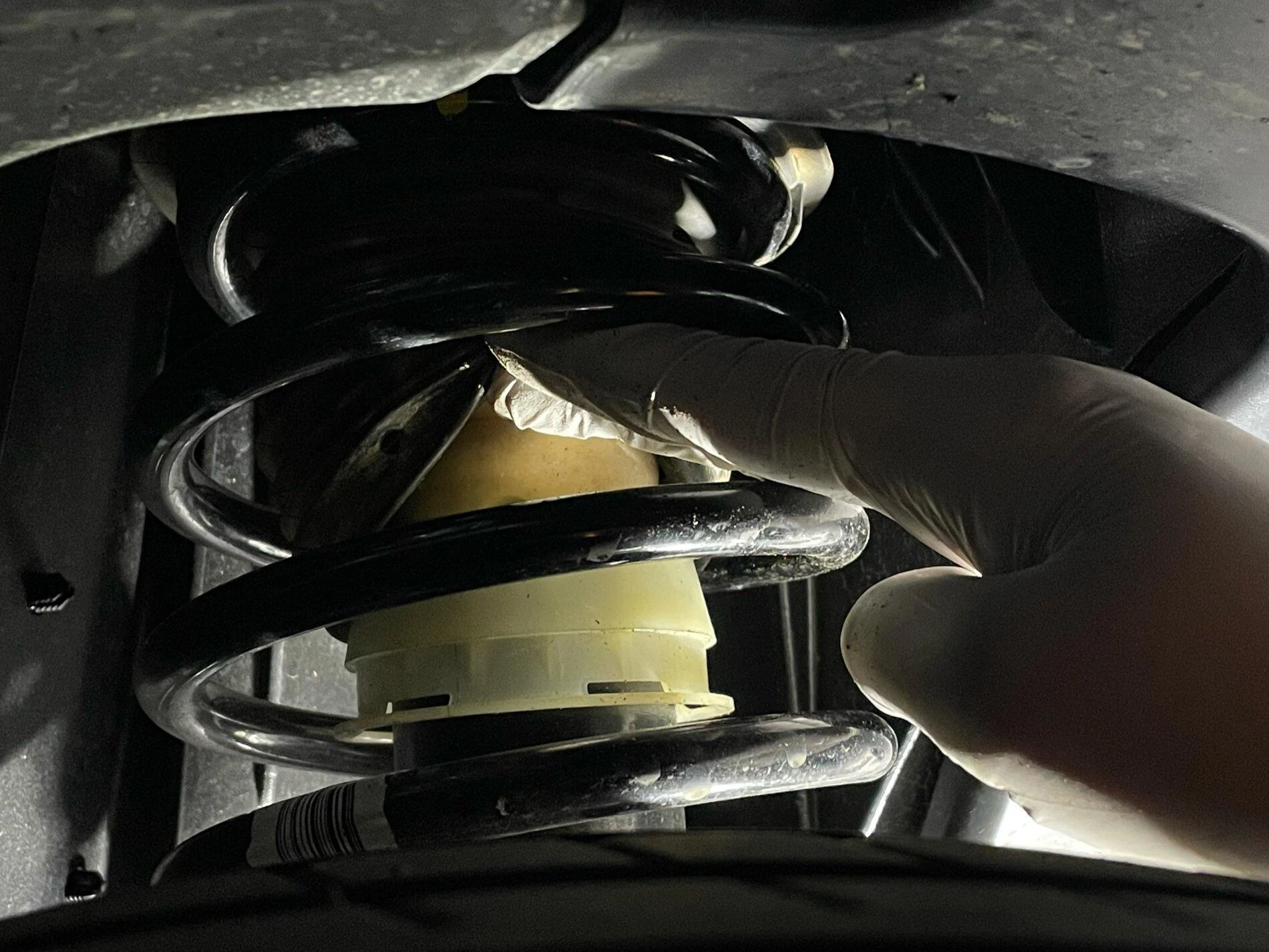

This squishy thing I am poking in the picture is just the bump stop, right? I wasn't expecting to find it right there next to the cap, but I guess most of the previous pictures that show it are with the car lifted and wheel off so the suspension is fully extended?
Correct, thats the factory bump stop. You’re good, no spacers.
