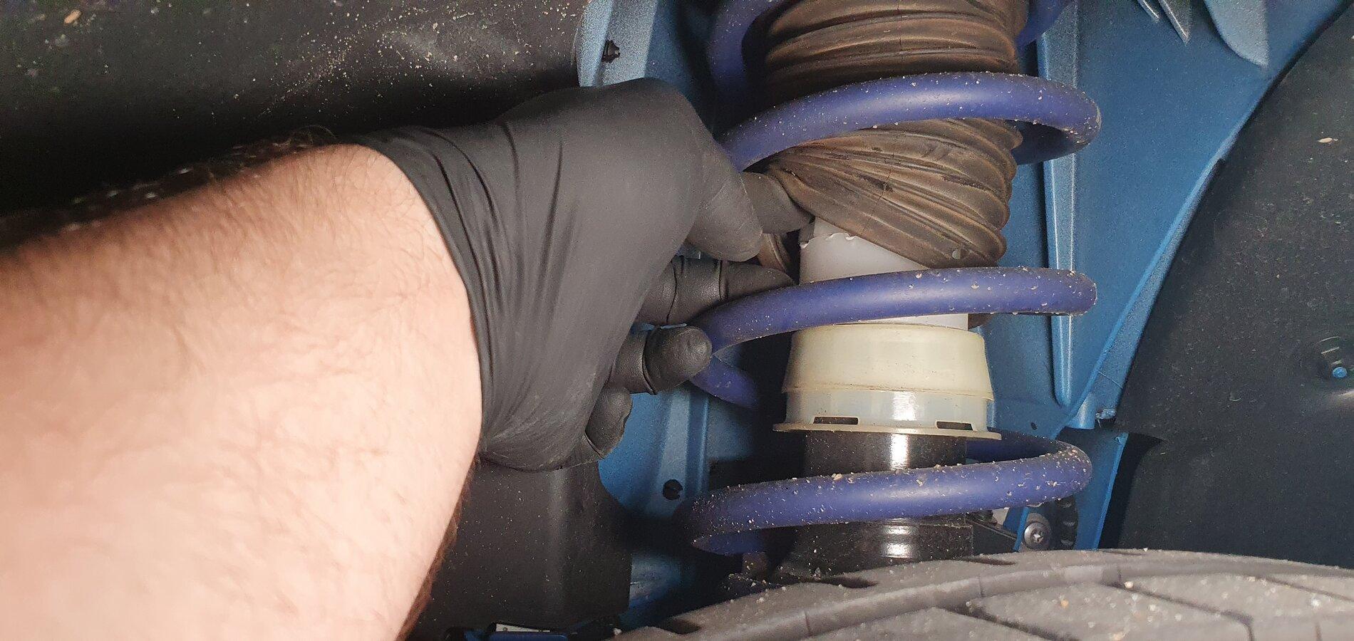

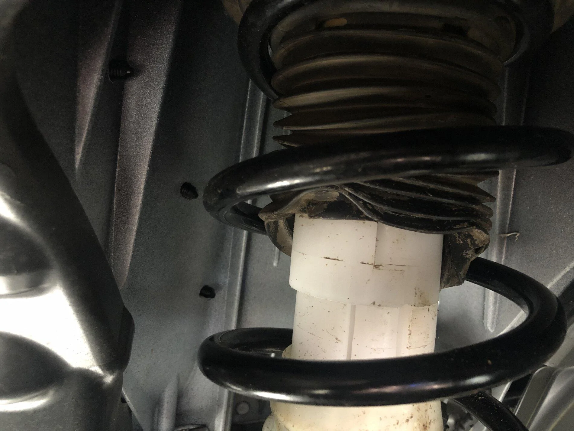

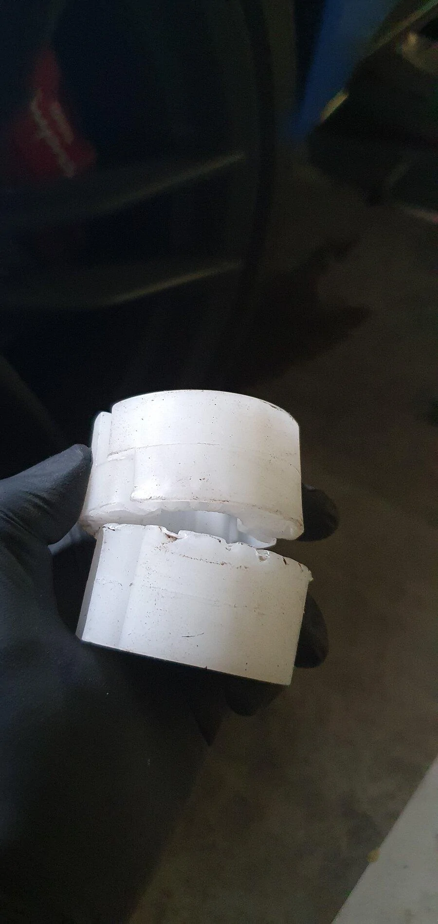

When I installed my springs I wasn't aware so I left the shipping spacers on and because I went on vacation afterwards, they had been sitting in the car for a bit. Finally got the time to remove them and wanted to share some pics for everyone else to see how you can remove them.
You don't need to get out the whole suspension out again! Just jack up the car, until the front wheels do not touch the ground and you can remove the spacers without even removing the wheels! Took me 5 mins.
You need to pull up the black plastic shoe , then the shipping spacers can be unclipped on one side, by pushing down the right end and pushing up the left end. Then you can slide them out. There are two on each side, someone else marked them one or two pages ago in this thread.
Video on how to unclip them:
Yep, that's how I did it.

I had to lift my car to get my hand between the wheel and the wheel well, but they were extremely easy to remove.
