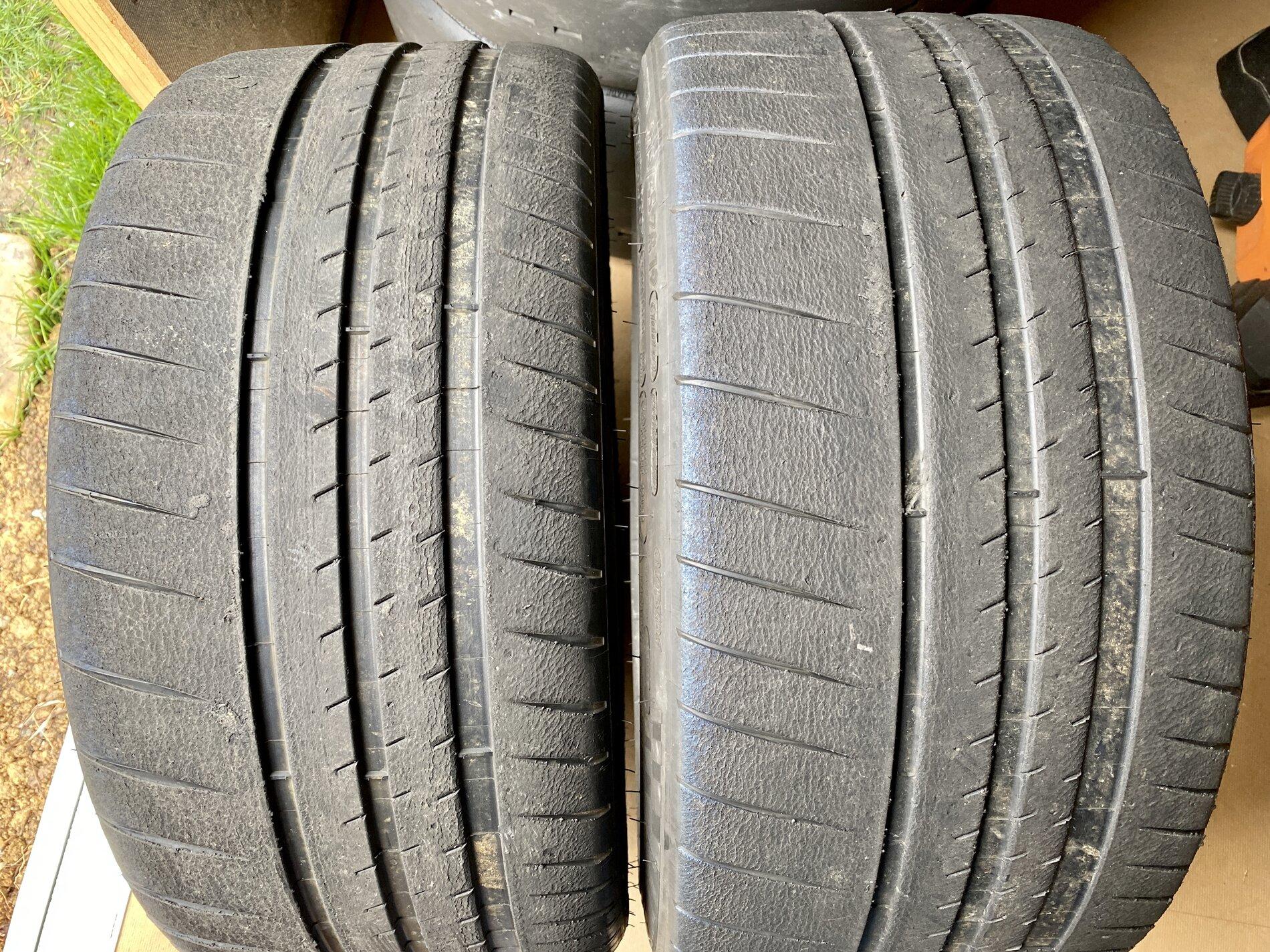

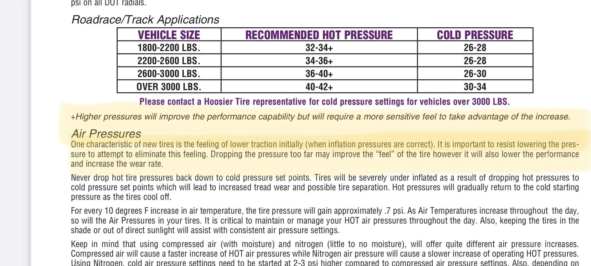

When I ran the OEM Super Sports, and later the Sport Cup 2’s on the stock suspension, I stayed in the 40-42psi range with good success at lowering times and mitigating some outer front treadeear. Rear camber was adequate keep excessive wear in check but the fronts need more camber and I have the SPLparts LCA’s on order too ( in addition to other spl control links).
There seems to be this train-of-thought that lower tire pressures equal improved traction and performance at the track. There is truth to that at the drag strip but not-so-much on a road course (within limits of course)...
TireRack competition tire pressure guide
https://m.tirerack.com/tires/tiretech/techpage.jsp?techid=58
and from “care and feeding of Hoosier R7/A7”... be sure to read the “+Higher pressures...” part highlighted first
The Hoosiers will need much more camber, of course, but the Sport Cup 2’s have survived 4.5hrs of Sears Point and Laguna Seca looking like this at 40-42psi. Sears Point lap times were 1:56-ish, and Laguna was 1:45-ish.
How do you like the Sport Cup 2s ???
