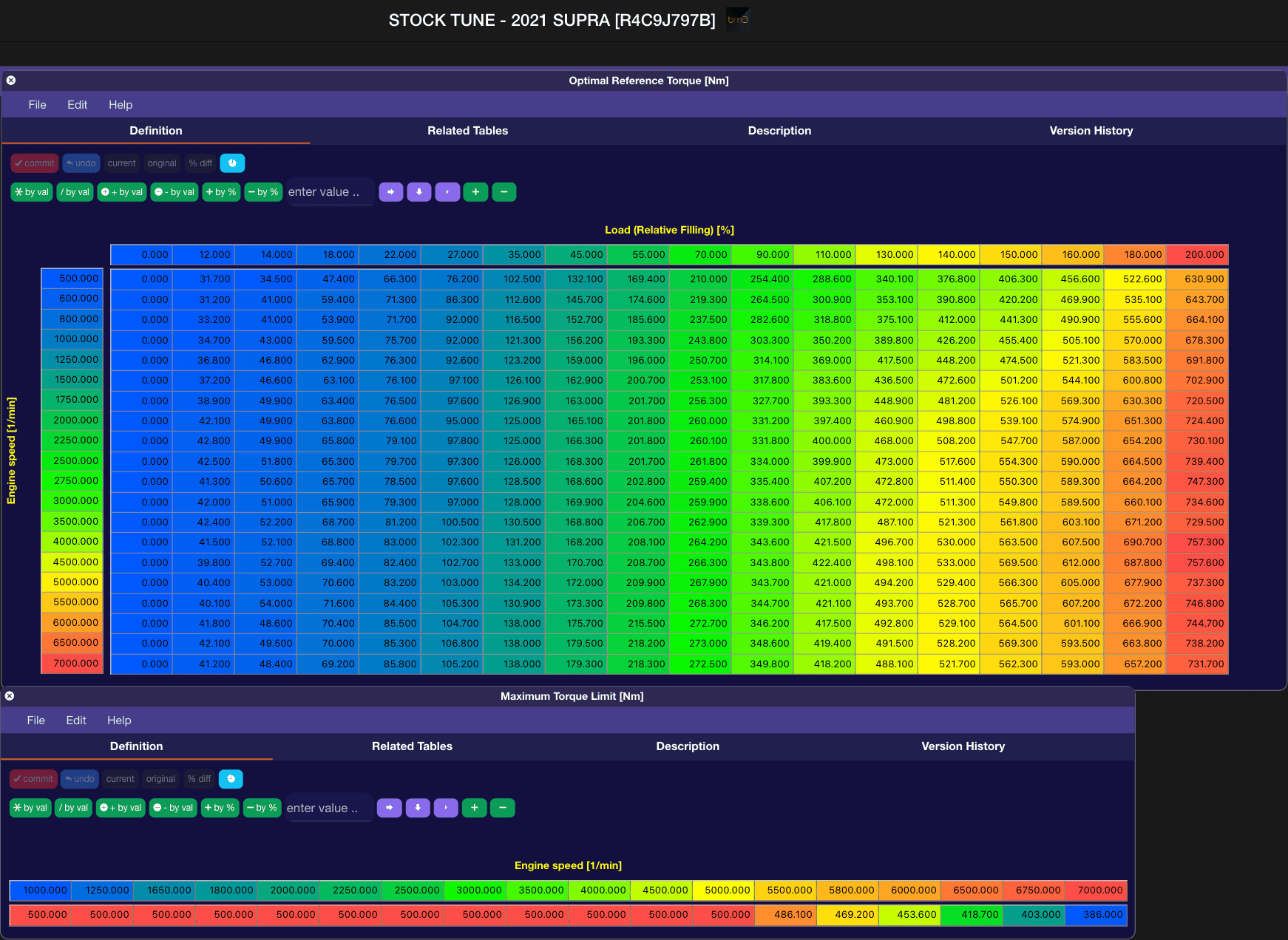

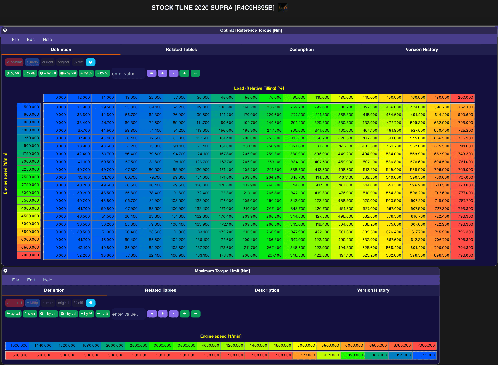

21+ is actually 10.2 CR
20 is 11.1 CR
21+ has higher torque-target programming because of the lower compression (stock)
20 is 11.1 CR
Interesting, didn't realize they changed pistons/crank/heads(?) between 2020-2021. Thought it was just the manifold.
