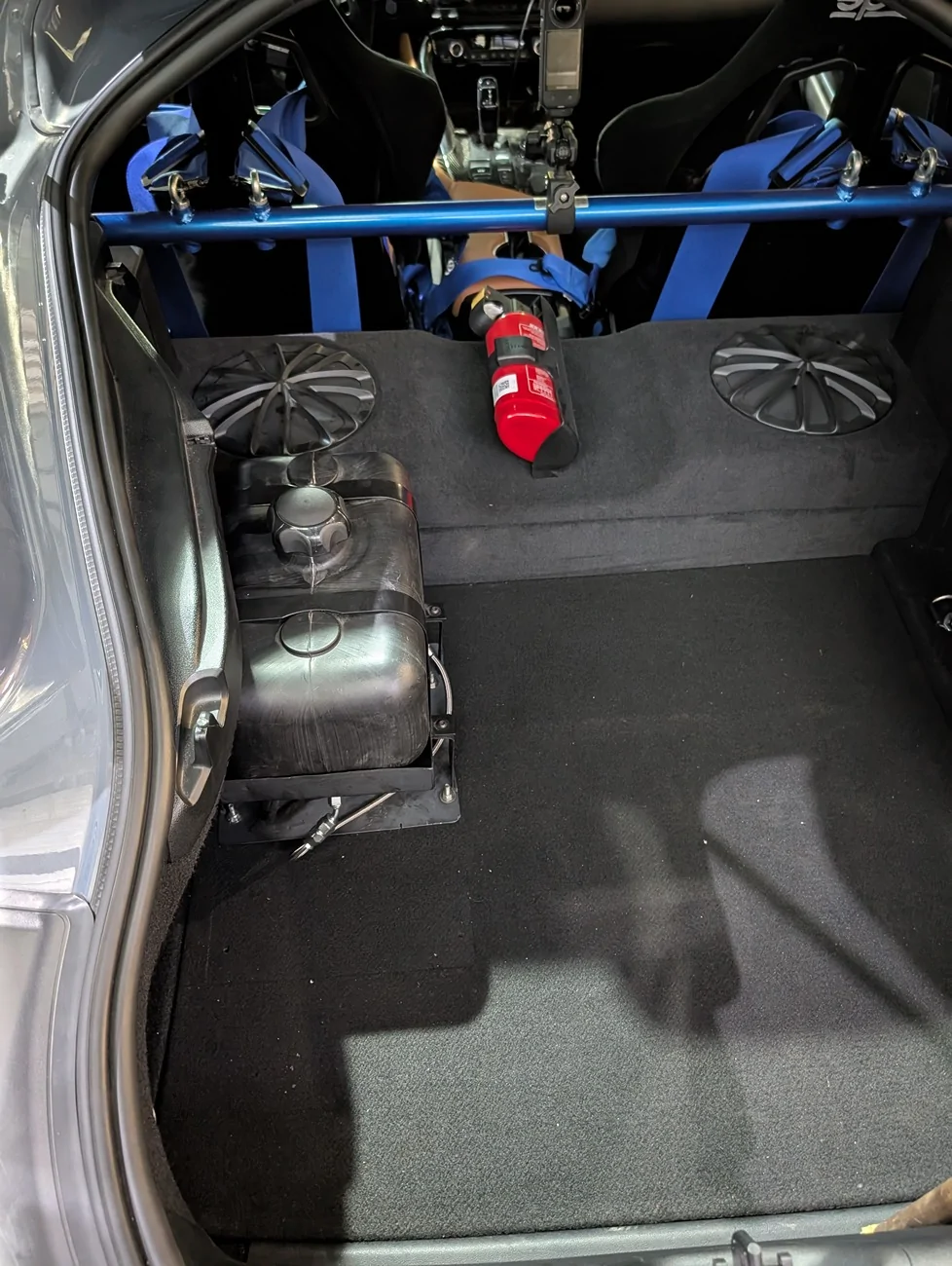

Did get the new meth tank on. Out goes the 3 liter underhood tank and in goes the 9.5 liter trunk mounted tank

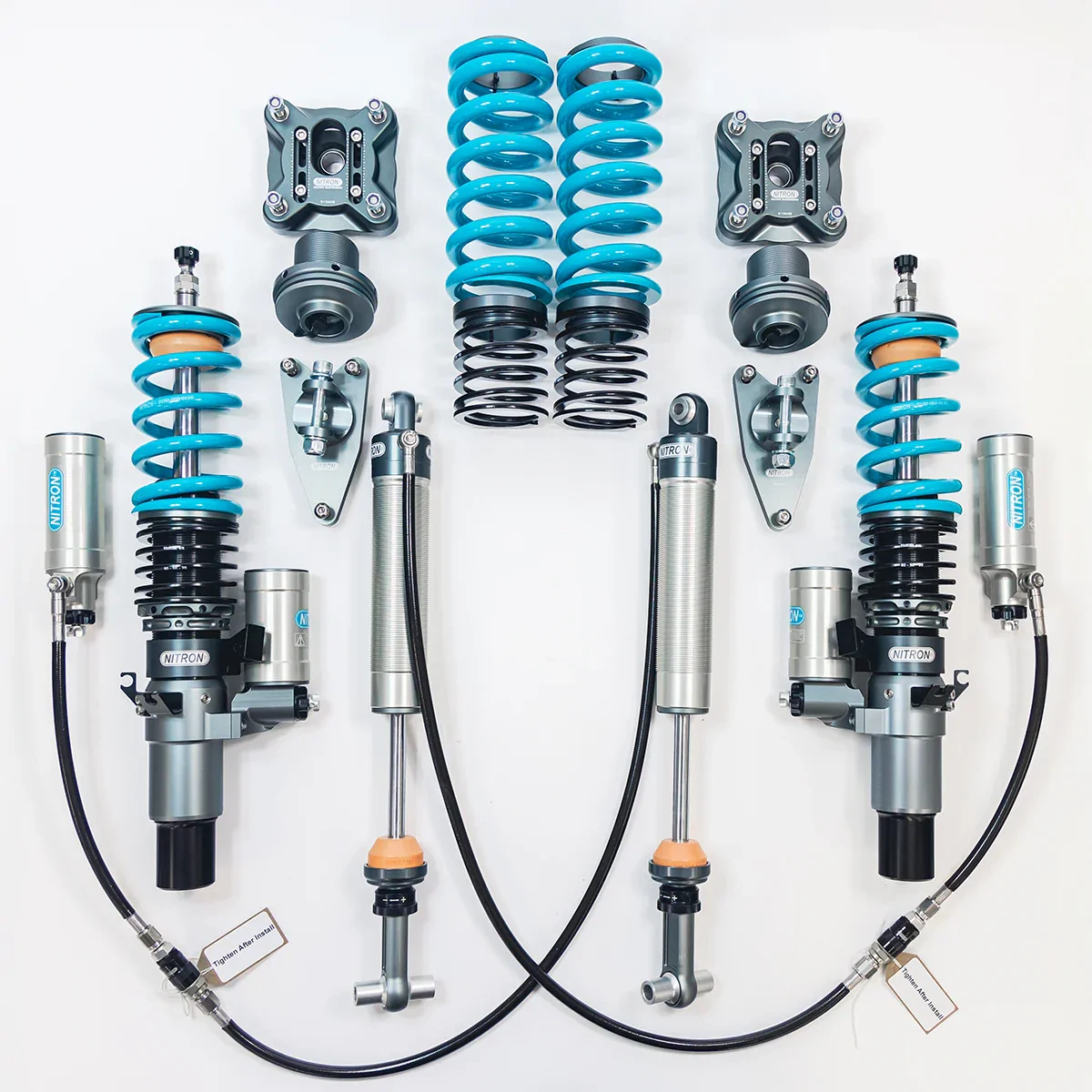

Moving away from the Ohlins that've served me well so far. Big fan of those coilovers, especially paired with the SS camber plates. They're just a great dual purpose setup.
But, it's time to go up a step. So i have Nitron 3 way coilovers on the way. Came down to these or the Moton 3 way ones.
Setting up 3 way coilovers is a bit intimidating....
VERY excited to hear your review/impressions on these coilovers once you've got them on the car and had some seat time to dial them in.

What spring rates?
60nm front and 140nm rear. 343/800
I also have an Alcon BBK on order btw, but they've just reached out to me and recommended a larger rotor for better thermal capacity. So we're looking at a 378mm rotor vs the 355 one in the kit i was looking at. If anyone reading this knows if that would clear my 18 inch TE37s (+30)....
Are you sure that is correct? 343 lbs/in front is insanely soft. 800 lbs/in rear is about 425 lbs/in since it's divorced. That is an insanely soft setup. The front is about half the rate of what I run and some people think my setup is "soft".
Will def share my detailed thoughts when i get them on.
Will say this though right off the bat....i think there's very little difference between the brands at the top. Nitron, JRZ, Moton, MCS etc...for the average pleb like us. I'd personally choose with vendor preference in mind and skewing hard towards the brand that can be serviced locally (or closest to me)
