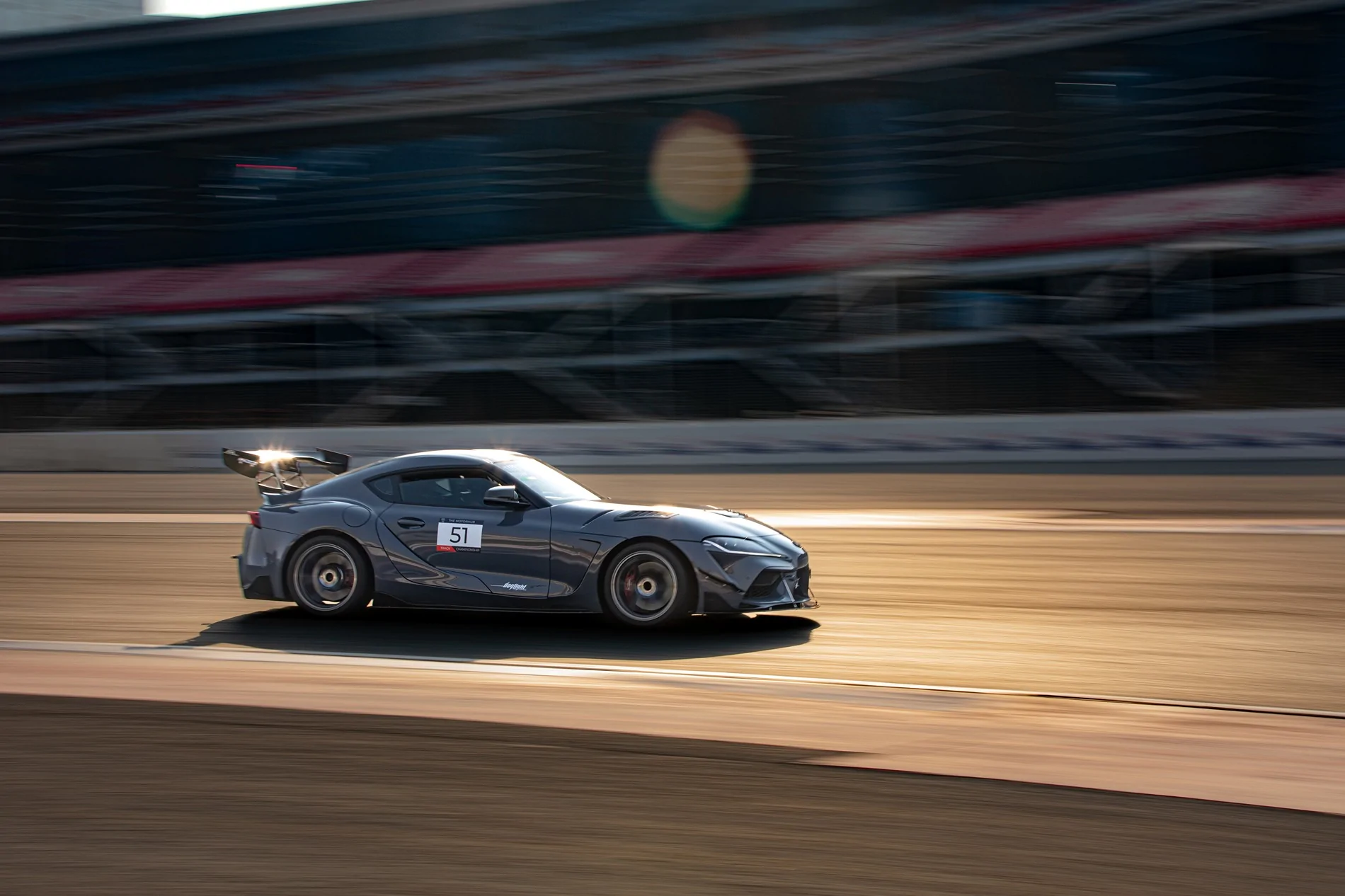

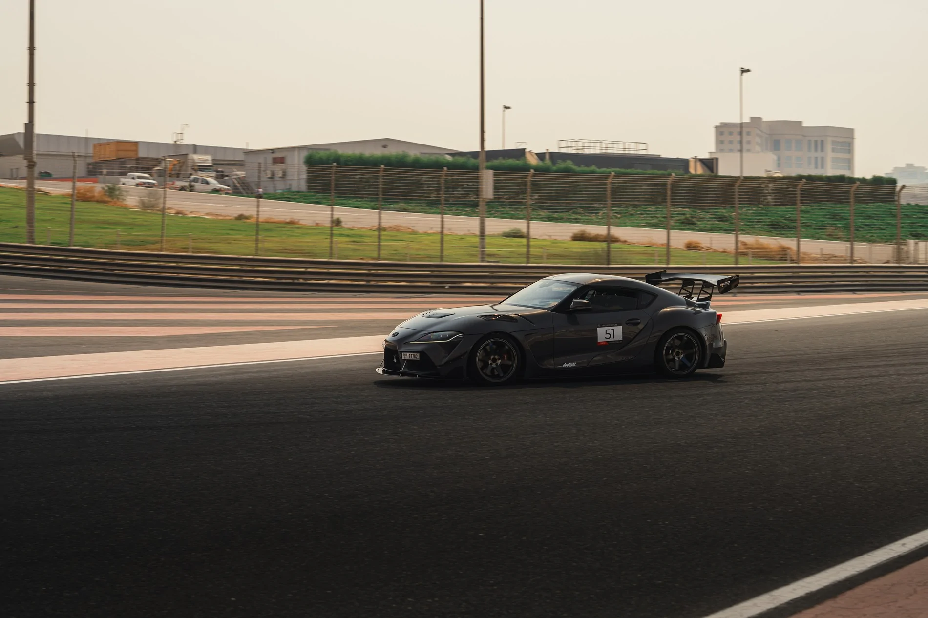

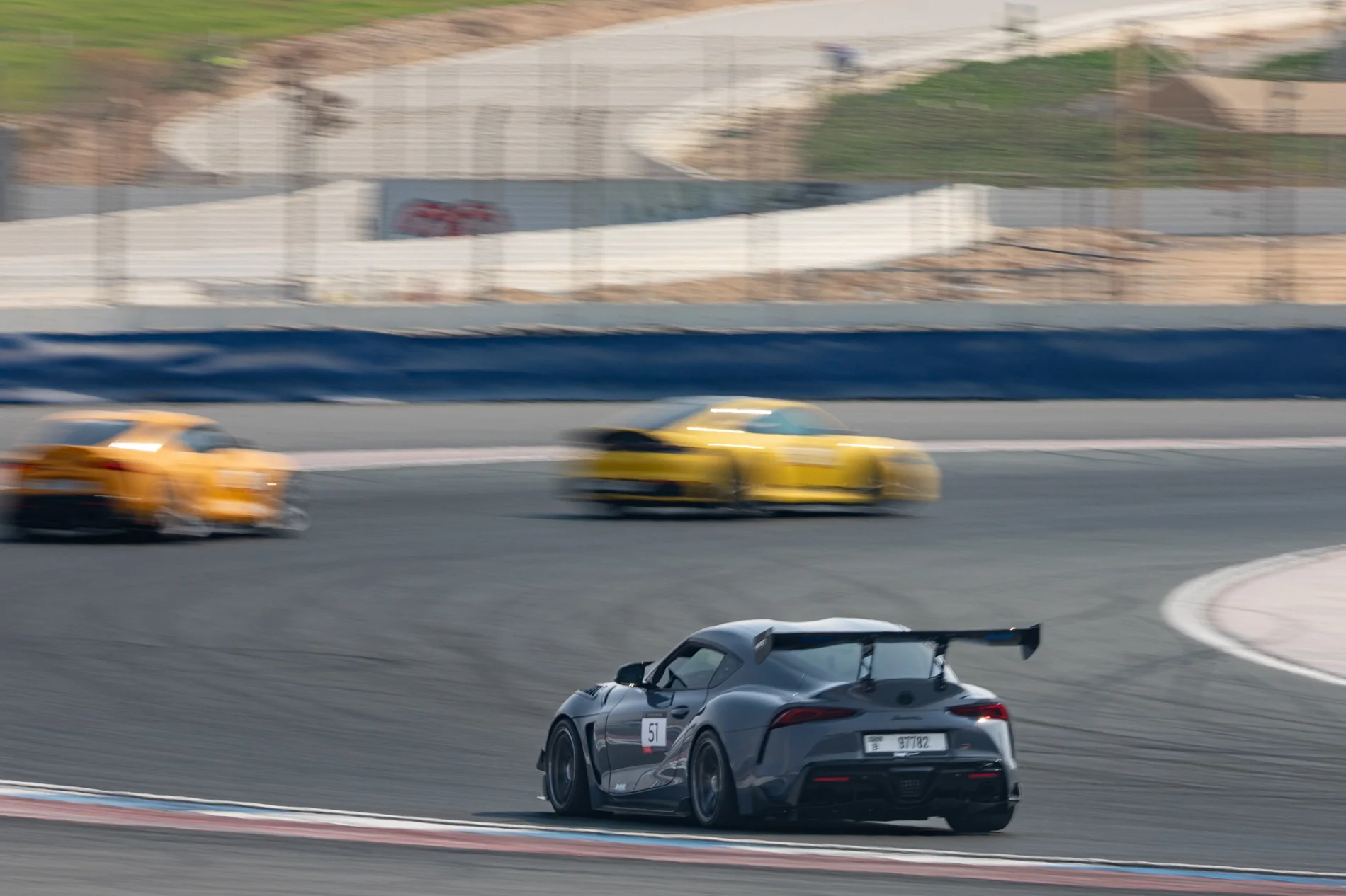

Cool shots man, what was the highest IAT and what was average? From the canchecked screen, do you go to the yas track, I tend to enjoy it more than autodrome

I do more autodrome than yas, but I'll be at yas soon when one of the 2 time attack leagues have a race there soon.
My IATs were in control that day. Highest number I saw was around 67
Edit: 57 not 67

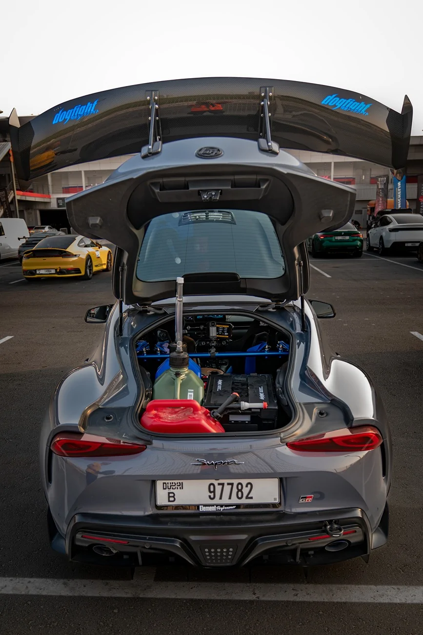

Id still consider that good in our weather, your using methanol to cool too right?

ah ok, 134f not so bad for that ambient and pushing the car. However, I thought you where spraying meth now?

tbh those were probably the lowest IATs of any Supra on track that day, unless they were also running meth (i don't think the others were). It's just that hot around here....and it didn't help that track days/races during this weather are usually in the evening, but we started a 1pm that day. Will be the same this coming weekend. We're on the precipice of good weather though. November - March will be nice.
(i also have tiny nozzles btw)
