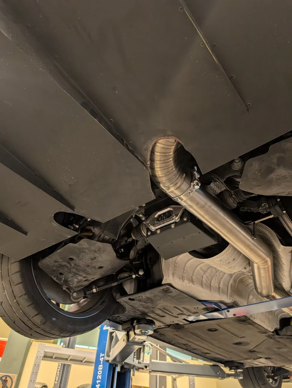

Titan Motorsports Titanium exhaust is on to replace the ARK DTS. 30bs lighter than OEM, and valved. No info online on whether it would fit the Verus diffuser, so we eyeballed it, assumed it probably would and bought the exhaust. It fits, with some trimming. Looks closer to the diffuser than it is IRL, so no it's not touching or going to touch under load. Misleading angle

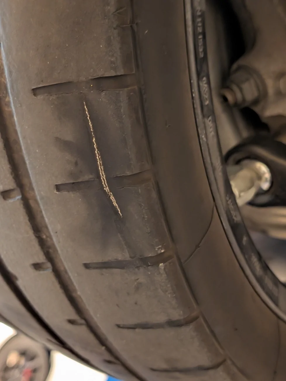

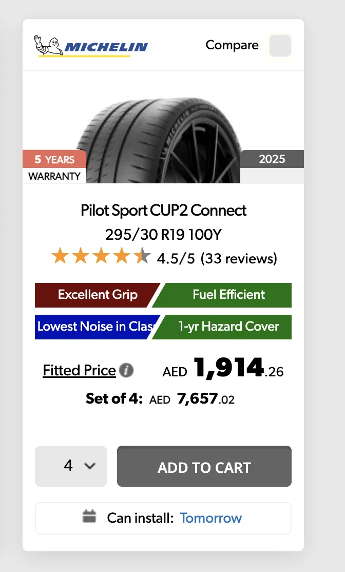

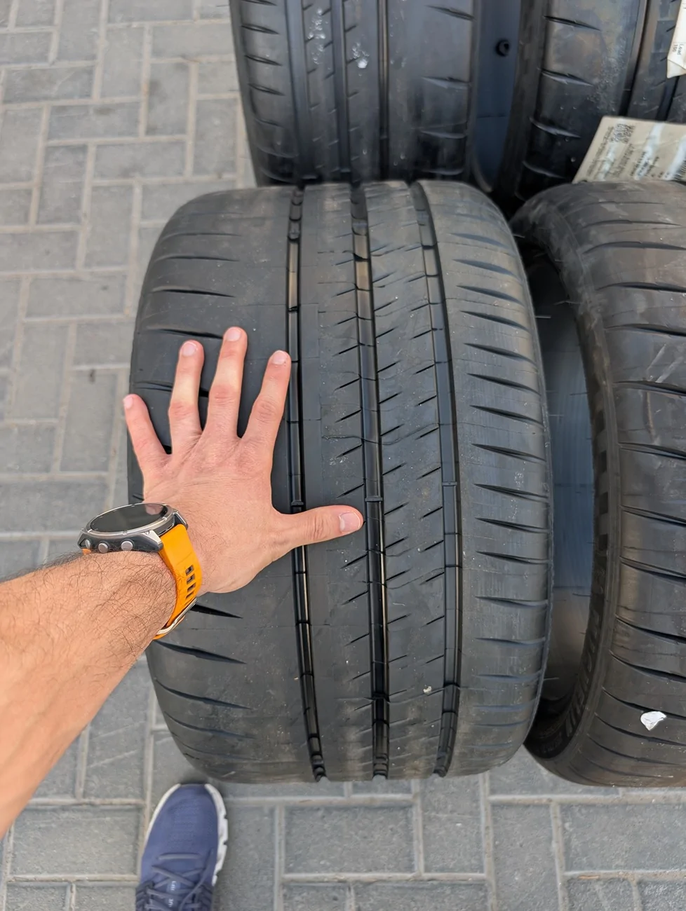

Discovered that my Nankangs were corded last night. I'm still on OEM wheels, and there's a massive shortage of 19 inch 200tw tires here. And i had no time, so i had to settle for a insanely expensive option to make it in time for my track day. Cup2, which set me back more than $2K for the set. They're fast tires, but not CRS fast by any means
Ok i'm good with whatever you believe in, but i personally don't do the sky daddy thing. But if i did, this would've been en emphatic sign that he/she/it is not a fan of me. I've been waiting for my 18 inch made-to-order wheels from Japan since Feb. Less than an hour after ordering those eye-wateringly expensive but not elite 19 inch tires, i get a call from the shop saying my wheels will be in soon. 18 inch 200tw are easy to find here....and obv half the price of the ones i bought. FFS...
2k for CUP2?? For the front and the back?
Bit more actually. Yeah front and rear. Almost but not quite double the cost of CRS around here

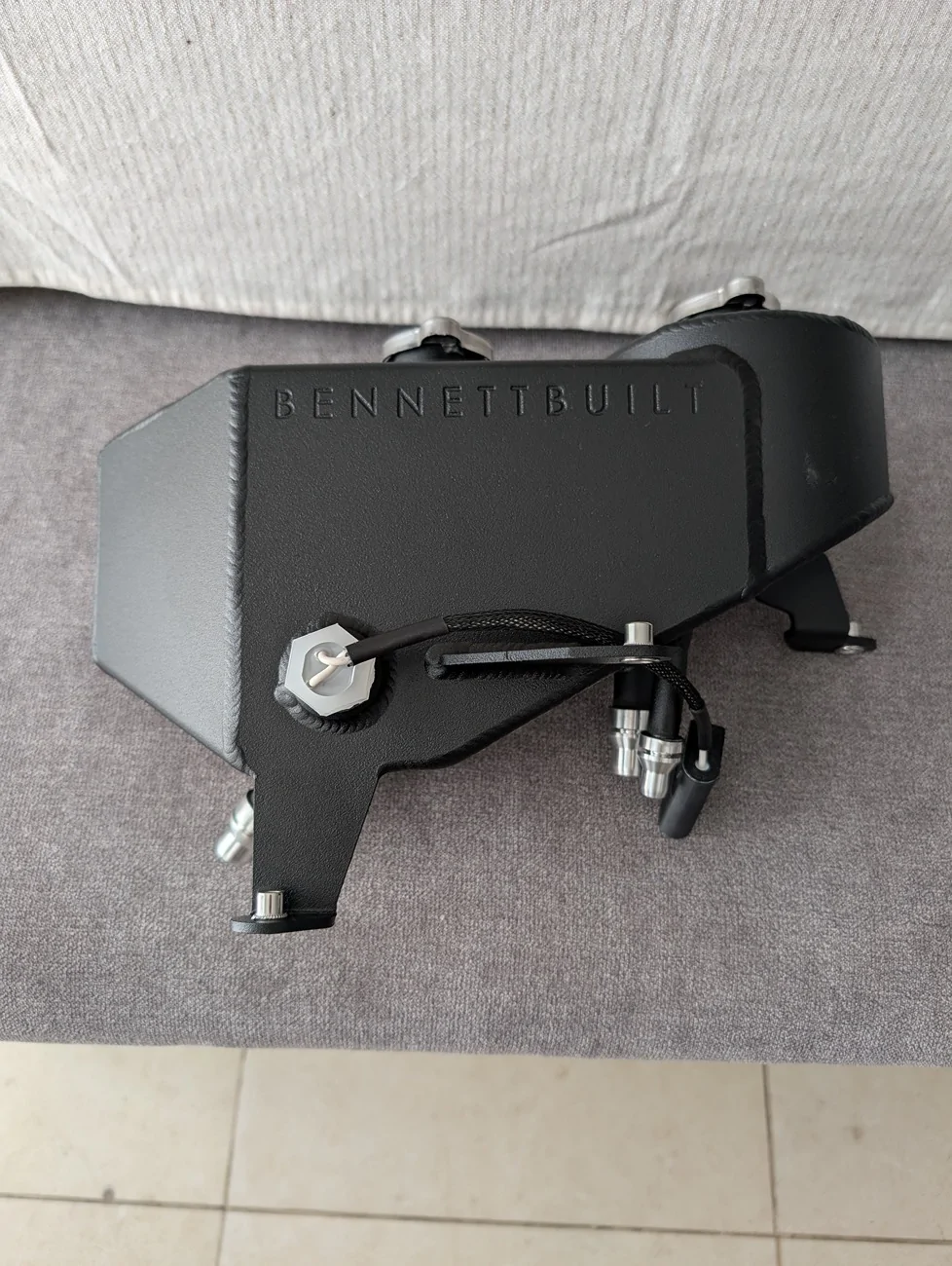

What is the reason you are changing the coolant reservoirs away from OEM?

OEM is plastic, so peace of mind. I do like the extra capacity as well.
Damn I’m paying 1675 dhs each (VAT Included) for the cup2 don’t know how it reached that high up, also are there any benefits to changing the front tires too?
I usually get my tires from pitstop.
Matching front and rear tires is not as important as matching the rears and fronts separately, but it's still highly recommended.
Different tire brands (and even different models within the same brand) use unique rubber compounds and tread designs. If your front and rear tires don’t match, the way they grip, flex, and heat up under load can be very different. So you get unpredictable handling.
Also very different grip levels front and rear can mess with your electronic nannies (e.g. TC)...because they're tuned to work with tires of similar grip levels.

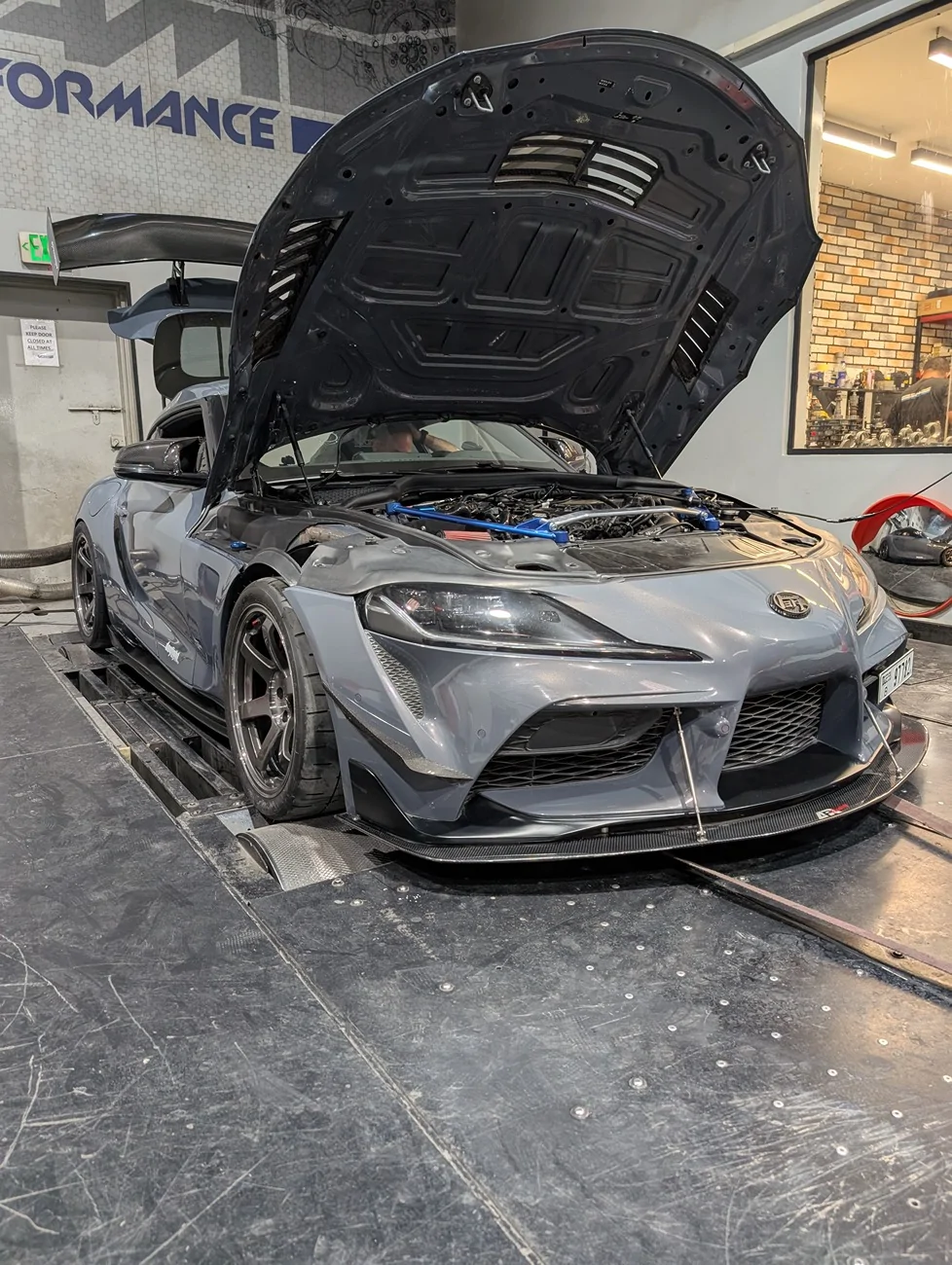

So i found a very good local tuner who agreed to sort me out, but it seems like BM3 is down and has been since yesterday....can't request tunes, can't flash etc..
And it's the weekend, so i don't think pro tuning freaks are going to do anything about it.

Whole lotta stuff done
Wheels. TE37 18x10.5 +30
295/30/18 CRS
Verus AOS
Dyno tune (not done yet, still needs to be smoothed out).
