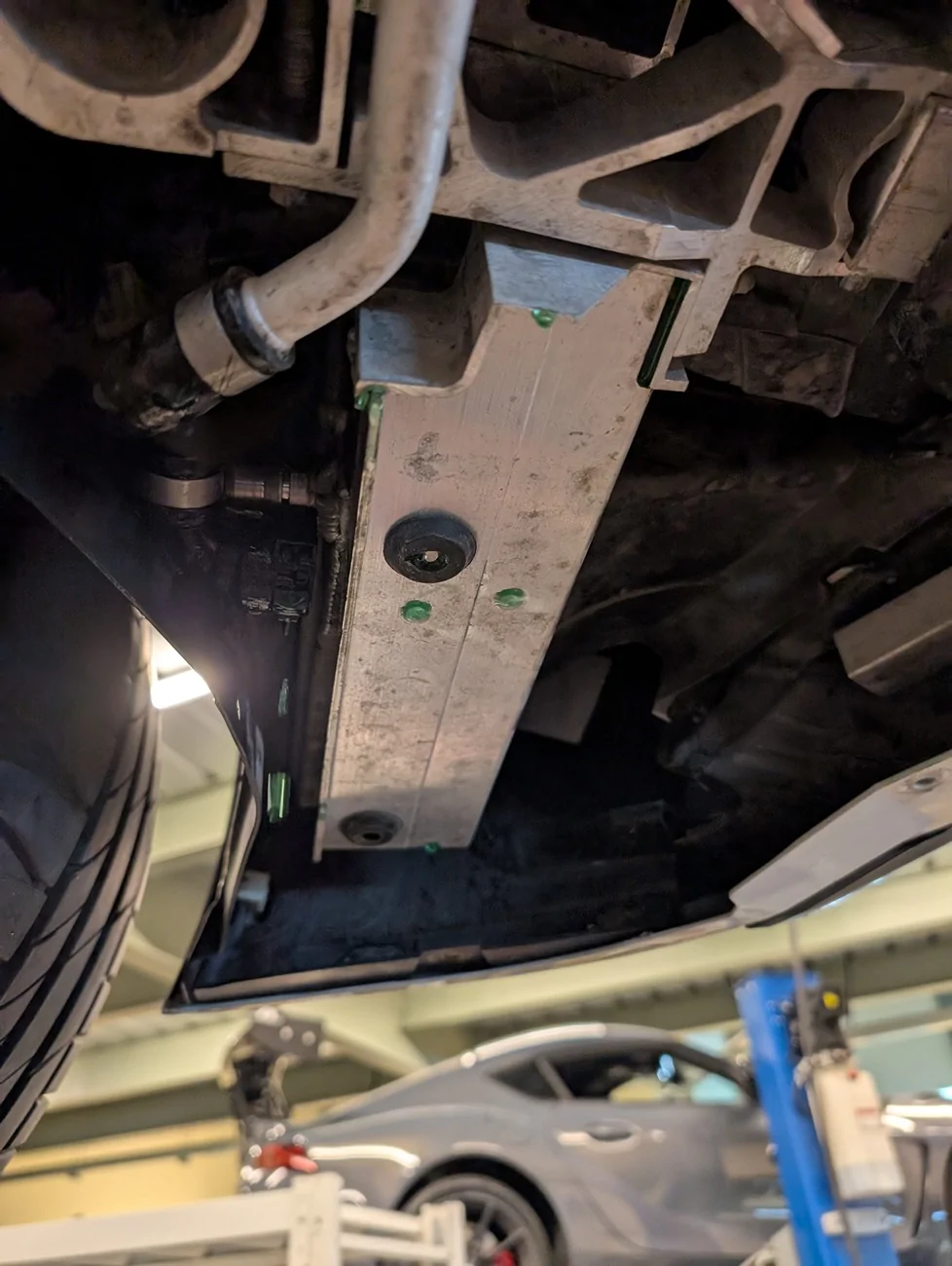

Easy to identify. The US ones are black steel and a whole cage, EU are raw aluminum and just L brackets

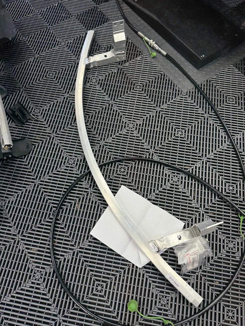

Ok so checked the radiator bracket setup on our cars here. This isn't my car (just somebody's getting worked on), but it's going to be the same as mine. This doesn't look like either the US or EU one. It's aluminum, but this absolutely doesn't look like it weighs 1.5lbs per side. Doesn't look as flimsy as the EU one either
At some point will do this properly by weighing everything, but at first glance this is a bit weird.

That is 100% the EU version.
https://www.ebay.com/itm/375505023118

That does indeed look identical. But then the next question I have is....then are we sure that the one that phd is selling and that weighs a claimed and combined 3.3lbs for both side is the same as the EU version? I know I'm just eyeballing it for now (will def weigh), but damn that does look a bit thicker than I was expecting
Edit: basically has someone here either bought an EU version to confirm, or has an EU member weighed theirs?

It's aluminum so probably not that far off. I mean, the whole front lower support bar I replaced felt like it weighed nothing.

You’d be surprised. Most things these days are hollow and weight nothing. But when a crash comes everything is jacked up lol

Thanks guys. I'm sure it's just my mind playing tricks on me. Will still weigh when i can just to get that monkey off my shoulder, but i'm not gonna think about it for now because you guys are probably right that it's the EU one

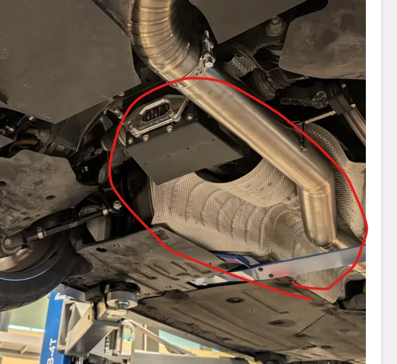

Titan Motorsports Titanium exhaust is on to replace the ARK DTS. 30bs lighter than OEM, and valved. No info online on whether it would fit the Verus diffuser, so we eyeballed it, assumed it probably would and bought the exhaust. It fits, with some trimming. Looks closer to the diffuser than it is IRL, so no it's not touching or going to touch under load. Misleading angle

Which subframe insert is that? did you feel any difference on the street at all?

I have the hardrace inserts. Can't really tell on the street. will have an answer today as i'm off to the track. interestingly though, i DID actually feel a difference on the street with the diff brace
