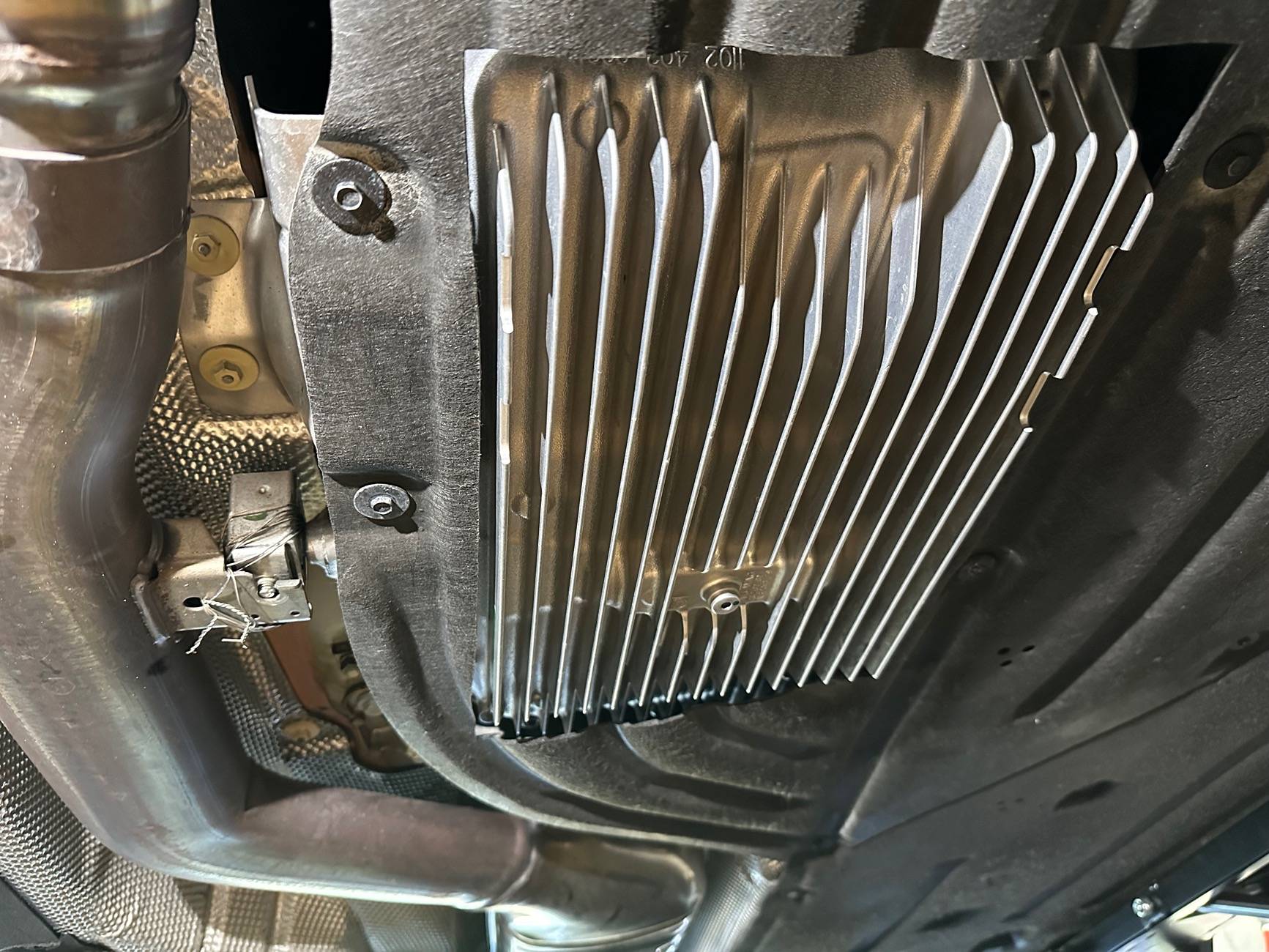

The M5 pan with exposed fins helped cooling a bit on my Supra.

M5 pan has deep cooling fins.

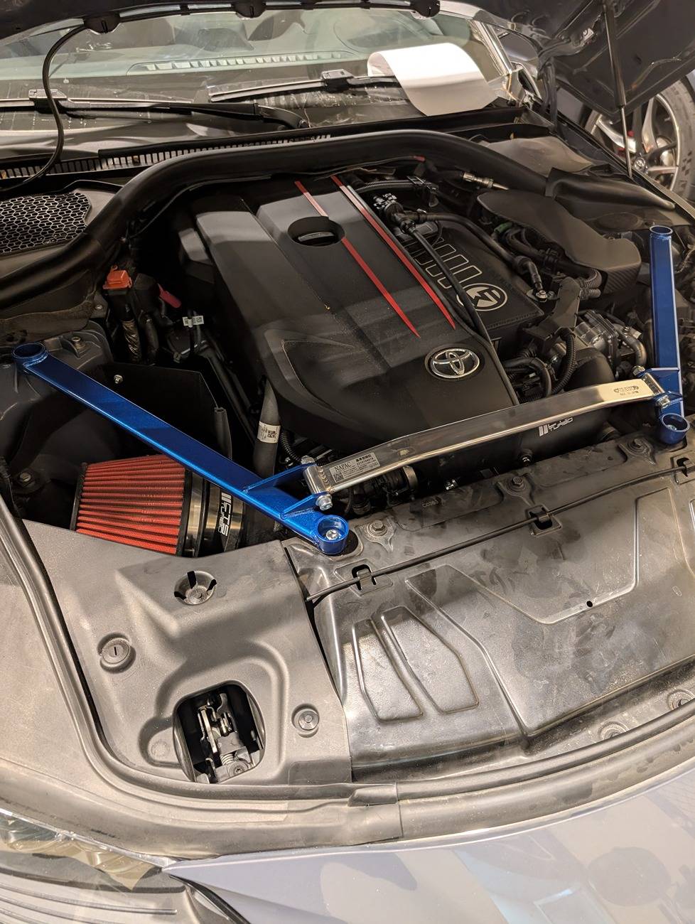

Cusco front brace is on. The OEM ones were fine, but man do they look awful

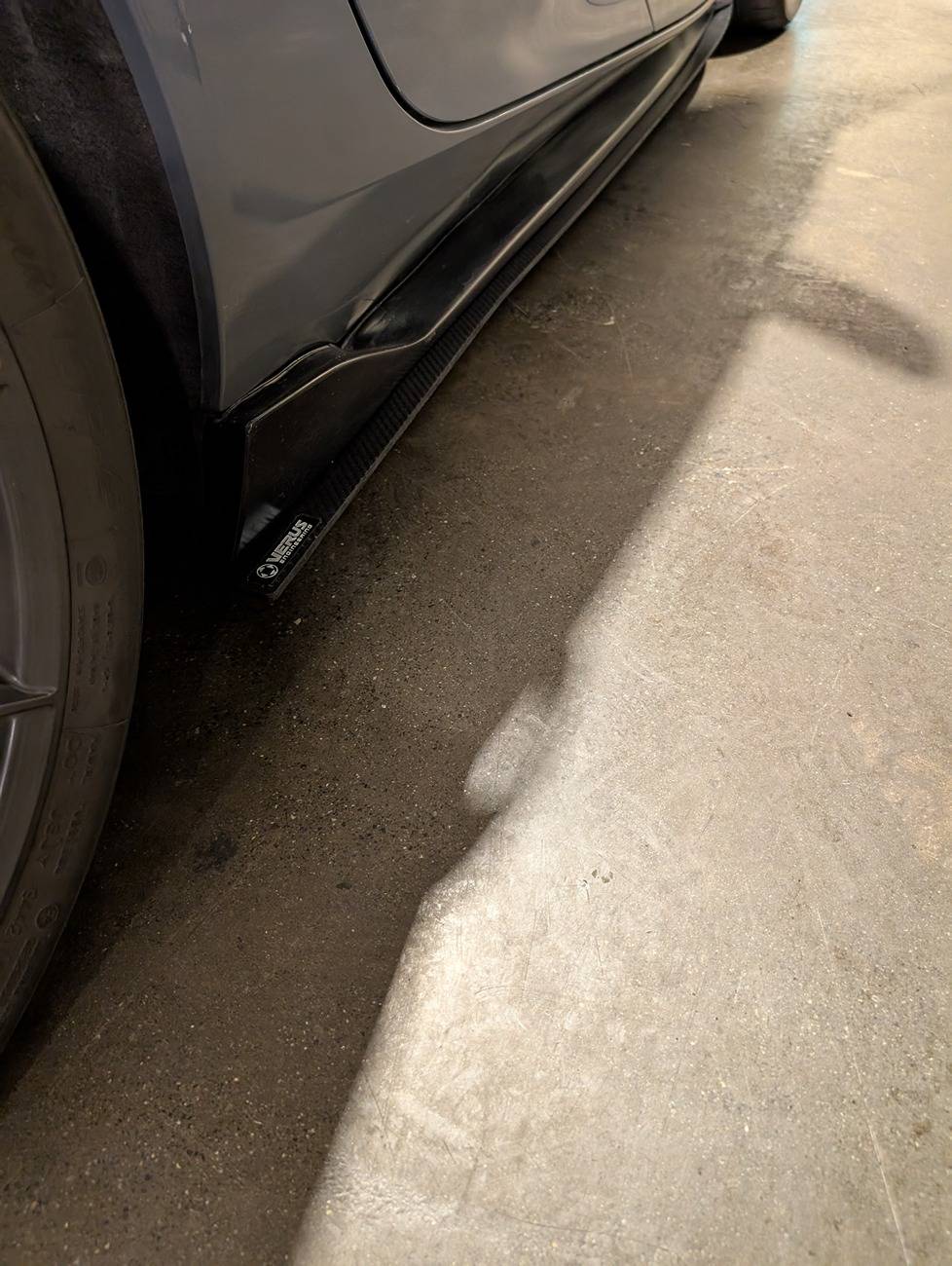

Verus side splitters. A little bit more subtle than i was expecting
leave me alone, i like it

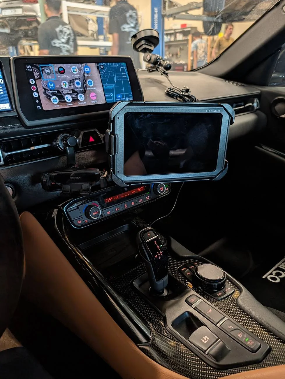

Ditched the windshield mount for the Catalyst for a proclip/ram combo setup. Thanks @razorlab. Zero play. Perfect angle.
One of the nicer cars in the shop that day

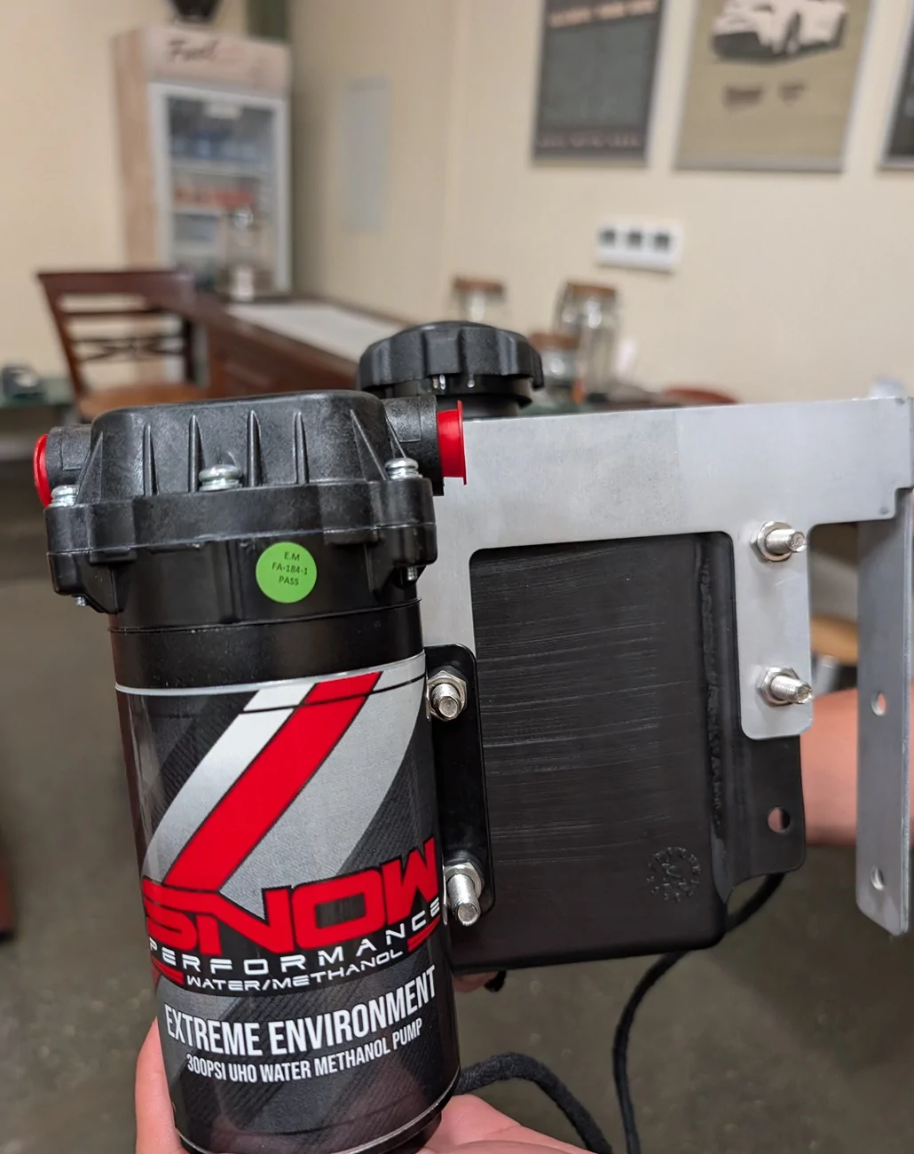

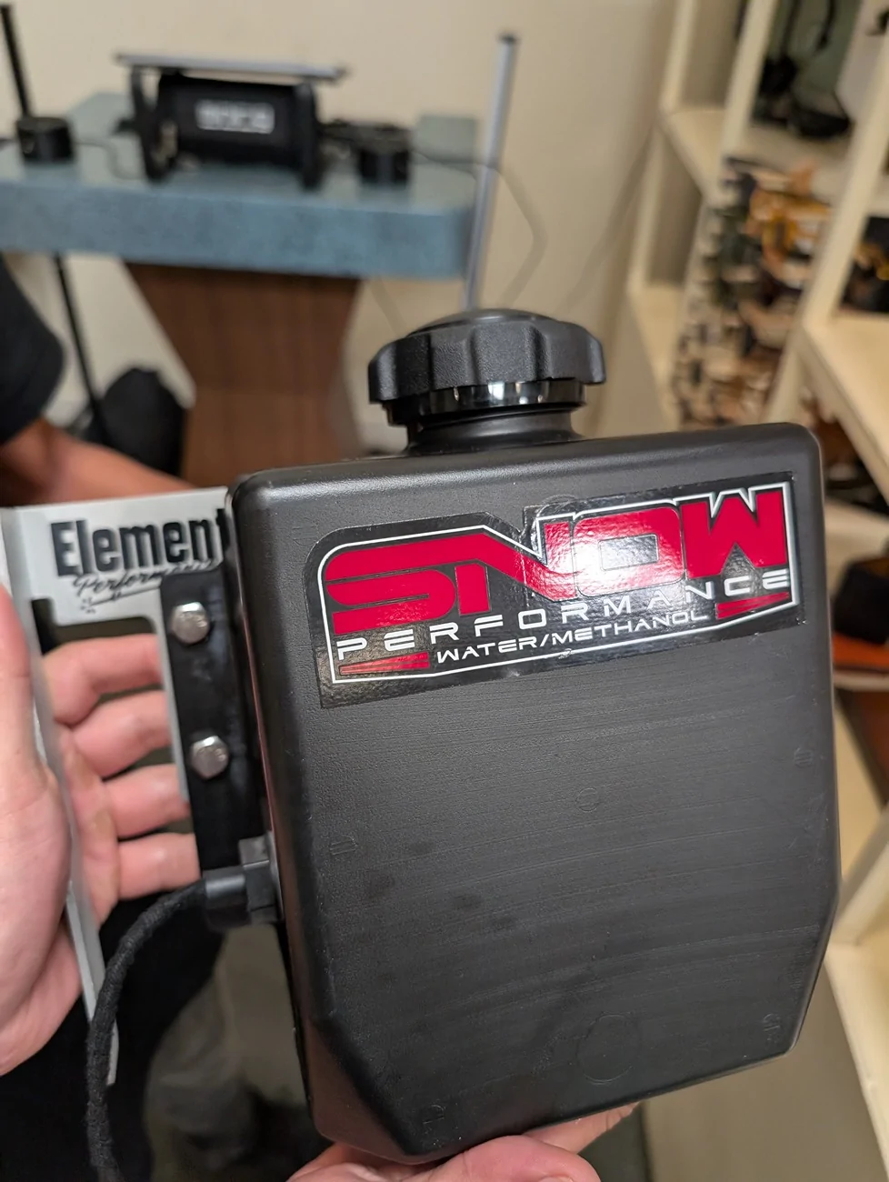

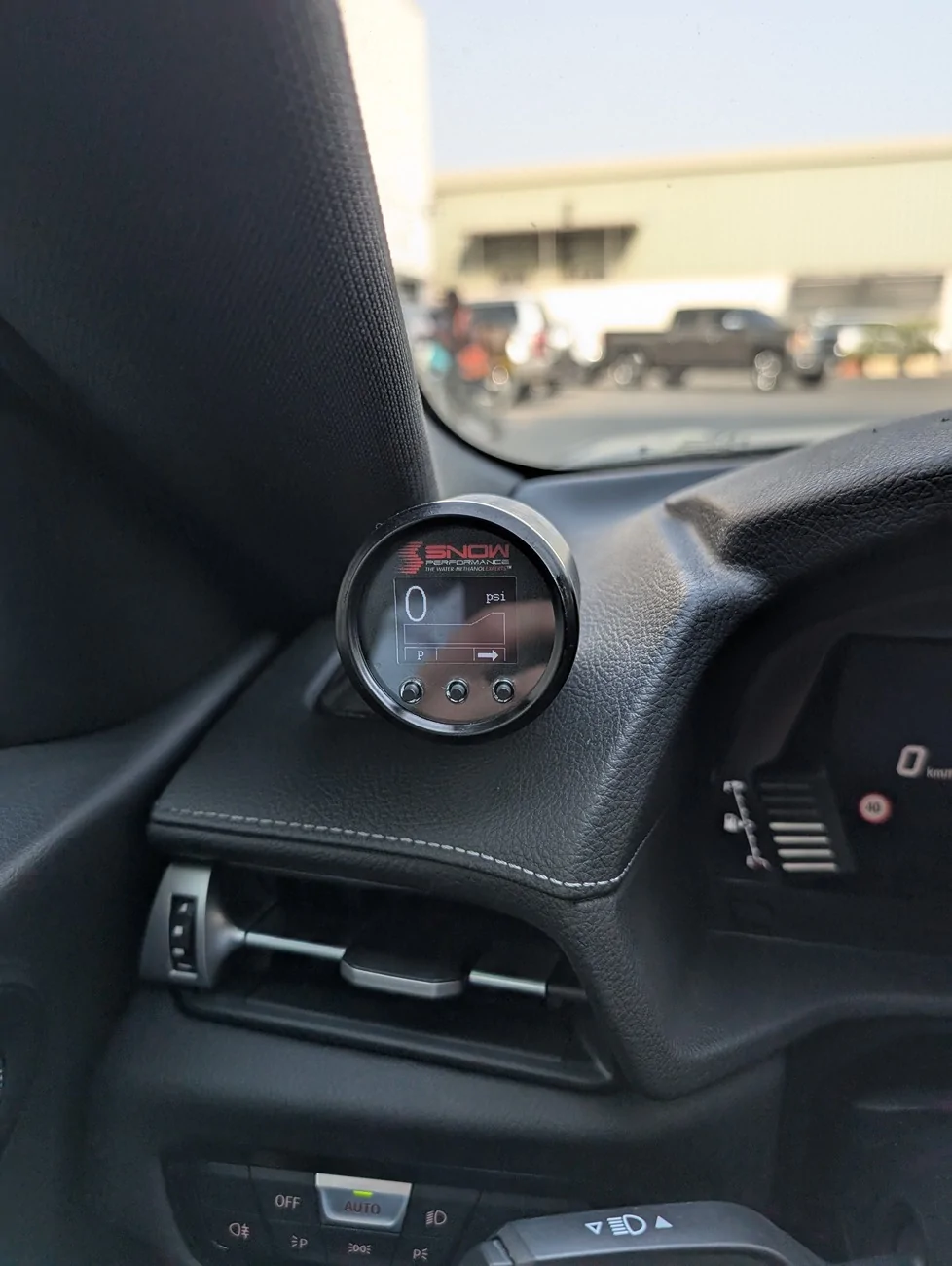

Snow Performance Stage 2.5 Methanol kit is now installed. Sameh tune pending
3D printed gauge pod by the shop looks great

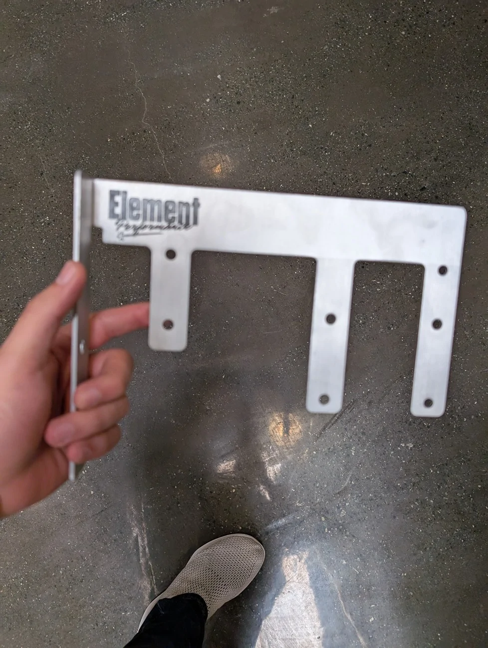

Another custom piece by the shop
