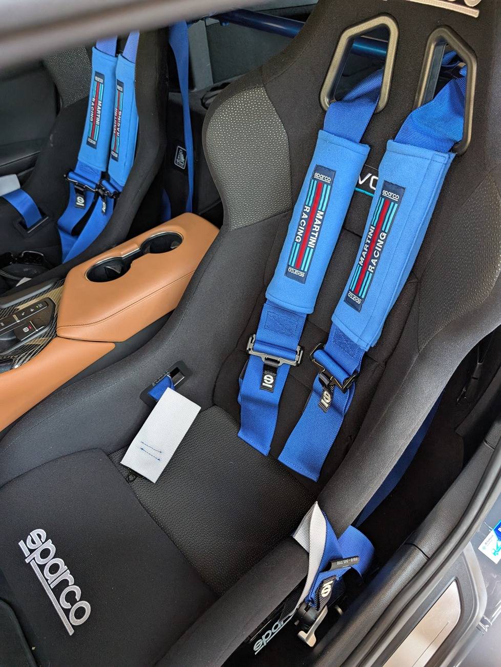

I know this is silly, but Martini Racing is my favorite livery ever. And shoulder pads make the harnesses so much more comfortable, so i'm actually quite happy with this purchase

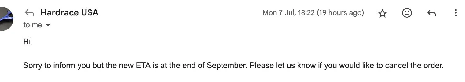

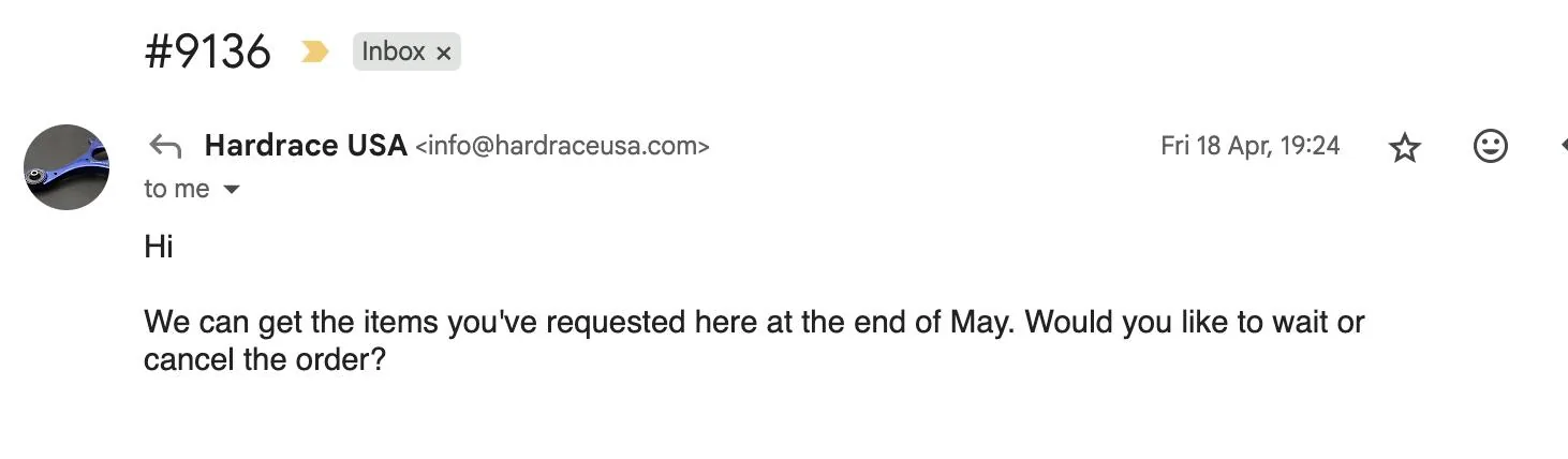

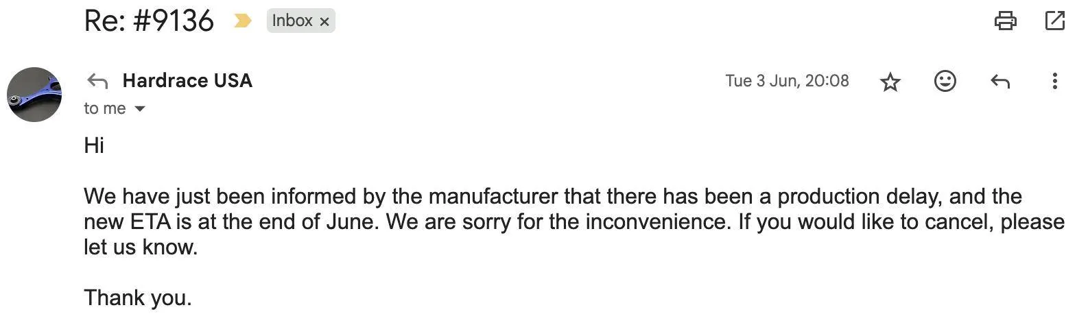

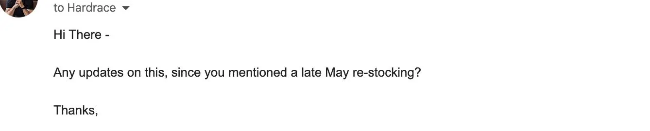

Tried to get those in December, after three months of them telling me the same thing about delays I cancelled the order. There are numerous other options.

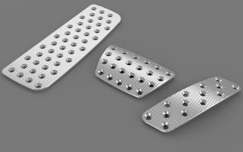

Ordered these billet aluminum pieces as well.
