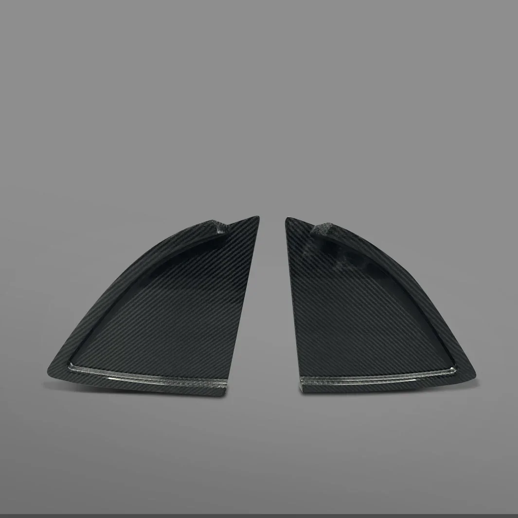

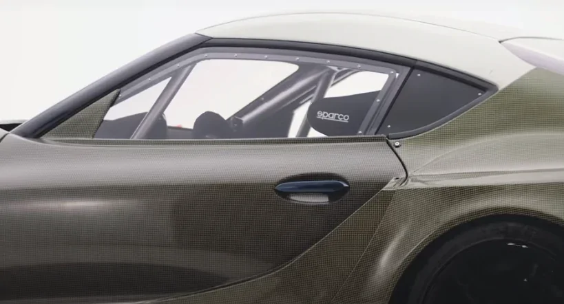

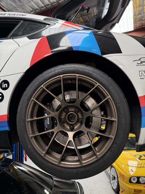

I'm in the same place as far as weight reduction goes. Lightweight battery (on the way), Alcons (fronts on the way, didn't even know they had a rear kit?), titanium exhaust, seats etc...struggling to find more places to remove proper weight....especially from the front.
I have some ideas though. The HGK CF roof saves about 15lbs, and from a relatively desirable area too. Not prohibitively expensive either.
Lexan is prohibited in my class, but i believe i can do something about the rear quarter windows. So i found these CF bits also from HGK. They weight less than 0.5lbs. Don't know how much they save though...
The car would be quite loud with the roof and these rear quarter parts.

I don't know if the rear is an off the shelf kit. My mechanics source Alcons from www.coore.com.au
I'm not going to get too focused on weight reduction, (although I have personally lost 14kgs in the last 6 months) it was just a nice surprise that the car was lighter than I expected.
