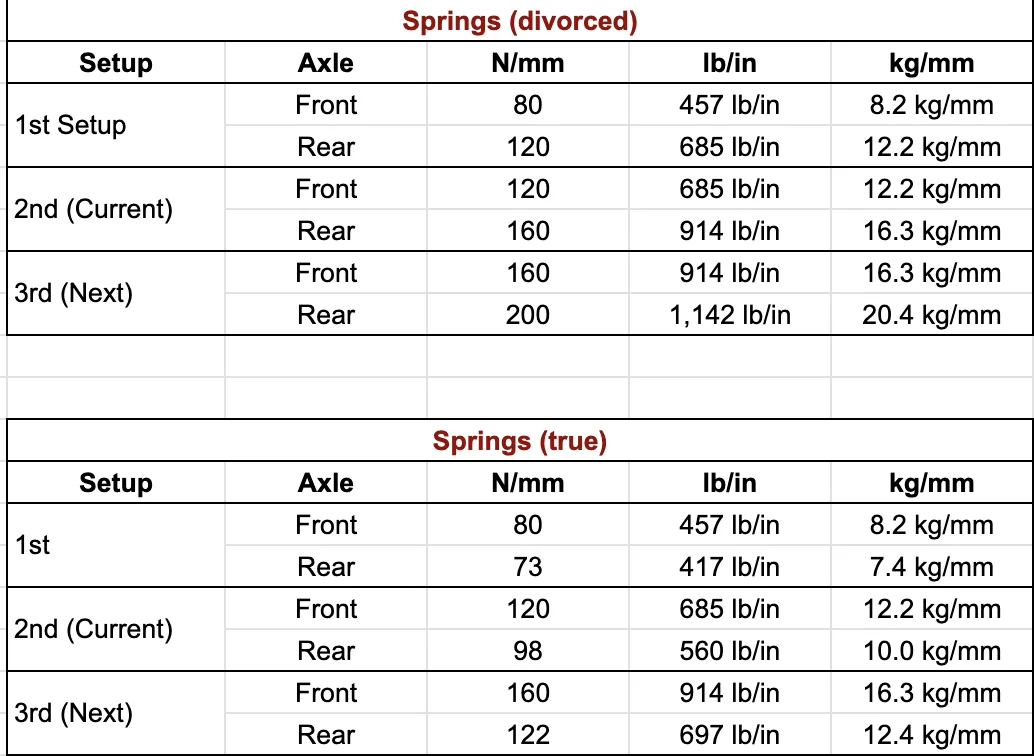

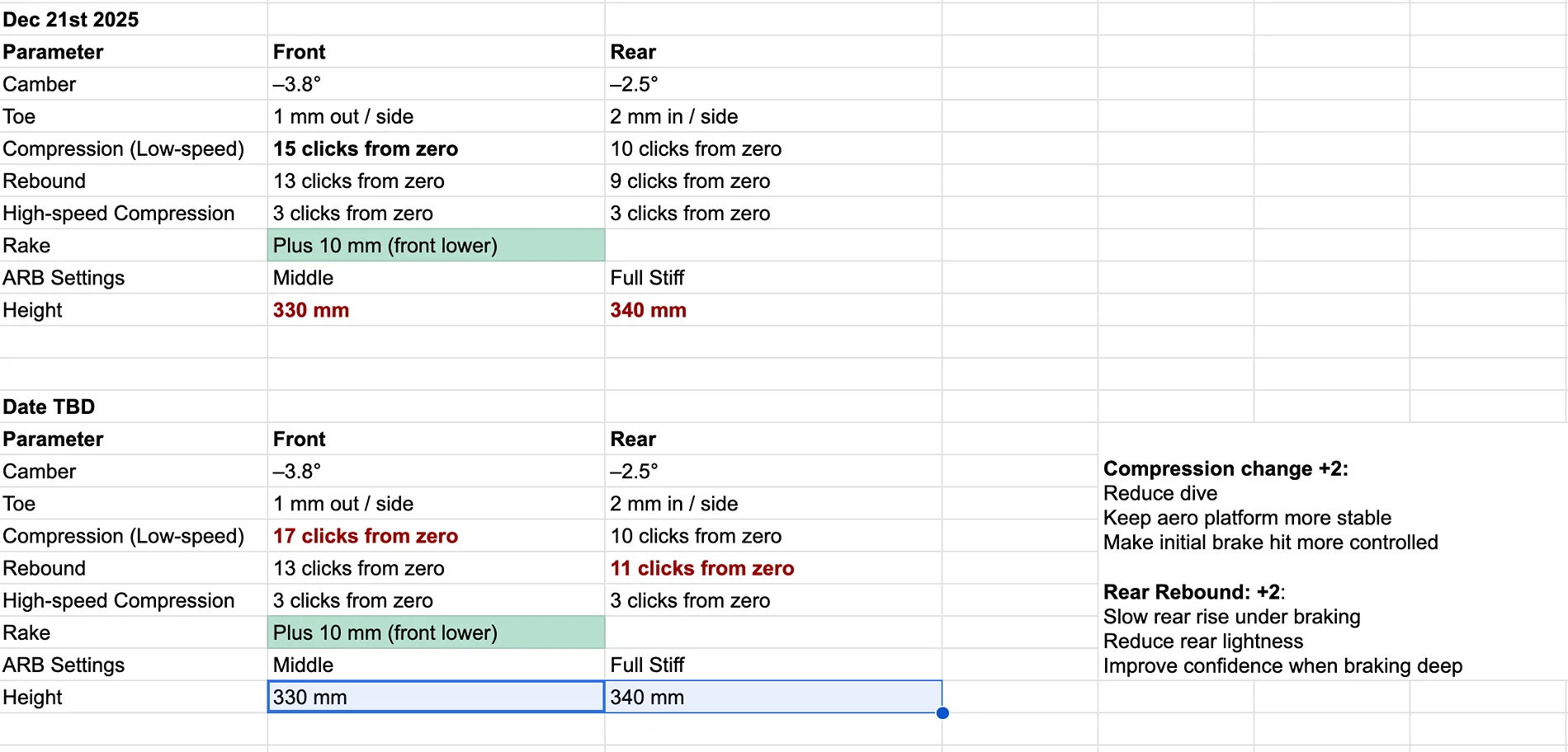

I think i'm leaving quite a bit of time on the table with braking. The braking setup is good, the winmax R7 pads are quite effective, although i'm not the biggest fan of their modulation. That's not the issue though of course.
I don't want to reduce front camber either. I'm not running too much front toe out either (1mm) for that be an area of optimization.
Here's my plan...i think

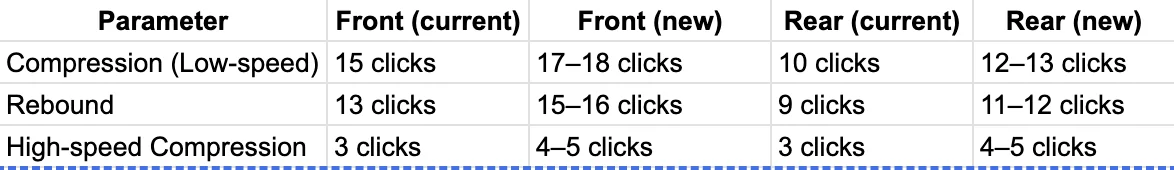

- I need even stiffer springs. I'm at 685 lb/in front and 913 lb/in rear currently. I believe the front end is diving a bit too much under heavy braking, taking the rears completely out of the equation when it comes to braking. That little help from the rears would surely make a difference. Thinking of moving to 913 lb/in front and 1,142 lb/in rear. Seems a bit high though when i look at the numbers, so i'm also wondering if should first try a midway point.
- Increase front compression +2 to reduce dive and make the initial braking a bit more reasonable.
- Increase rear rebound +2 to slow the rear rising under braking/reduce rear lightness.
This is how it's reflected in my suspension/alignment tracker. Top is the current one set in Dec and bottom is what i'm considering. Should probably add spring rates to this as this would be my 3rd change. In red is what is being changed from the previous setup.
Text on the right is so i keep track of why i made the changes.

I can't remember, are you true coilover rear or divorced spring? Because if you are divorced, your rates are basically 685f/538r.
Have you done the brake coding yet? That will add more rear braking force.
Divorced, so yeah the actual rates are diff
No i haven't. Tbh i've never done that before so i'm not sure how to. I'll try to look for instructions. Getting the rear brakes to do more work would be great.

Progression of my setup, including the incoming springs:

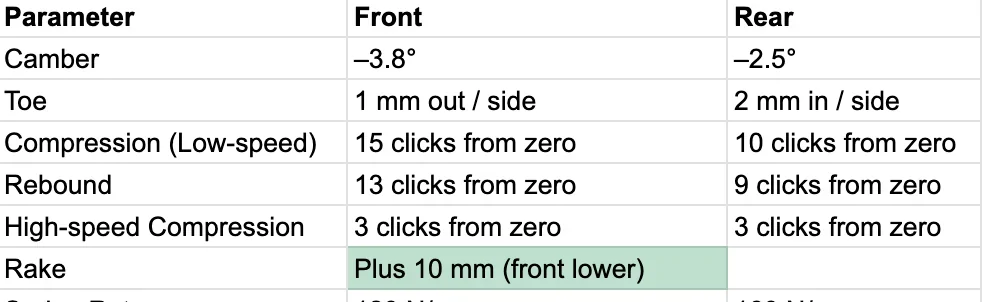

Can't help but think that this is going to be very stiff. These are my current settings:

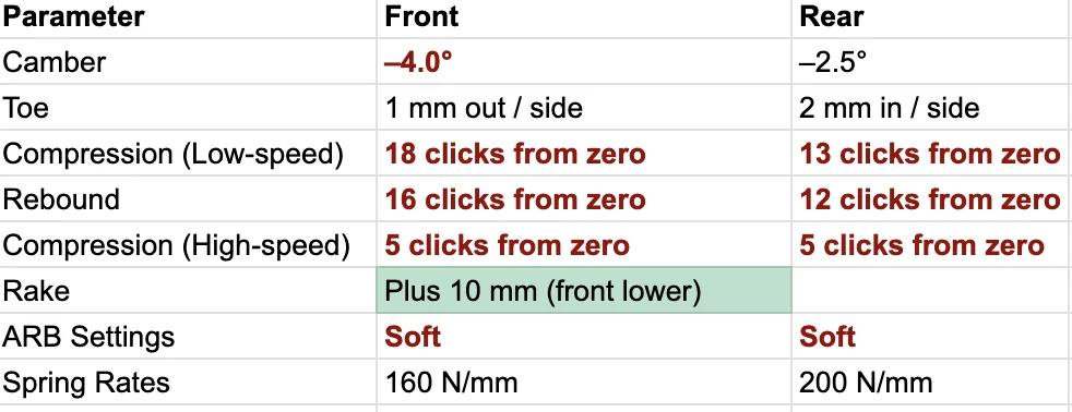

And here's what i'm considering doing to accommodate the much stiffer setup. Basically soften LSC, HSC and rebound. Will also soften both sways from middle to soft.
I'm also considering moving up from -3.8 front camber to -4.0, because the stiffer setup means i'm going to get less dynamic camber gain.
That's a lot of changes all at once, which I generally don't like doing. But it's a fairly big shift in rates. Am i 100% confident about any of this? Absolutely not. But it makes sense to me....
This is what my setup will look like basically. (bold red means it's changed since the last setup)
The front is strut, there is no dynamic camber gain. There is however, camber loss.
Derp. That's correct. Same conclusion though. MORE CAMBER.
Edit: will def be interested in seeing if i feel any difference there. If the camber still feels good, then i likely could've gotten away with more camber before the changes, since it's effectively going to be just that. So camber stays at 3.8 for now, thanks for that
