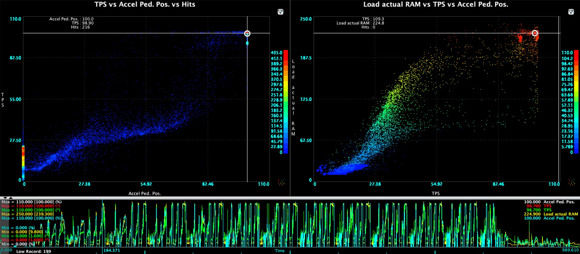

MegaLogViewer has great Scatter plot tools:
The data science nerd in me is def excited to check something like that out.

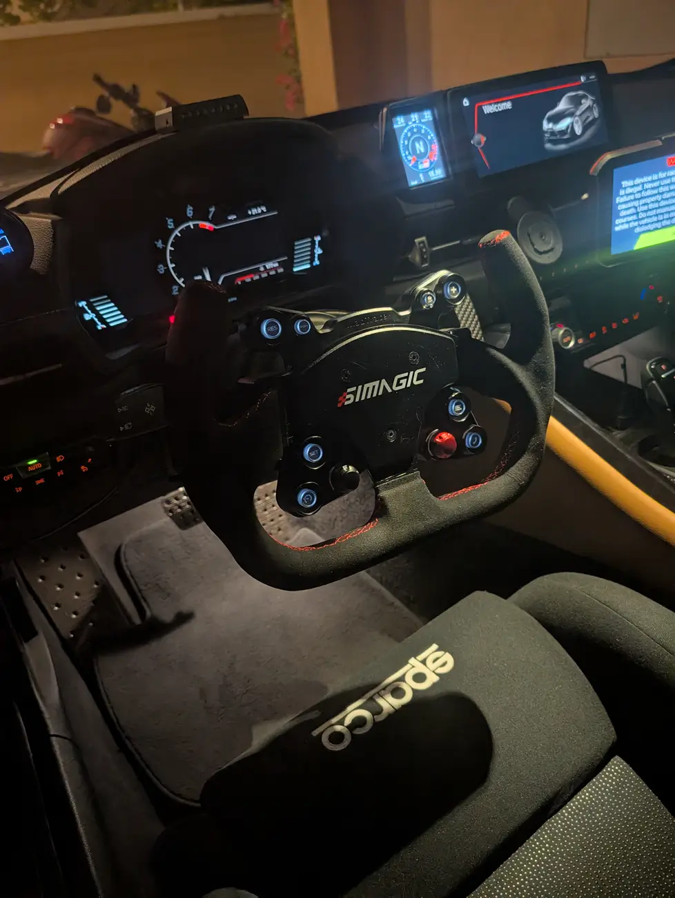

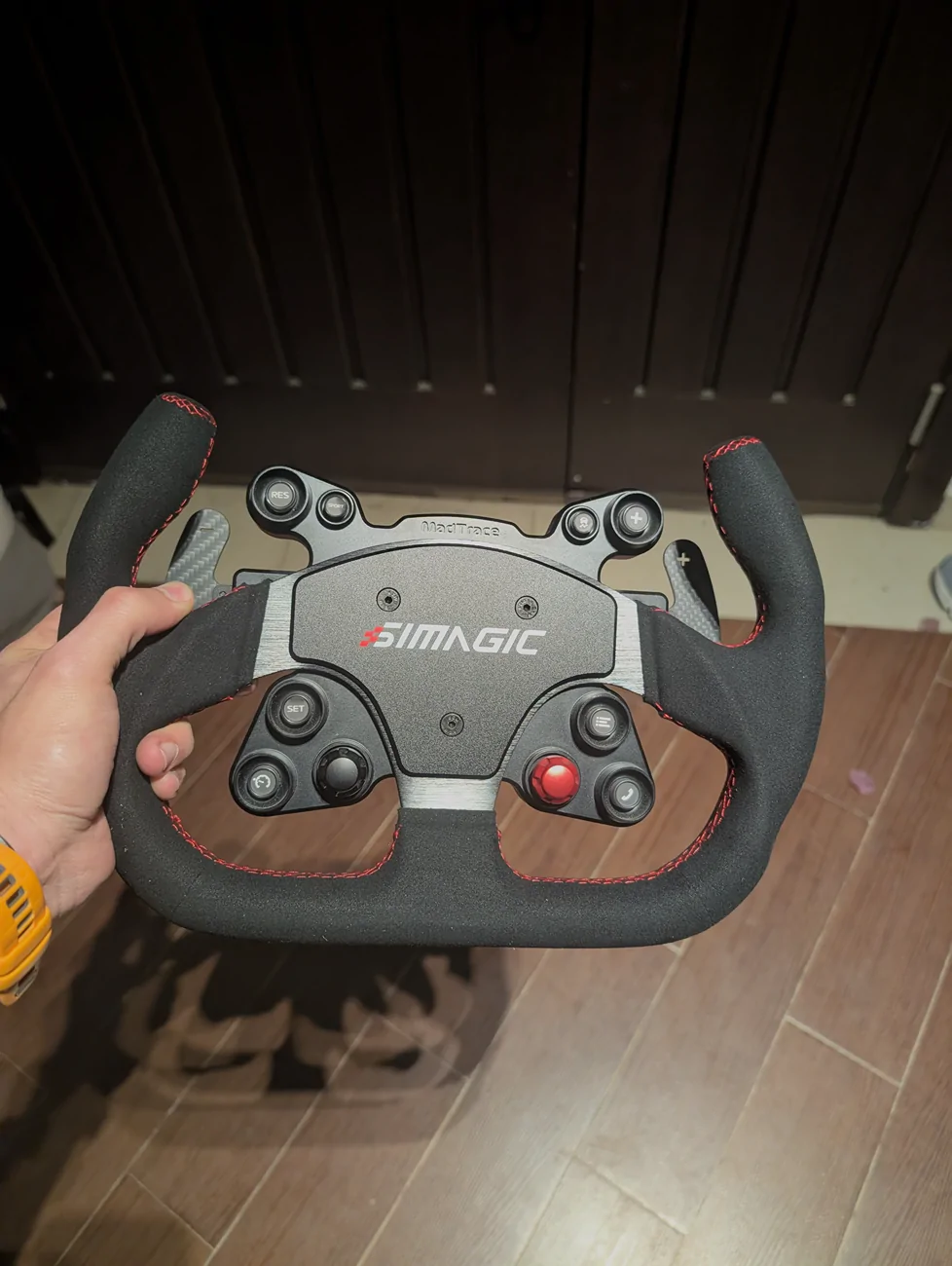

Sim wheel fits!

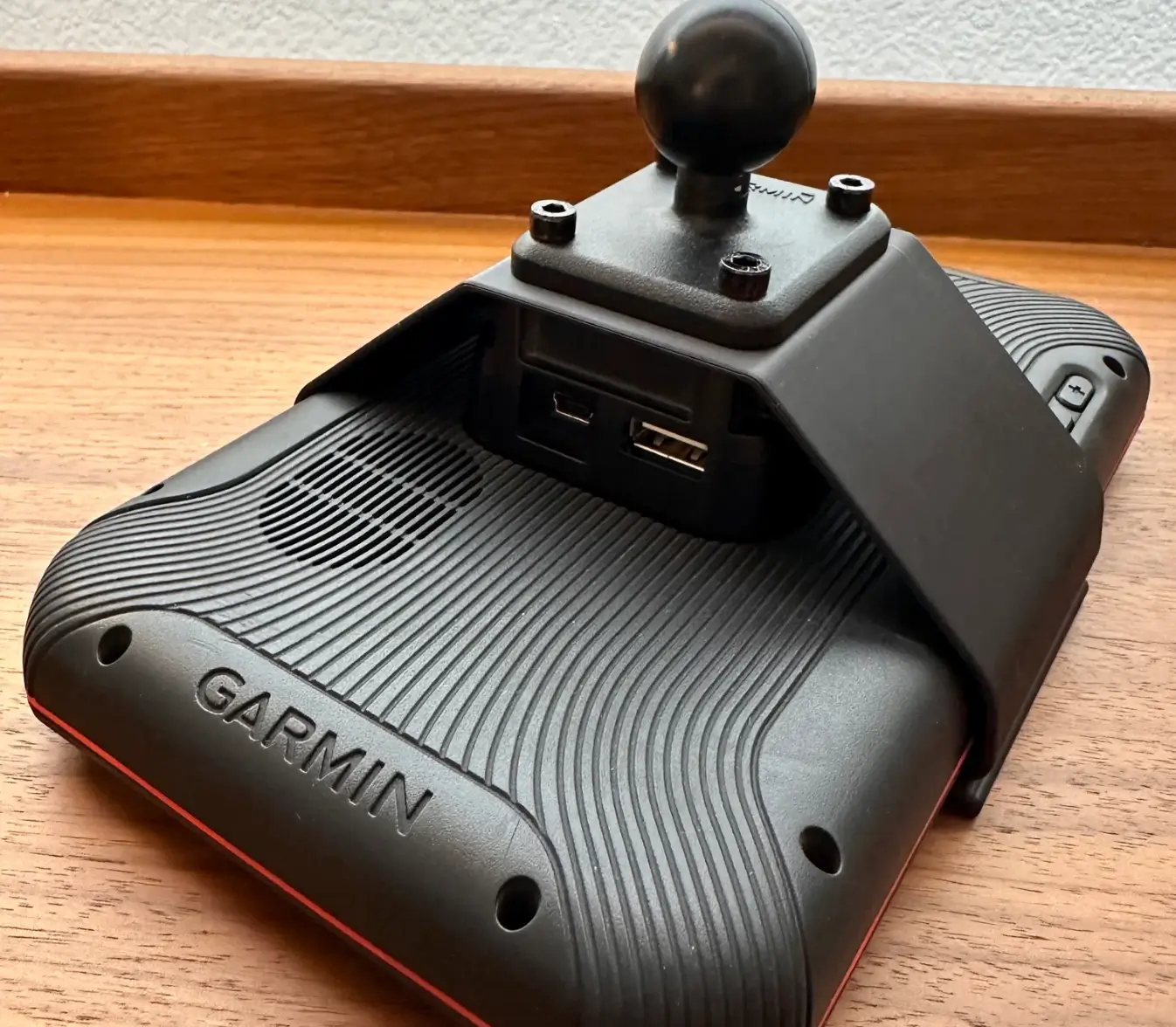

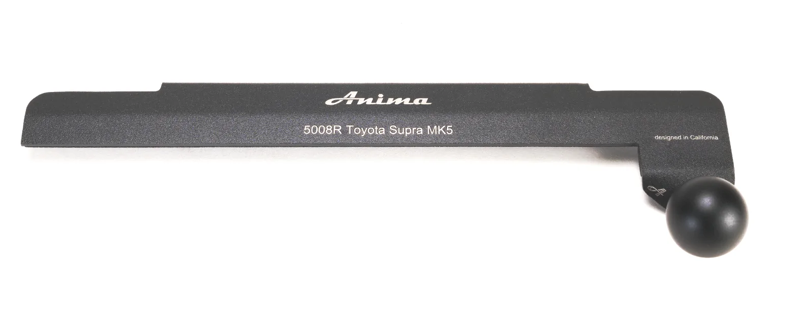

what are you using the hold the Garmin Catalyst, is it solid or is there some movement?
This fits under the infotainment screen. Just disappears, with the ball sticking out on the right side.
And the ball then connects to this mount that holds the catalyst
I've tried many different combos (i think 5 at this point), and this is by far the one i liked the most. Does it move? errr....a tad. Nothing really noticeable, and it won't fall off no matter how rough things get. It also sits fairly flush, even though you can still control the angle.
When you take the catalyst off, the magnetic charger (and hence cables) stays connected to the mount since it's screwed in, so there's no need to ever disconnect the cables. I've had to do that with a couple of the mounts i tried and it was really annoying.
https://animamotorsports.com/Anima-1-Ball-Base-Mount-RIGHT-side-for-Toyota-Supra-MK5-A90_p_51.html

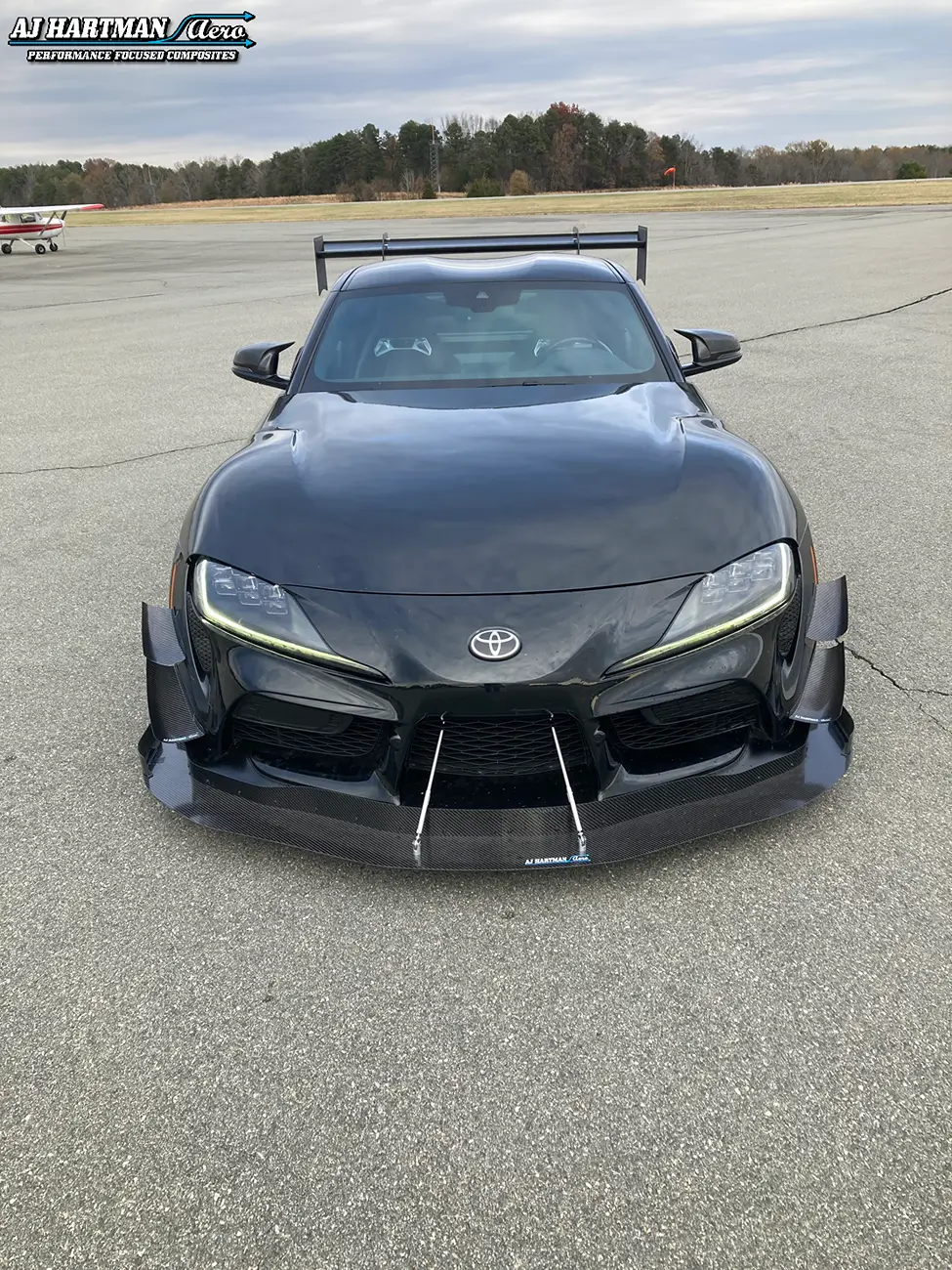

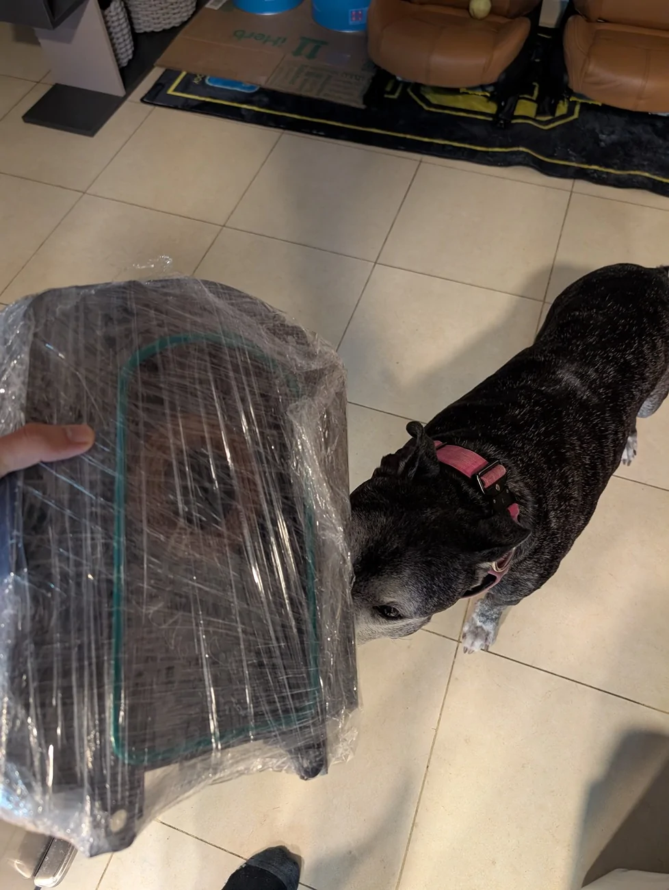

Once that's done, the rear vents (cutout behind the rear wheels to extract air) will go on. Also have some new canards on the way as one of mine got chipped during the earlier splitter incident. Rather than replacing them with another set of APRs, i got the big boy canards from AJ Hartman on the way. Pic below

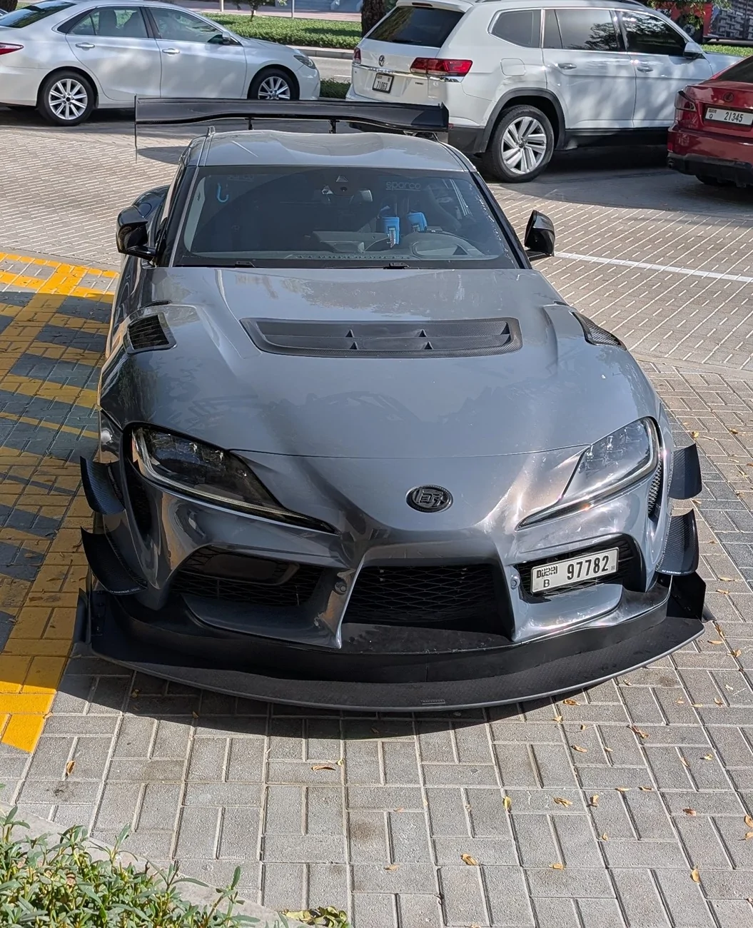

Looks...familiar lol
dude, that pic is nicer than any of the ones on the AJ Hartman website. wtf. Got any more? That looks really nice.
Edit: i think that's the smaller Fulcrum 12 though not the 14. I could be mistaken of course

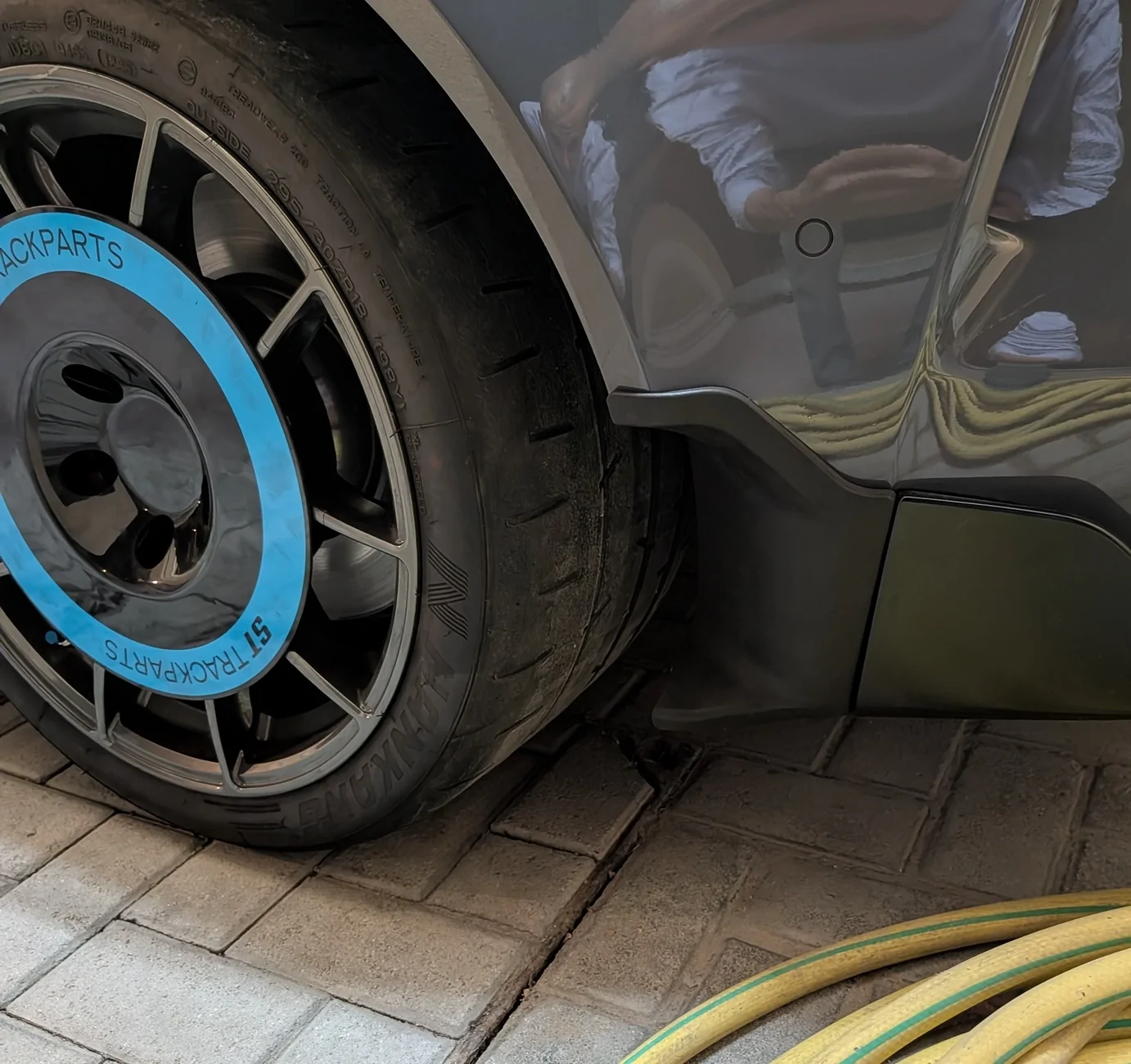

- Speed Engineering rear vents done

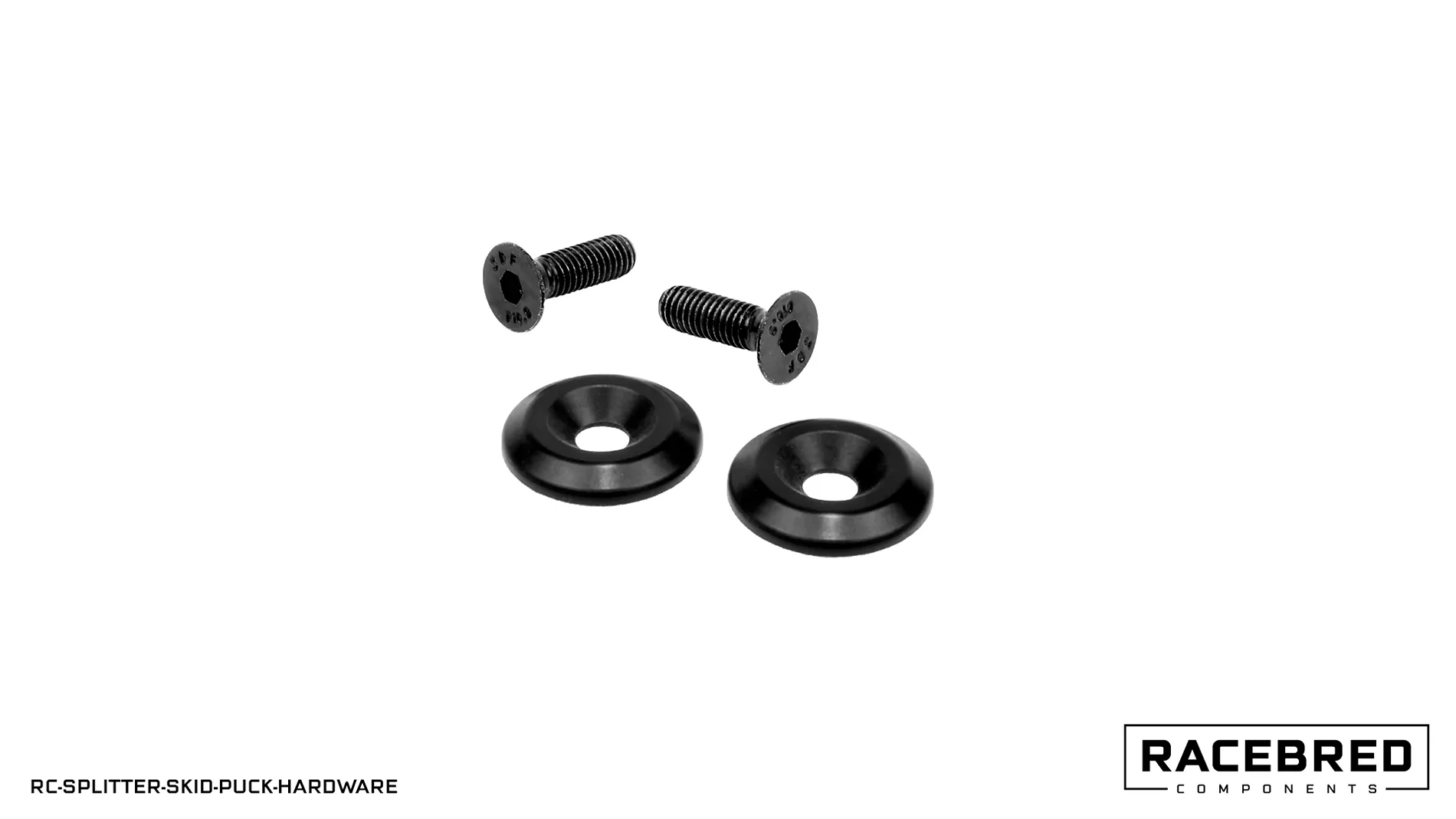

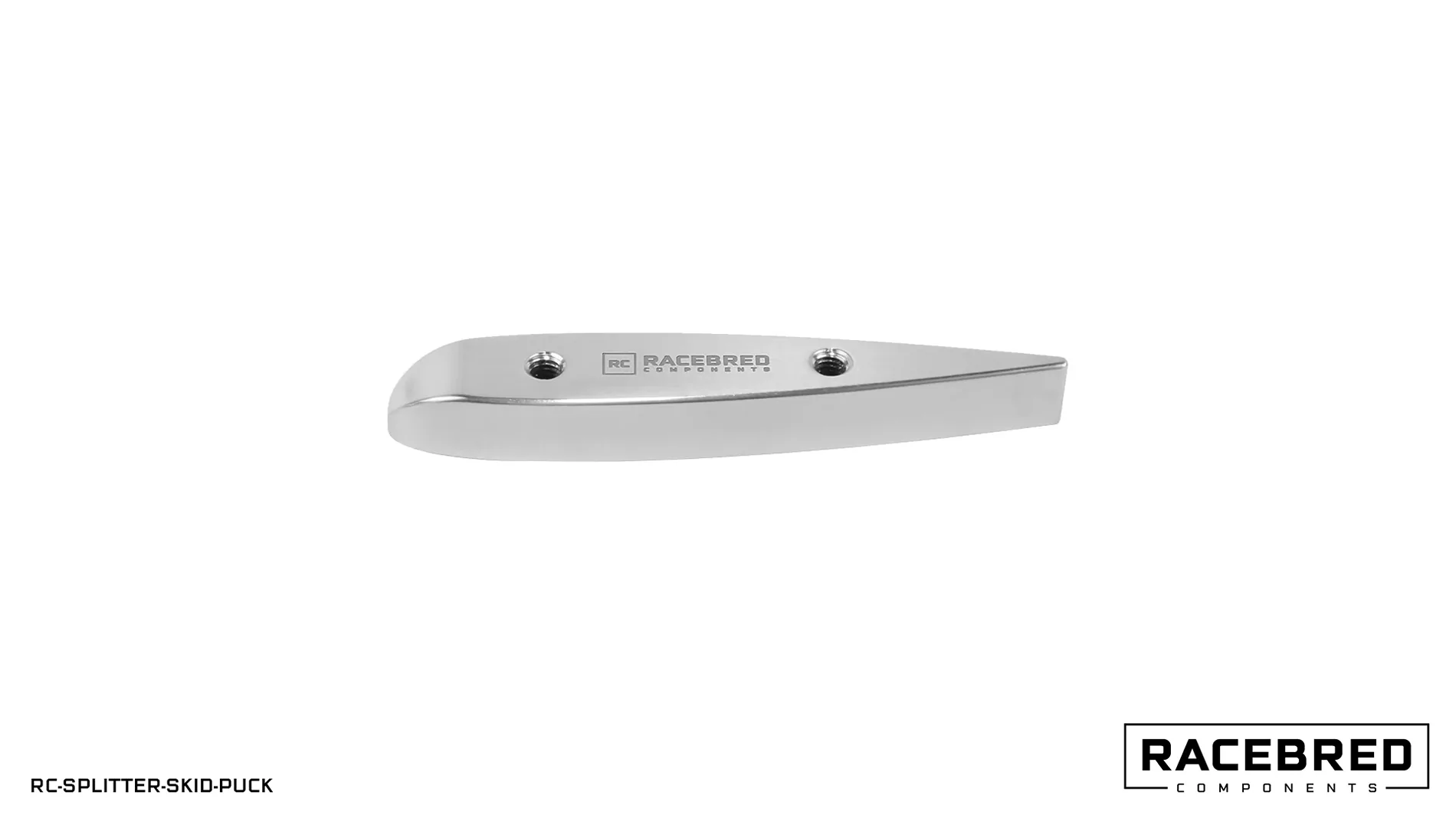

Picked up some Racebred skid blocks. Hopefully they arrive before the next race on the 22nd. unlikely though. Really like them. Nicely designed to minimize catching. I also like the fact that the hardware they included is black.... which matters to me a bit more than i'd like to admit.

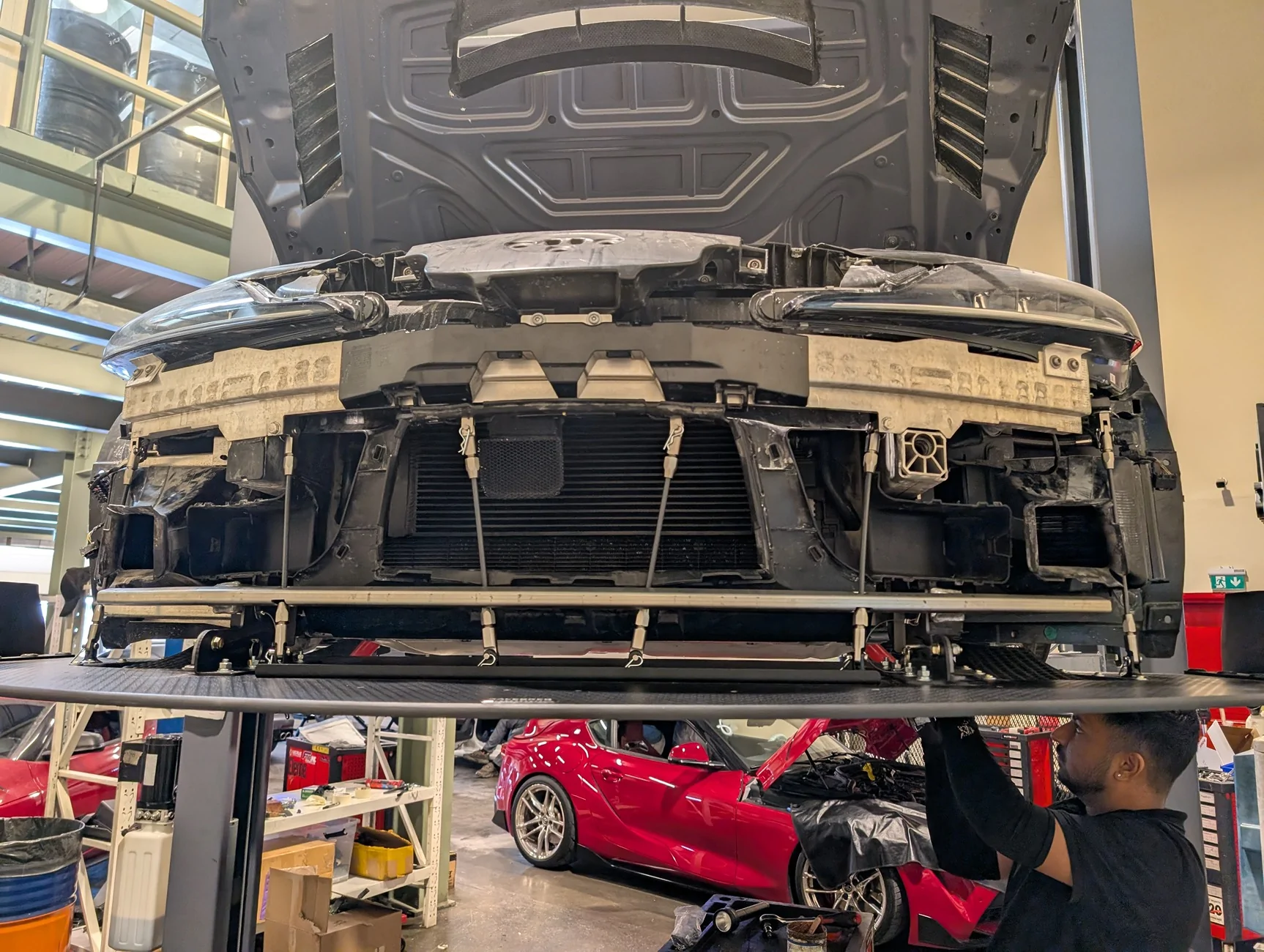

splitter rod placement is good, splitter rod to crash bar mounting are bad. especially the 2nd from ouside ones. those will rip off after a few events. use 1/8th thick 6/7 series aluminum plates to sandwich all bolt points front and back, top and bottom if you want them to last.
And here i was happy with my 6 rods. NOT ENOUGH HARDWARE. Never thought it would be this hard to get something that seemingly simple right

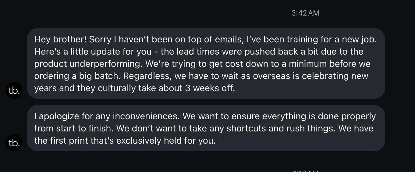

Decided to reach out to the trackbuilt guys on Instagram since they're active there and haven't responded to my earlier email
Looks like this isn't going to happen anytime soon. Me thinks they should've had all that sorted out before taking pre-orders.

just speaking from experience. i ripped off that exact little nub.
I appreciate the advice. That's why i have this build thread, in hopes that people can chime in and share some advice

Subwoofers out. Each one weighs about 2kg / 4.4lbs.
New canards on
