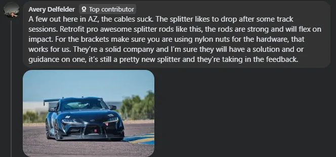

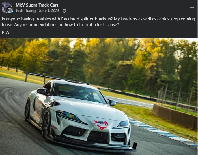

Yeah, between myself, mike from bossboss, traxion, a whole bunch of guys on FB, and now TBK having a catastrophic failure of his splitter, I am withdrawing my recommendation of racebred until they revise their design to get rid of the cables.
tsaulsbu
Tim
Feb 16, 2025
2021 GR Supra, 2008 6266 335i
What would you get instead with what you now know? I was leaning racebred and using pro awesome in lieu of the cables.
OP, what do you plan to replace the racebred with?
