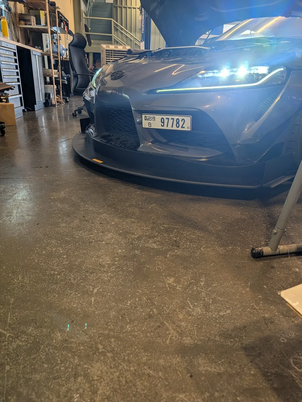

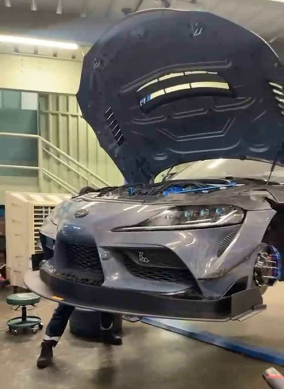

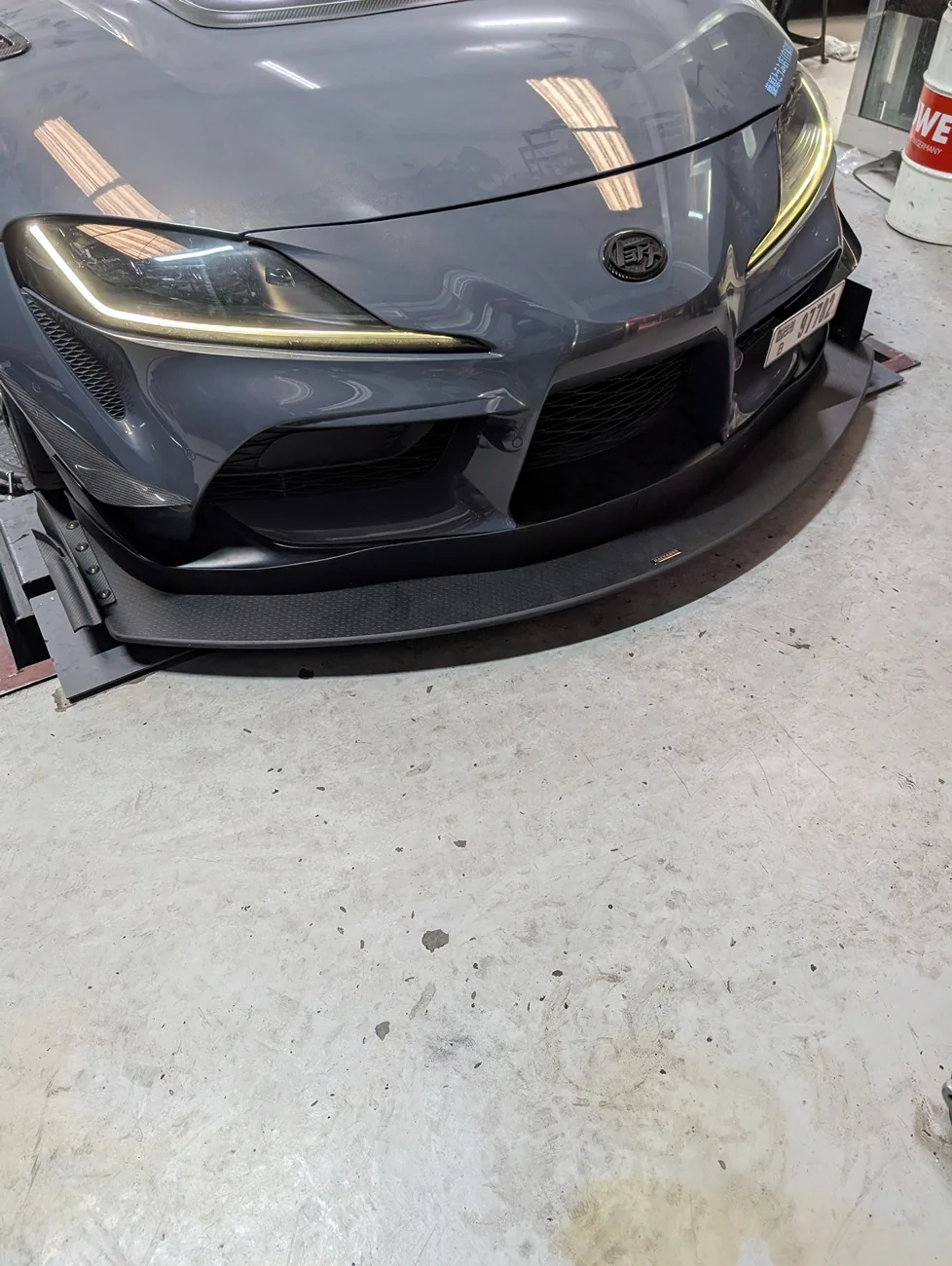

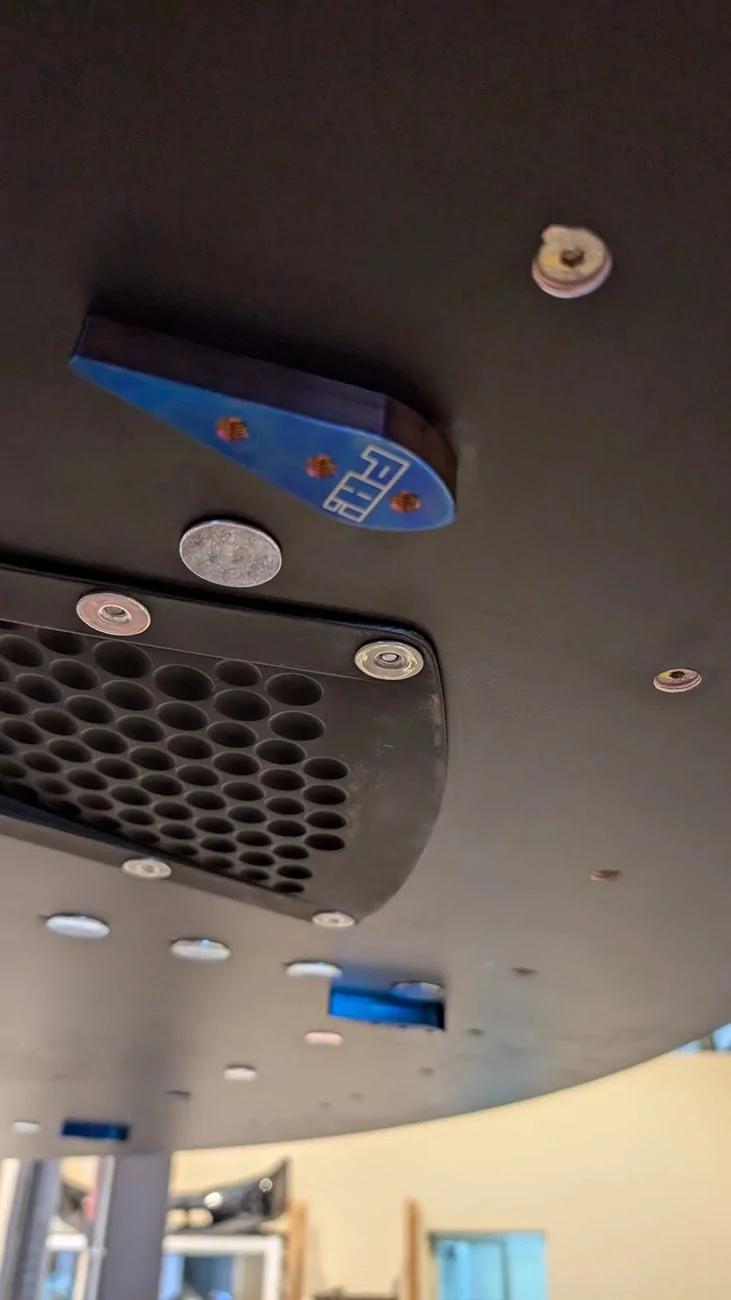

Racebred splitter + tunnels + cf endplates installed. Excuse the potato pic, it's actually a screenshot from a vid the shop sent me.

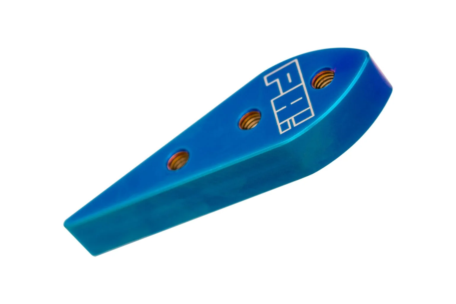

4 of these titanium blocks also installed
Think we figured out what to do with the tow strap. I'm going to unscrew the front plate and use it at the track (as i should be doing anyway....). Since the tow strap doesn't have a shaft, going to pick up one of these afe tow hooks and use the shaft/bolt.

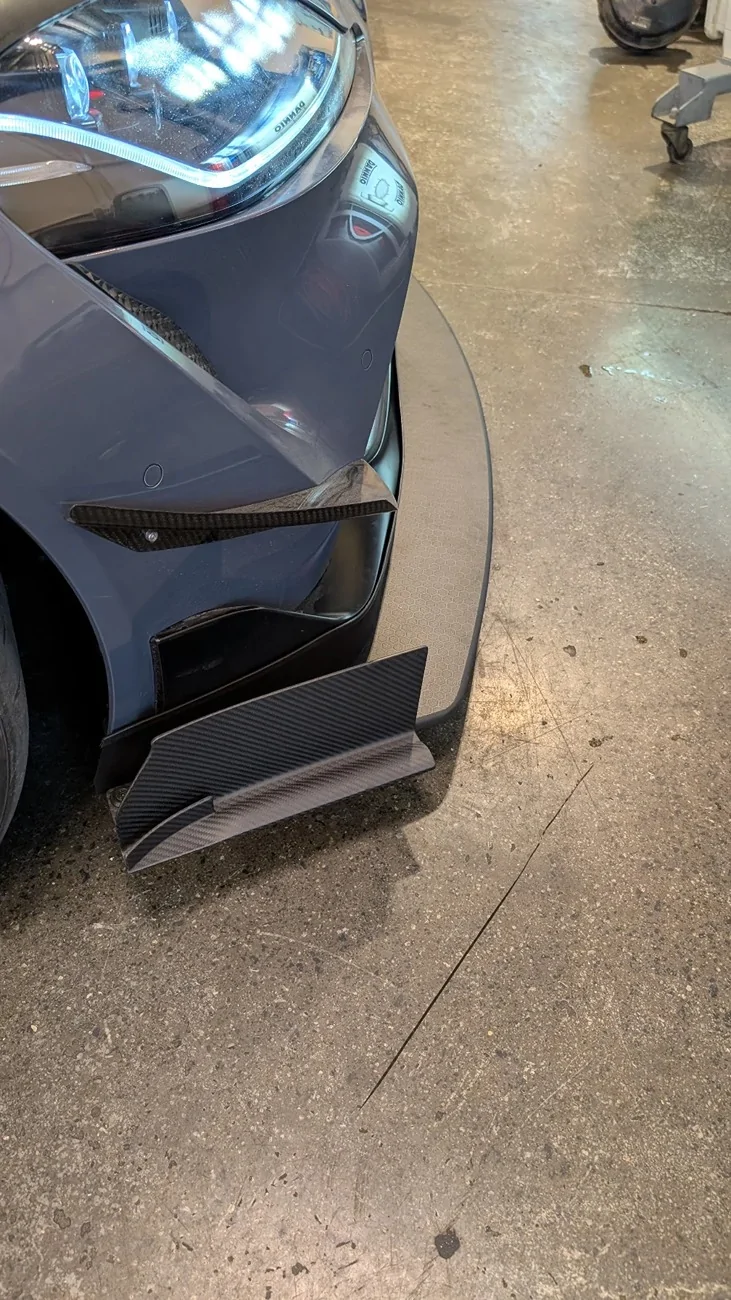

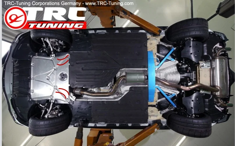

Lastly, the other 2 underbody strakes arrived, so i have all 4 now. 2 for each side. Need to figure out the exact placement. They're about a foot long each.
I think this placement here where i drew the red lines would probably be best. not sure if there's any downside to drilling into that aluminum plate though so i car screw them in.

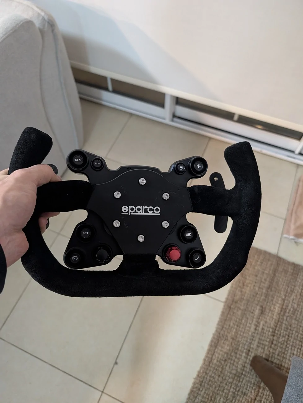

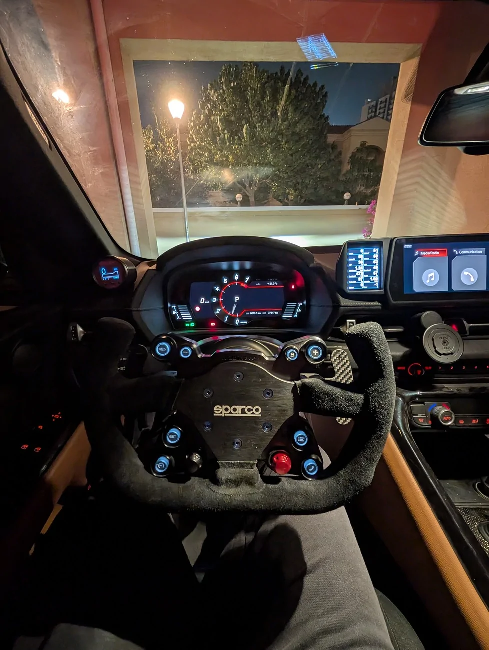

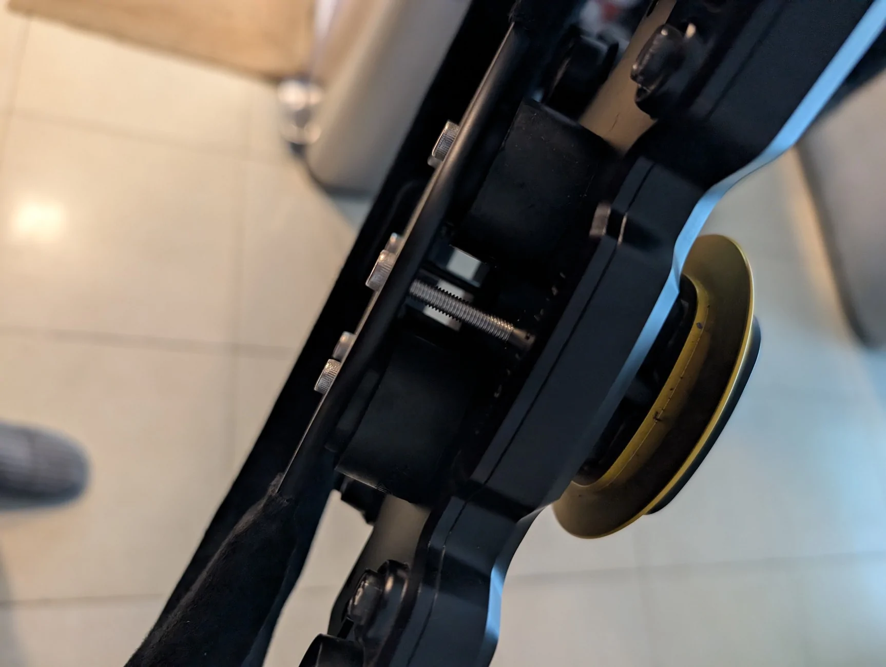

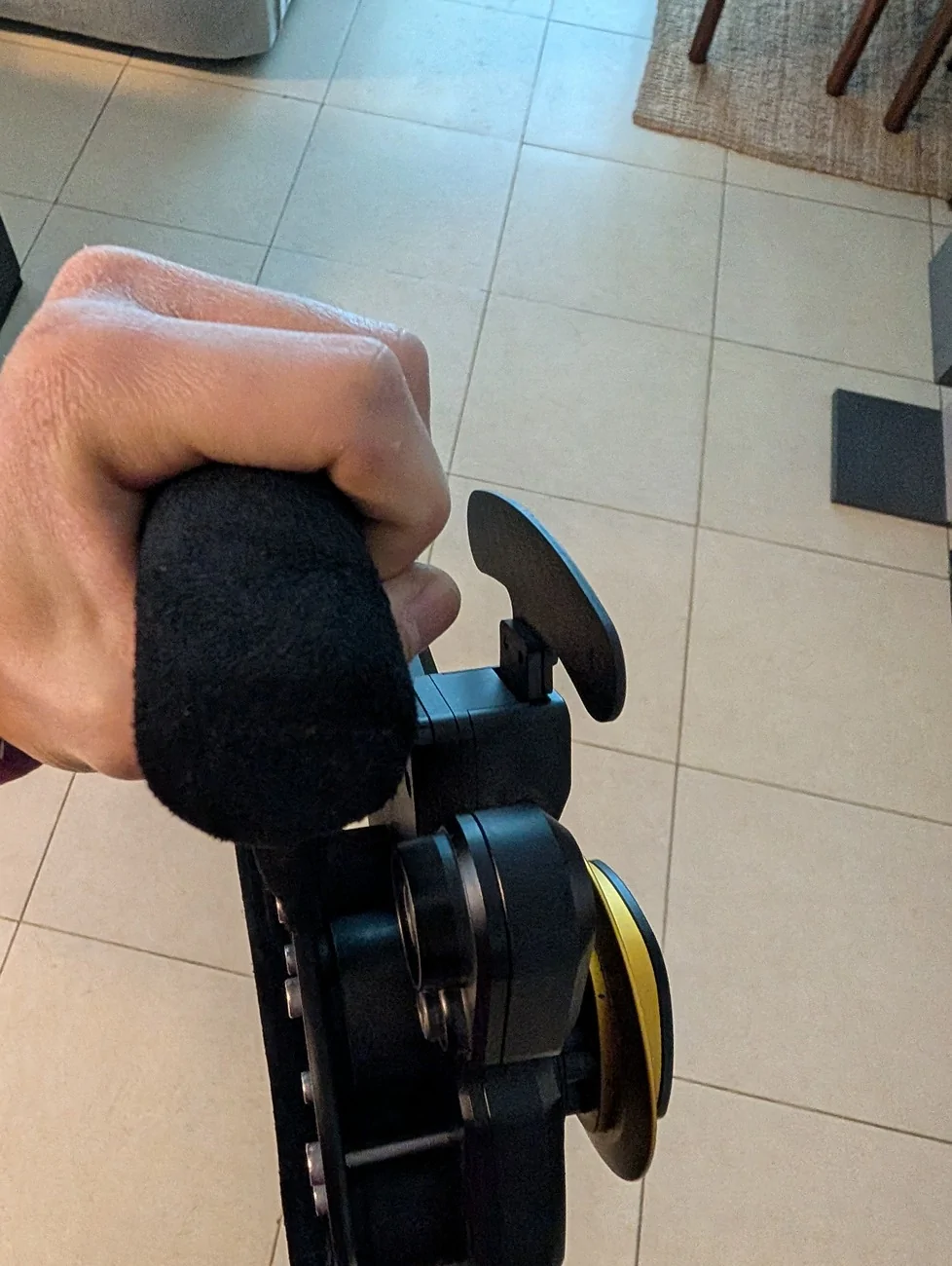

Steering wheel didn't really work. The wheel is so small (310mm), so you can see the bottom part rubbing on the button housing. That's....fine i guess. But then the paddles are too close to my hands when they're gripping the wheel. There's barely any clearance there.
I'm still going to try to make it work. i've ordered different sized spacers, and longer bolts. The one's i currently use are m5x30mm and baaaarely reach. Trying 45mm and 50mm.
If that still doesn't work, i do have a plan B. kInda. I think. Have this sim wheel on order and should be here in like a week. Unfortunately not in time for the race this weekend, but that's fine. It's 330mm wide, so the same as my current wheel. Not 100% about fitment, but i know the pcd is correct.
I'm also going to raise the car a bit tomorrow before the Saturday race. The new splitter just sits waaaay too low. Drove the car to work today, something i never do. Instant regret. Splitter scrapes everywhere. So does the rest of the car actually. So will jack it up by like 10mm.

Raised the damn thing by 10mm initially and still looked too low to clear anything on the street, so up it went by another 15mm. Better. Still scrapes here and there, but nothing like before
Put these 35mm spacers between the wheel and the hub
Now have clearance between my hands and the paddles
Got to try it today, and oh man. This is it. I was worried a 310mm wheel would feel small, but for whatever reason this just felt fantastic to use. Not an ideal street wheel for obvious reasons, but this is going to feel great at the track
