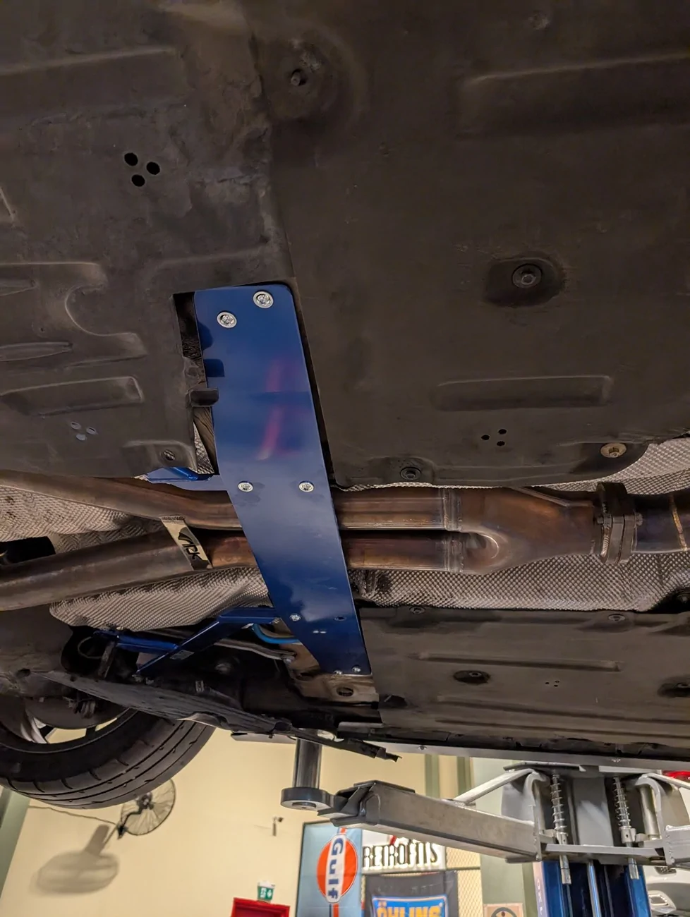

At the shop today (if you're in the UAE, Element Performance ftw)
Cusco brace on

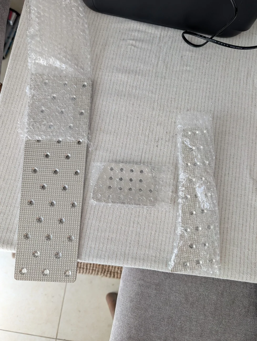

Billet aluminum pedals

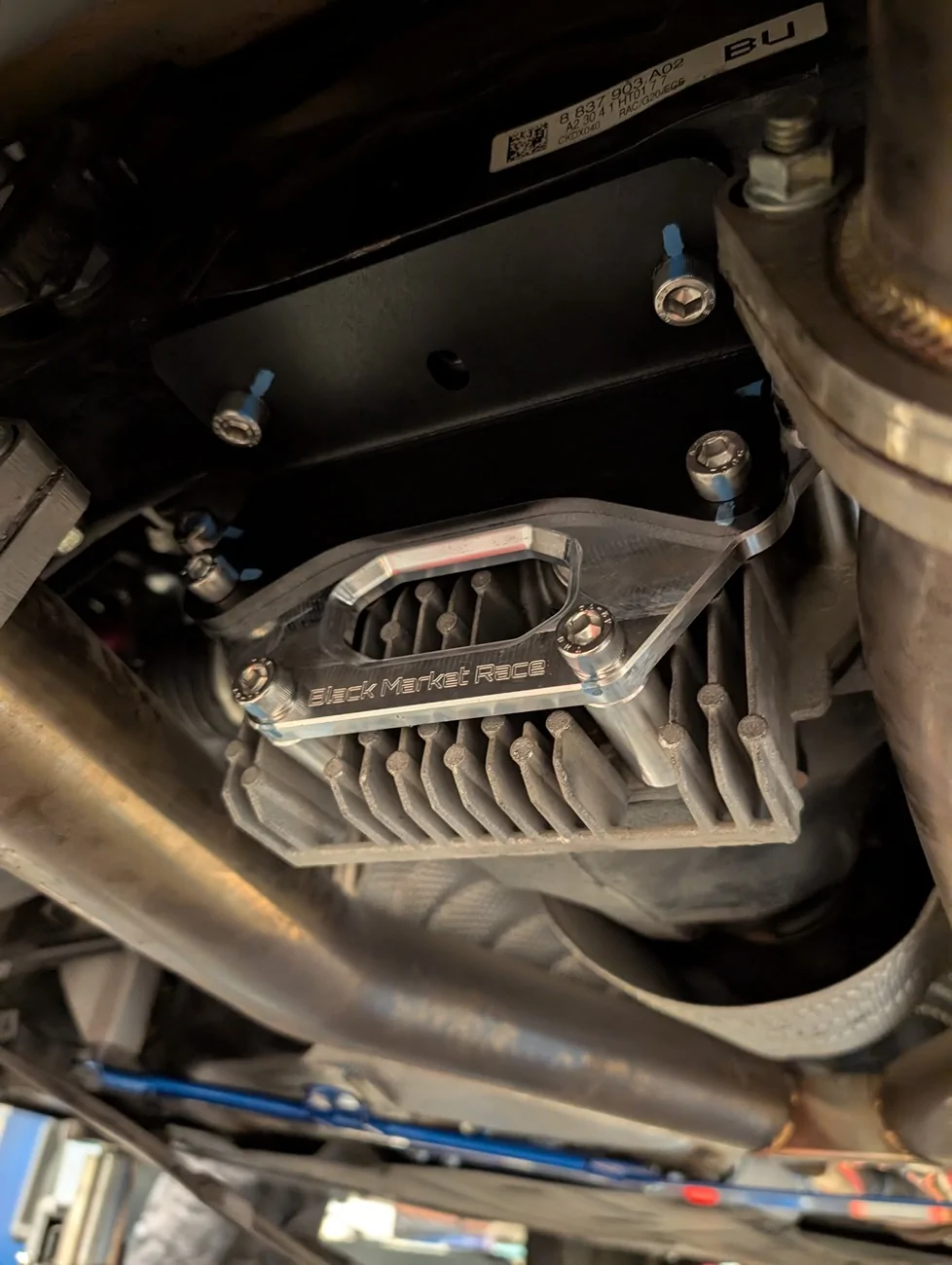

rear diff brace
if you shave off a bit of the sides you can use the Verus diff cooling plate with this brace

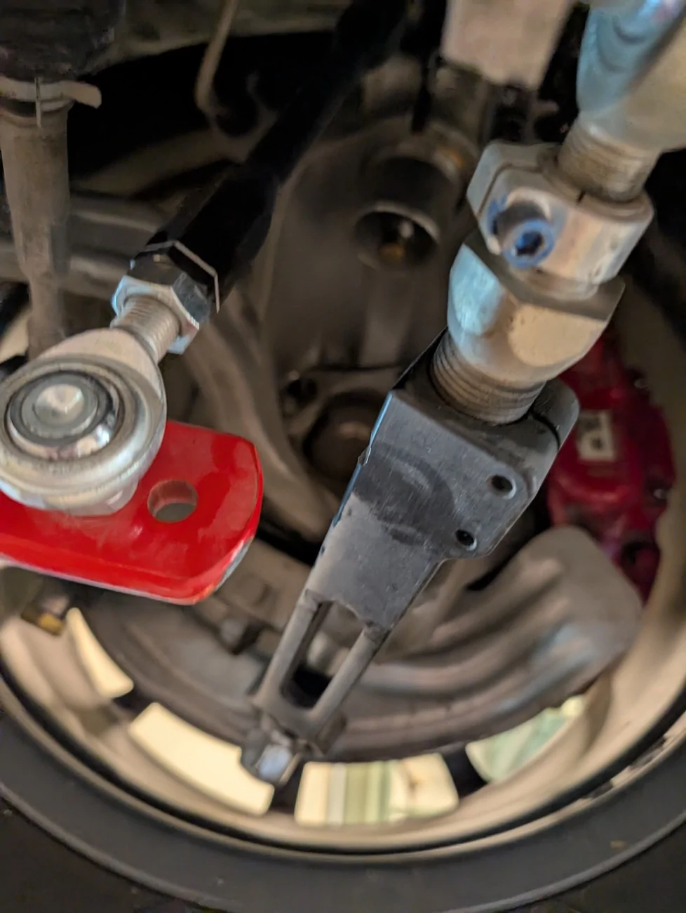

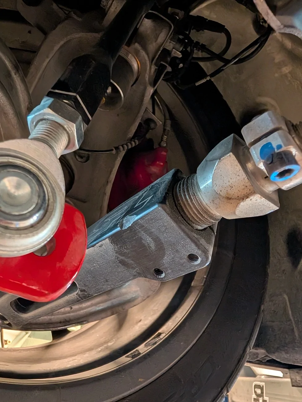

So this is.....a thing
Even though there seems to a lot of clearance, the Eibach sway bar has carved a bit out of the SPL LCA.
The sway bar is on the medium setting, so I'm assuming it would've been worse if it was on the hard setting, with the butt of the sway pushed out more towards the LCA.
I don't know if this was a 1 time thing or if it happens frequently

Common. My stock sway bar / endlinks hit my SPL arms.
I guess that's a bit comforting. Are we not worried about something breaking here? Marked the LCA chipped area in blue to keep track and see if it gets worse
tf is going to happen if i set the front sway to hard. would get even worse

Yes, all the track guys already know about this. Some people cut off the end of the ears to gain clearance.
The Verkline LCA's have way more clearance than my SPL arms did.
You can try to not go full lock or get rack limiters if it really bothers you.

Thanks
Doesn't really bother me tbh, as long as it's just superficial damage.
And yeah did also think of shaving off the butt of the sway bar. Glad to know it's not an original (read: likely silly) idea. Might end up doing that.

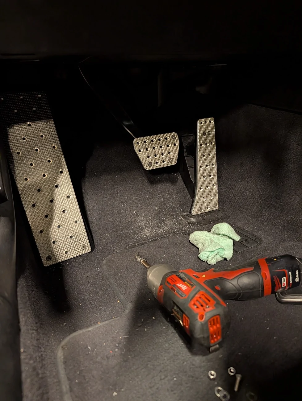

Thought i'd share an update on the billet aluminum pedals now that they've been on for a week or so.
There's absolutely nothing wrong with the OEM pedals, but i'm a big fan of improving everything that you physically interact with. That would be shifter (for MT), steering wheel, pedals, seats. The pedals have the least impact between the bunch imo, but still improves the driving experience overall. The OEM ones are rubber, and so there's a bit less "feel". The best way i can describe the difference is if you were to wear proper flat shoes made for racing vs regular sneakers. Doesn't come with a any downsides either, unlike most other upgrades that improve "feel". So yeah, no ragrats

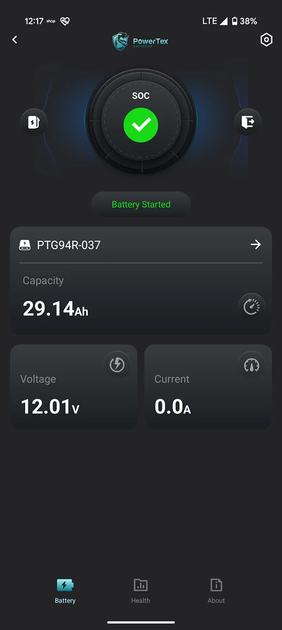

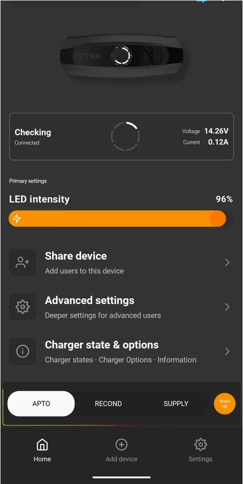

gah, having trouble with this...
Picked up a powertex battery. Had to shipped internationally, and so the state of charge had to be dropped to 50% before shipping.
I've been trying to charge it back up with no success.

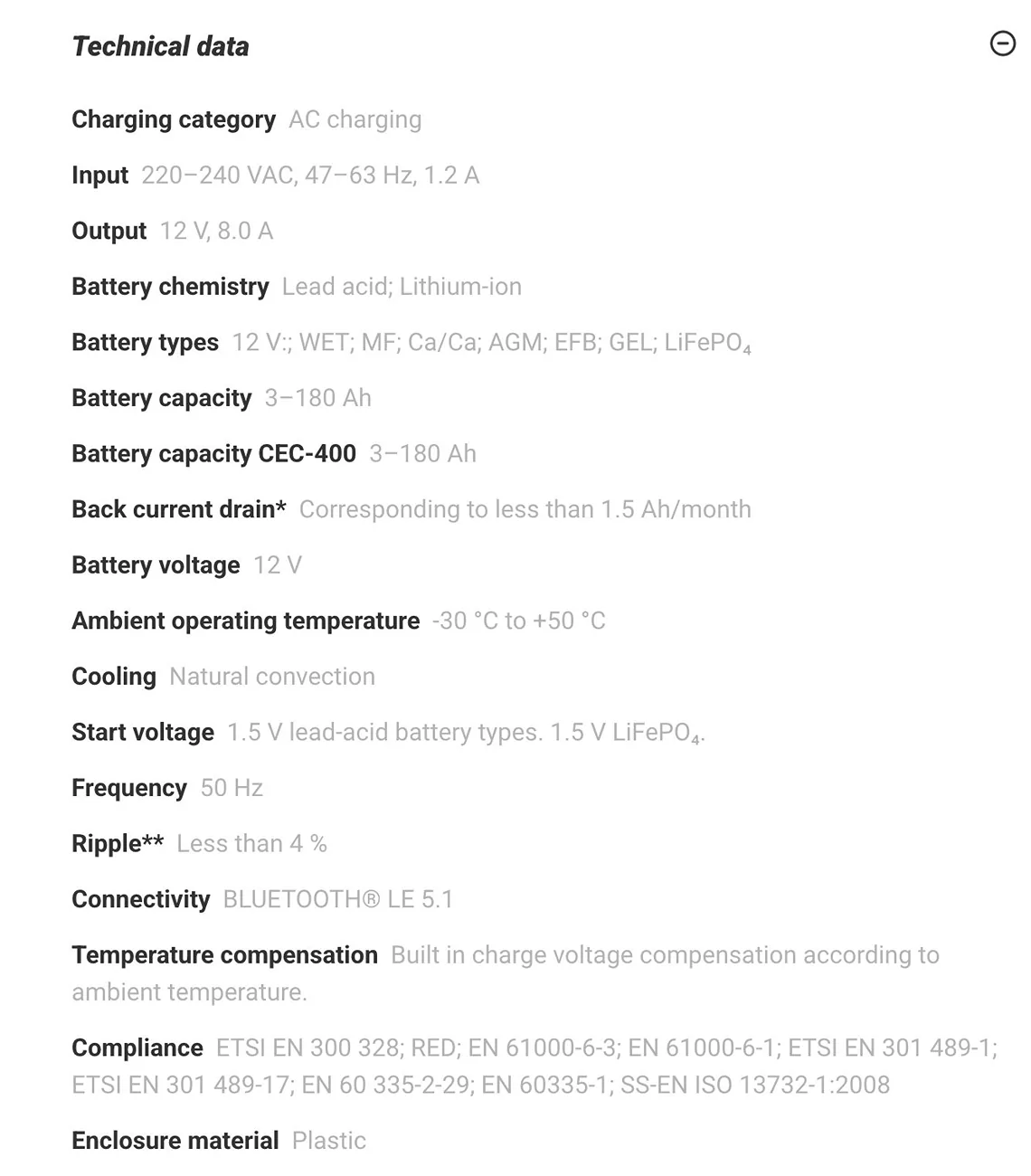

I'm using a CTEK One, which is a smart charger which auto detects the battery chemistry.
As you can see from the pic below from the CTEK app, there's no current at all....as if it's just trickle charging.
From the powertex app. Also the battery health seems to be "perfect" according to the app.
I've tried letting it trickle charge for hours. I've tried the CTEK "wake up" function just in case the BMS shut everything down. I have another charger, but it's a crappy Chinese one, and that didn't work either.
My only working theory is that this specific battery does not want to play nice with a "smart" charger. AFAIK a smart charger like the CTEK will “ping” the battery first. If it doesn’t see a stable voltage, it assumes no battery connected and could refuse to start. I don't know if that's what's going on here. The only way to find out is to get a lithium only charger and have a go. But, i don't have one, and i really want to avoid having to buy one....
Help?

I use this ctek charger with no issues with my PowerTex.
https://a.co/d/5115tSq
That's what i'm going to try. But then it's a bit weird that my ctek charger hasn't worked. I'm really hoping it's because of what i mentioned, and that the powertex doesn't want to play nice with a smart charger. Otherwise it seems like i've gotten a defective battery, and there's no chance of it bring replaced under warranty.

The PowerTex battery issue still hasn't been resolved. It seems the BMS is blocking all current no matter what i do. I've tried a wild number of experiments to try and get it to respond. To their credit, the PowerTex support team have been amazing. They've just never seen something like this before.

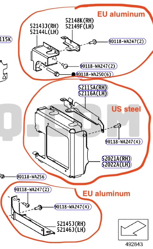

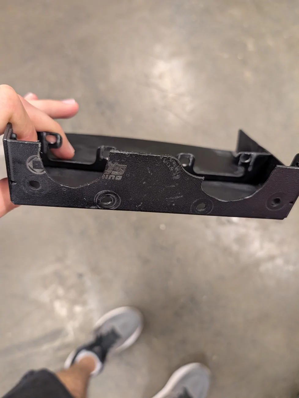

Lastly, i forgot to check if the radiator brackets we have here are the EU or US ones when my aux radiators were going on. Will get the wheel off and check next weekend. If anybody knows the part number for the EU bracket, please let me know. I'm usually a pretty proficient googler, but for some reason couldn't figure it out.
8,806
17,271

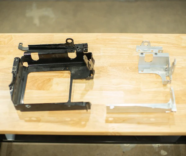

Easy to identify. The US ones are black steel and a whole cage, EU are raw aluminum and just L brackets

EU part #'s:
Bottom brackets
FL: 52145WAA01
FR: 52146WAA01
Top brackets
FL: 52144WAA01
FR: 52143WAA01
Top smaller brackets
FL: 52149WAA01
FR: 52148WAA02
