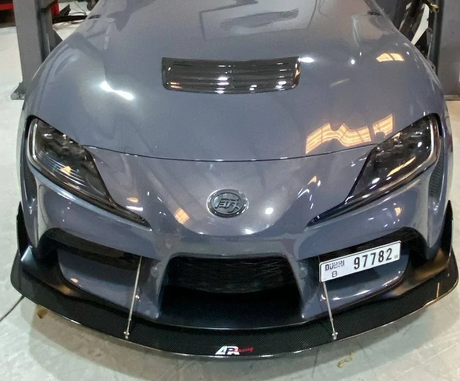

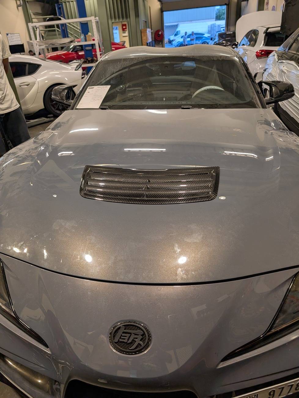

Got a few things done today. Verus hood louvres and TEQ CF badges

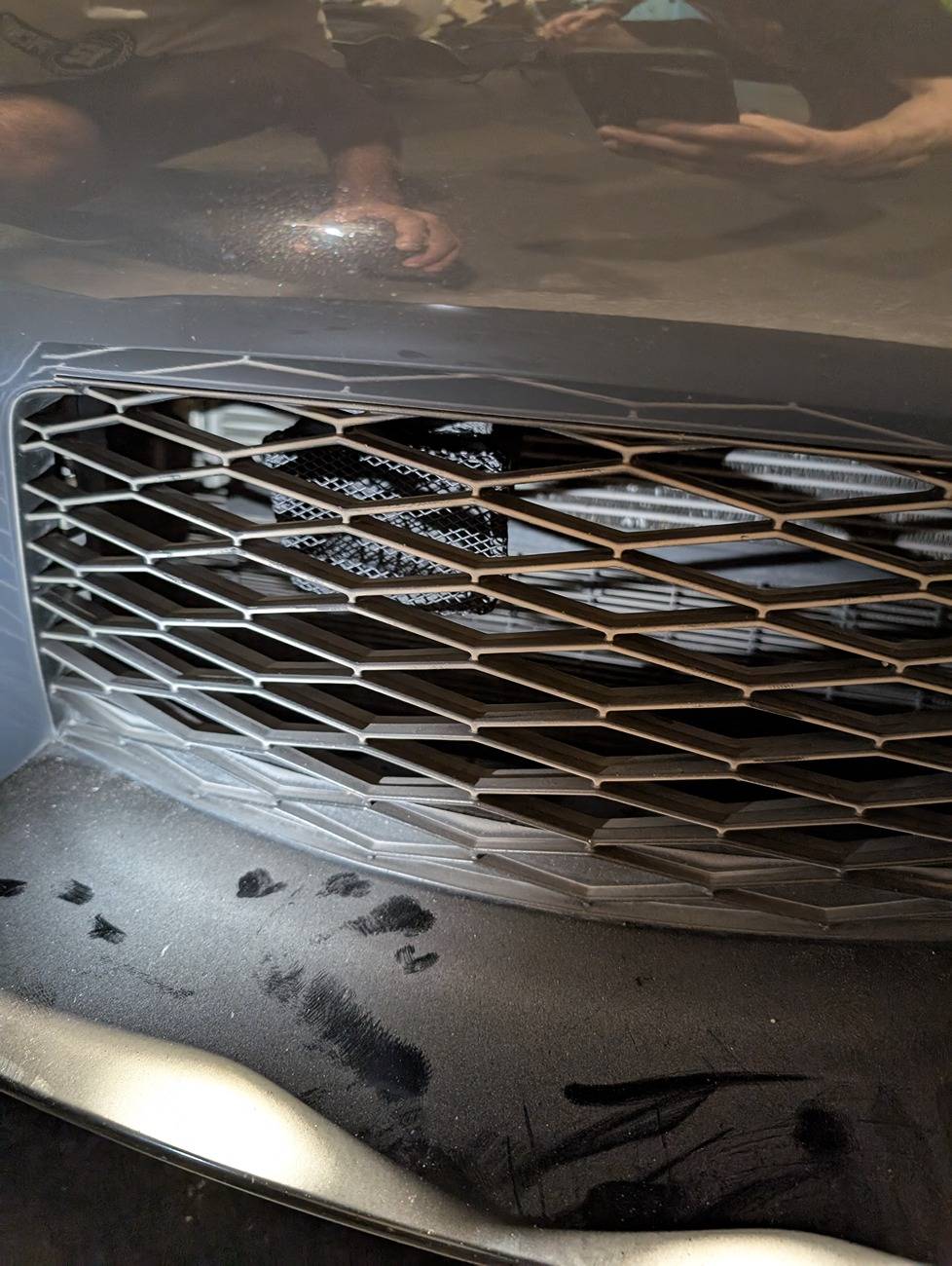

Also got a custom 3D printed snorkel done that pulls air from the grill area to the intake. Will be fun testing that out. We did cover the front with mesh as well to make sure no rocks get through

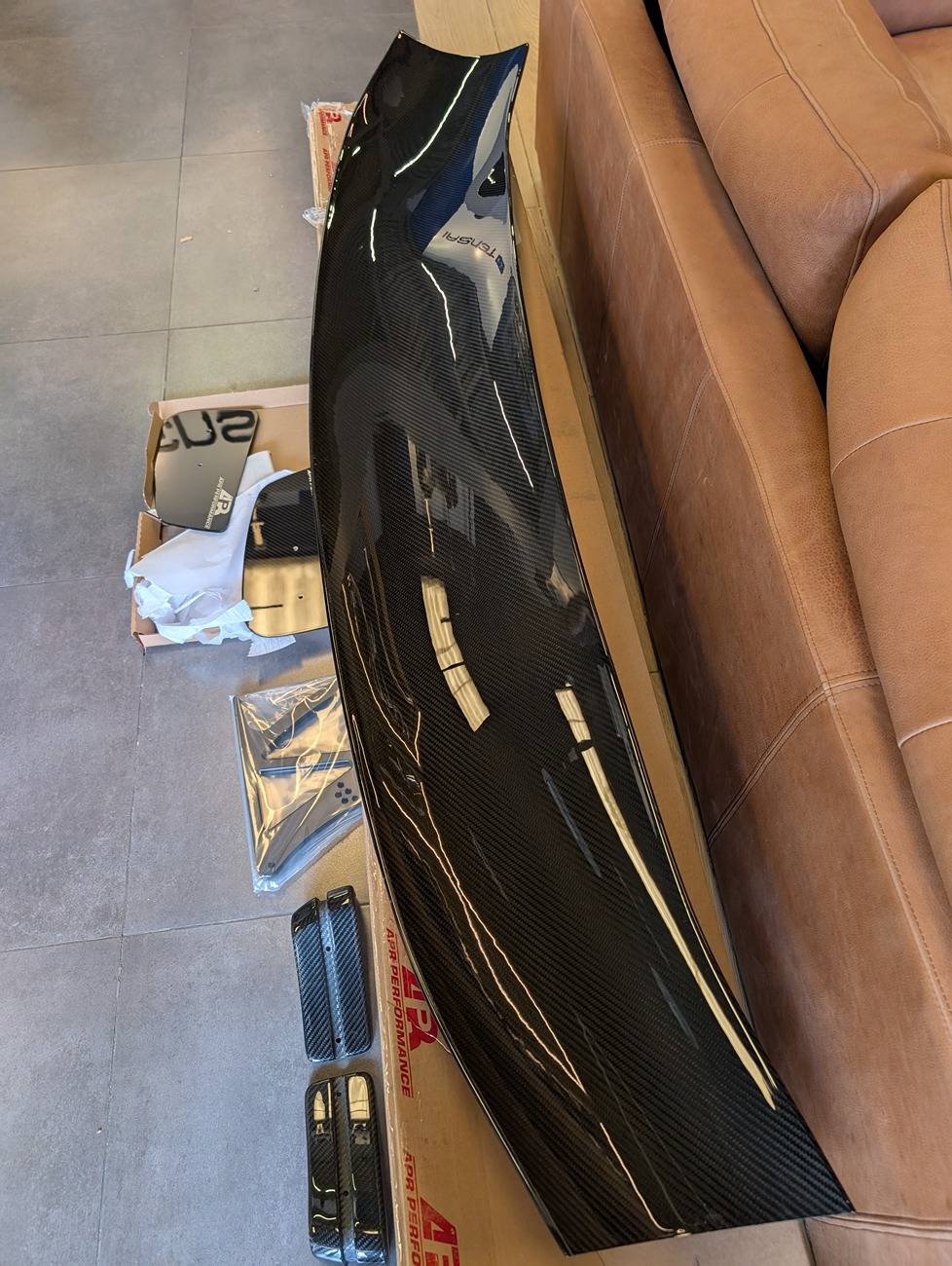

The wing and the splitter are in. So is the flex fuel kit. CTS intake too (it was in stock locally, no other reason....yes dumb).
By the time al that's done my camber plates would've arrived, along with the front and rear sway bars. Already have the tie rod ends with me. So all those will go on. And then it's time to get the alignment according to the specs i shared that some of you guys generously shared feedback on.
