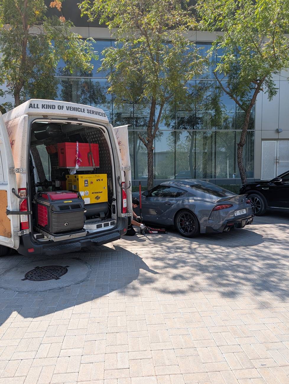

Getting some proper tires for a change. My new 18" wheels won't be here until July since they're made-to-order, so still using the stock wheels.
Nankang CRS 275/35/19 in the front and 295/30/19 in the rear
The van is basically a mobile tire fitting service (who also sell you the tires). They'll bring your tire of choice wherever you are and get the job done. In my case this is getting done while I'm at work.

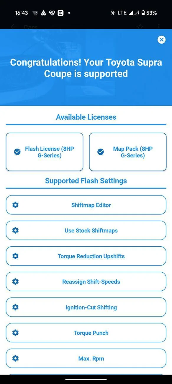

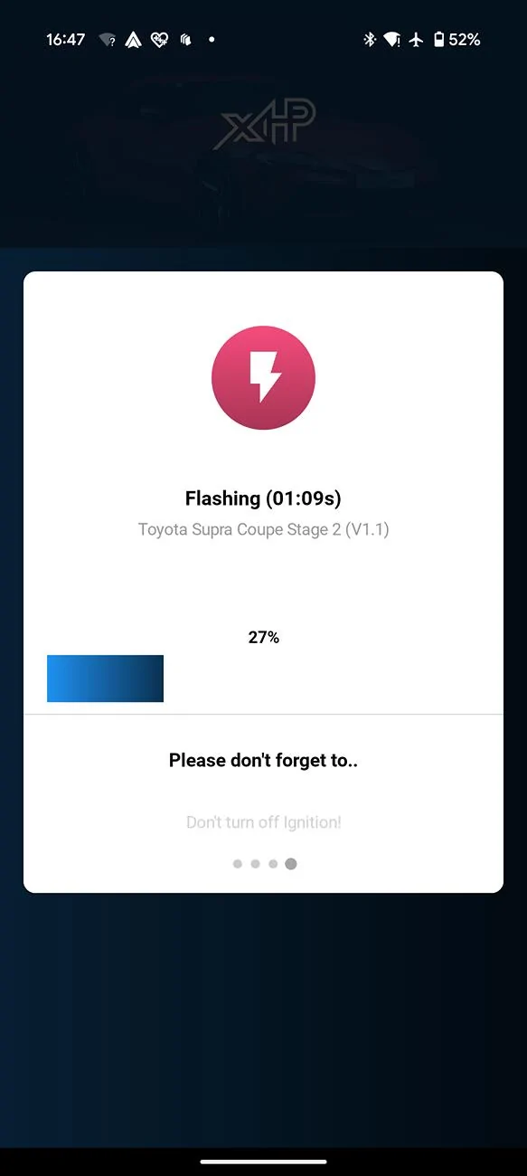

Flashed my transmission. xHp stage 2. Between that and the new tires, i'm really excited to get back on track. Have a track day lined up for this coming Monday evening

I tried the stage 2 on track (for one session), found it to be much better but still lacking. Switched to stage 3 between sessions and…. baddabam ? McLovin ? it ever since!! Enjoy amigo ?
Oof, didn't actually think about reflashing during the track day itself to try and gauge the differences.
Haven't done much research about stage 3, but from the little i've read it seems to be a bit too harsh for my setup? Stock trans basically. Am i misinformed?
Yessir. But I have the ZF. So it was better suited for me. Still smooth as hell, doesn’t’ shift too late in normal/comfort mode and could actually be used in fully automatic mode when in/on track mode.
8,783
17,240
He also has a ZF 8spd. All auto Supras have the ZF 8spd
I’d hope so, lol. You got me. I didn’t remember or read back. I’ll have to put in more due diligence next time.
And it was a great suggestion on your part to do so, using stage 3. Apprecyatit master Labs!!

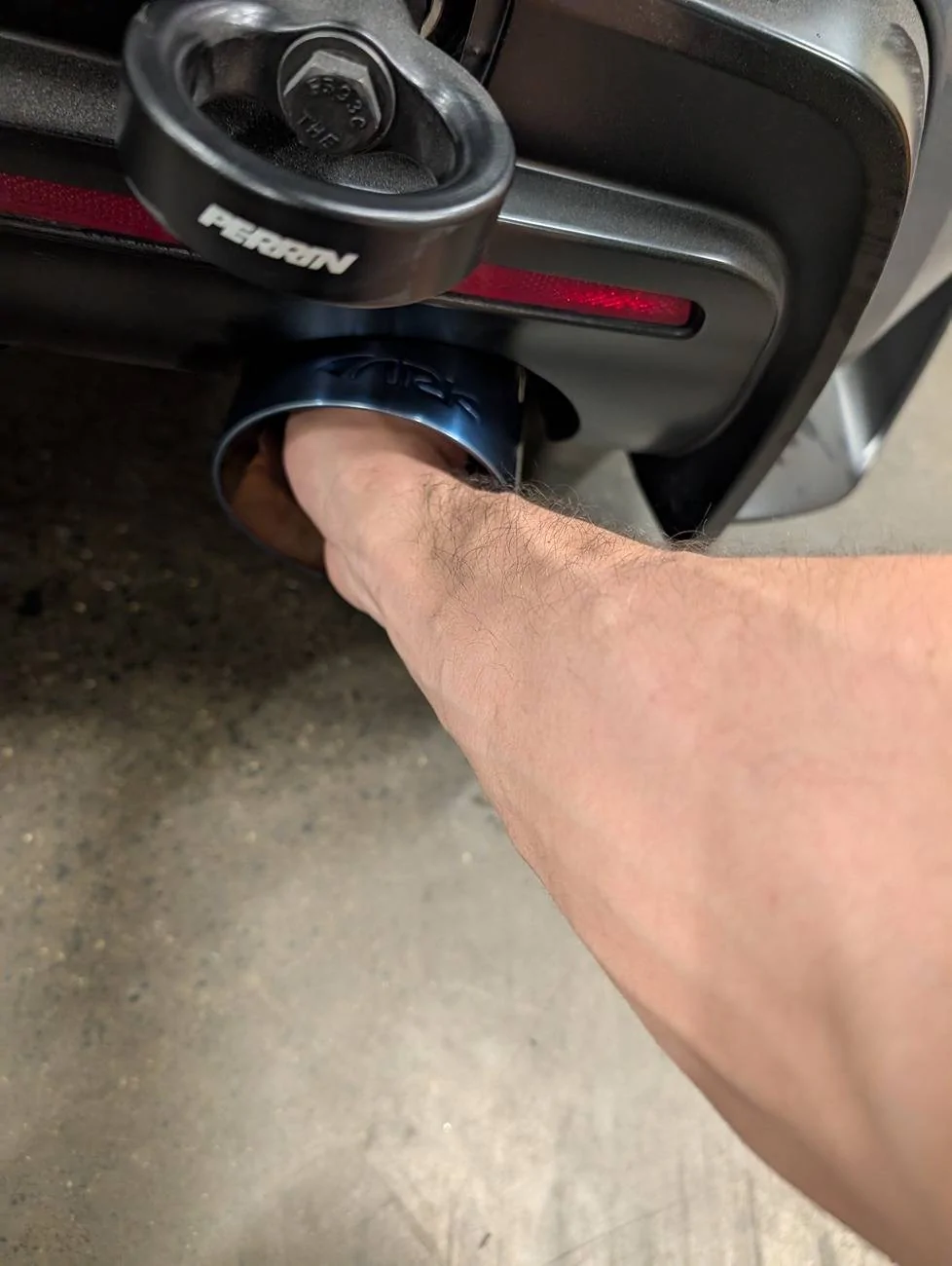

Got the Ark exhaust on. Those are some big tips...
We couldn't figure out why the valves weren't working when toggling between sport and normal. They were always open. My friend used app (bimmercode? not sure) to close them and they would close for a second and then open back up.

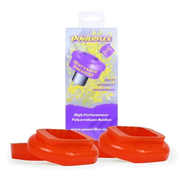

Installed these Powerflex engine mount inserts. The solid (black) ones are a bit too harsh.m These still add some NVH at idle, but nothing i can't live with.

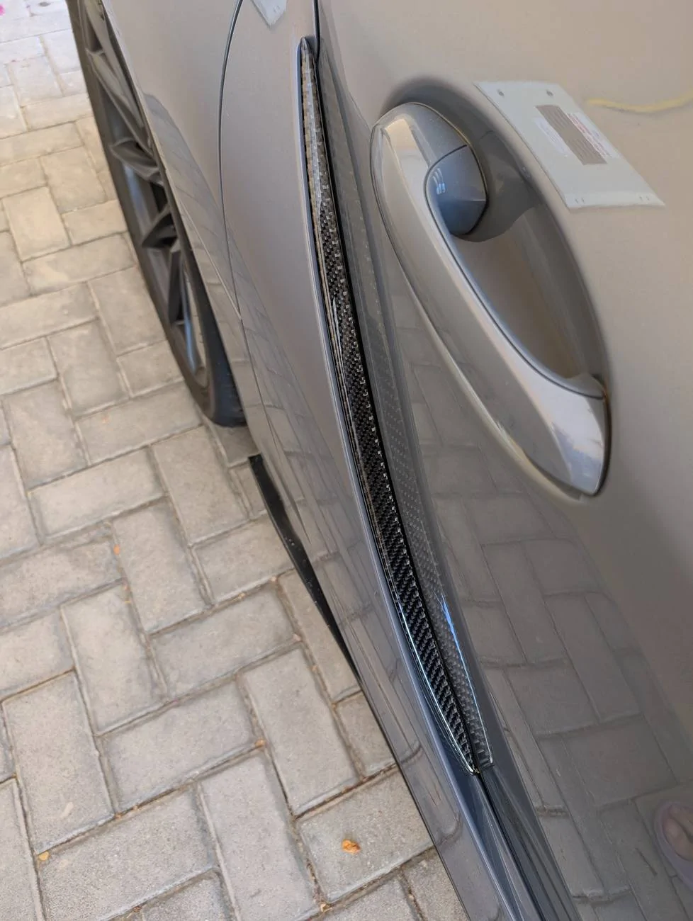

This is really silly, but i also added these soft CR door inserts. I like CF (ish) and really don't like the black plastic vents. Leave me alone
