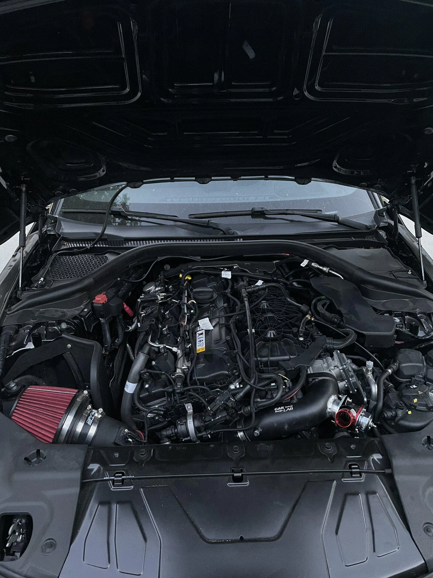

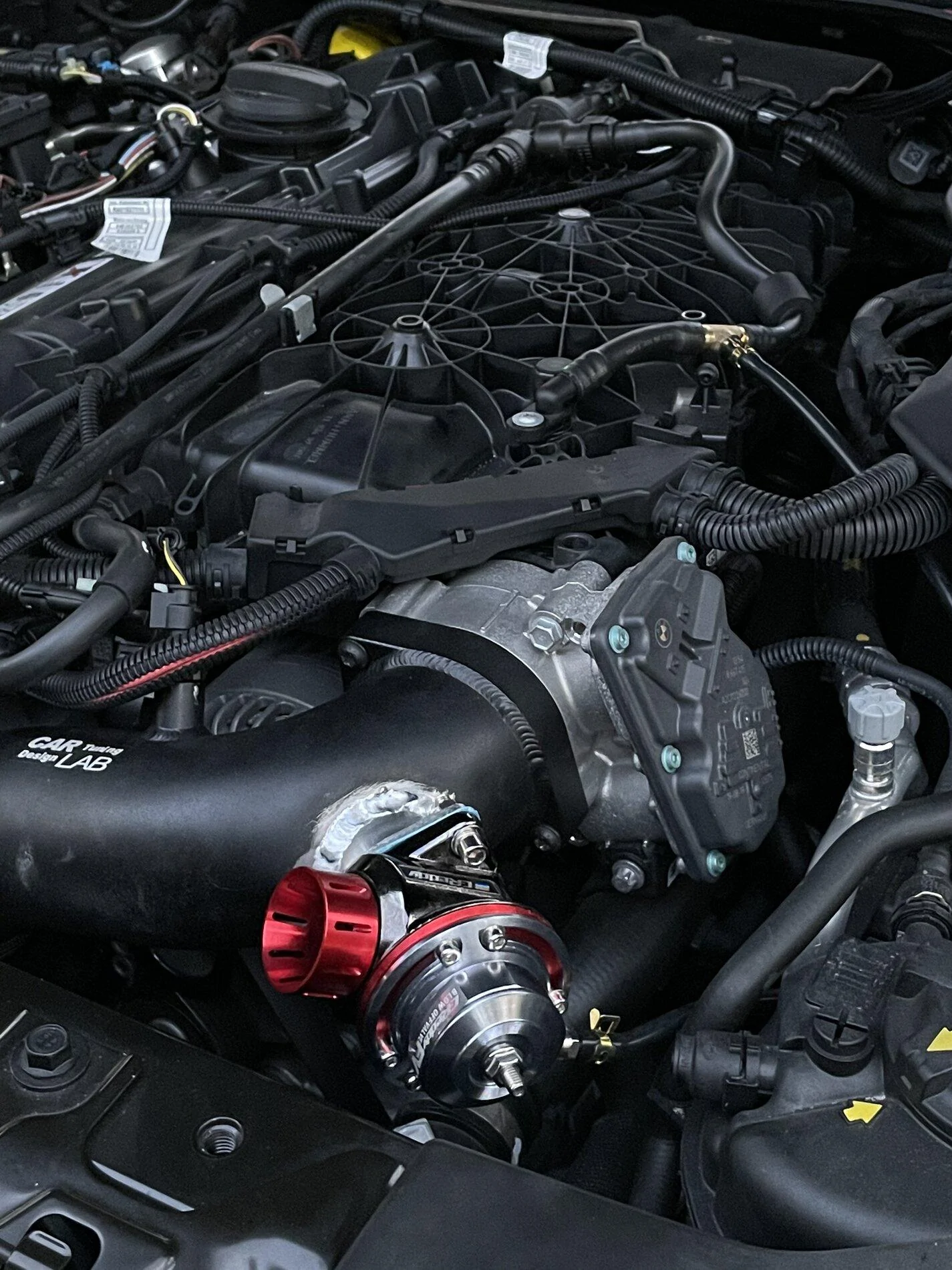

here the newest update with hks exhaust too
pretty cool IMO but I’d go with a different blowoff. Much props for making it work.

I’m adding a GReddy FV BOV to mine, getting the flange charge-pipe welded soon. I have the FV on my turbo Miata and love the sound...

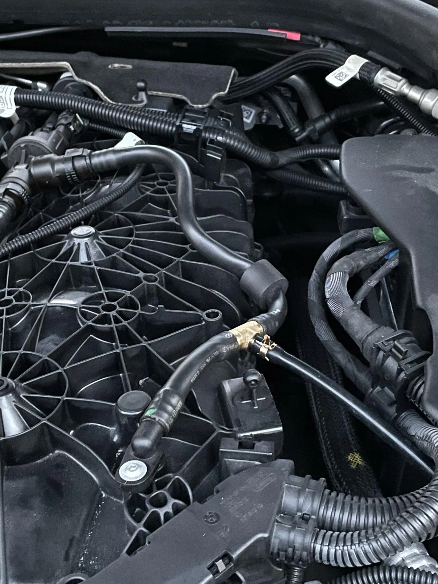

When you tapped into that vacuum line what barb size is the tee? I ordered various sizes (1/2 to 1/4 and 1/4 to 1/8) I’m just curious.
edit - 5/29/21 I used a 1/2 to 1/4 tee on the vacuum line and it fits snug! did a test drive but need to adjust the bov preload, it’s too loose and not holding boost pressure. Looks great in the engine bay though!
edit edit - bov is now adjusted how i like it. had to tighten nut on top so it held boost. video for noise. not too loud but still audible. also feels a little smoother shifting though lower gears. I'm happy with the install, even if it's just a noise machine lol GReddy FV BOV Noise

Curious how everyone is hooking up a valve to that line, I've tried to hook up both a gfb response and an HKS ssqv to that line and they seem to just be permanently shut. I did log an average of 1.4 in/hg of vacuum on that line, the lowest vacuum I got was 3.2 in/hg.

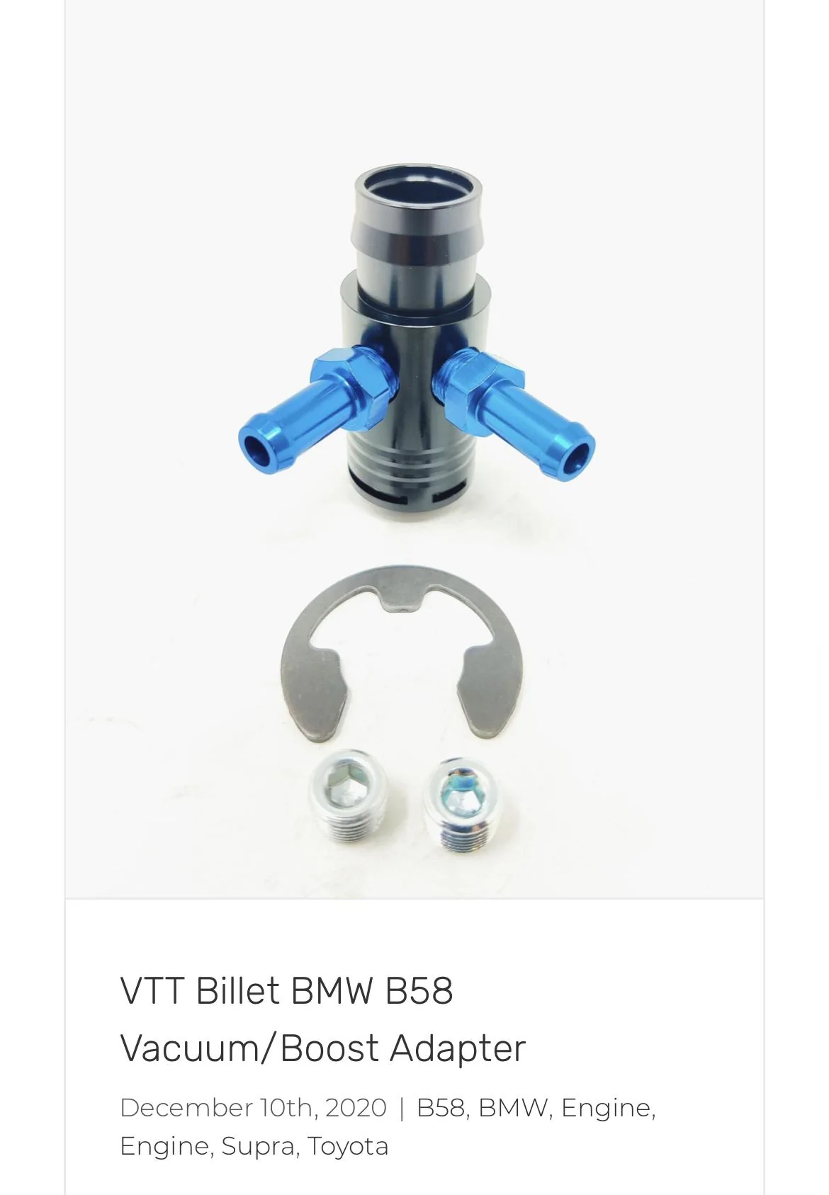

Have a charge pipe on the way and going to have a flange welded on. Think I’m going to go with the Turbo Smart gen V race port bov. Going to use the VTT adapter to run the vacuum line.
