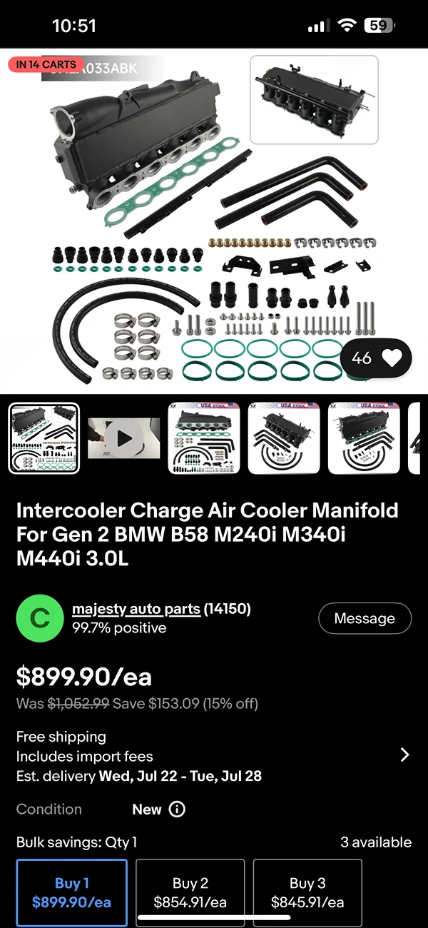

The absolute cheapest Intake Manifold I could find online, want some thoughts on it if anyone has tried or even seen it before.

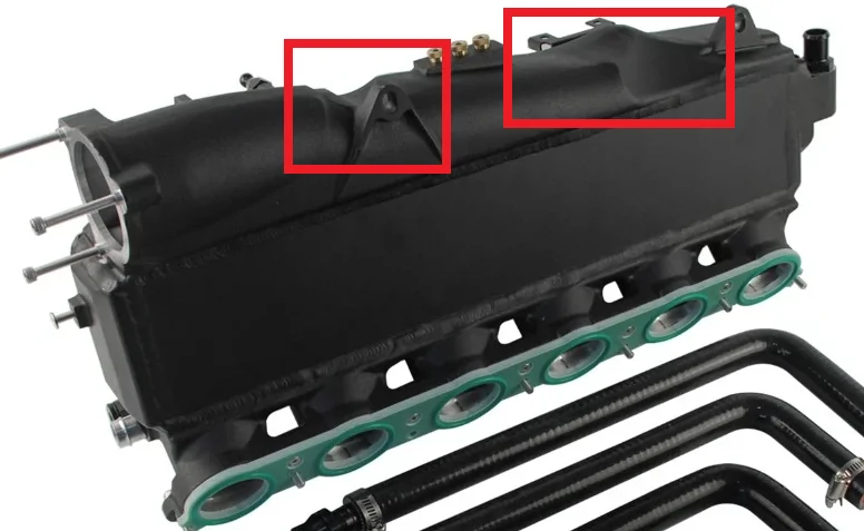

I might be mistaken, but I believe the EOS manifold
Correct. Pictures are to compare intake plenums of both EOS and OP's photos.

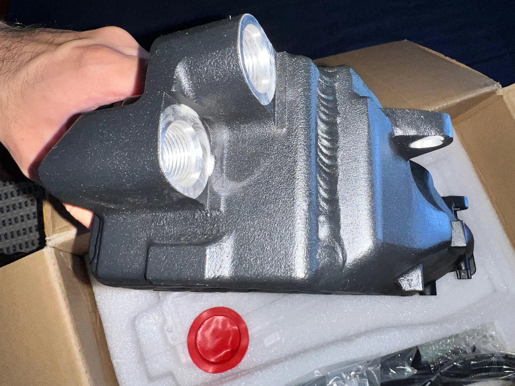

Personally id steer clear. I mean for science id love to see data, but even if it does have any performance gain id imagine it probably fits like garbage, has quality issues, and wont last as long.
Don't me wrong, China is next level and you can get some amazing, high quality products there. Where else is Pure, DAWS, VTT, and the rest getting their castings from ..............But this?
Do we really need to verify where this is being built or if they carry an ISO cert?

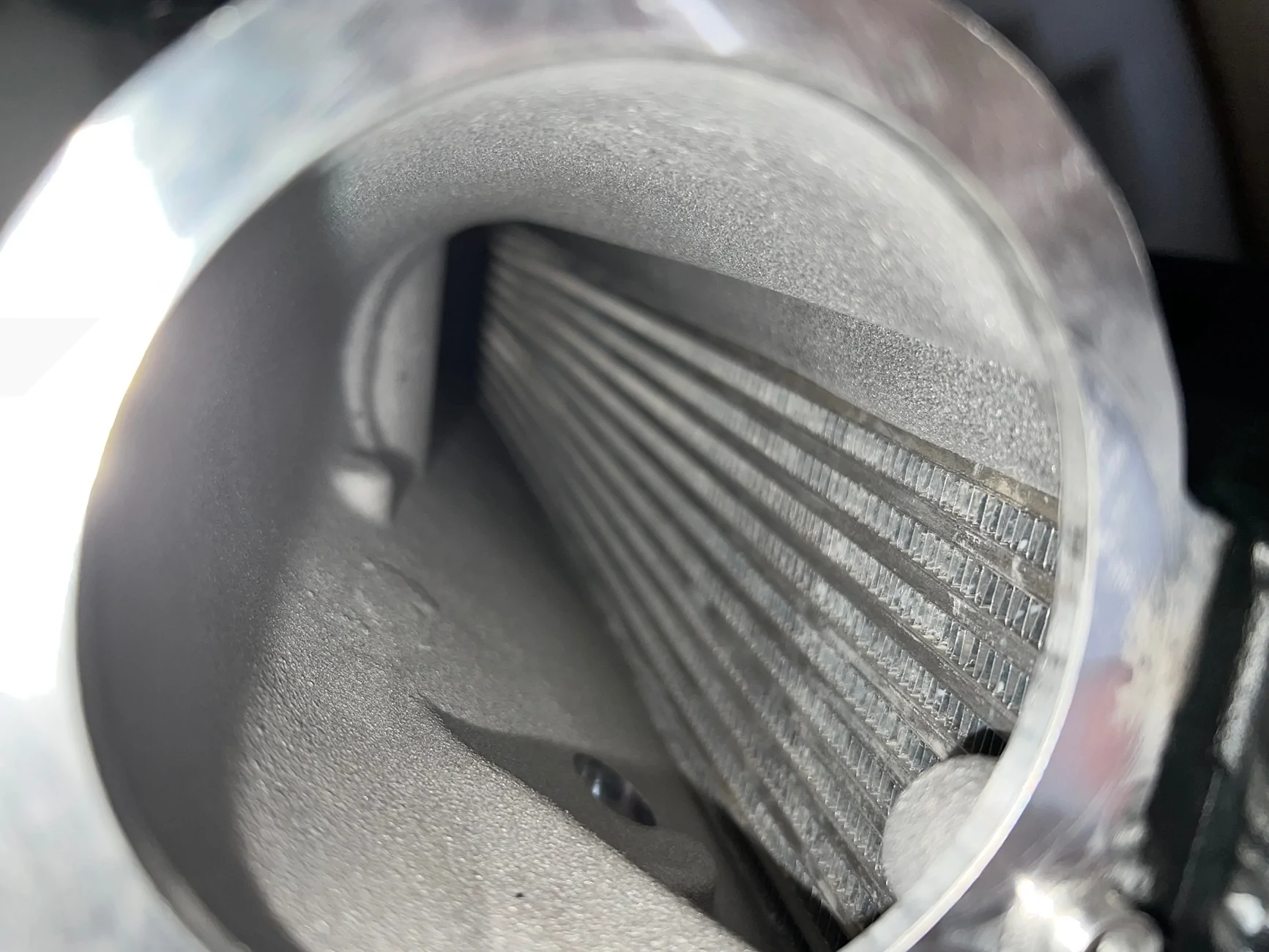

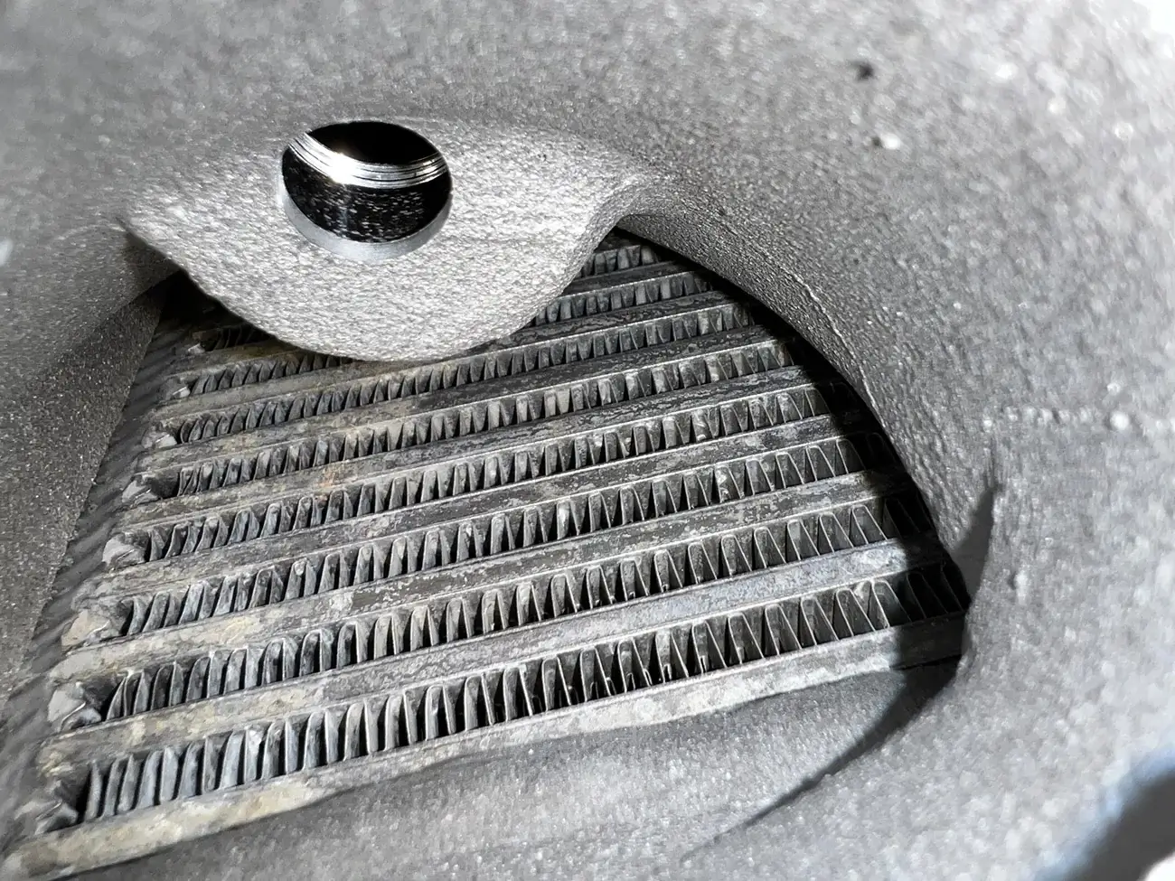

Oh yeah........... this plenum is totally acceptable for OP's 800hp build on a 2port stock block with 0 risk.
Because the DME magically tracks individual cylinder AFRs and doesn't just average everything from a single O2 sensor, right?
High velocity air inside an obstructed plenum definitely causes 0 turbulence....... yep.
I'm sure the air mass entering the cylinders definitely won't vary from cycle to cycle. All 6 will be fed evenly and cooled effectively. 100%... Air is smoothly traveling the entire length of that plenum.
Oh yeah, I'm sure that indent at cylinder 6 won't mess with the port injection spray pattern, and that ingesting pooled, unatomized droplets won't trigger a super knock event.
I mean, what could possibly go wrong? Finding out the entire block is a throwaway after scraping the wall with metal shrapnel from a blown ringland? Nothing quite like throwing away a whole motor just to save a few hundred bucks on a Wish.com intake manifold
