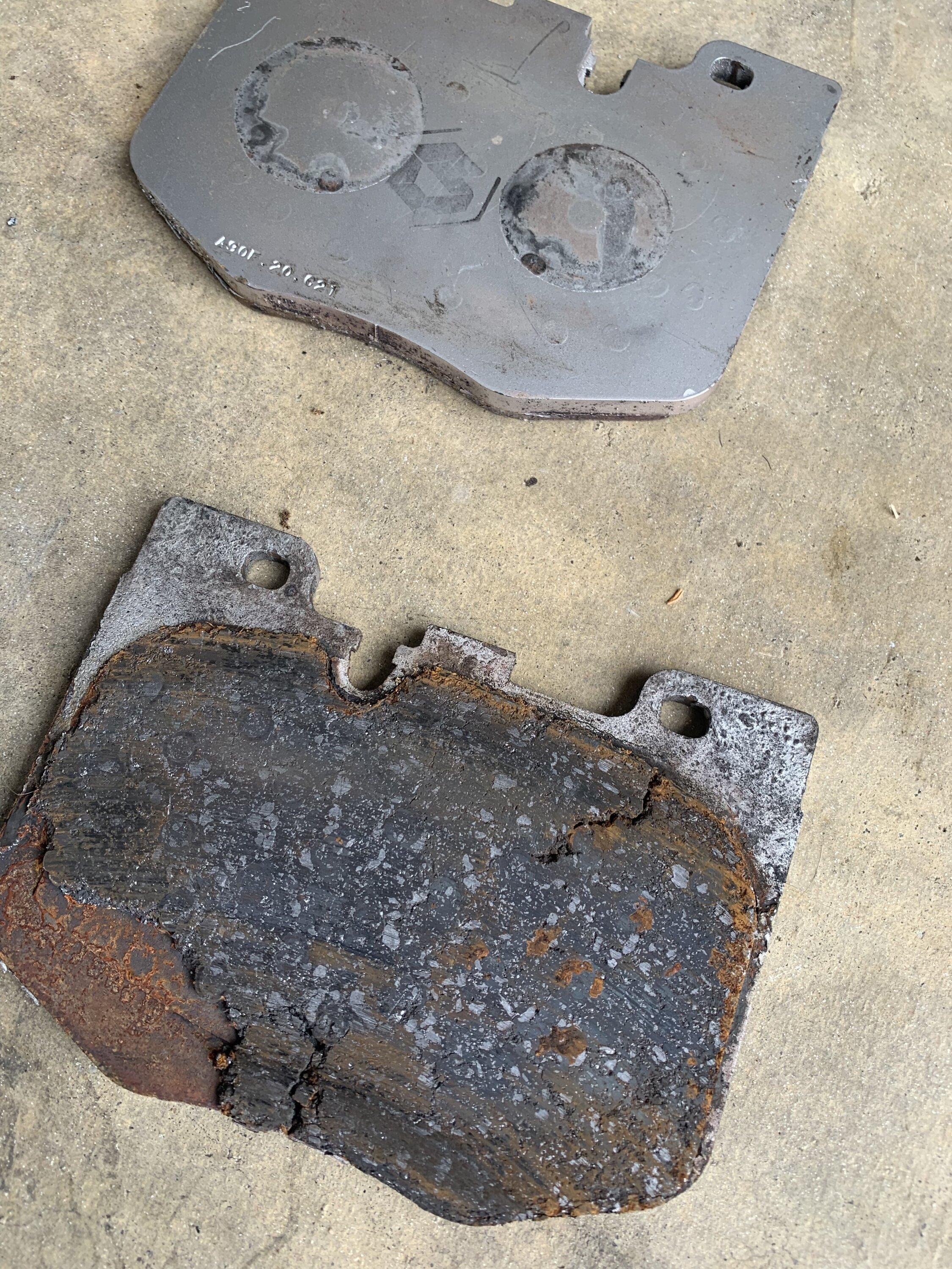

Quick update on this thread! The MX72+ pads have been great so far, however because they get hotter than stock they quickly warped my original rotors. New Gyrodisc rotors are installed and ready for a new track season!
I highly doubt you warped your rotors. My bet is bad pad material transfer due to a bad bed in. Only shakes when the brakes are up to temp?
Material transfer was definitely part of it, but they were most certainly warped. New rotors feel fantastic!
