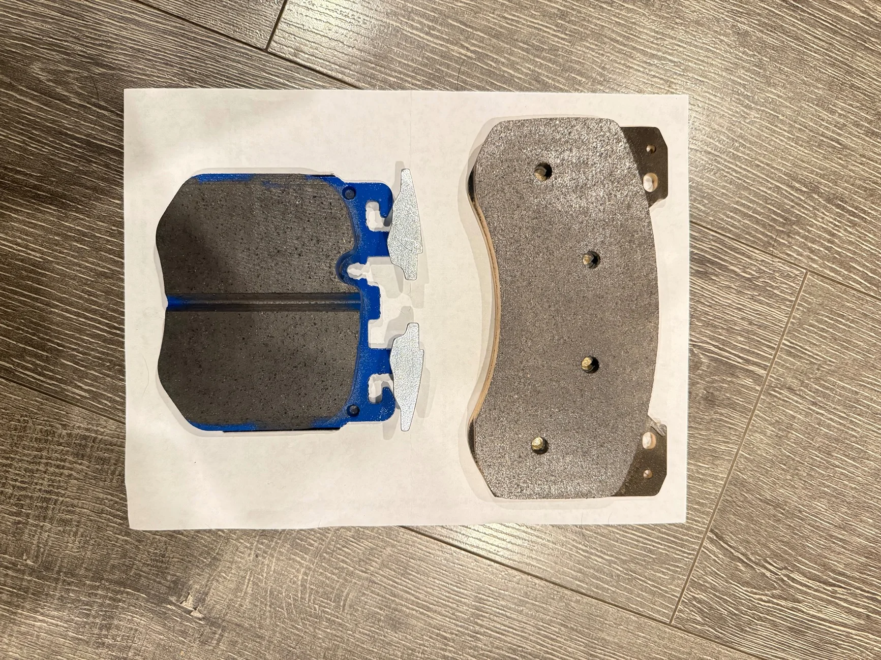

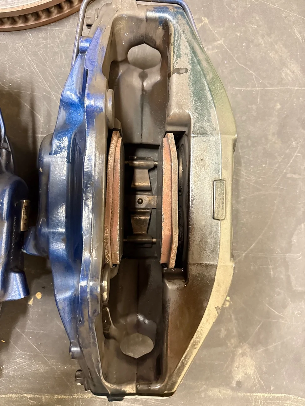

The only decent option I had for the 374mm brakes were carbotech xp20’s. The calipers use the same piston sizes as the baby M lite brakes, so I always had terrible pad taper. The pad is just too tall for it to manage the pad well. The best thing I did was got off those brakes and moved into g80 brakes. Unfortunately getting an 18” to fit over those is almost impossible unlike the 374mm’s. I run g-loc r16’s with the m3 brakes (essentially carbotechs) and the pad taper is very minimal now.

Since you have the larger calipers, you have a VERY limited selection of track worthy pads to choose from. Tip to help your search: The FE shares the same front calipers as the M240i/M340i/M440i Cooling and Tire package (ZTK) The M550i / 750i / M850i / X3M / X5,7 M40i,M50i also share the same calipers.
Hawk does not have DTC60's for those calipers yet.
You also already have a bit more negative camber than non FE's as the FE use the - camber front hubs. You will need to be careful with 18" wheels as most won't fit over the FE larger brakes.

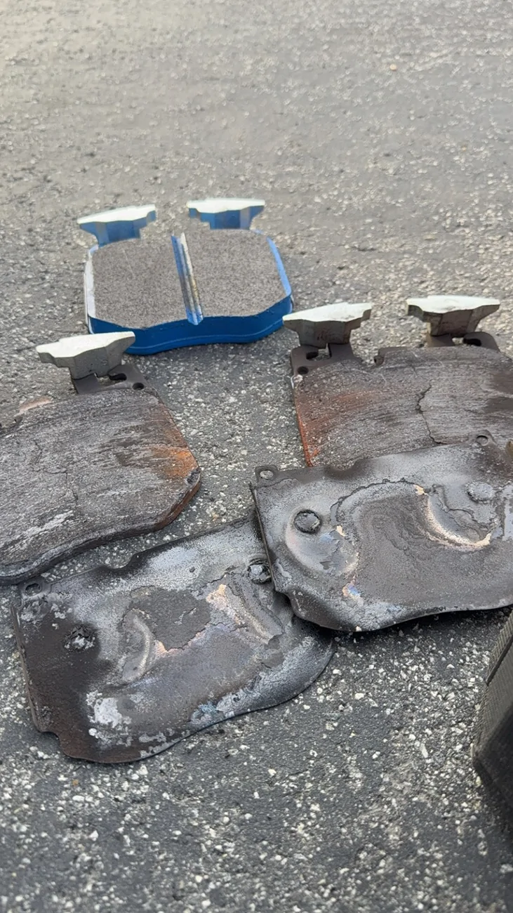

That pad for the 374mm rotor I showed for comparison to the g80 pad is an EBC blue. I would literally go through a front set in a full track day. Decent bite for the first 5 minutes of a 20 min session before falling off.
only plus was that I could source them at FCP Euro and replace them for free.

That doesn’t look good! Which car were you driving? Which track? Any tc on?
It was at Laguna Seca, TC 1 step off. I did a 1:38 there with EBC blues, and a 1:37 with the carbotech xp20’s with those old brakes.
So, you’re also managing a bit more weight… 😜
Just ordered some G-Loc track pads. They will make the size/shape I need. 😁
