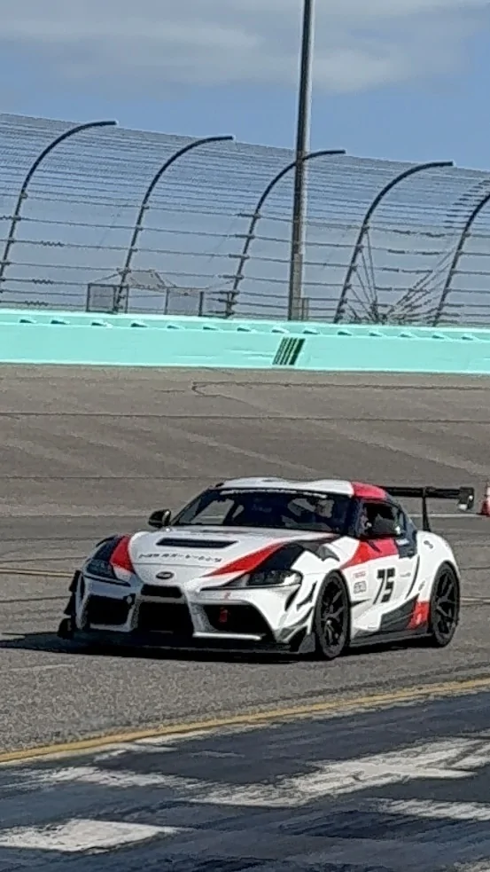

Lovely. Is kind of what I did. I’m already on Stage 8! Of my build.
Just have not documented the whole thing but planning to.
I added the cooling earlier because Im
In swampy FL and needed it to run the entire summer
https://www.supramkv.com/threads/project-gr-75-build-log-mod-list-and-short-ratings.22449/
the actual list of things the car has:
Based on a 3.0 6 cylinder 2024 base model A91 with B58 six in line engine with ZF 8HP 8-speed automatic transmission
Aero:
-High downforce splitter
-Canards
-Splitter endplates
-Cold air intake
-Fender wheel vents
-Hood louvre
-Side skirts
-Rear spats
-Diffuser
-VX1 rear wing
Engine / Suspension / brakes:
-Turbo cooling plate
-Injen cold air intake
-AA Cat downpipe
-Master Brake cylinder brace
-Steel front brake lines
-MCS TT2 2 way non remote coilovers with Non divorced rear springs
-Vorshlag Camber Plates
-Eibach front sway bar
-Verkline front and rear adjustable arms
-Front brakes cooling ducts
-Hawks DTC 60/30 pads
-Borla dual exhaust
-Blitz front engine strut bars
-Wagner Tuning Manifold + intercooler
-Alignment and 4 corner balance by Breathless Racing
Cabin:
-Zestek quick release steering wheel
-Driver and Passenger Sparco Evo QRT seats
-Sparco 6 point driver and passenger pull up -harness (chasis anchored with backing plates)
-RSR extended mid and rear Roll-bar (welded and -bolted thru and thru)
-777 door Motorsport release straps
Telemetry:
-RaceCapture Track Mk3 Lap timer, Telemetry and Data Logger
-TrailBrake CAN linked external TPMS system
-8 inch tablet display
Media:
-Bumper camera
-Dash Camera
-Rear camera
-POV driver camera
-Driver’s right camera
-Thru wheel camera
-DJI Mic mini Engine and Exhaust microphones
Wheels:
Titan 7S
F: 19x9.5 5x112 +34
R: 19x11 5x112 +40
Tires:
295/35 R19
275/35 R19
Staggered (wet track + street)
Apex
18x10.7 5x112 +38
Squared
Maxxis Victra RC1
275/35 R18 TW100
(Dry track)
Exterior
-Livery:
Toyota "GR Supra Racing Concept" World Premiere
-Front PPF
-Windshield exterior PPF
-carbon fiber mirror caps
-Fall-Line Motorsports front and rear Tow Strap
-RBG Day time running lights
-F1 style 3rd stop

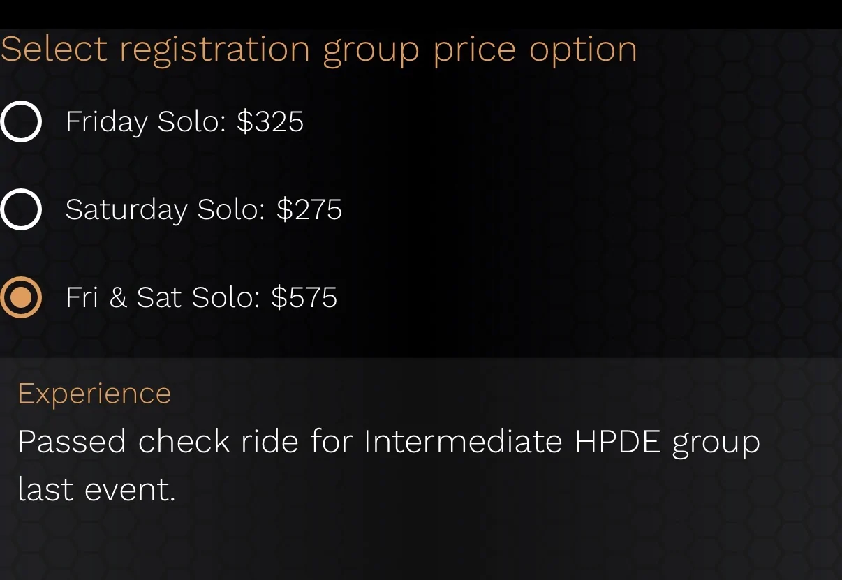

That seems a bit short. What are the event prices?
We had a group here in the NE that used to do 7 20 min sessions. haha. It was way too much and I would rarely do even 5 sessions, but you could for sure get your moneys worth. They have since dropped it to 4 sessions like most of the organizations here do.
Gabe
Gabriel
Feb 19, 2024
679
1,239
Miami
Each session is 20-25 min usually and there are three per day.
happy hour only last day at the end of the event. 30 min
