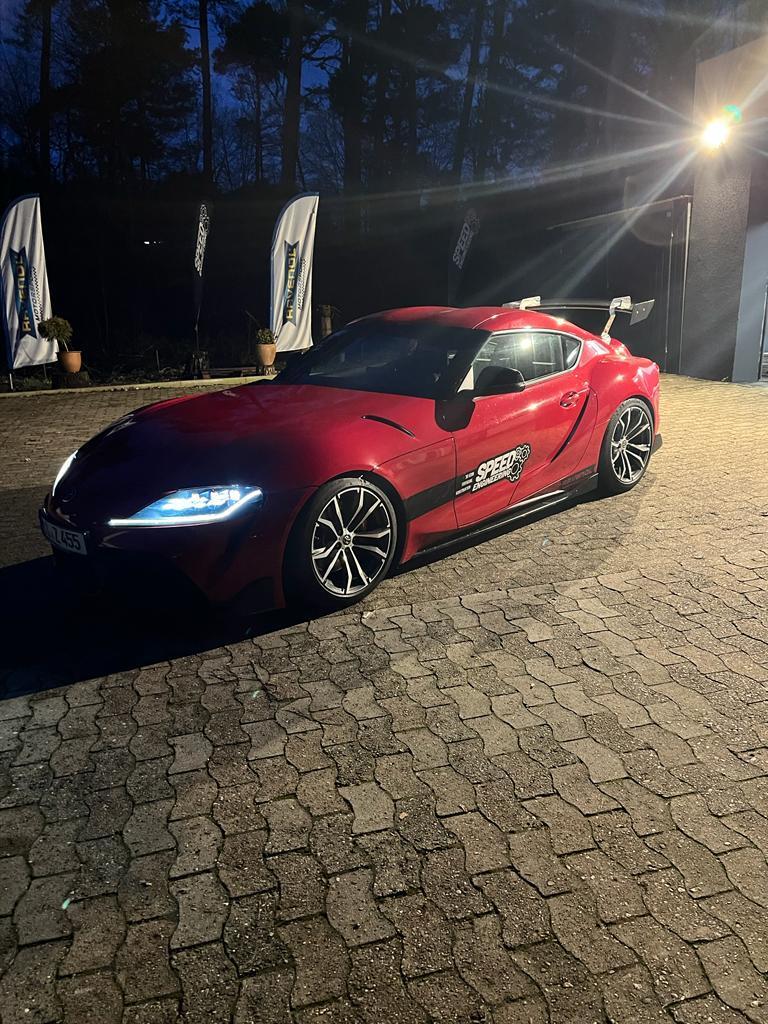

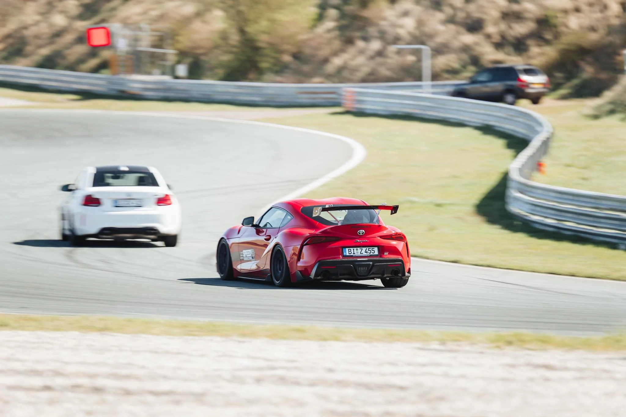

Test-mounted the spoiler. The raw aluminium look from the bracket meets the look of the OEM rims. Good that it's going to be powdercoated in black to meet the track-wheel optics.? It's so cold here that semislicks would break, so I'm on the OEM rims, equipped with Michelin Pilot Supersports.
I heard that every "normal" road picture needs to be compensated with a picture from the racetrack, haha:

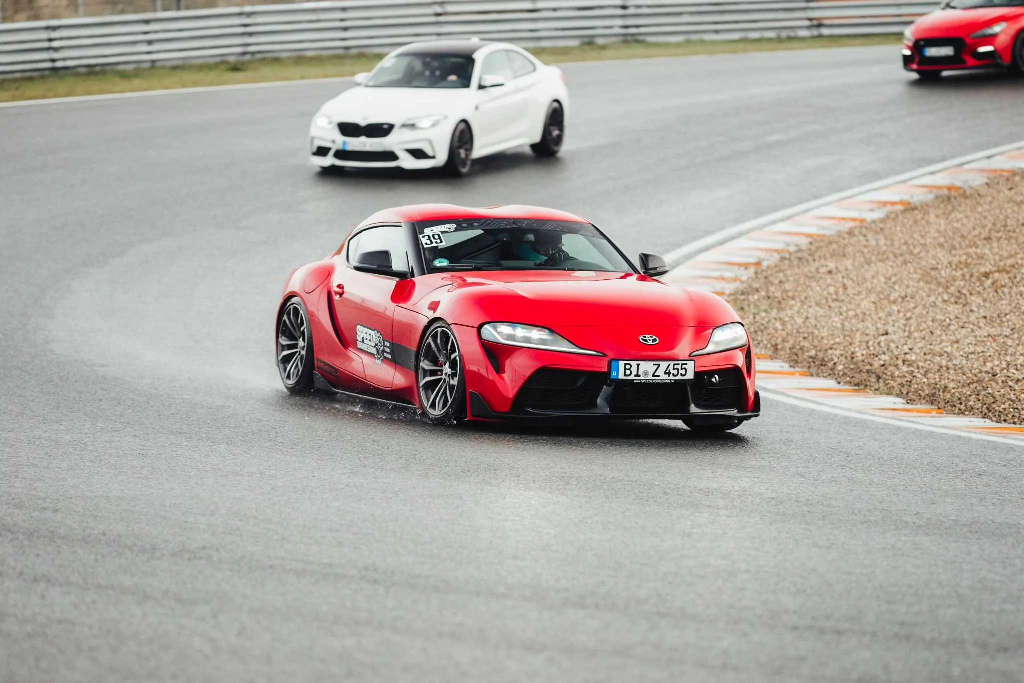

Again equipped with the OEM tires because of the really wet weather. Had a great session at Circuit Park Zandvoort (NL [EU]) last December. Some buddies in the M2 (nearly stock) and a full built i30N chasing me.

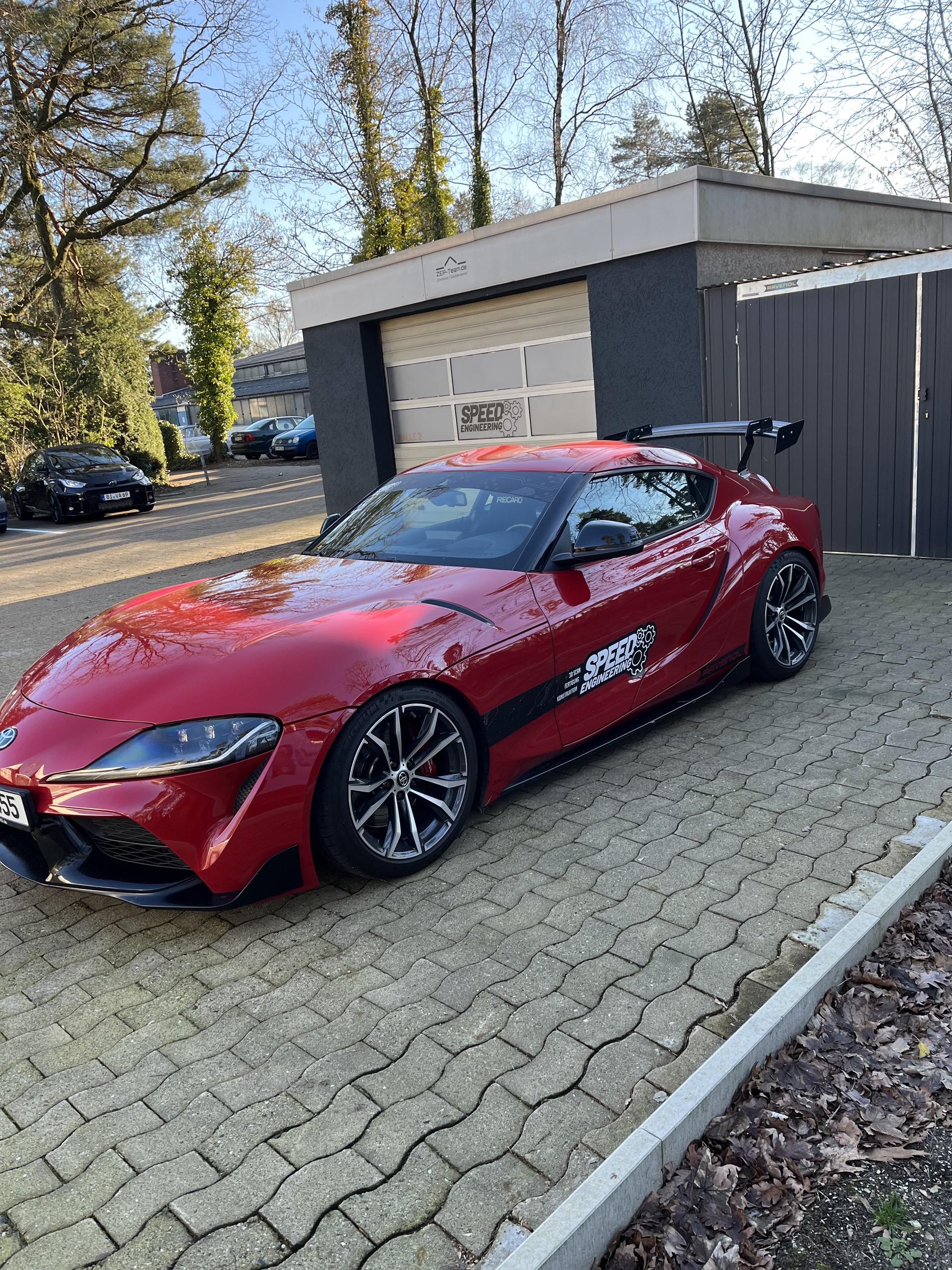

Hello guys, did a little work on the car: The spoiler-project is completed!
Best point is: Official road legal here in germany :drive:

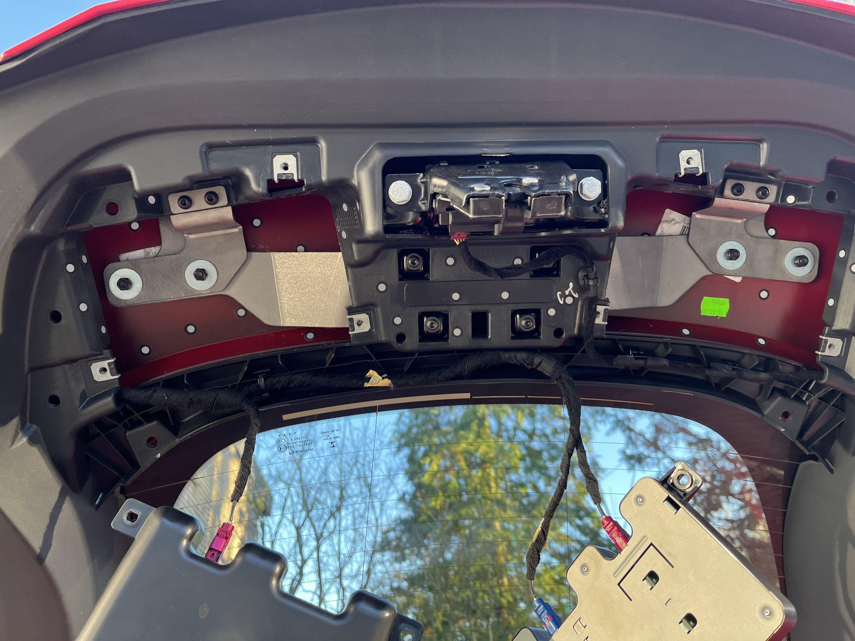

As @Todday1 said, the trunk lid needed some attention. So i made a metal bracket, reinforcing the billet mounts on the other side and the whole lid. Now it's stiff (as it should). Then i reinstalled the plastic covers and did a little ride.
Feels great. Does not wobble. Everything else is tested on the racetrack in three weeks. But i have a good feeling. You can feel that it adds a bit of drag already. Without the spoiler it accelerates noticeable faster after 200 km/h. (i know... it's also because i only have 300hp ? )

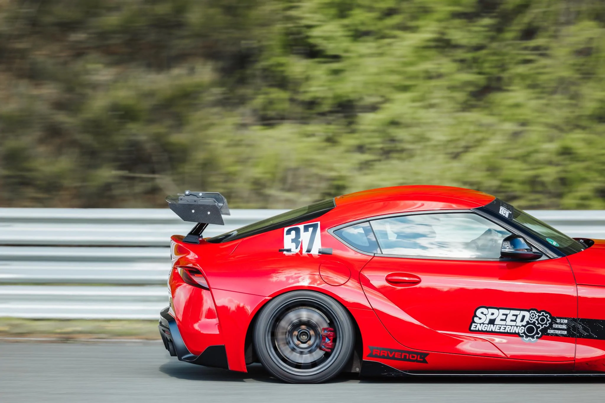

Soo, the track season just started here in germany. :drive:
Together with some friends we spend a whole trackday at Zandvoort Circuit (Netherlands) again, to start into the season. The wing proved his rectifaction of existence here!
Followed by an amazing trackday at Spa francorchamps (France) -this is the point im begging for more power…-.
Last week we had a blast at Bilster Berg (Germany).
I think i need a splitter now. The car’s very light at the front axle: Driving uphill in a long turn, i will be carried out by the g’s, loosing some time because i need to lift the throttle. If the wing is uninstalled, the problem isn’t occuring, so it’s definetly the wing, maximizing the load oft he rear axle. But i will not call it problem from now on. It’s the opportunity to develop a splitter, haha!

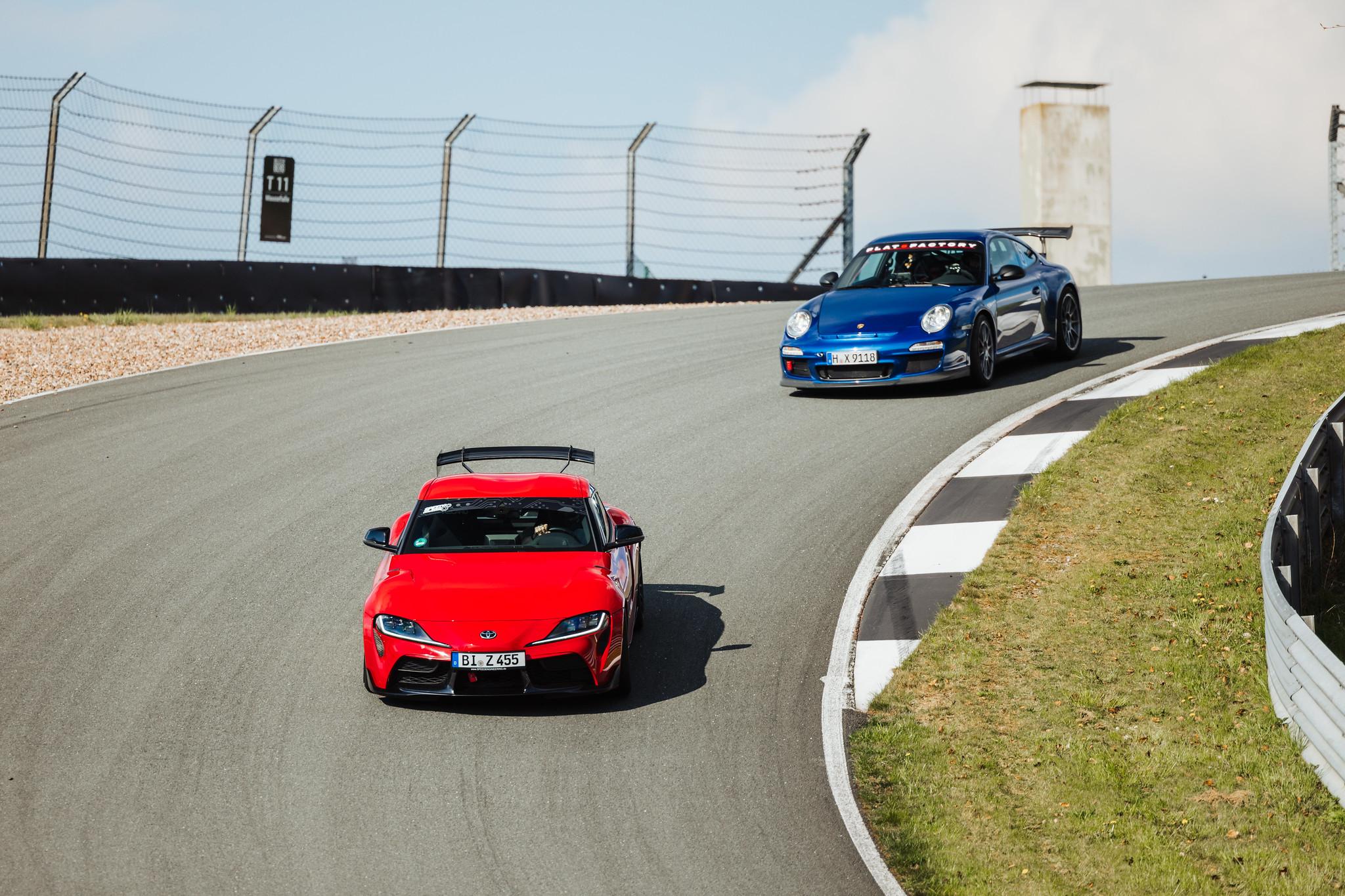

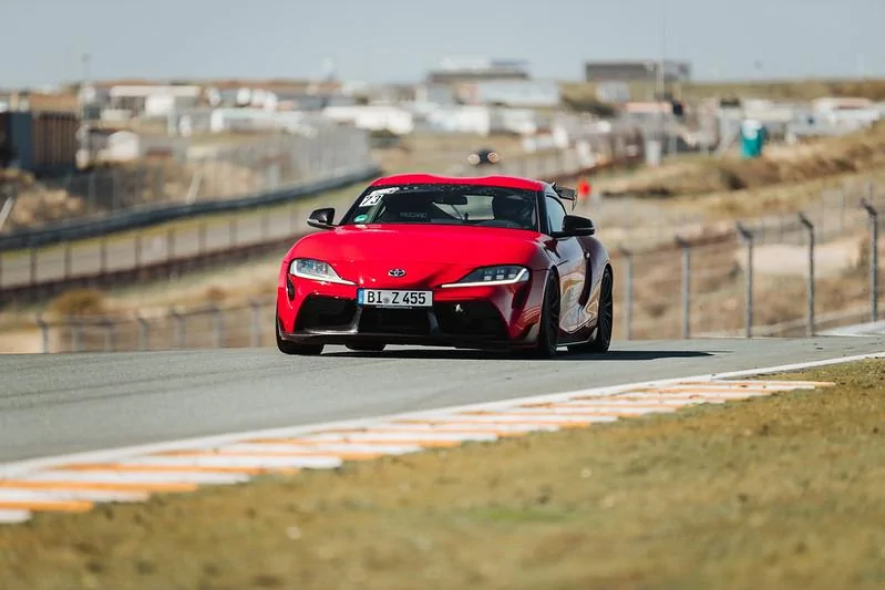

Some trackday photo-material again after visiting three trackdays in the last two months. Good friend of me tried to attack with his 997 GT3 RS. But... Okay, i admit there's no way i could win this duel. Not with 150hp less.:drive:
I'm in love with that car. The fitment of the wheels, the edges and contours of the car. It looks so big and feels so light. Absolutely stunning.
