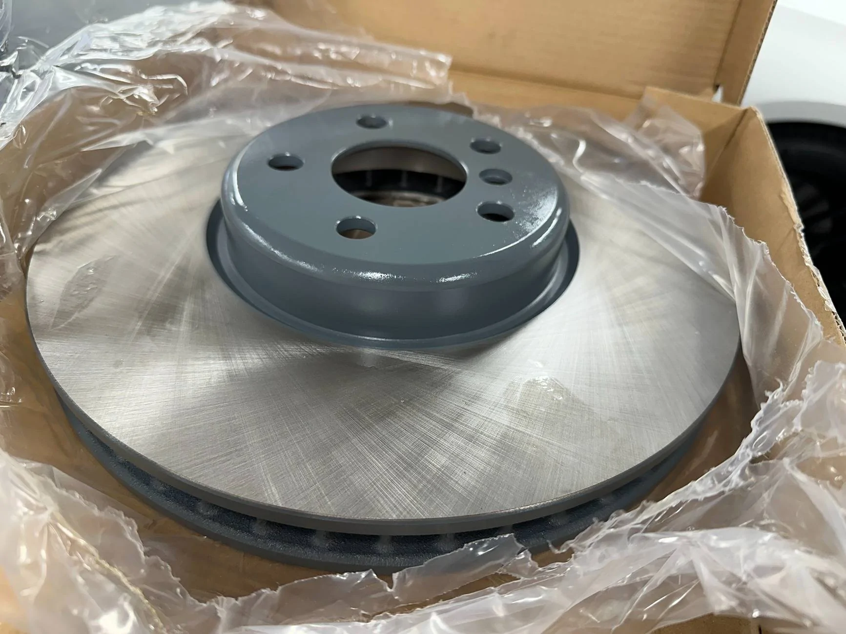

I personally think the cooling gains from slotted or cross drilling are marginal on a ventilated disc. There are issues with cracking on drilled rotors as well. If you're serious about brake cooling it's better to run a brake cooling duct and hosing. Race pads and fluid are fine for 20 minute track sessions even on 200tw tires.
Race pads also chew through rotors so spending more on premium rotors for slightly better cooling or weight savings usually aren't enough to justify the massively increased cost of a wear item. Unless you're actively competing I'd stick with the cheap blank options from Rockauto (or FCP euro) although I'd go for coated rotors.

I just picked up front rotors for $35 each. Yea bois, keep spending your coin on $1200 2 piece EURODICS
CarQuest special babyyy. These are exactly what I just installed with my DTC pads lol. I bought two full sets as soon as the going out of business sale went live.

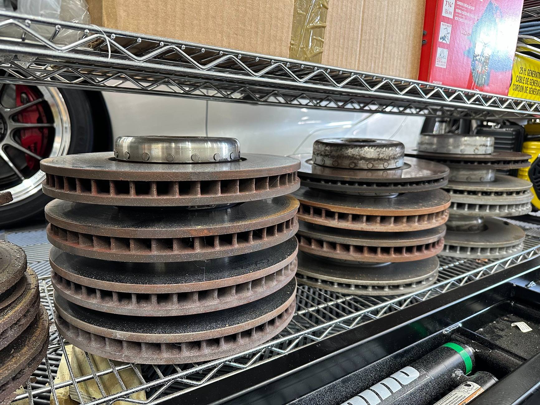

Father is a machinist that can turn it on a lathe probably for me personally.
That‘s good! Unfortunately for most of us it would cost more to do that, than just buy new ones. Plus new rotors would be thicker, last longer, even dissipate more heat having more material…. w/out thinning down the (life) rotor further.

Sounds like the weight penalty from going with a 1 piece fully cast el-cheapo Rock Auto rotor vs. an OEM style two piece (aluminum hat & iron rotor) is not significant?

Oddly the shipping/specified weight was nearly identical. Unless you're actively competing the cheap rotors seem to be the way to go for general tracking. After beating on them on track there isn't any noticeable difference in terms of performance or heat tolerance vs oem.

Yup, Geospec or similar fully coated - rust prone rotors are the way to go. You only buy more expensive ones if you had a vehicle that you are forced to buy ones that are limited production (or getting free one from a sponsor). Many of ”cheaper” rotors are made to exceed OEM standards. Most come from Centric and are rebranded. Economies of scale ? at its best. The cost to weight savings advantage just isn’t there. Similarly I could get lighter pads but they‘d be shaved down, dissipate less heat & wouldn’t last as long. Hence our money should go to best pads & fluid.
