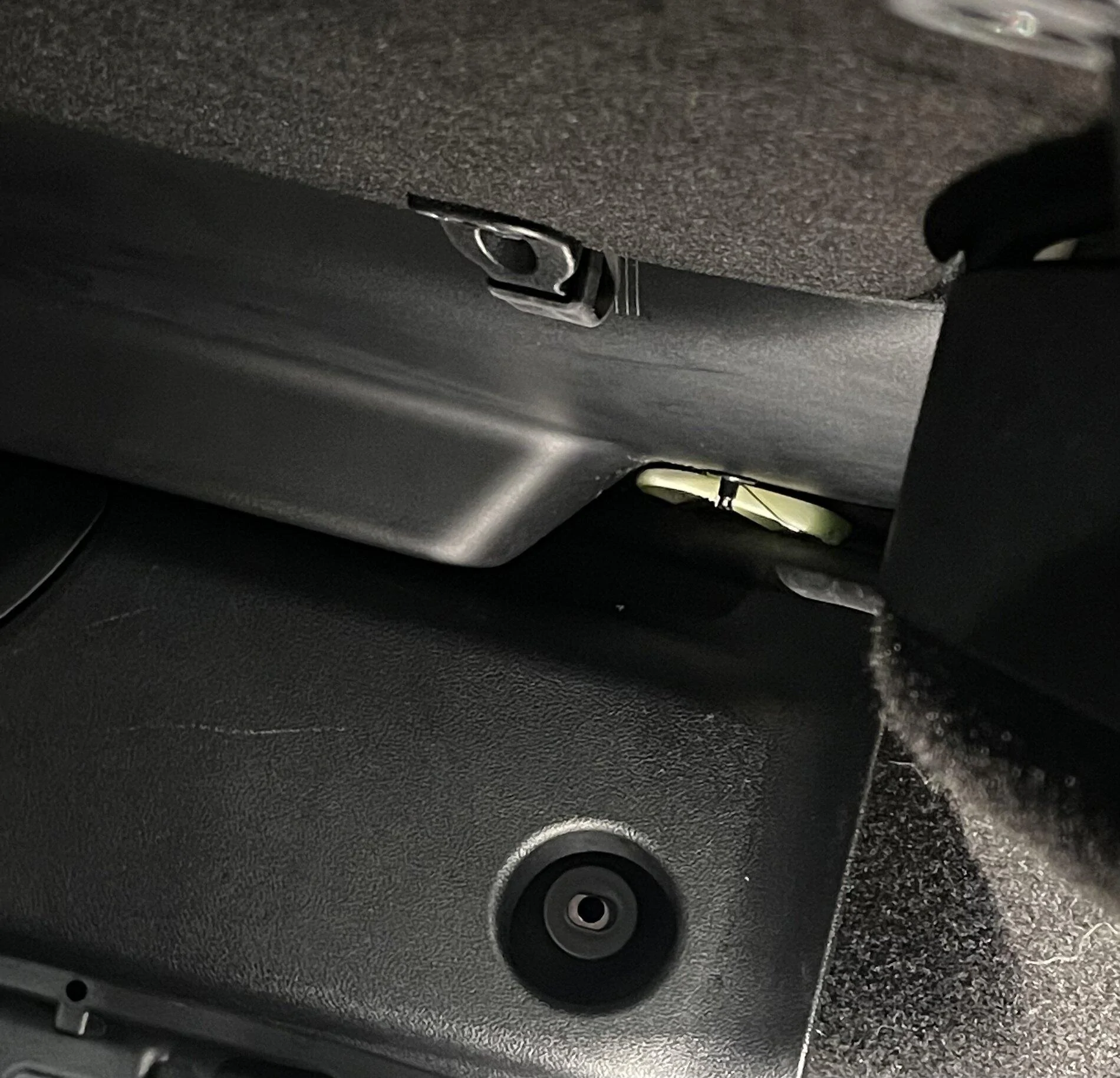

Thanks! I took the car to the dealer this morning and they took care of it in an hour. Lucky for me they had a Supra(BMW)-certified technician with a petite stature so that guy (my hero for the day) crawled into the trunk from the front, torn down a panel and disentangled the latch. Exhausted every bit of strength in that man tho.
They didnt charge me either. Warranty.
I guess my situation wasn’t as bad as some of the others’ coz I could still see part of the emergency latch from the front when it was stuck (see picture attached). Still, needed the dealer to fix it.
The dealer showed me how to stick the emergency latch onto a little black pin on the hatch so that it doesn’t drop down; but I guess it gets loose quite easily so I’d tape it too.
Thanks very much OP and all.
