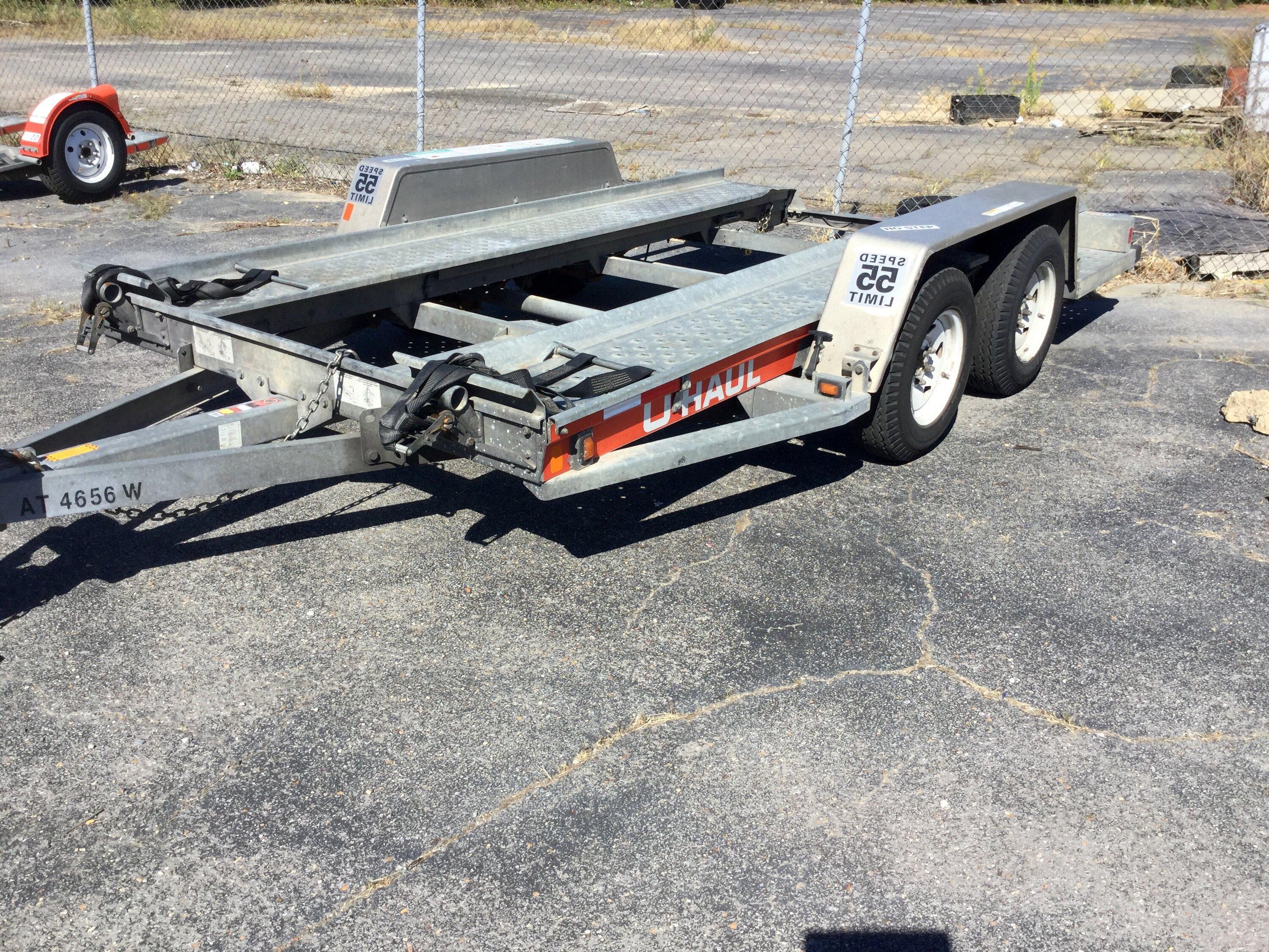

Has anyone transported their vehicle on a uhaul car hauler? If so, did you need to rig anything to get it strapped down/not rip the bumper off? I figure a few chunks of 2x8’s would be sufficient to overcome most typical problems, but want to make sure.
Any pictures or crayon drawings would be greatly appreciated.

The frontwheel stops (lifted angled metal) are removable. Didn't remove then when I loaded my race BRZ up for a move and took a chunk out of my splitter.
Otherwise just lots of wood.

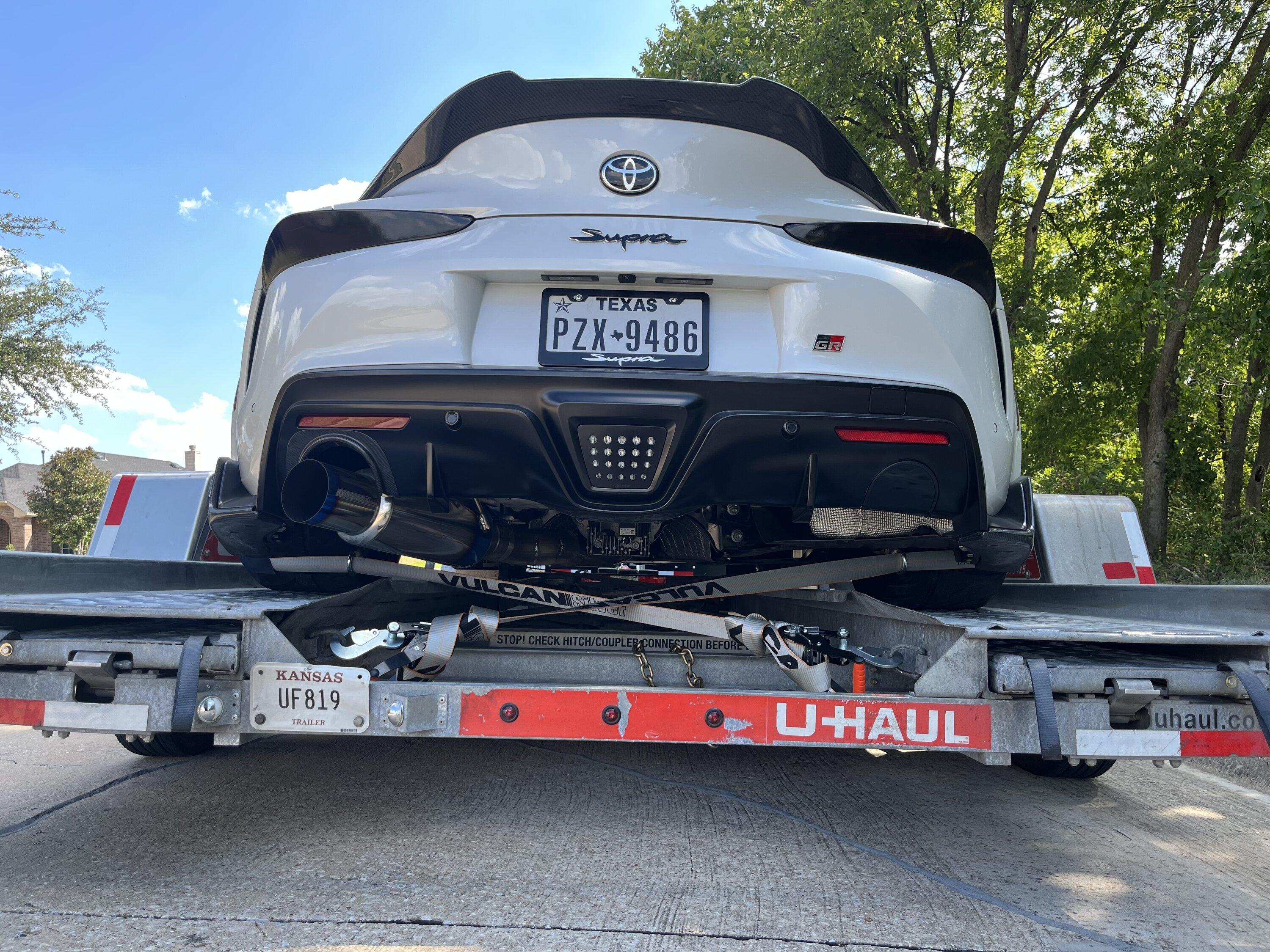

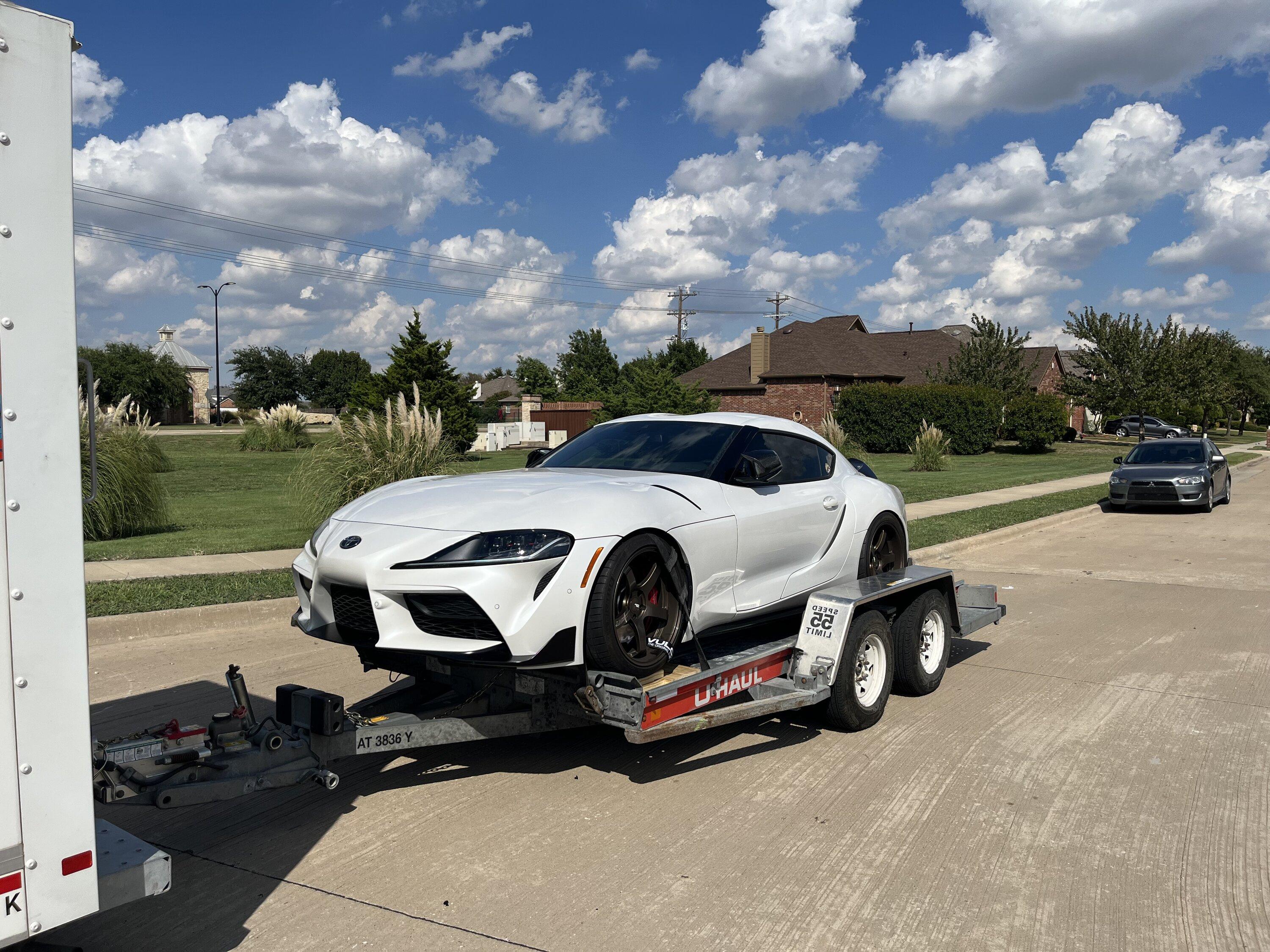

Pulled mine from Dallas, TX to Northern Utah. Just over 1,300 miles. I'm lowered on HKS adjustable and had to use some 2x8's under the end of the ramp to pull the car on and off so I wouldn't scrape. Then as you can see in the bottom picture I used the 2x8s to raise the front so the bumper would have more clearance.

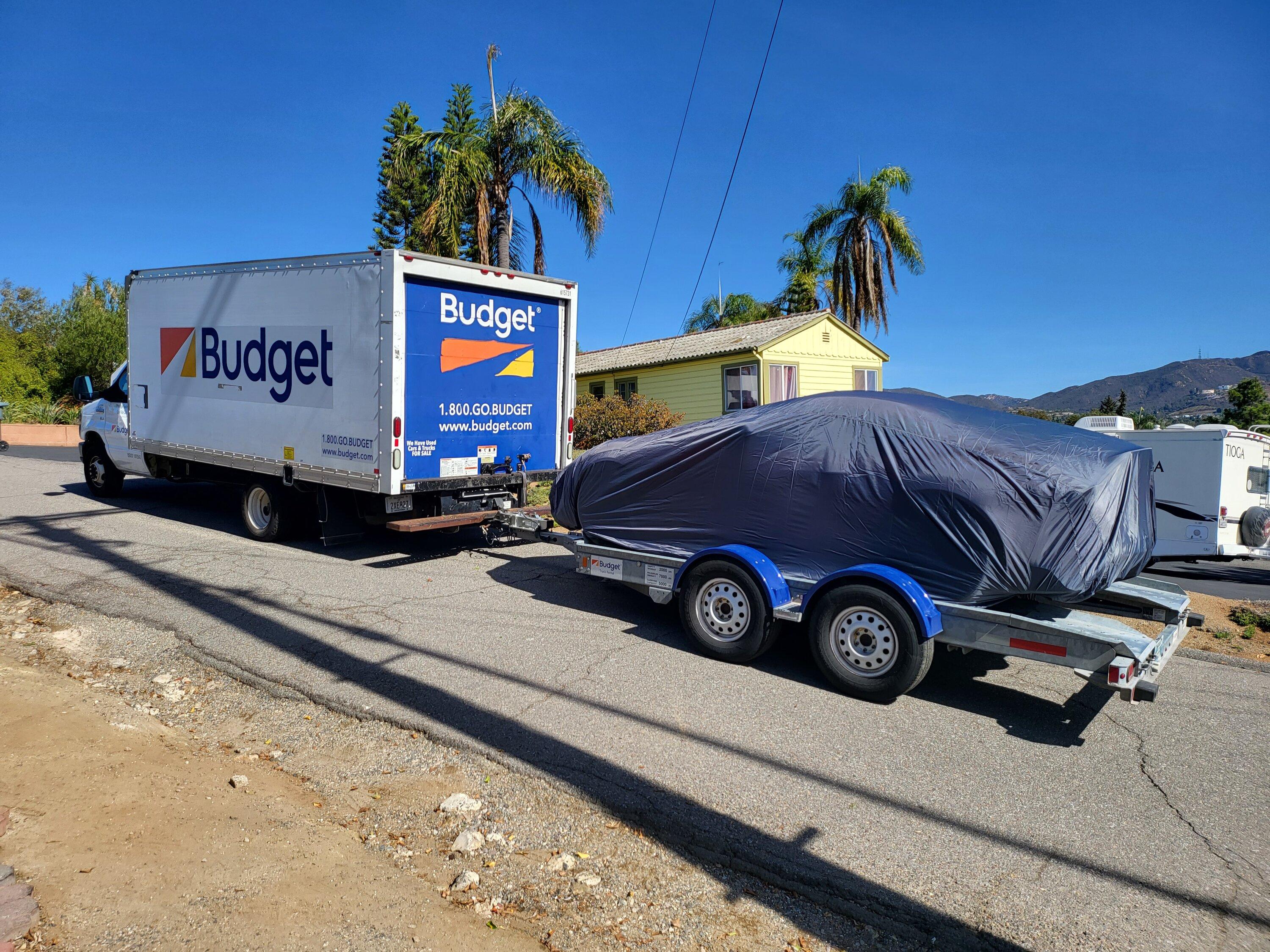

I used one of these to transport from California to Texas. I used some wood blocks to raise the front some as others have said. Driving it up was dicey haha. If you have aftermarket wheels, the strap will rub a tiny bit in transit due to vibration regardless of how well its secured. Also, huge word of advice, don't put a cover on yr car. With the wind, it slightly allowed just enough air to slip in and flap against the hips and other angular parts. It left cloth rub micro scratches. I know in retrospect, it wasn't the greatest idea now, but at the time I only thought of wind and rocks etc. If I did it again I'd take my chances with the open air elements than the rubbing. It CAN be removed, but definitely made me wanna cry.

Good to know. I was definitely planning to leave the cover on.

Glad I could help! Yea, tbh I didn't even think about the fabric being able to leave scratches. But yea from the wind rubbing the material of the fabric, it left the color of the fabric scratched/rubbed onto those lines I mentioned. So on the red there is light gray rub scratches on it :(
