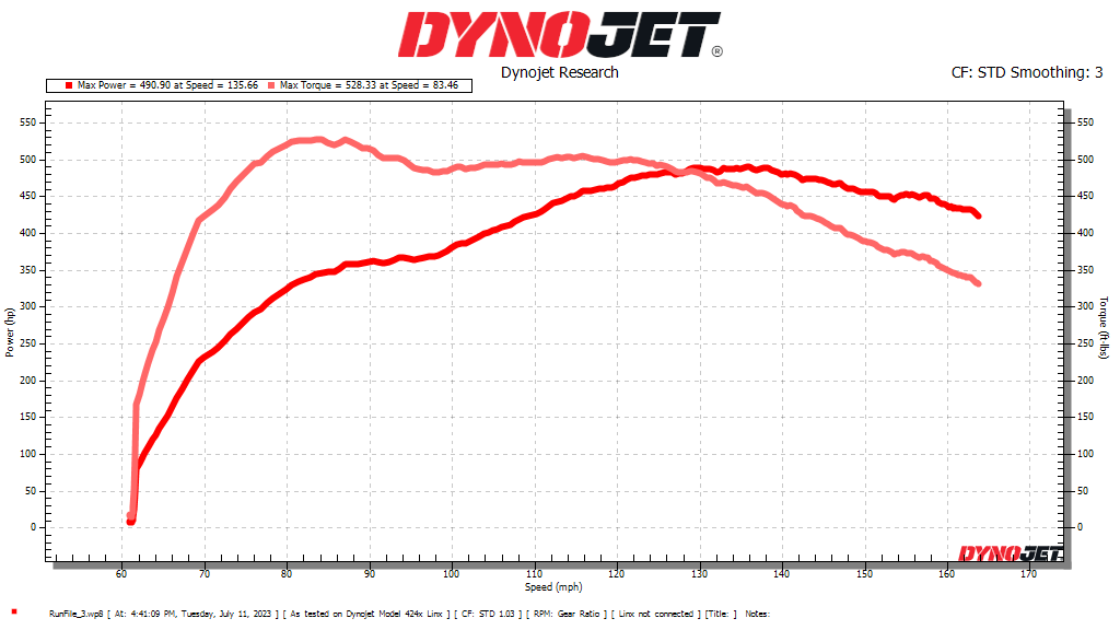

BM3 Stage 2 Flex Tune - E47 Blend Fuel - HKS Intake - AA Catted DP - BM3 Flex Fuel Kit - Temp 89 - 72% humidity
And next up i'm working with Sameh to do a custom flex tune.. when we get that ironed out i'll head back to the dyno and see what else we can squeeze out of this setup with a custom tune vs. OTS ..

How the butt dyno with the new tune - everything you hoped for? Seems like pretty solid #'s from just basic bolt-ons and ethanol (though honestly I don't know what is typical off the top of my head)

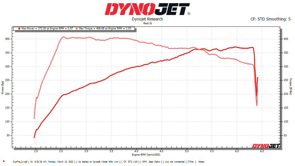

I was hoping to see 500whp .. just because that would sound cooler šŸ˜Ž but maybe if I got my blend up to E50 from E47 and the weather was down in the 70s without humidity šŸ¤· .. any who.. it's still a nice jump from my baseline 372.. I can tell you already though.. this.... Will not be enough haha.. I think I'll end up wanting enough to make me go upgraded turbo, trans and fuel system.. I want to be slammed back in my seat and held there haha
