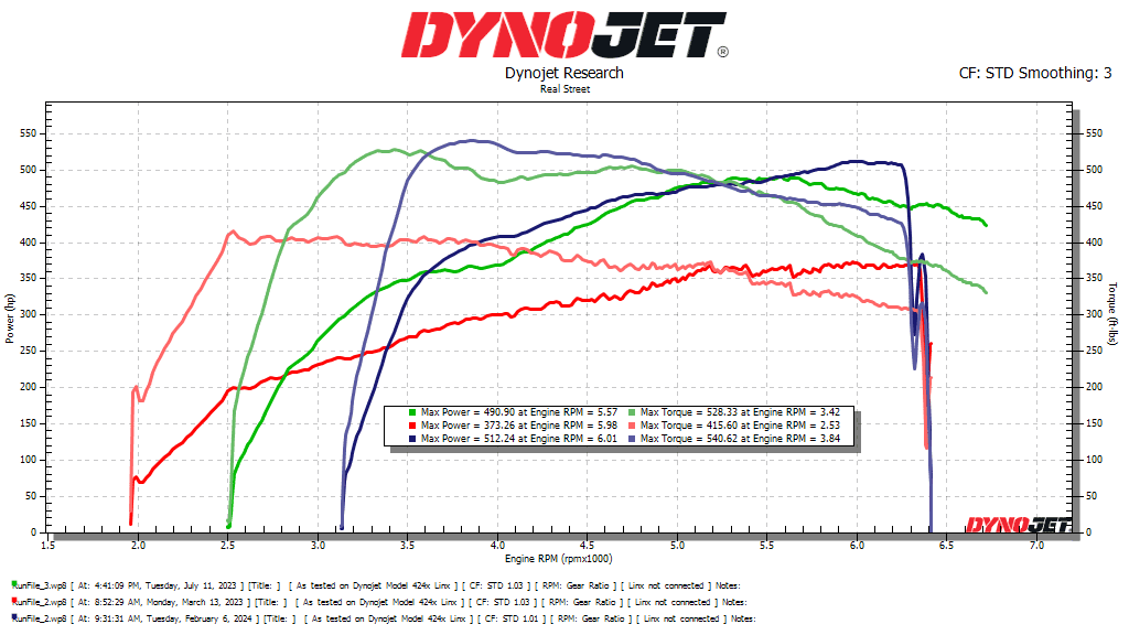

I was hoping to see 500whp .. just because that would sound cooler ? but maybe if I got my blend up to E50 from E47 and the weather was down in the 70s without humidity ? .. any who.. it's still a nice jump from my baseline 372.. I can tell you already though.. this.... Will not be enough haha.. I think I'll end up wanting enough to make me go upgraded turbo, trans and fuel system.. I want to be slammed back in my seat and held there haha
I'm in a similar position and starting my build next week. You'll find that to go from bolt-ons, femto unlock, aftermarket turbo, on stock fueling is a big investment (it's relative for everyone but IMO, that's a pretty big step to get into 500-600whp range. Past that, you're looking at another significant cost/investment as you'll need to get into a built trans, PI, reflex (if you want true DME controlled e-flex), colder plugs, an upgraded LPFP or HPFP, additional radiators and cooling, axles if you plan to launch, and likely an intake manifold, especially if you're in a hotter part of the country (assuming your are in FL). Once i priced out the full bananas build, i stepped down a bit. At the 600+ HP range, you're looking at an entry fee of about another $20k, at least. That's been my experience at least in putting together different build options. Higher you go, the deeper pockets you need and at some point, unless you keep the car for a long time, you get diminishing returns....that's of course just my POV. I want to retire some day, so blowing a pile of cash on a newer car to sell at some point down the line doesn't make a ton of sense to me.
I'd say what the car laid down on the stock turbo was pretty solid.

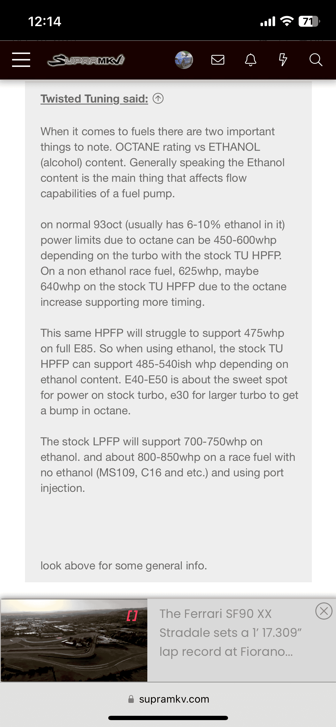

This is the mother of all posts that covers power tiers and needs for the car. The collective community contributed to this from experience, so i think it's pretty well vetted.
https://www.supramkv.com/threads/gr-supra-101-routes-to-big-power.17670/
That post says LPFP is good for 700whp
@Thraxbert says it’s good for 600.
I don’t know who’s right and who’s wrong. But if the thread is correct, an HPFP alone can get you to 650whp.
If the goal is 650 or under, HPFP and PI are roughly the same price.

Lol LPFP is absolutely not good for 700. It's 600ish, which is similar to most 6cyl in-tank pumps on a GDI setup. Maybe the poster typo'd. HPFP is about 550ish.
The source was twisted tuning. Doesn’t seem like a typo tbh. I guess I’ll just push it and find out lol
