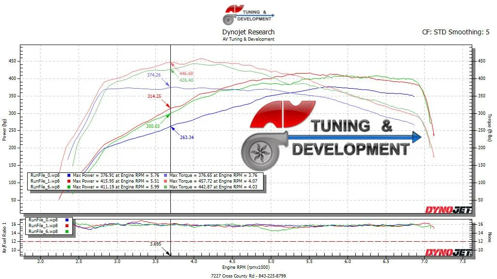

Got the car dynod today after getting a JB4 installed on the map 1 configuration, and disappointingly it only pushed 352 whp on a 5th gear pull, and 344 on a 4th gear pull.
For reference I'm running a catless downpipe, cold air intake and the jb4 on map 1. I was expecting somewhere in the mid 400's but results showing less than advertised for a stock supra surprised me.
Unsure if there's something I did wrong or I had my expectations to high, or if anyone else has also had a dyno result similar to this after installation of modifications.
Yes we were in dyno mode on the car as well as sport mode. Any advice would be appreciated or things to check to see why the results might be lower would be awesome.
Post dyno chart and JB4 datalog. catless DP MUST be tuned for...

Listen to ColonelAdama, he knows his stuff. He helped me get to pretty good power with 415bhp and 456ftlb. This was during a rain storm with shop doors open, about high 70s, on 93 octane Shell pump gas.

Listen to ColonelAdama, he knows his stuff. He helped me get to pretty good power, as posted, with 415bhp and 456ftlb. This was during a rain storm with shop doors open, about high 70s. This was on 93 octane Shell pump gas.
The only thing I don't see often mentioned often in these threads is a different spark plug and gap recommended by BM, specifically a colder heat range plug with gap at 0.022".
Thanks!
~40whp/~60wtq gains are pretty spot-on for JB4 on 93 octane. Of course it is only the gains that matter and not the overall number, as it is dyno dependent.
