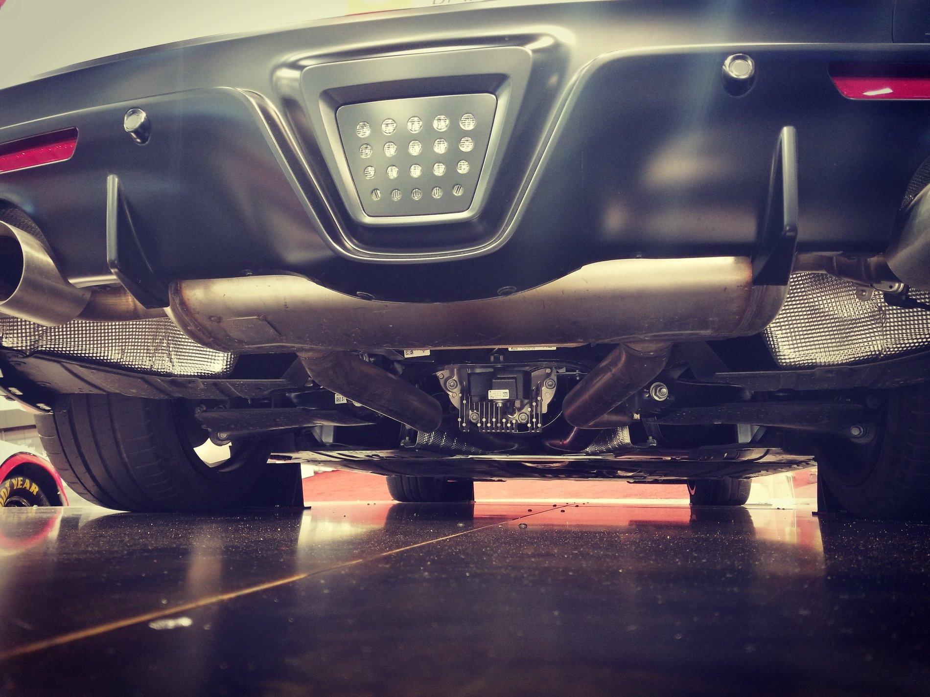

Im late to the party, but i looked at this a little but at the DFW auto show. The exhaust is the most obvious point. It appears that 30lbs could be saved fairly easy at a low cost. (keeping cats)

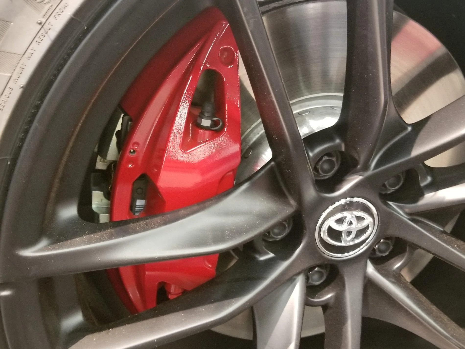

Second was the brake rotors, and this was confirmed by one of the aftermarket companies tear down video for measuring. (do not remember stated weight. 23lbs?) I belive 4lbs of unsprung can be saved here per corner. (16lbs)
Some other obvious points are the wheels, (10-12lbs) move to a lighter weight battery (10lbs for an affordable braille aka deka)
Is the exhaust the system the same for US to Europe?
Watching the reviews between Virginia and Madrid it looks like the US version you can hear it louder and when they shift that fart sound i cant hear it in european reviews.... Im not an expert but looks like the european supras I cant hear that farting sound when chaging gears maybe they quit that.
These are just the obvious places and conservative estimates. there are other places that would grant substantial savings such as seats but I do not have a estimate of what 9000 way adjustable seats come in at. my best guess would be about 55lbs as i know the oem manual seats in the FR-S is at 40lbs.
Aren't the wheels already forged from the factory? I doubt you can save 10lbs by going with an aftermarket forged wheel. Maybe 2-3lbs at the most.
