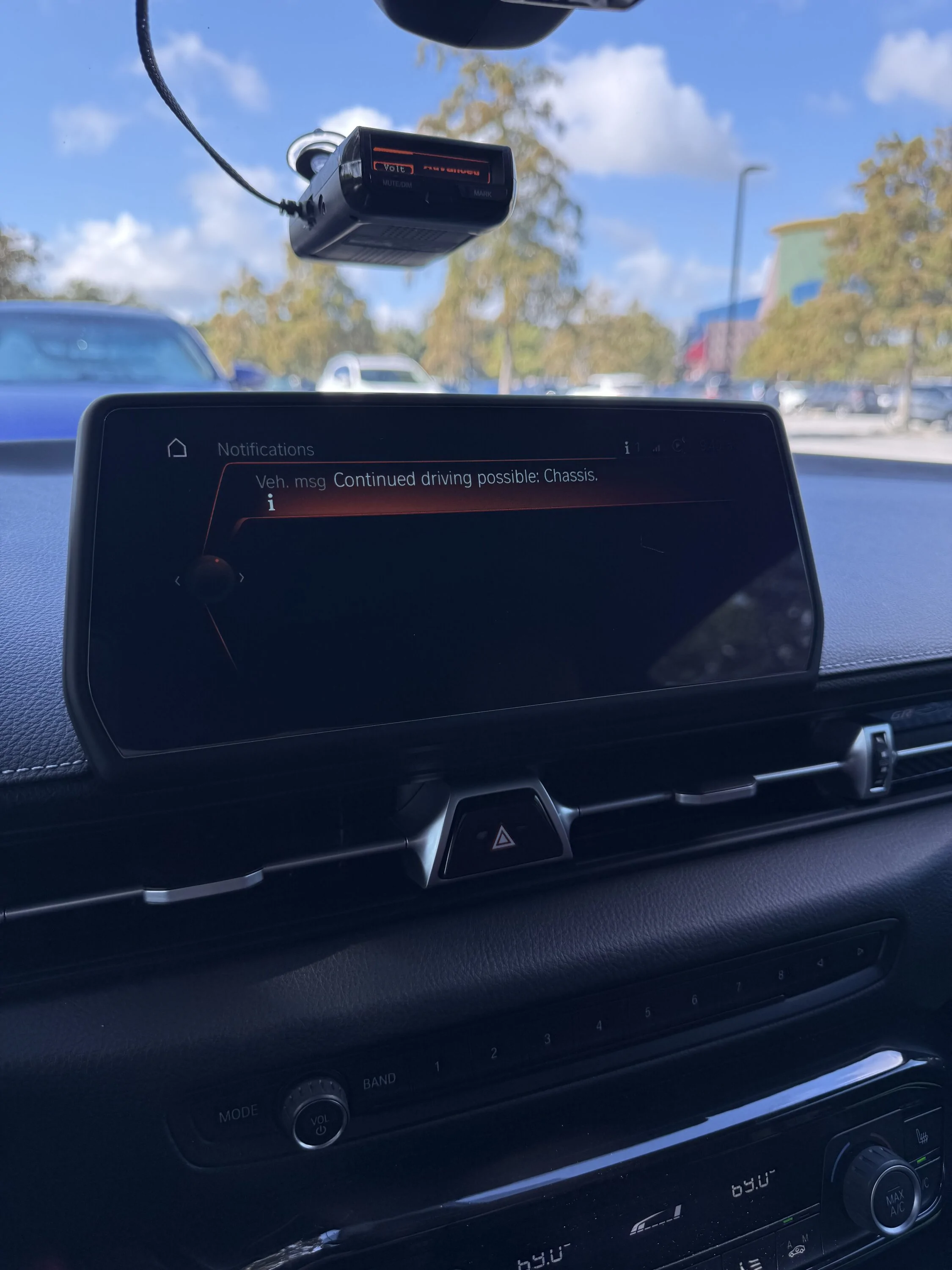

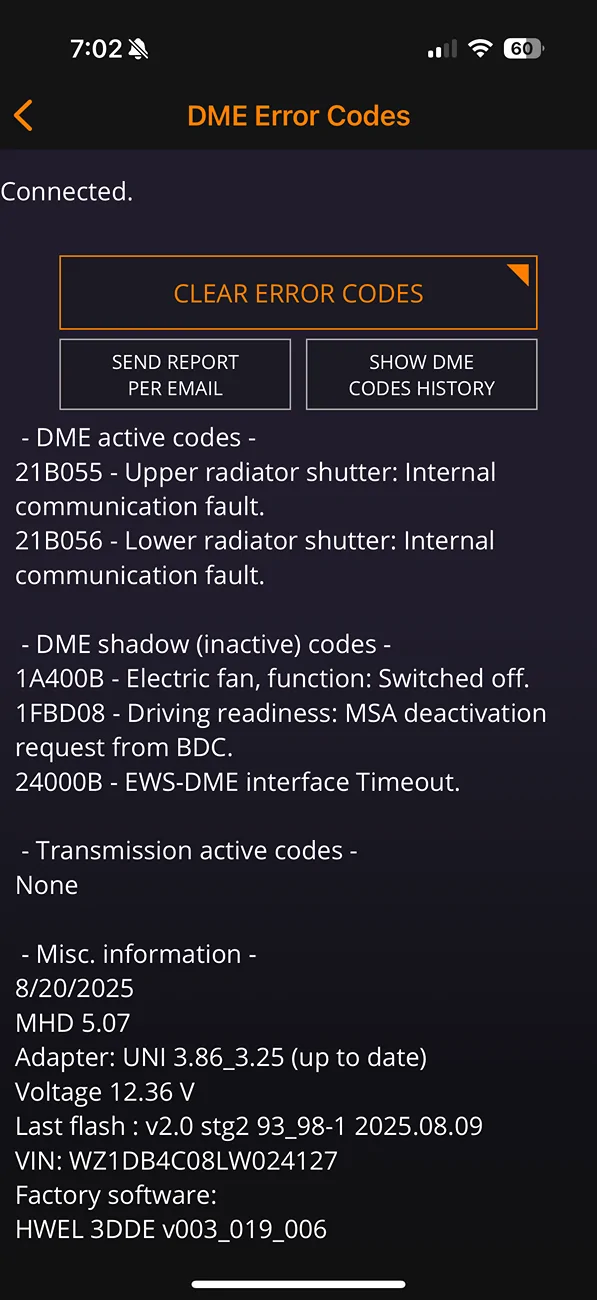

Updated with Codes - Random Issue after suspension upgrade

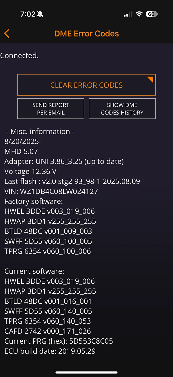

No. Thought about it but after I fully cleared the code with BimmerLink and it came back I didn’t think that would help.

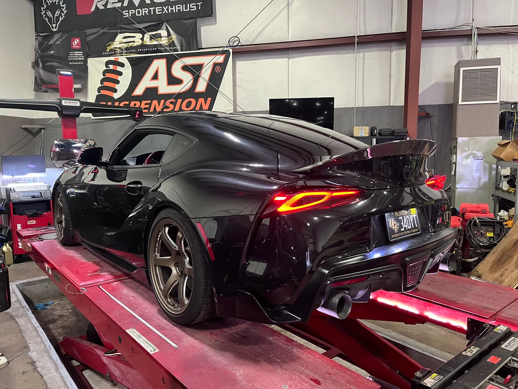

She’s in the shop now.

Well, time will tell. Shop raised the car 3/4 inch, and did a full code scan and test of the ride height sensor. Sensor passed tests, with no issues. they double-checked wiring to the sensor, no damage. They cleared all codes and said that maybe the ride hight was a touch too low and it was causing the sensor plausibility reading.
No charge for any of the work, so I'm not going to complain. Happy to build a relationship with a quality shop/team that will dedicate time and resources and not charge me and arm and a leg to troubleshoot.

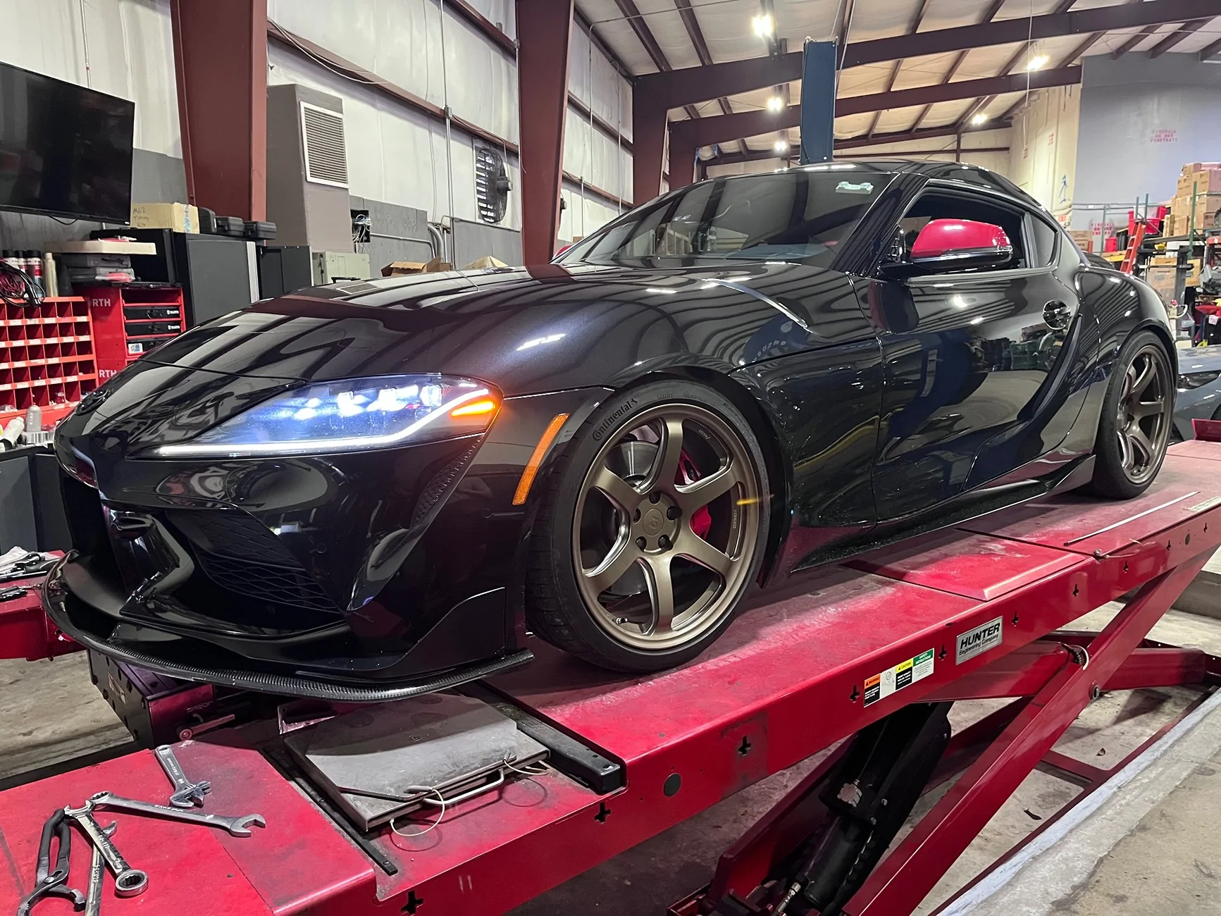

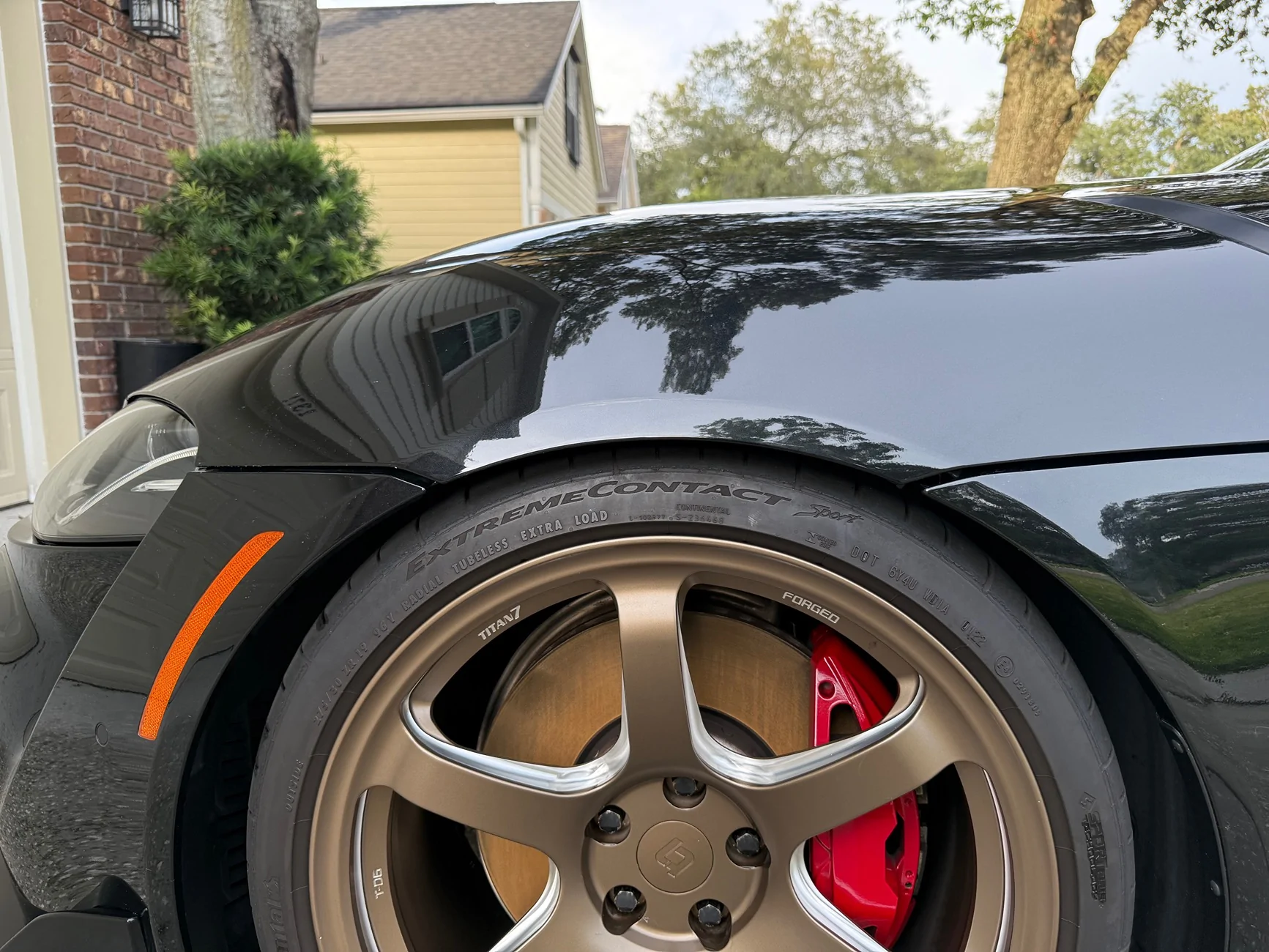

You raised it 3/4" of an inch? How much lower than stock was it?
Picture below was day of installation. Less than a finger off the front tire. Front tire is 275/30/19. Springs installed a month ago settled more than expected after 2k miles on the road. She’s back where I want her now. If needed I can go back to stock height.
I will get it dialed in eventually.
