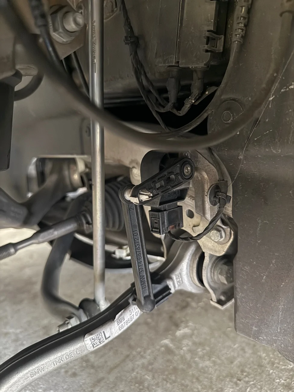

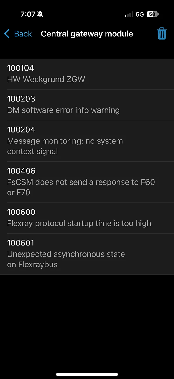

So I inspected all four corners of the car this weekend... no visible issues. Ride Height Sensors are undamaged, and in proper orientation, see no problem there. All other lines and wires appear undamaged. Had no issues with notifications over the weekend, or on my drive to/from work on Monday. Today's drive in was fine. Drive home, got the same chassis error. This time I used MHD app to scan codes before I shut the car off, nothing reported back, no new codes or anything different than the last scan posted in pictures above. Shop that did the install of the suspension (BMW specialists) feels in could be a failing abs/wheel speed sensor. I have an appointment 9/9 to have the troubleshoot.

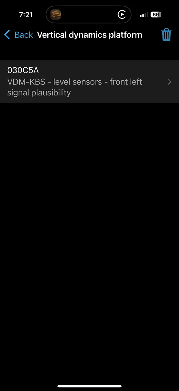

OK... no issues on the drive in, but on the drive home again, chassis error. Before I shut the car off when I got in the garge, used Bimmerlink to pull codes. Here is what I have:
030C5A VDM-KBS - level sensors front left signal plausibility
800ABF KAFAS camera: field of views temporarily disturbed
D90D54 NFC reader inside front: Unexpected CAN participant
21B055 Multiples DOBD message AKKS 1 (OKE): Internal communication error
21B056 Multiplex DOBD message AKKS 2 (UKE): Internal communication error

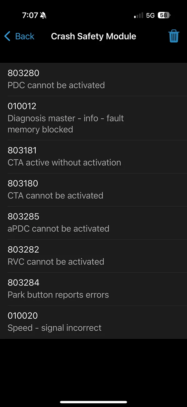

And these:

Check to make sure the plugs for the ride height sensors are fully seated. They can be deceptive. When I first installed my HKS HAS springs I got that error and realized I just didnt fully seat the one connector. That would explain the intermittent nature, albeit i would expect it to happen more often and with bumps. Either that or check to make sure all the pins are properly fully engaged in the plugs. You might be able to tell if some of the individual boots for the pin are pushed out.

Doing brakes tomorrow so I’ll pull and reseat them all. Alignment appt is Tuesday so can have it all doublechecked.

Sensor appears fine and fully connected. I’ll leave it to the experts at the shop to diagnose.

there might be a height sensor calibration. its detecting that your car height is out of spec maybe cause car is lowered?
Yeah, I've been searching online. ISTA may be required to recalibrate. Interesting though... I'm low, but not slammed and it seems to pop the warning on smooth interstate with little to no chassis movement.
I am raising it about 1/2 to 3/4 inch on Wedesday and getting a new alignment. Love the look, but I'm scraping front lip every time I leave my driveway. I've got the code captured from Bimmerlink, so we'll have a chat and see what the shop suggests. Willing to replace and calibrate if it will solve things.
