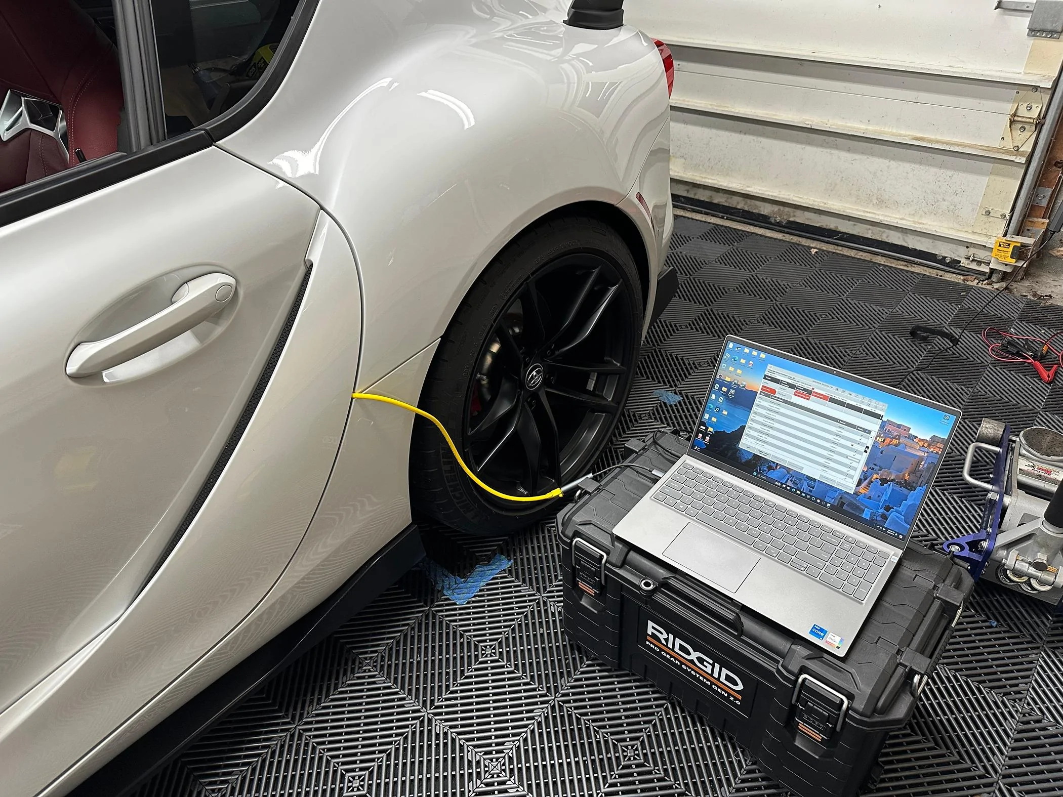

Took matters into my own hands because I don't trust dealers. Full reprogramming and update of all systems via ISTA.

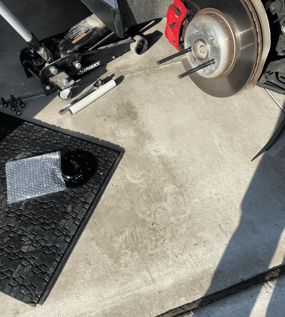

- Signed up for the first track day this year ✅ (Grattan Raceway, MI. See you there if you'll be there on the 14th or 15th)
- Spacers Installed ✅
- New tires installed ✅
- Verus turbo heat shield ✅
- Verus diff cooler ✅
-Verus brake brace ✅
- still wondering about what oil to use ✅ (Liquid Moly 5w-30 is what I'm using right now)

Can you explain what this really means for the layman?
ISTA is the same software tool that the dealers use to update systems in the car. Same as when they perform software update recalls (like the brake recall). I just did it all in the comfort of my own garage.
level of difficulty? something i've been wanting to do as well..
oh. did you refer to this thread?
https://www.supramkv.com/threads/an...step-update-yourself.13044/page-5#post-342551
Actually pretty simple. You download ISTA and Techstream from the website links outlined in that thread. You pay for a license. You can get a couple days, a month or a year. Make sure you have a +70amp charger (not a trickle charger) set to constant 13.5v and then use a laptop to connect to the car via ENET cable. Then follow the step by step in with ISTA software, which is very straight forward.
One thing to note is you need to have the OEM seats in the car so ISTA doesn't get pissed not seeing the seat modules. I had to reinstall both my OEM seats to do the updates. This was actually the hardest part of the process as it was actual physical labor. ;)
This part is not optional unless you want to risk turning your car into a paperweight for the next few months. You've been warned everybody.
8,675
17,006
I used this guy from Amazon for $175: https://a.co/d/9NZI116
Delivered in a day. It worked like a champ, never dropping voltage through the whole process. Also had no voltage warnings from ISTA like some others have stated they have had.
