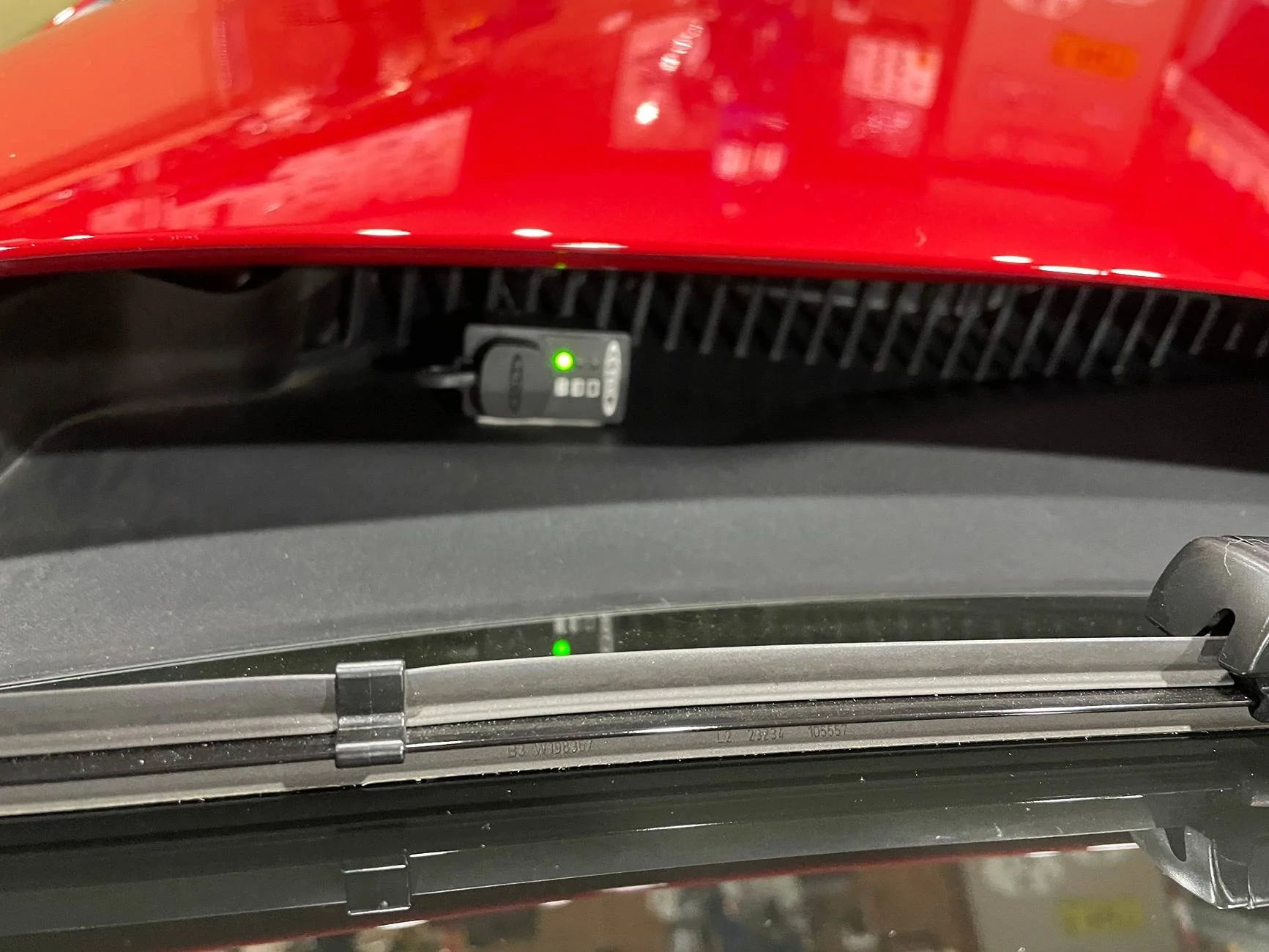

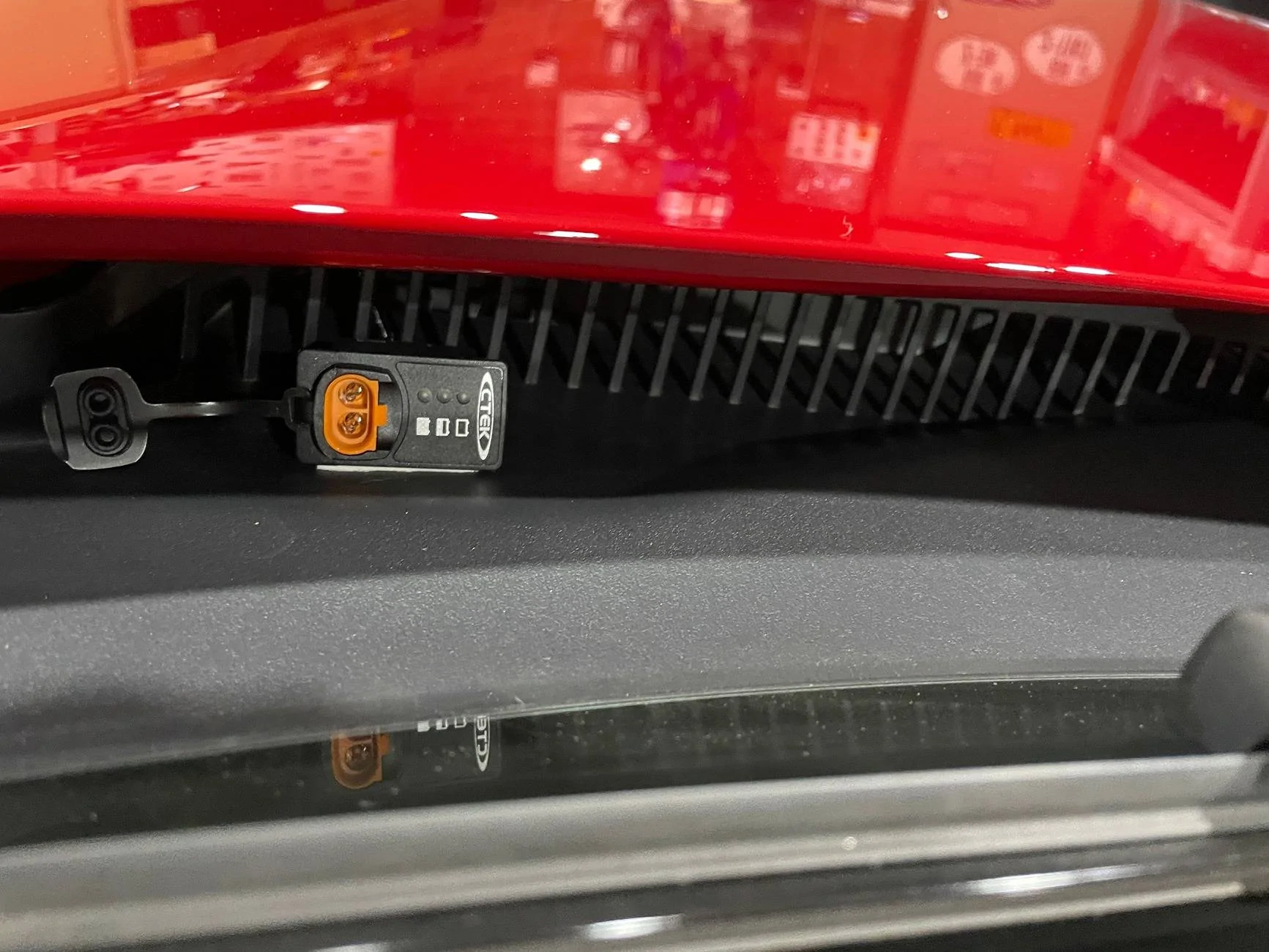

Mounted one of these up the other day. Light flashes once/second green, orange or red depending on battery condition. Means I don't need to open the hood to hook up the charger and no need to leave it connected all the time. Would be an even easier install on a LHD car. Some black DS tape would also look nicer but white was what I had.
https://www.ctek.com/uk/battery-chargers-12v-24v/accessories/car-accessories/indicator-panel-1-5m
Damn that’s sweet. Do they sell them in a 5 pack?

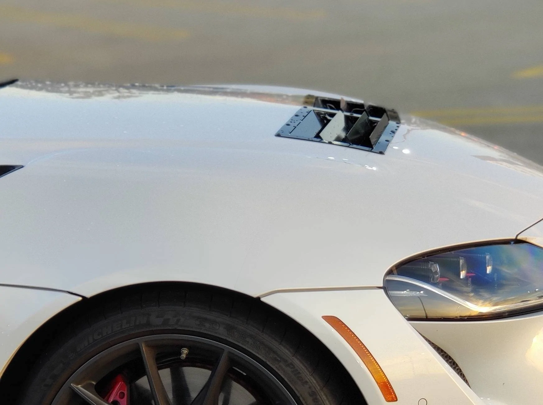

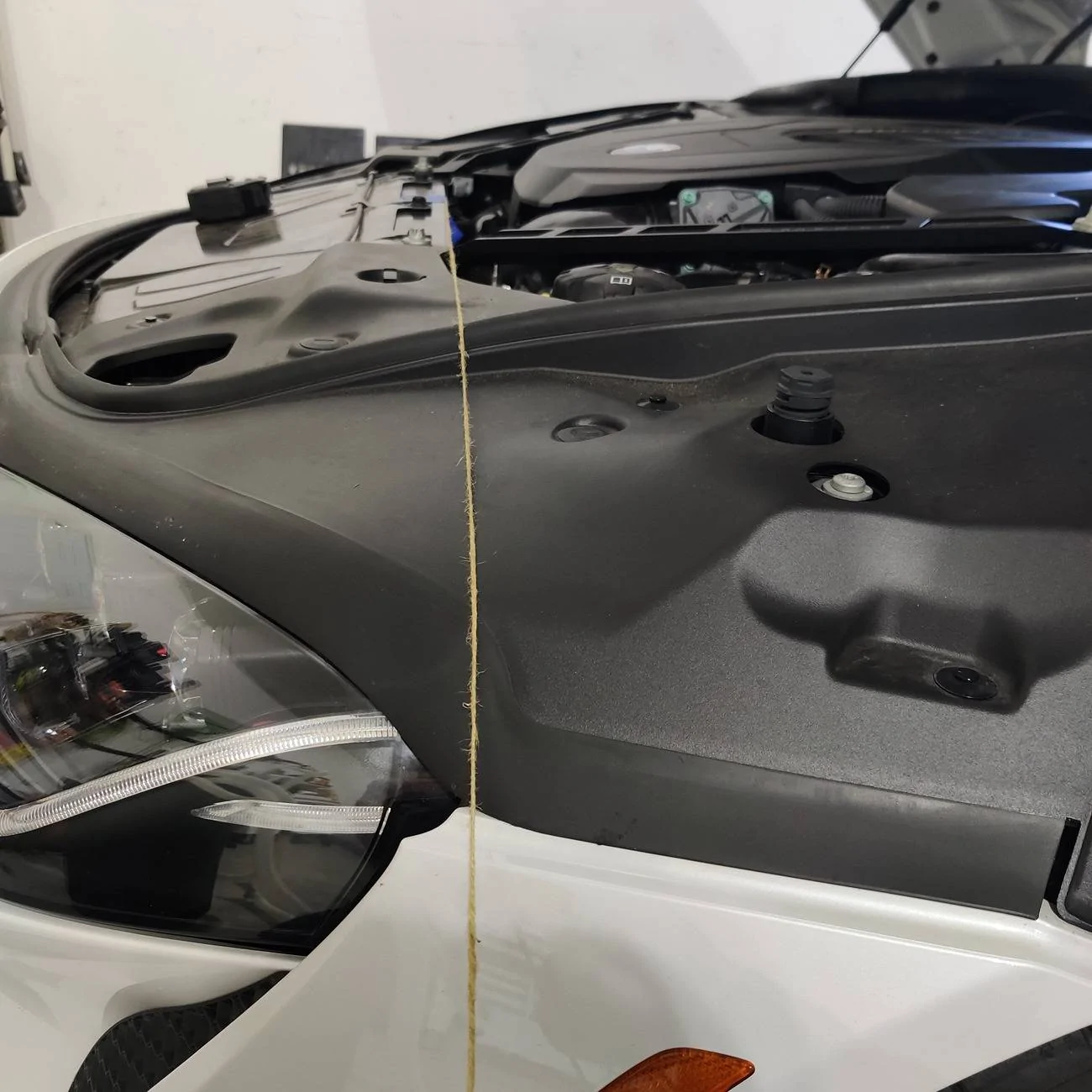

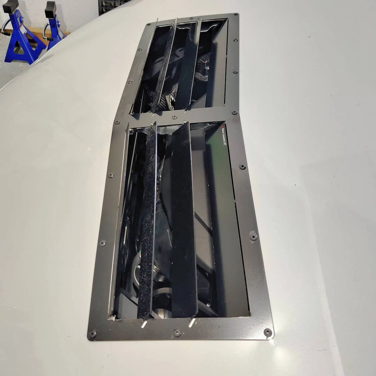

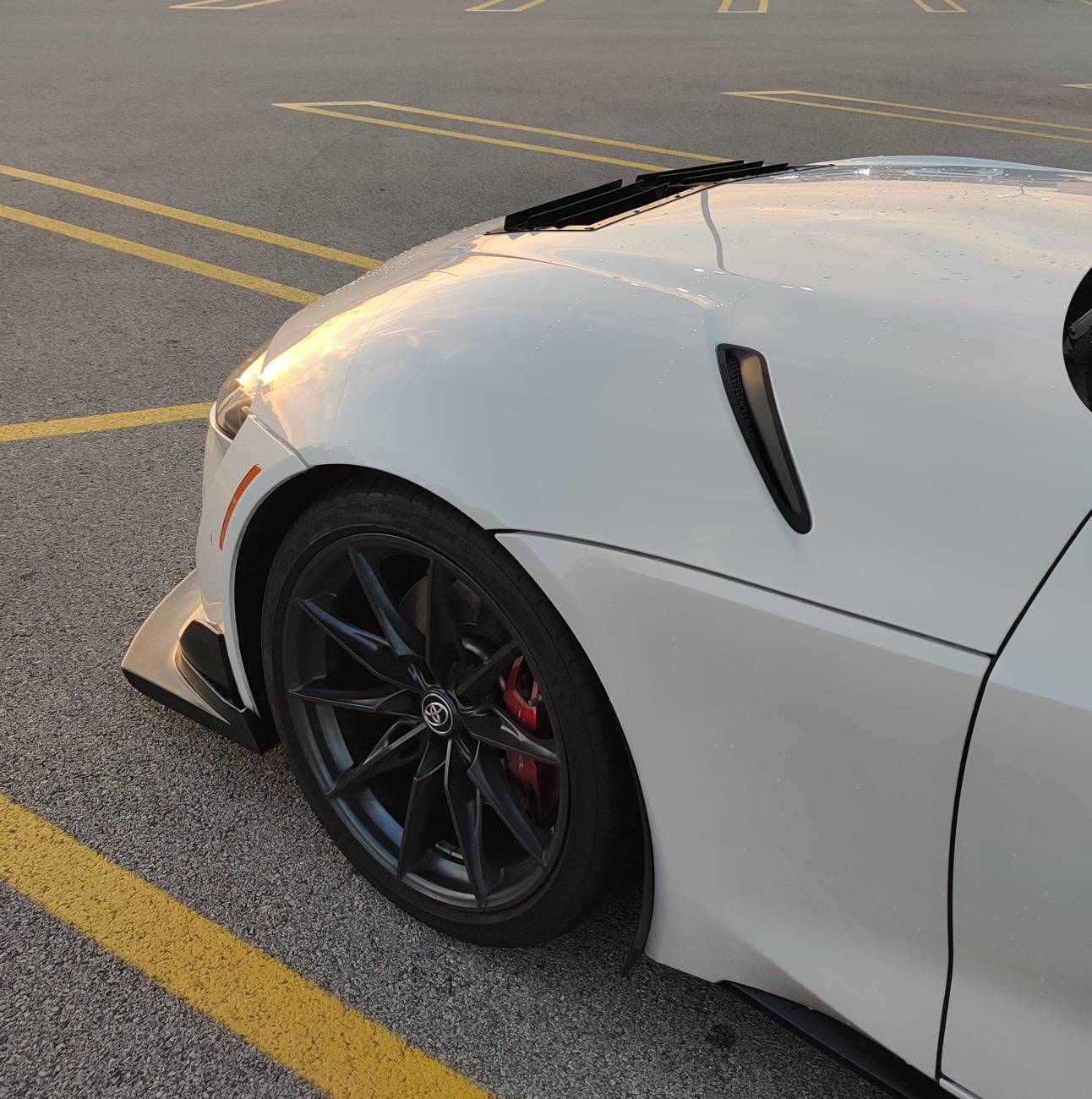

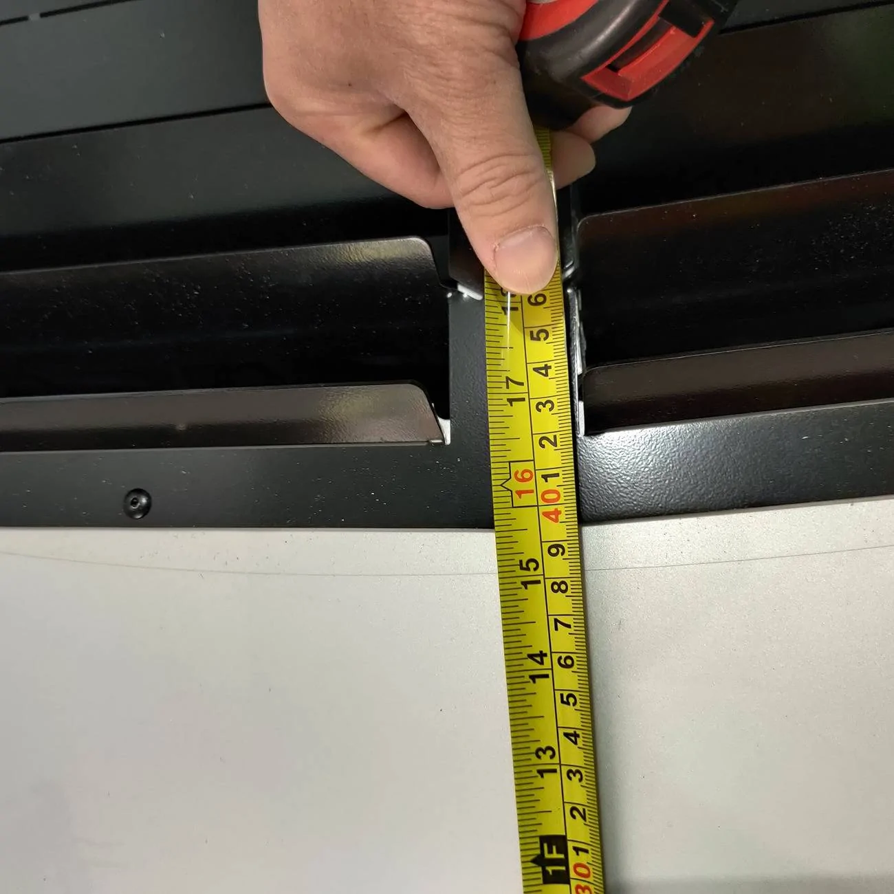

15.5 inches to the edge of the hood will align the gurney flap of the racelouver vent with the rear edge of the rad cover plate. most folks are mounting the triple seven vent 18.5 inches back, but Albert @ RL says 2 inches behind the rear plane of the radiator stack is ideal. since the rad plate extends back 3.5 inches, this seems like a nice compromise.
this is the 30x9 version. there is also a 30x14 variant but albert says he doesn't really recommend that one much because it can make some hoods too floppy.
This is why I don't cut my hood - all the measuring devices in the world and it's still crooked. You might be able to straighten it up a little if you trim the edges and twist it a tad bit. Other than that - good luck and looking [pretty] nice.

Where did you connect it to?

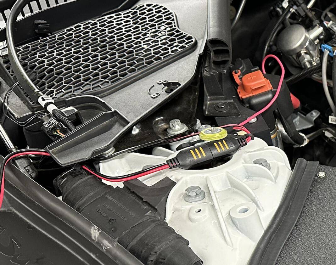

It connects to the positive block and a ground in the engine bay. I have basically the same thing, just underhood.

Which ground in the engine bay? I usually use the post above the fender but not sure the CTEK terminals will fit.

There is one in the cubby underneath that honeycomb plastic thing in my photo I posted.

Wow, that's clever - I'm definitely tired of opening my hood and clamping to the contacts every time. How did you connect the eyelets to the posts? And where did you route the wires? Do you mind showing how you did it?

I'll get some images under the hood for you but it will be different and easier on a LHD car simply because the the wiring is a much more direct run from the passengers side to the remote battery terminal. On the RHD drive car I ran the wire across the firewall tucked into existing holders and to the positive post and cut a small section from the positive plastic cover so it still clips on with the lead terminal attached then shortened the negative lead and earthed it under a strut bolt on the passengers side (drivers side on LHD car)

Yeah, would love to see images to help guide me - thanks in advance!
