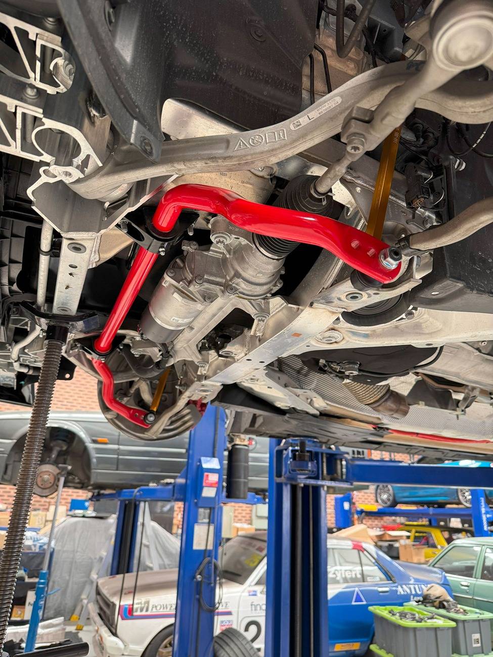

F&R Eibach sway bars. Holy smokes, what a difference. Even with both on the softest setting the improvement is huge. This is exactly how I wanted the car too come from the factory and TBH, I was a little underwhelmed when it arrived feeling so laggy and soft. It now feels planted, direct and the change of direction is razor sharp. Like it's been to the gym and had a few weeks off the booze.
As this is not a track car maintaining ride quality was important. It is definitely all round a firmer ride now but not to the point where it's uncomfortable. Also, anyone that tells you that sway bars don't impact ride quality at all is talking out their ass (many, many people have told me this over the years, it's just not true).
Honestly one of my favorite 'bang for your buck' performance upgrades so far. If you love to drive, seriously consider this upgrade.

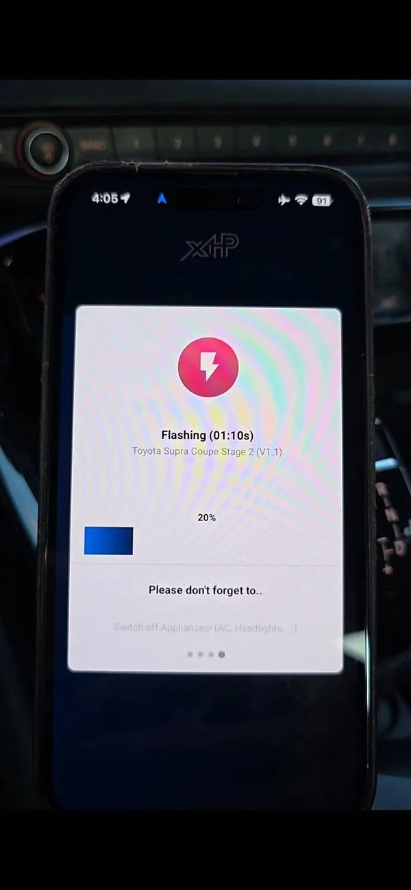

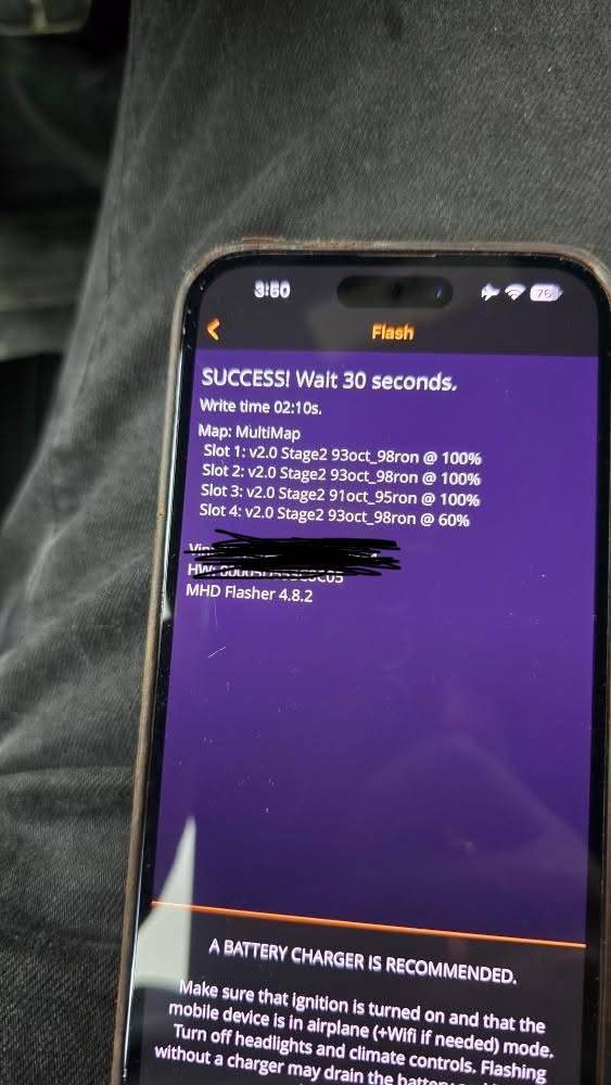

after 60,000 miles on stock tune, I recently tuned MY2020 on mhd+ stage 2 and xhp stage 2.

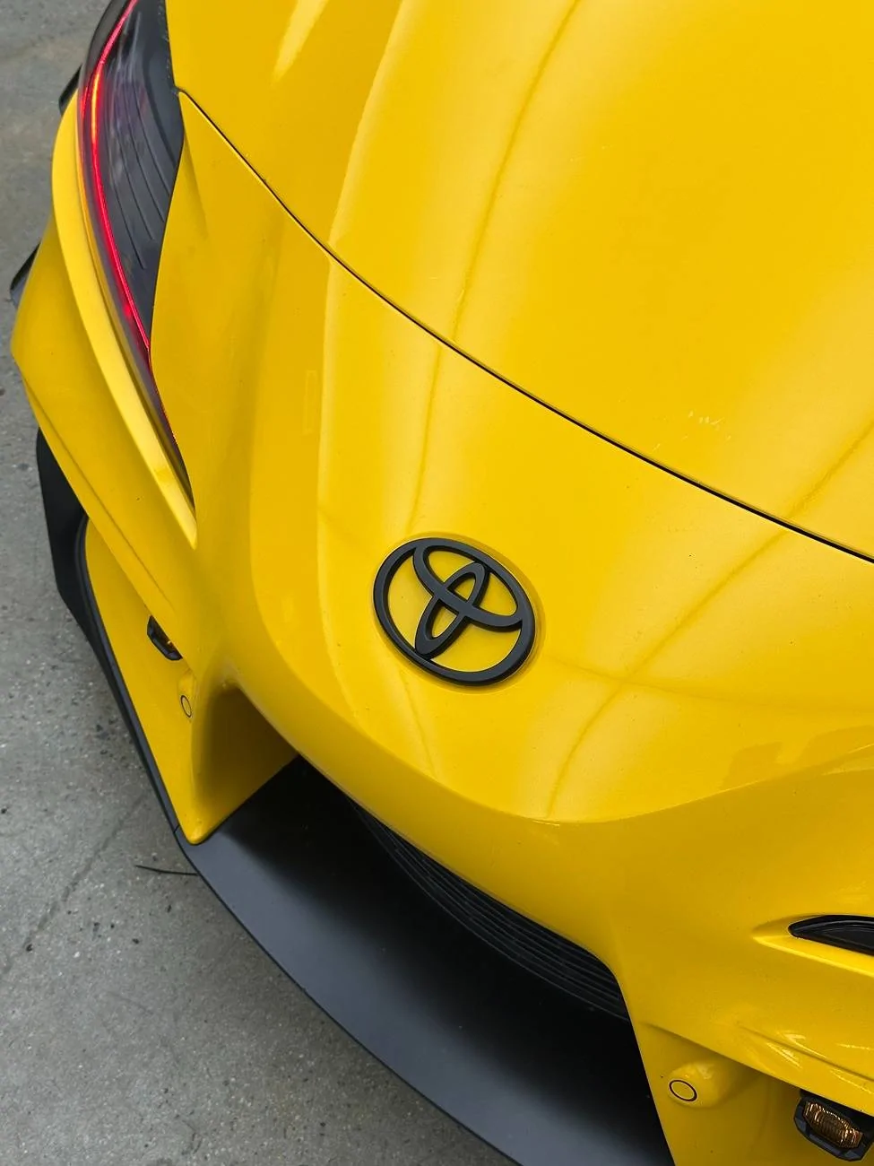

Also, I upgraded the stock toyota emblems.
also the car sounds good with burbles turned off

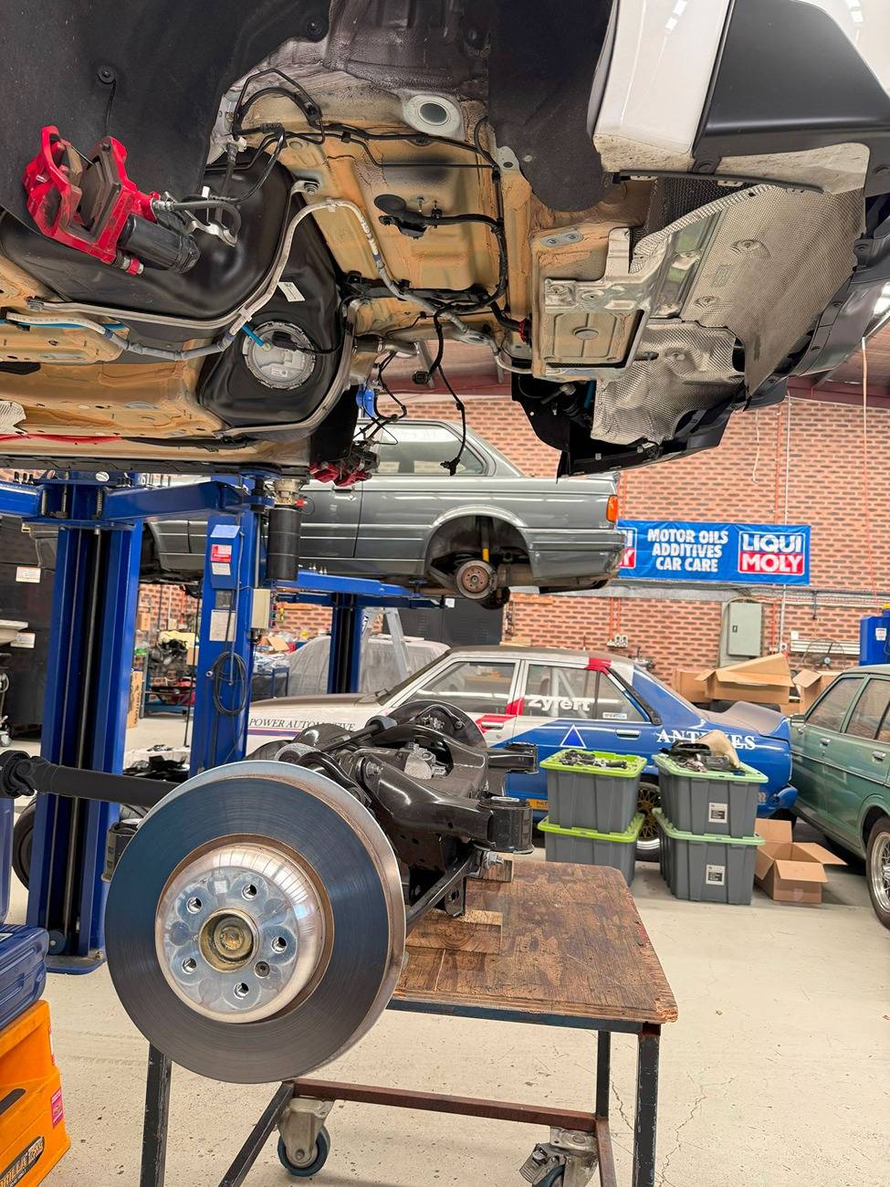

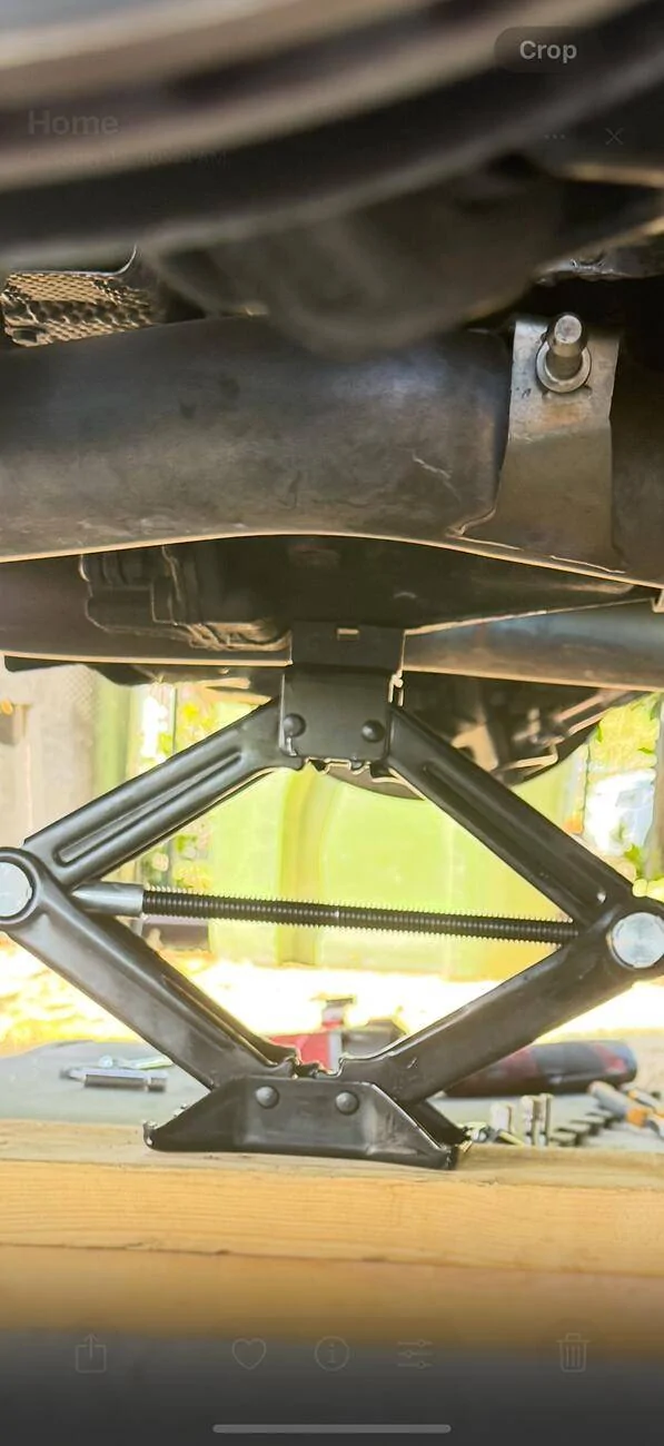

~ Well done! I installed the front eibach bar but the rear looks like a lot of work dropping the subframe / rear end.
Some do and some don't recommend adding the rear bar on this particular car. Is it because of the added work or it's not necessary?!? I'm honestly not certain.
I ran half a the track season with front only. The rear really made the car feel more planted, but I don’t think the z4 is as stiff as the Supra. My car used to creak a lot approaching curbs at an angle when it was front only.
It was about 3.5 hrs in the driveway. Lowered the subframe just enough by using a scissor jack, and used a few guides along the way. I liked the way the car drove with just the front, but I feel like the labor is the biggest deterrent for most.

I took it to a shop that prep/tune/build a lot of BMW track cars as well as do complete restorations. No way I was trying this myself. The guys there said that a lot of people just lower the rear subframe a little to wiggle the bar though, but for the sake of removing just a few more bolts they can lower it completely and get proper access.
I wanted to do both because I was really happy with the relationship between the front and rear of the car in it's stock form, I just wanted it tighter all round. I figured the only way to achieve that would be to do both. Also, if by adding bars I were to introduce an imbalance that I didn't like, then by having both adjustable I'd have the ability to tune it out.
I must admit, when they sent the photo of the rear end missing I experienced a wave of nausea, but after getting the car back I'm thrilled.
