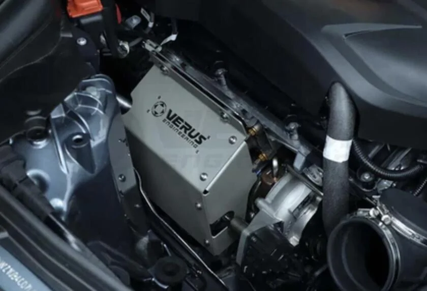

Fitted Verus caps and heatshield today. That bottom bolt on the heatshield was a PITA to thread in. Fortunate that I have piano hands, so I managed to squeeze it in there.
the verus heatshield can be pre assembled prior to installation.
it'll slide right over the wastegate arm.
even says to preassemble before installing but people still be trying to assemble it on the car. turning a ~10 minute job to a 30+ minute job lol ?
I followed Versus own install guide on YT. Nothing was mentioned there about preassembling. Might be a difference between 2 and 6-port?
This is what I did. Made installation a literal no brainer. Did the heatshield install when I did my AA downpipe. Was a literal breeze ?
You can't preassemble the 2 port version. That one side piece goes over the wastegate actuator rod. You'll get faster after you take it off a couple times. I have it down to a science now. Maybe 5 minutes.
The verus youtube video says to assemble on car. i made a comment that said you should do it before but was met with a sarcastic response
Ya'll saying this aren't realizing he has a 2 port, which you literally cannot preassemble before installation, per my reply above.
clarification. verus 6-port youtube video says to assemble on car, and
i acknowledge the 2 port design is different
