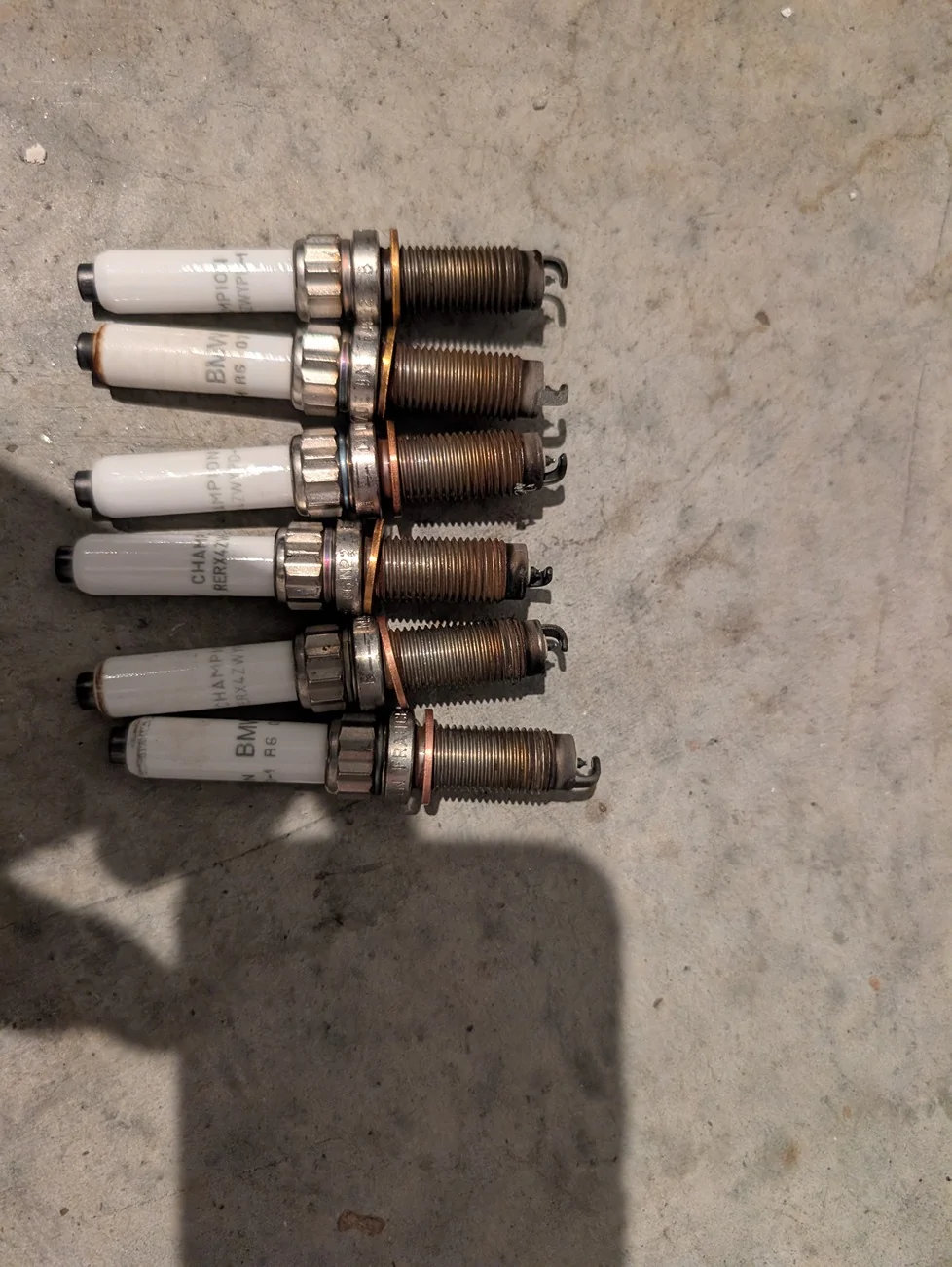

Spark plugs and oil change today at 42k miles! First of my FCPEuro purchases.
Word of advice, just buy a non magnetic socket & buy a separate magnetic tool to remove them. Absolutely destroyed the magnet in the first 2 plugs.
Had a hell of a time figuring out what I messed up just to realize the socket was junk. Coil Packs can also be used to remove the plugs!

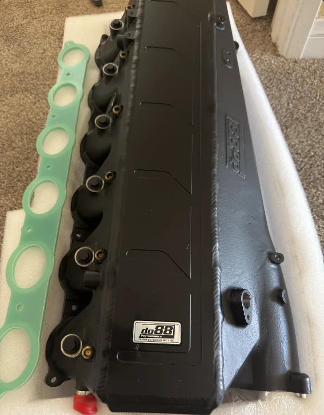

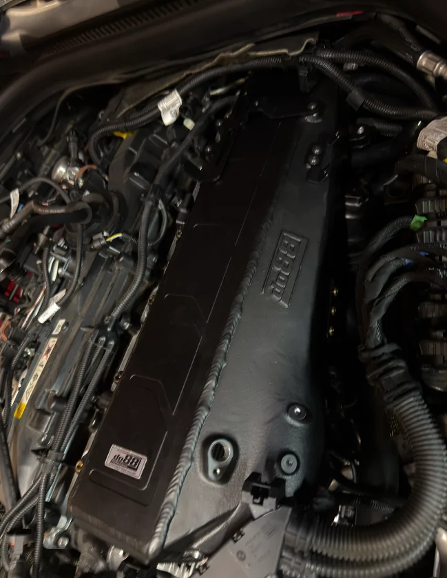

Maybe I'll do the intake manifold in... 2 more weeks...
I bought this tool few years ago - never had an issue with changing out spark plugs
https://www.fcpeuro.com/products/14mm-spark-plug-socket-w-long-extension-cta-7654

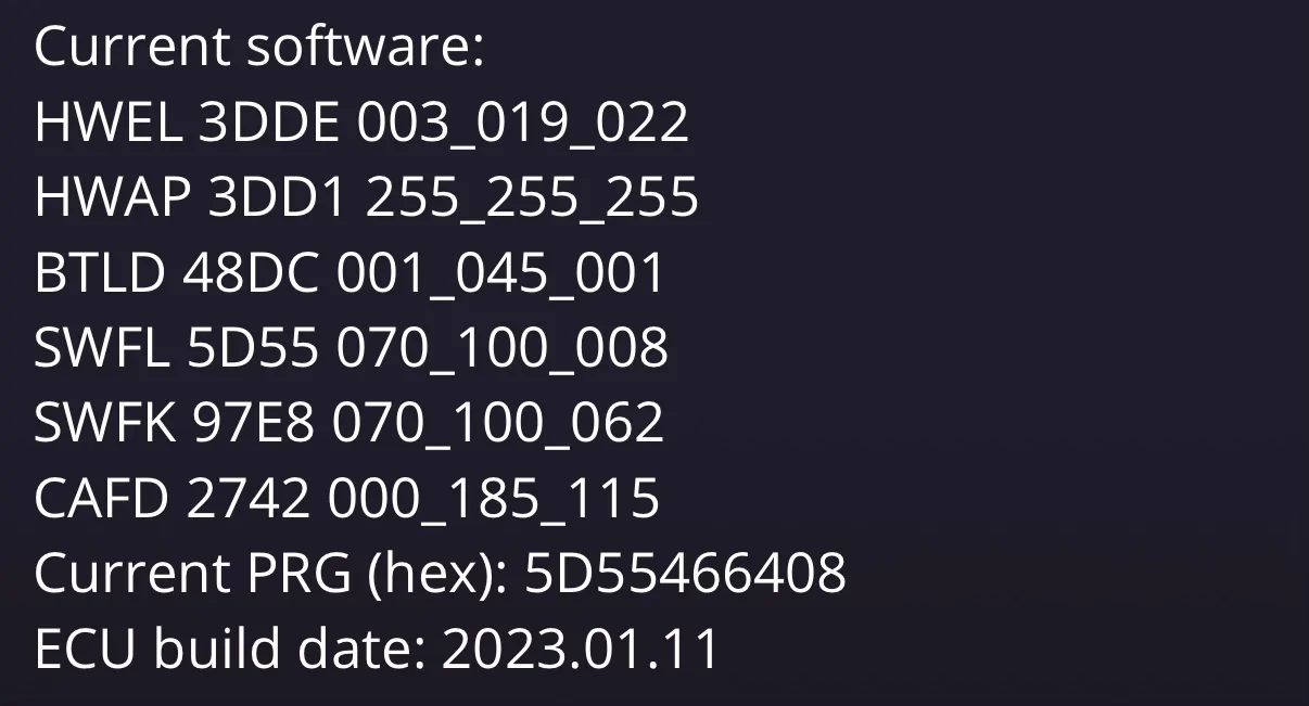

My 26 MT got a DME unlock, downpipe and the MHD stage 2 tune.
2nd gear is pretty wild now. I don't love the throttle mapping (it's SUPER sensitive) but since I have always been a little iffy about off the shelf maps I'm going to get a custom tune done hopefully soon (anyone got any recs? 😁).

Using comfort mode engine setting helps, a little.

Speed Logic replied to my same gripe regarding the throttle mapping and advised "reflashing with linear throttle mapping via MHD flash time options". I haven't had time to look into it but figured I would share the knowledge.

B58 doesnt have throttle mapping via MHD in the OTS settings.
