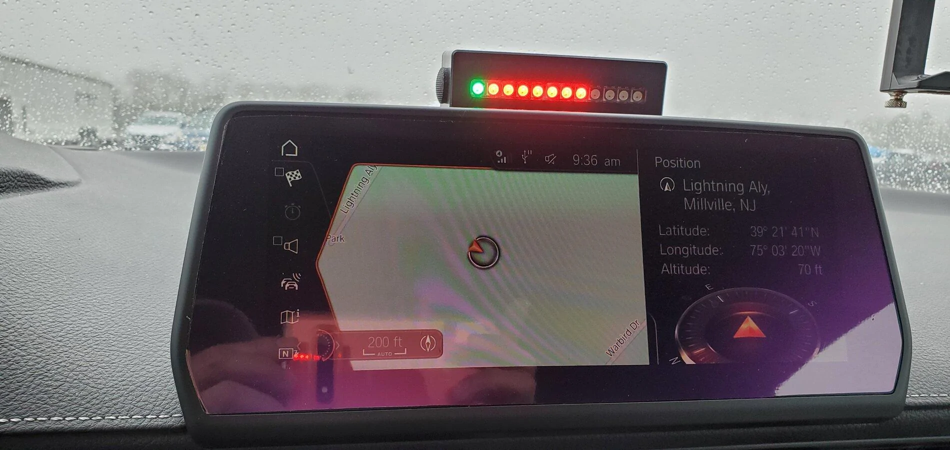

Whats that?
That's APEX pro. It shows you if you are using full potential of the car on the track.
https://www.apextrackcoach.com/
it needed a good mounting but I wasn't ready to stick it on the dash which is softer material than the surface behind the screen. So I 3D printed a mounting block so it is visible right above the screen.

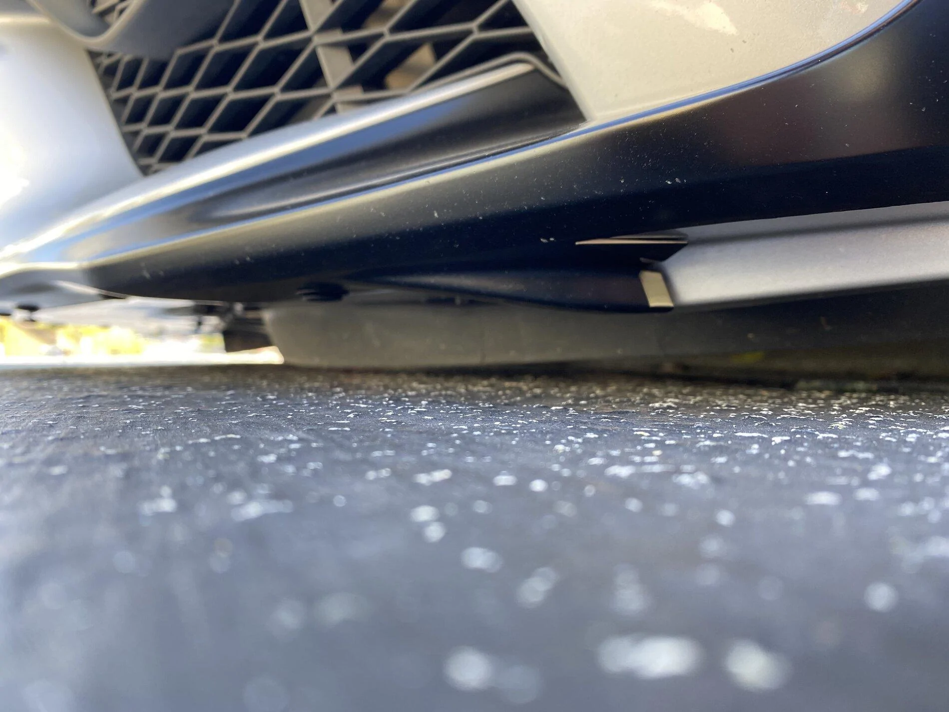

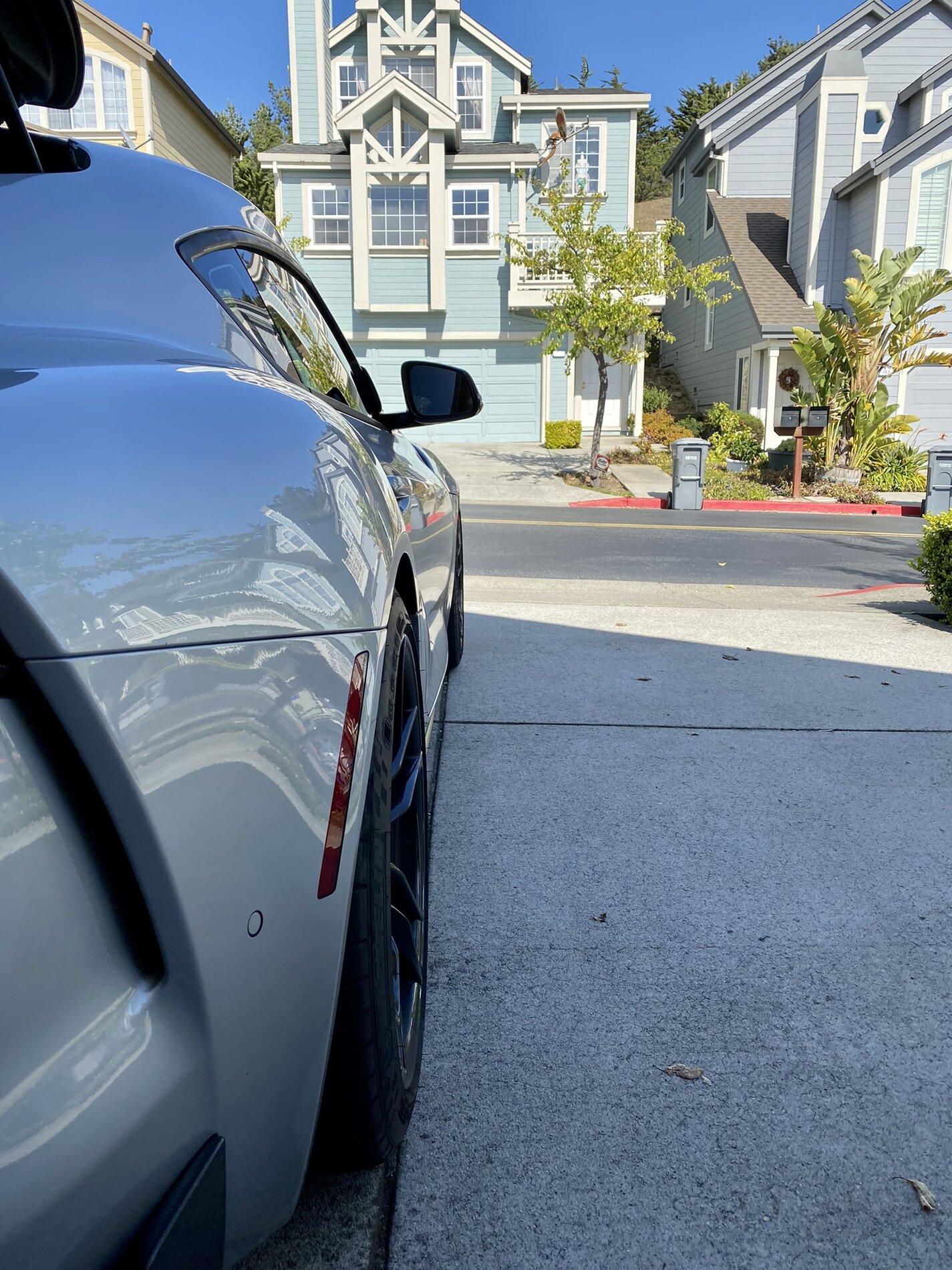

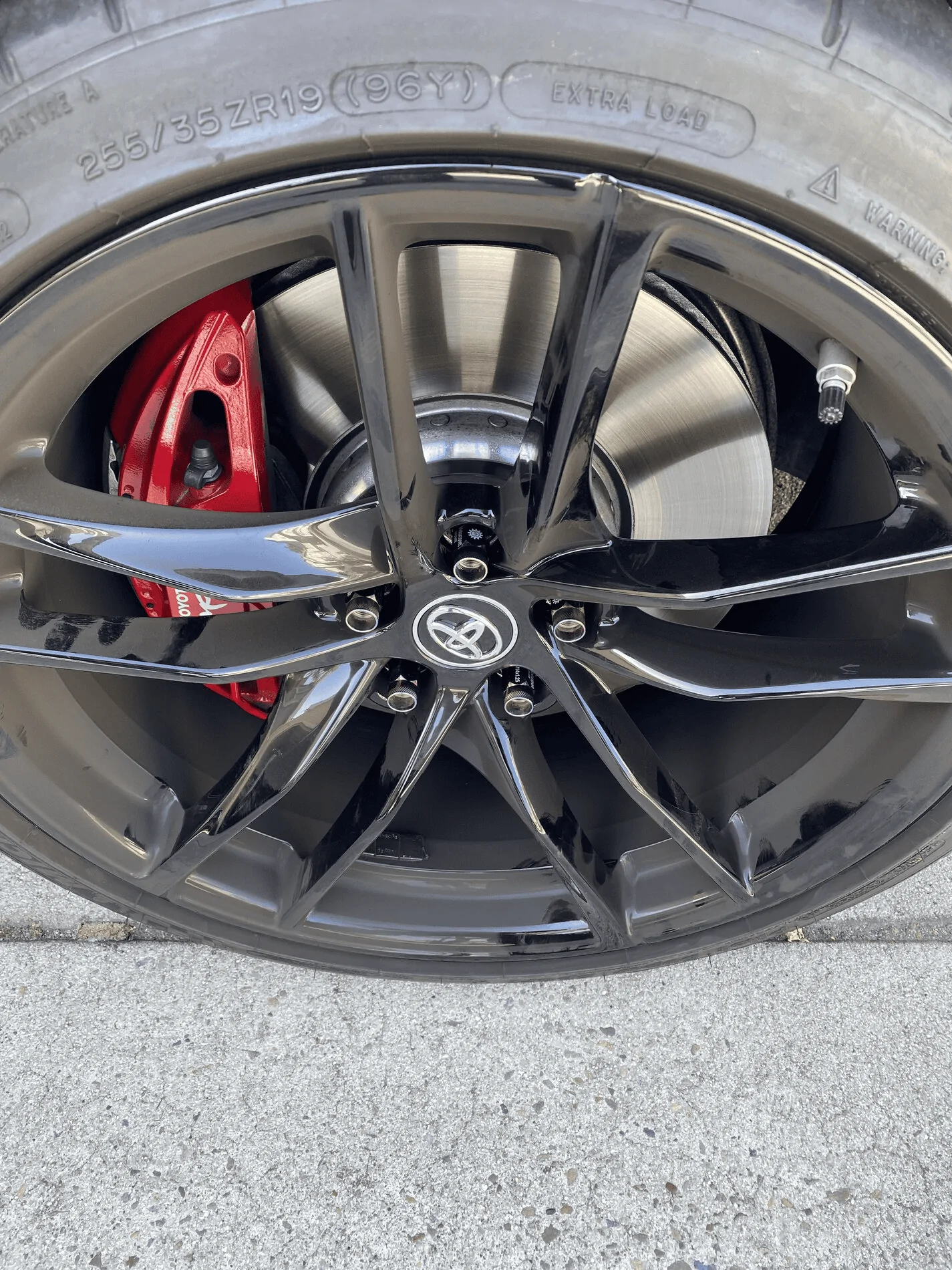

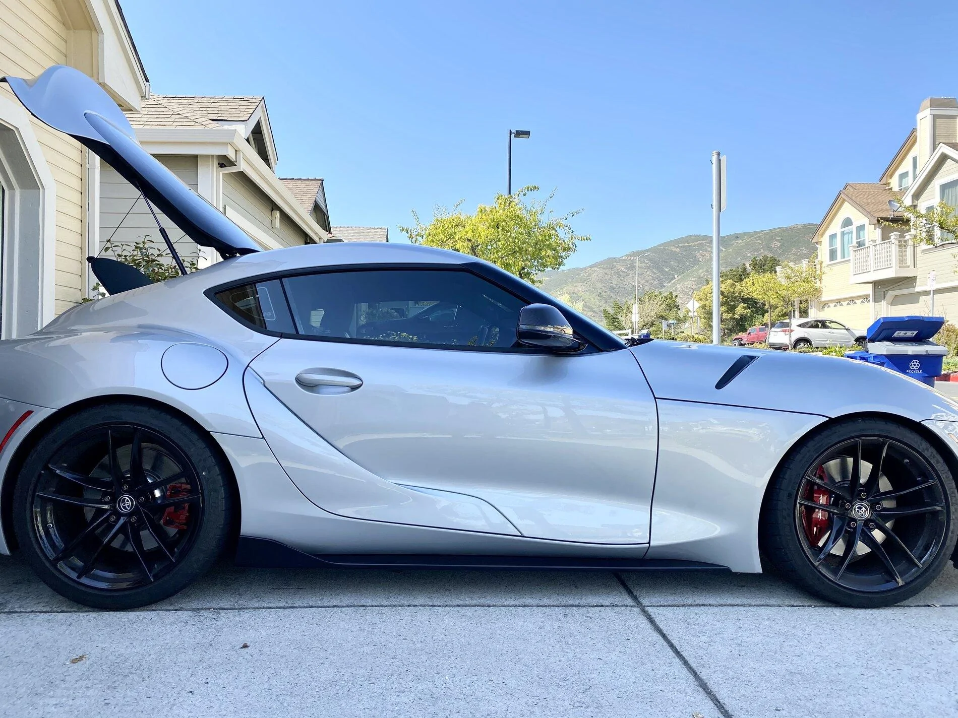

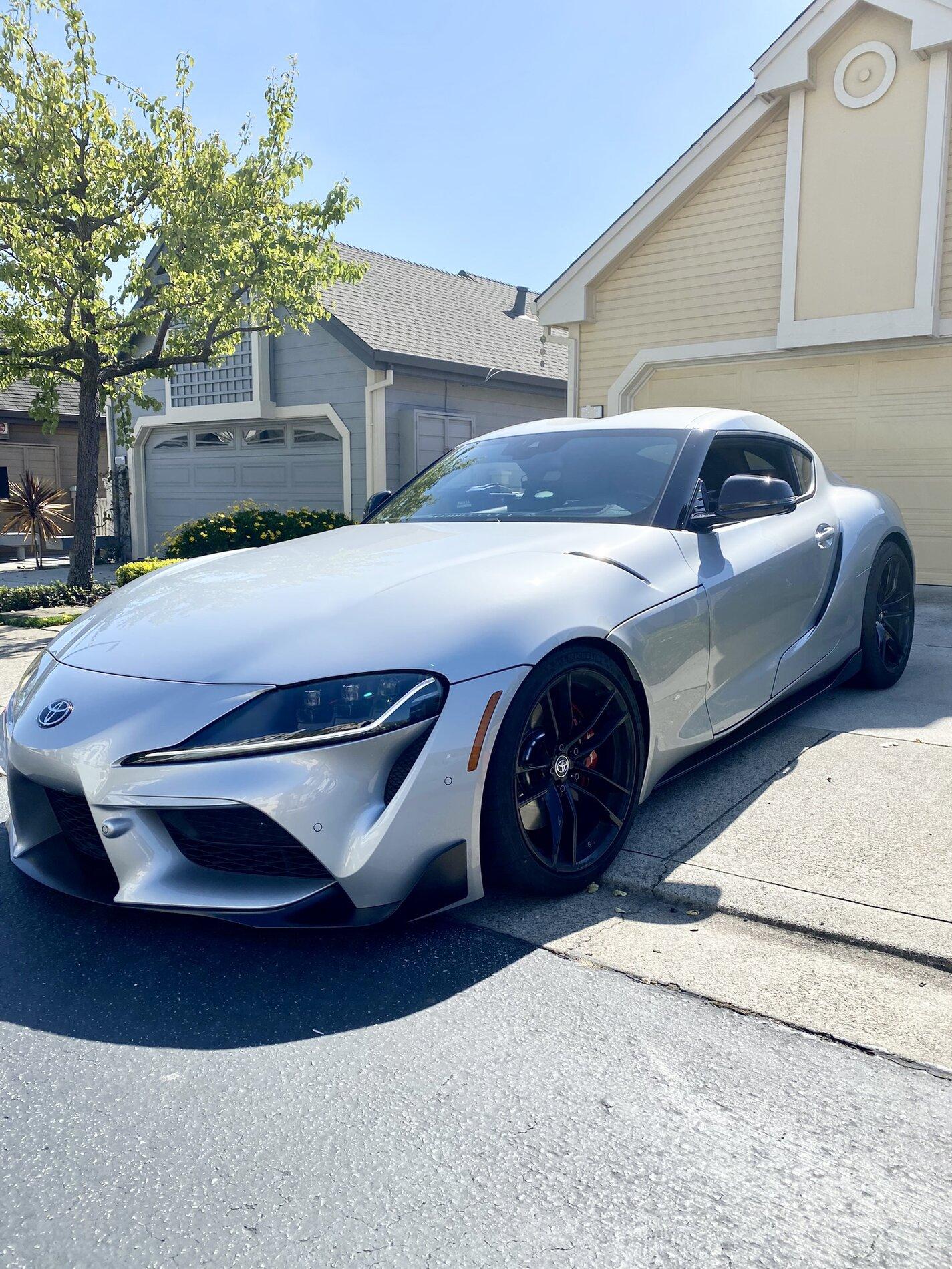

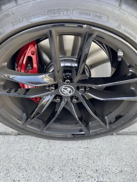

Added a couple goodies recently.
Llumar 35% ceramic tint all around with 80% on the windshield, VQCarbon Steering wheel, blackline paddle shifters, hardwired my Uniden R7, 12mm H&R spacers all around, MSH stud conversion kit in neochrome, powder coated wheels gloss black, lowered on H&R springs, powerstop ceramic z23 brake pads all around (really couldn’t stand the dust - have dealt with European car brake dust for way too long), weathertech floormats (and trunk mat), and added some LED lighting in the footwell and subwoofer areas. Just hit 1200 miles tonight and booked oil change for tomorrow. Have been loving this car a ton. Smiles every mile.
Forgot to wash the wheels before taking a closeup of them so please excuse the brake dust (which hopefully will be of the past). :) also realized with the drop how just a tad close I am to the ground when coming in/out the driveway. LOL
big, big thanks to Alex at Speed Industry for taking amazing care of me and having a great educational chat with me throughout the millions of questions I tossed him. Between Alex and the forums here, really have appreciated the community I stepped into. Not to mention the amazing folks I’ve met who are also fellow MKV owners like the great team of individuals at Elite Performance out here in the Bay Area (Gary and Melody are fantastic to work with).
