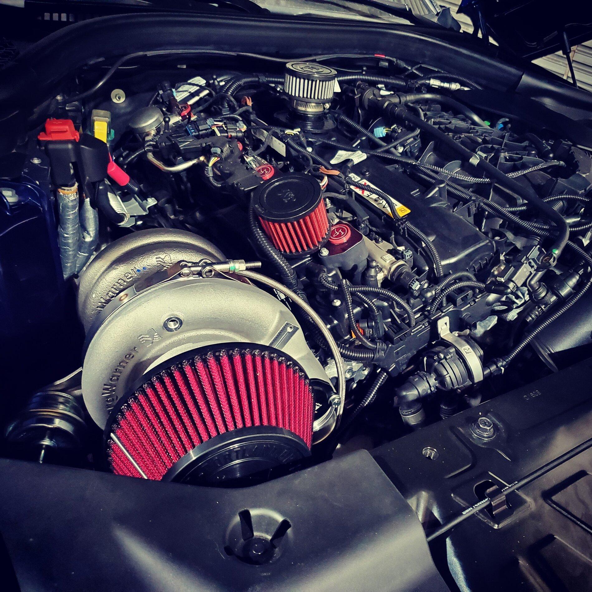

Installing DocRace Kit. Currently modifying and repainting the charge pipes that will use VanJen clamps in lieu of crappy silicone couplers the kit came with.. also installing proper BOV since DR does not include a solution to removing the built-in BOV.
Lastly, I'm replacing their drain line with braided -10an line since their kit came with 3/4" hose and hose clamps.. so far the kit seems solid outside of a few tweaks. I'll post back on here when complete.

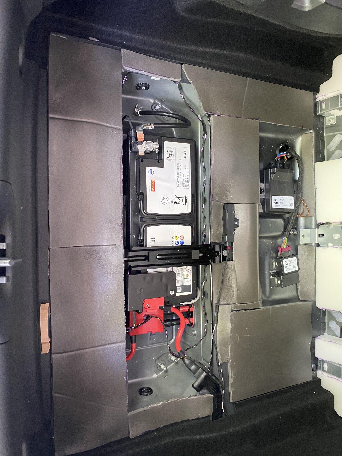

Yesterday I did Tada‘s subwoofer mod. A few things I did was use loose polyfill to fill the OEM metal box containing the subs. Way easier and loose Polyfill has been used for years with DIY sub builds. I also installed very lightweight Noico sound dampening foam in the rear area. After it’s all said and done, it made a big difference, bass extends lower and is cleaner. If you are a basshead it won’t be enough, but between this and the EQ mod, it’s much better. Thanks Tada!

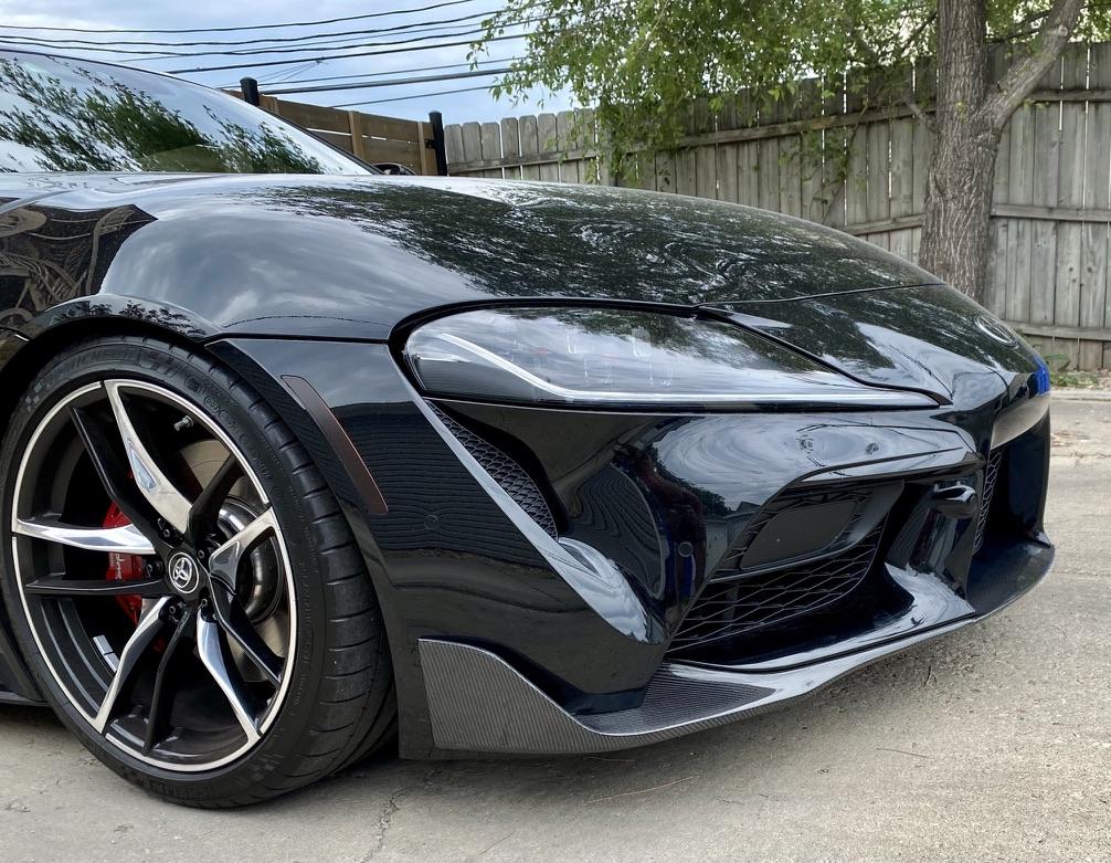

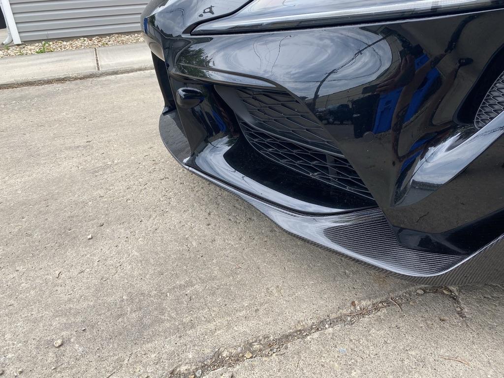

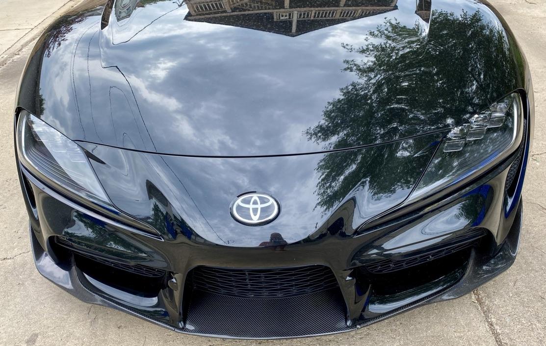

Carbon fiber factory front lip replacement:
I'm doing a test fit for a vendor in this photo. There are a few imperfections, and I'll probably replace it with an updated version after they tweak it a little bit. It's generally good, needs small improvements.

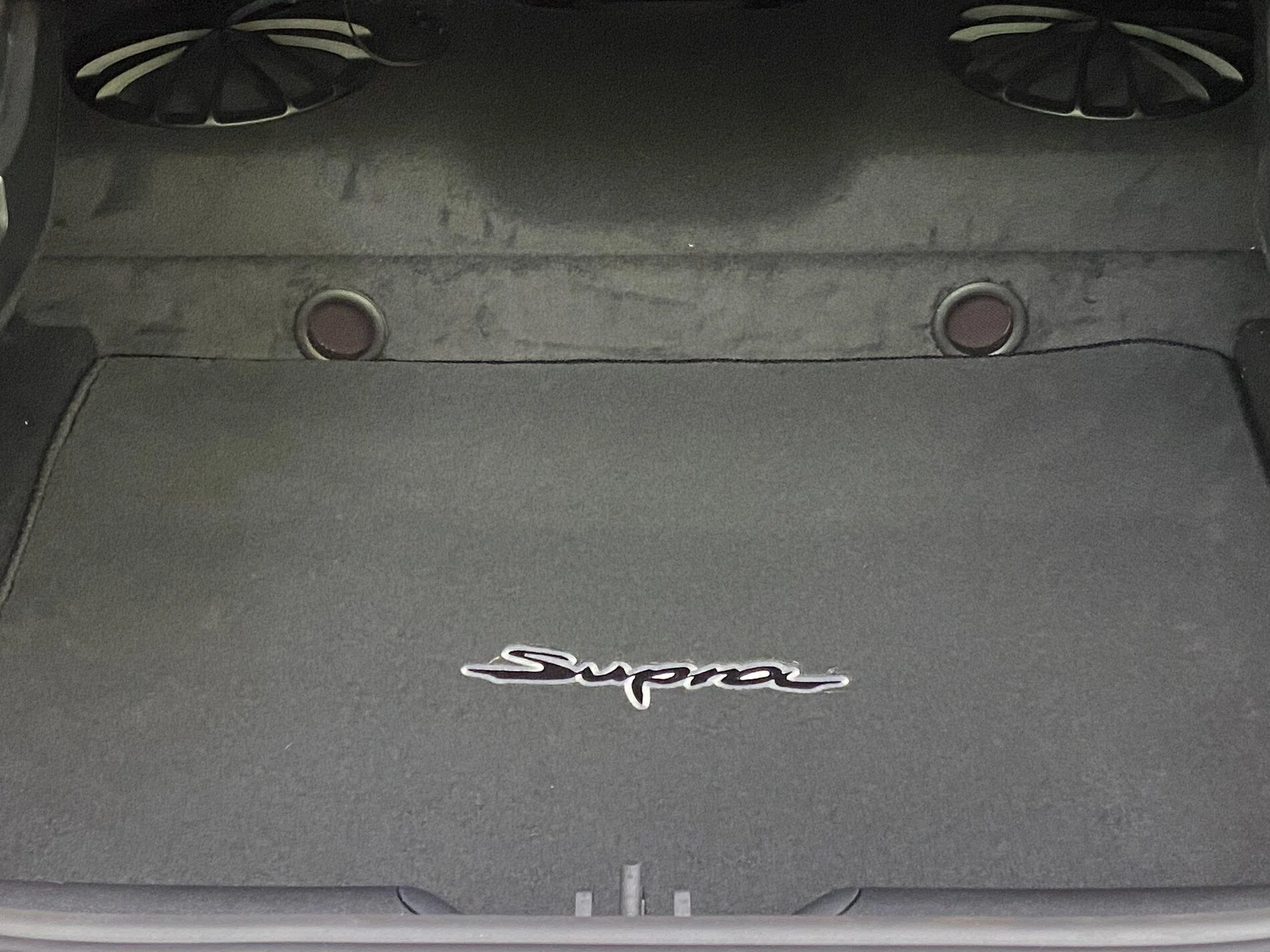

I installed the Maxton Design gurney flap and cut the half circles on my weathertech trunk mat so it would no longer cover the ports on the sound system mod.
Nice! Where do you get weathertech mats with GR Supra symbol?

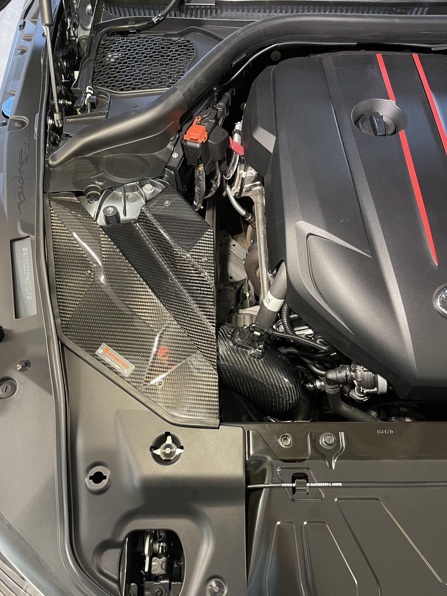

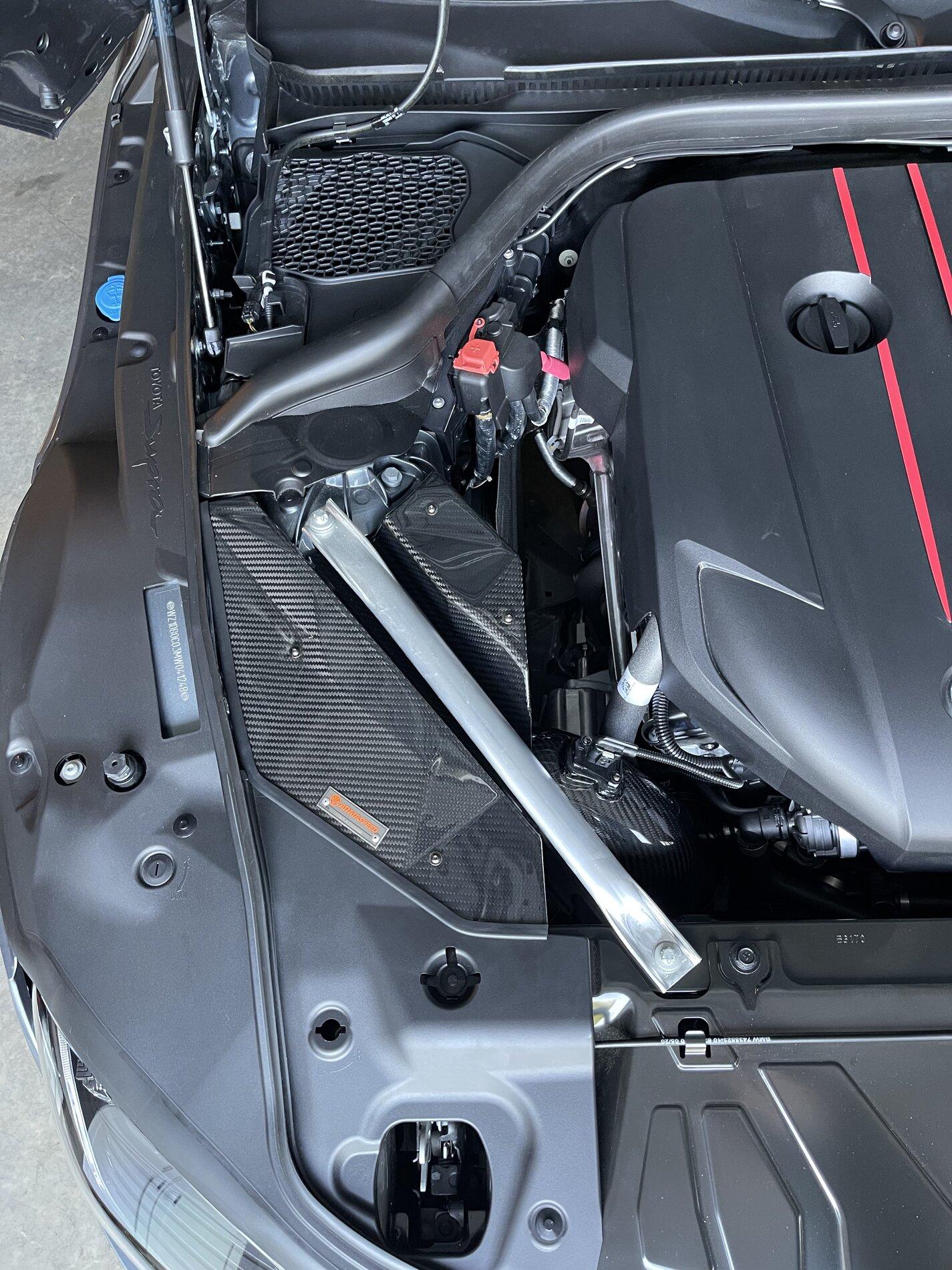

Armaspeed carbon intake, heat shield is a bit annoying because of the fitment (the size of the plastic pieces that go into rubber grommets is almost too small IMO) but the sound is amazing for sure! Looks great
Ohh that's nice. Now if they make one that protrudes out a bit further than stock :)
I got the mat and logo at ftspeed.com the mat and logo are sold separately though. Just look for them on the site. I think someone posted a promo code on this thread btw
I know. I just wanted it a little bit further out. I don't like things getting too flashy, or too far from an OEM+ look, so this is pretty perfect for me.

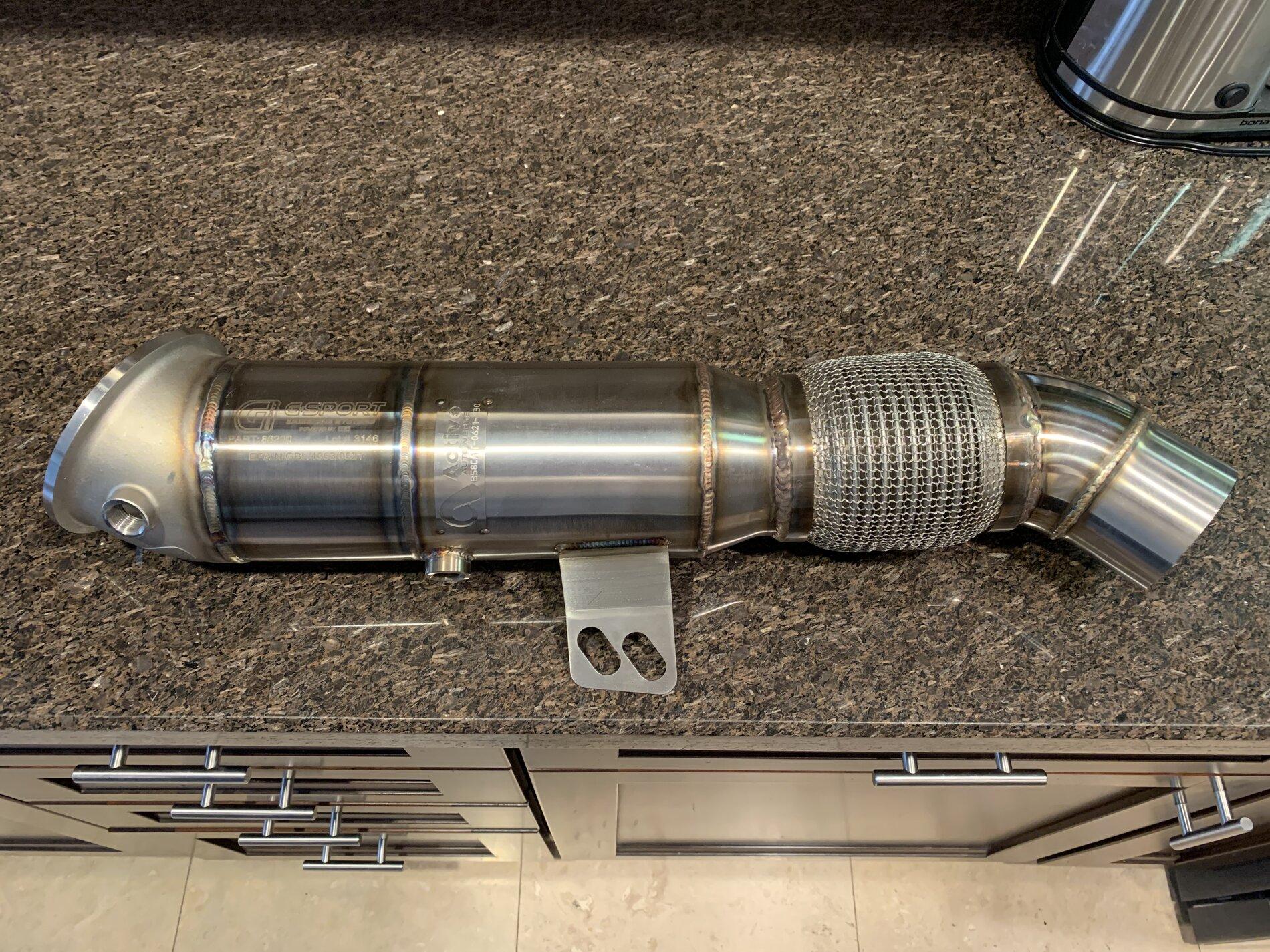

Finally installed my catted red star DP & replaced the air filter on eventuri (which was shockingly clean for 9000ish thousand miles I put on it). I guess re-tune should to account for DP should be next on the list.
