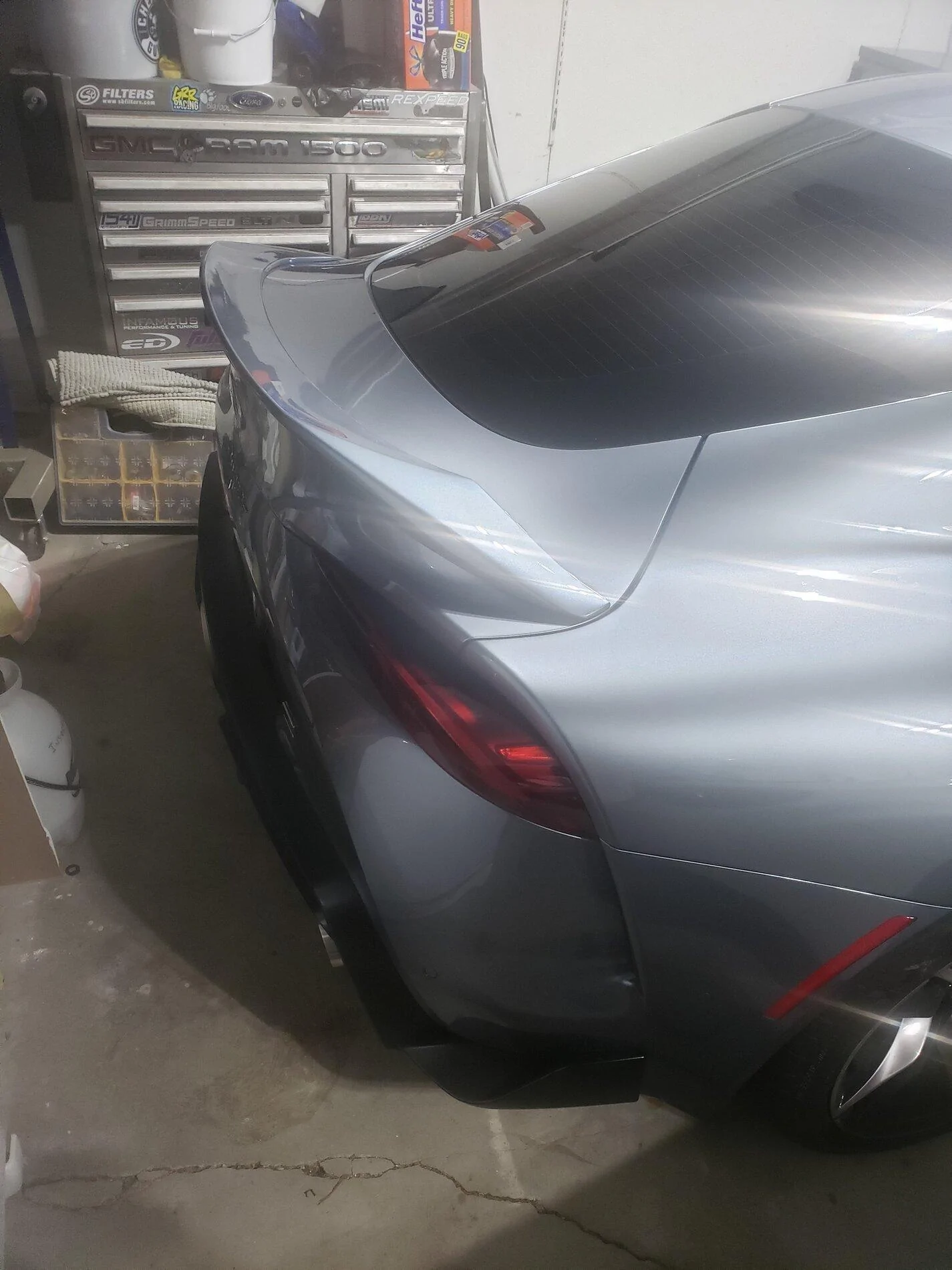

Any tips? I've got a spoiler coming and am hoping to self install as well.
Triple/quadruple check to make sure the spoiler is sitting properly on the trunk lid. Made sure the spacing was even left/right and also front/back. I propped up the trunk lid with a paper towel roll so that when I drilled I wouldn’t drill in to the trunk deck. The lid is plastic so drilling is easy. After drilling the pilot holes with the template, I switched to a unibit/step drill bit and taped of the drill bit to where I want to stop drilling. Only little issue I had was when initially installing the bolts, the threads on one bolt caught on the little rubber gaskets and caused the bolt to be difficult to tighten. I didn’t try and force it. I just stopped and cleaned up the threads in the spoiler with the thread chaser. Went on fine after that.

Paint matched TRD k/o spoiler was test fitted. Looks great except the waviness of the plastic itself across the topside. I'm not sure if I'm ok with it given the decklid is perfectly smooth in front of it. Don't think I'm willing to take it off, prime/block sand it and repaint it to fix the issue.
