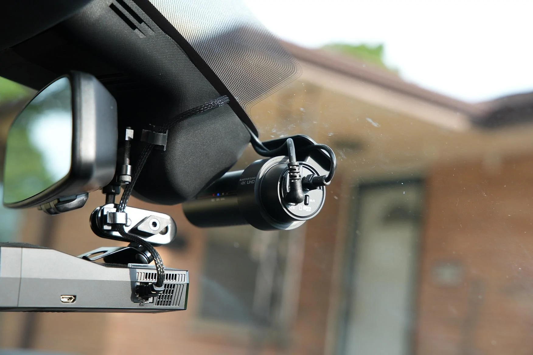

My Uniden R7 arrives later today. When you were installing yours did you notice if you could use Uniden's wire-tap or is it necessary to hardwire to the fuse box?
I just bought a mount that came with a mirror tap kit. This one specifically:
Radar Mount Mirror Mount Bracket... https://www.amazon.com/dp/B0788XRBTV?ref=ppx_pop_mob_ap_share
Wanted to get a blend mount but they seem pricey for what they are. Let me know if your R7 auto powers off if you hardwire.
IMHO, use the mirror tap to hardwire the R7. It’s easier to work with than the passenger fuse box. Save the fuse taps for hardwiring dash cams.

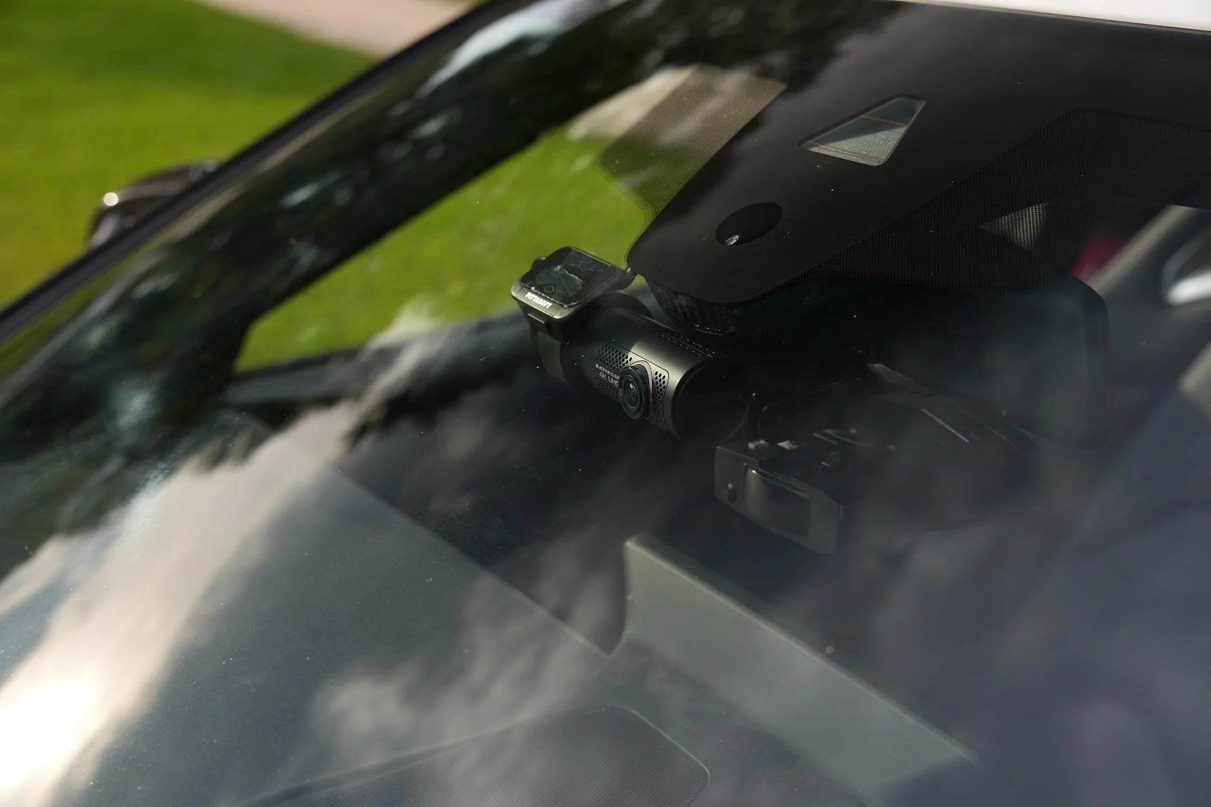

I’d love to have a front and rear discrete dash cam for the Supra. Please share your thoughts and photos. Thanks
There’s a thread with detailed steps and photos:
https://www.supramkv.com/threads/blackvue-dr900s-2ch-install-diy.4921/
I found step 2 was completely unnecessary. I also didnā€˜t need step 5 as I was able to push the wires after removing the panel in step 3.
I chose the Thinkware U1000 dual-channel system and I’m happy with it.

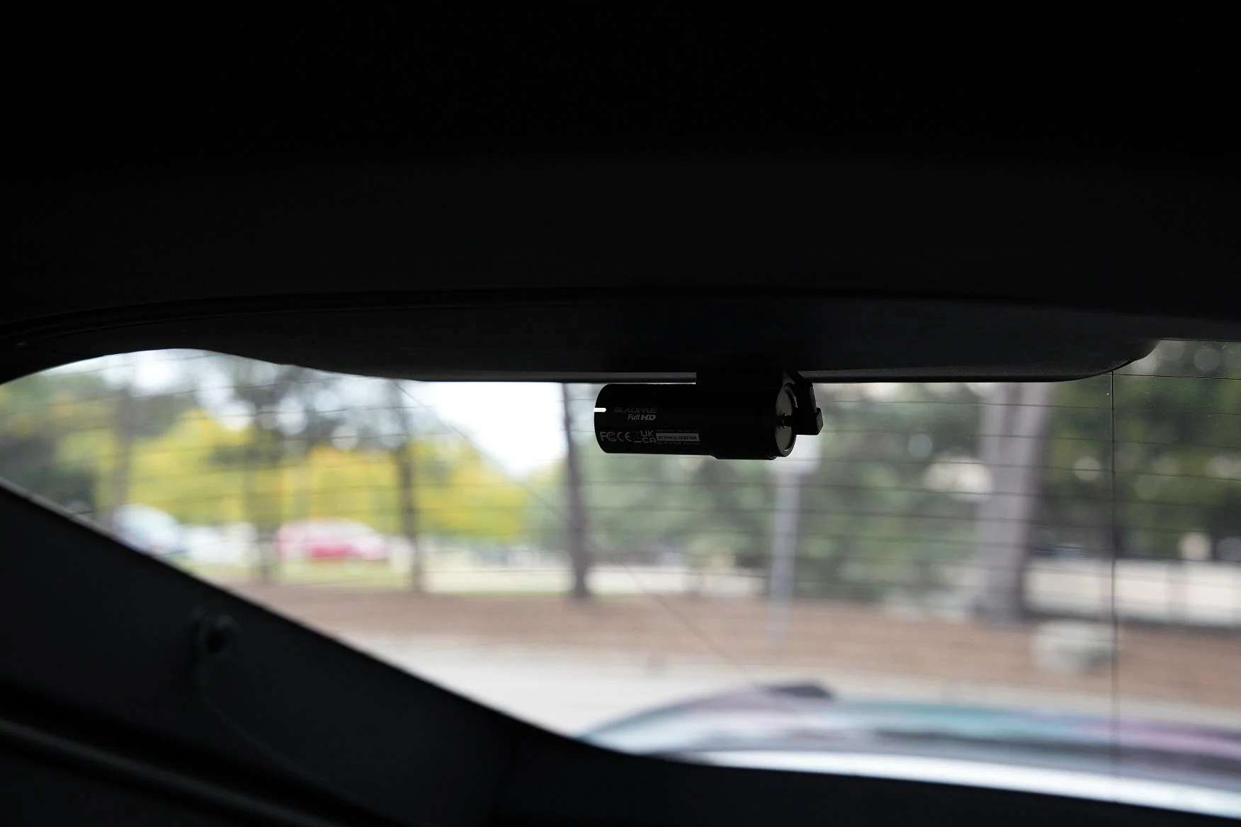

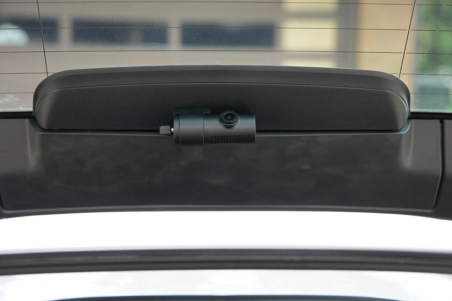

Got a dash cam and spent my twin’s nap time today (2hrs) furiously trying to get the rear cam setup done. My dumbass lead the thick side of the cable in first and I paid for it when I got to the rubber hose opening. Absolute bitch getting the cable through that rubber hose.
Otherwise install was not to bad. Used a dremel to make a guide hole for the wire in the brake light trim cover.
Didn’t have time to open up the interior panel behind the seatbelts to hide the extra wire slack - if anyone knows how to do that let me know, hope to get it done tonight after the twins go down for the night.
How did you hide the wire from the hatch lid to behind the seat belt area? Did you use the tube that conceals the wiring to the brake light?
