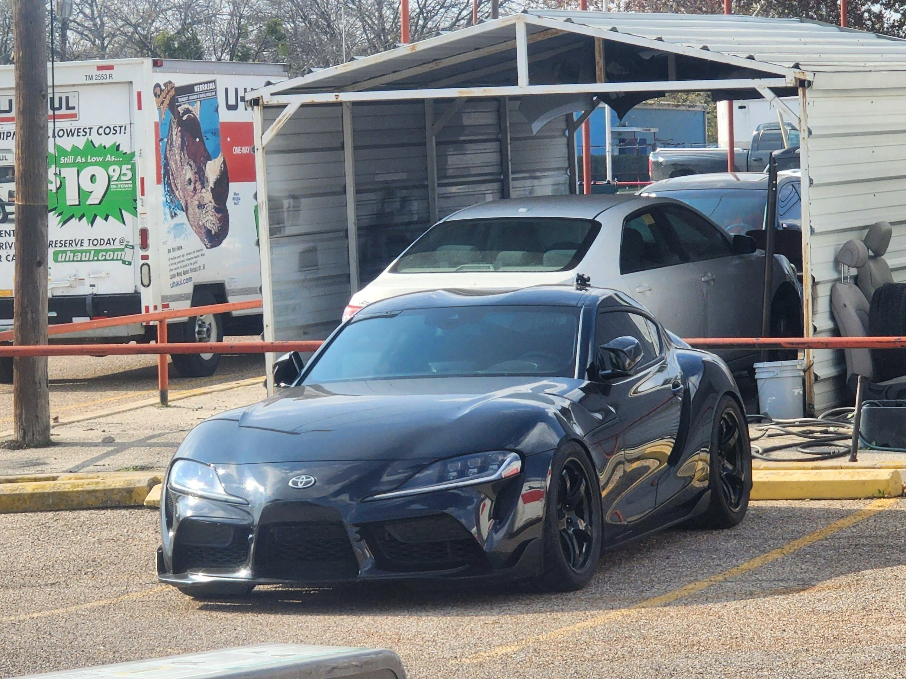

Gotta run that 35 profile or lower to limit rubbing on 19s
Yeah, these are just for daily driving. They don't rub much and where they do is an unimportant area. It's such a slight amount of rubbing that one of the 2 spots has stopped rubbing already (I turn left more than right on the regular, so I'd expect the right turn to stop rubbing in due time). Took a look at the tires and they look completely fine still and the wheel well is really clean in 1 spot :)
The additional comfort the 40 profile tires provide is too good to go back for daily driving...it's a night and day difference.
TLDR: Great for daily driving, not so great for much else.

Sounds like the OEM 255/275 with a 40 ratio may be the sweet spot. Don’t remember anyone having tried this yet.

That should give about 4mm of extra space to work with, might be just perfect for daily driving.
Keep in mind though that I'm running lowered on KW V3's, so your mileage may vary.
What I'm running right now might work on the OEM suspension.
The place where they are rubbing is just above the vent in the front part of the wheel well...the vents are recessed a bit from the regular wheel well plastic, so if you're at factory ride height you might be in the clear.

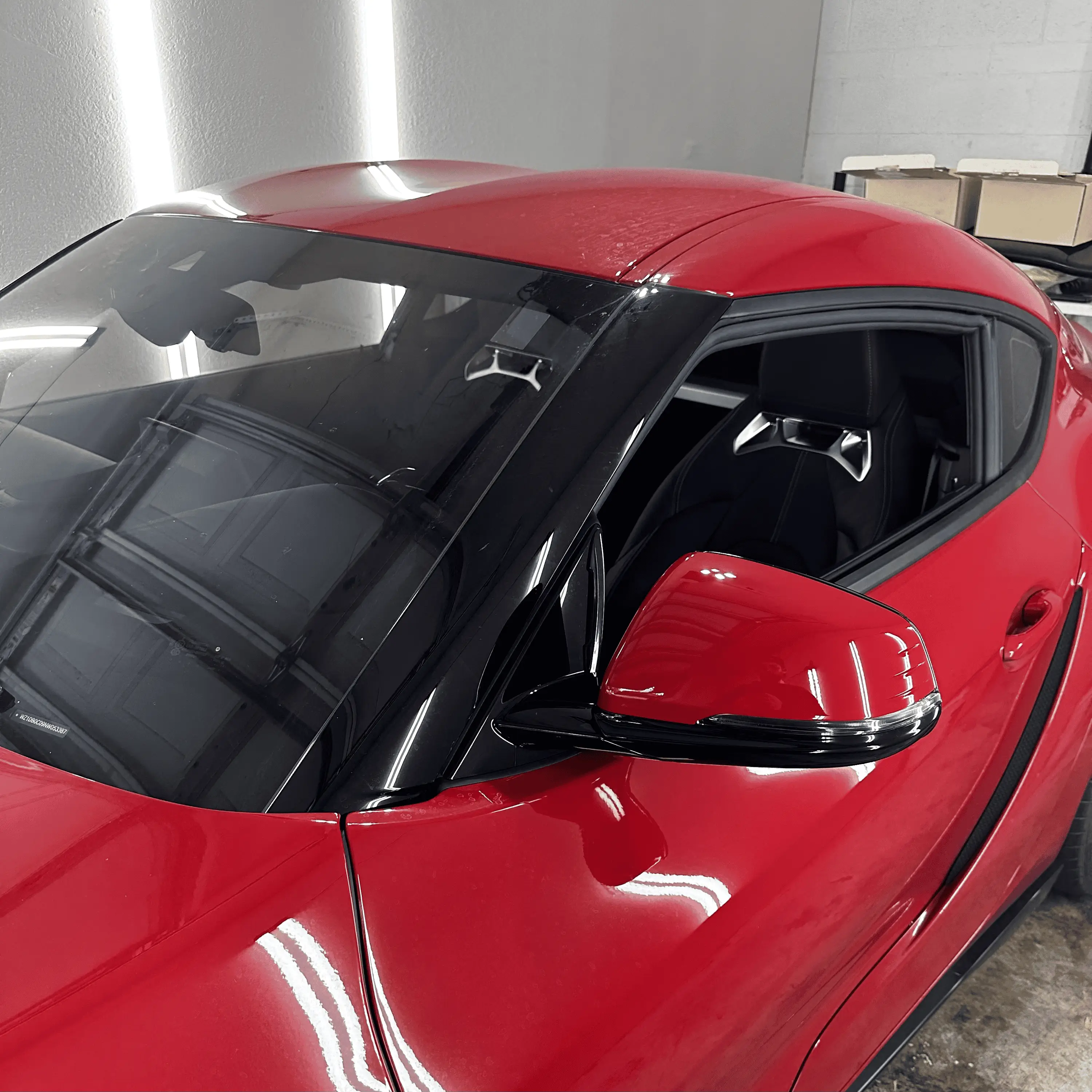

A must OEM replacement for renaissance red Supras IMO. Fun fact, launch edition Supras that come with the red mirrors are renaissance red color code. Why they didn’t come factory with this option? Lol I am not sure. Ordered this from Toyota.com and picked up in 2-3 days. Links to Toyota/parts numbers for the launch edition caps below + photos,
Part numbers,
87945WAA15
87915WAA15
Links to Toyota,
https://parts.toyota.com/p/Door-Mirror-Cover-Right/94215711/87915WAA15.html
https://parts.toyota.com/p/Door-Mirror-Cover-Left/94215713/87945WAA15.html
Great find. Big improvement, very nice!!

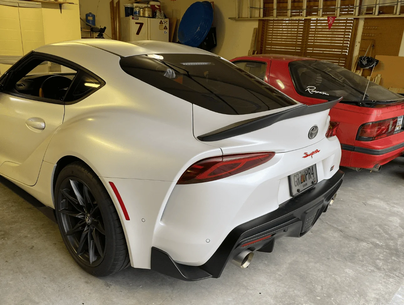

Installed a duckbill spoiler from Ninte today.
Need to paint or replace those exhaust tips next.
Are you happy with the Ninte spoiler? Does align with the rear bumper color and sheen?

Do they sell other colors or only the red for the launch edition?

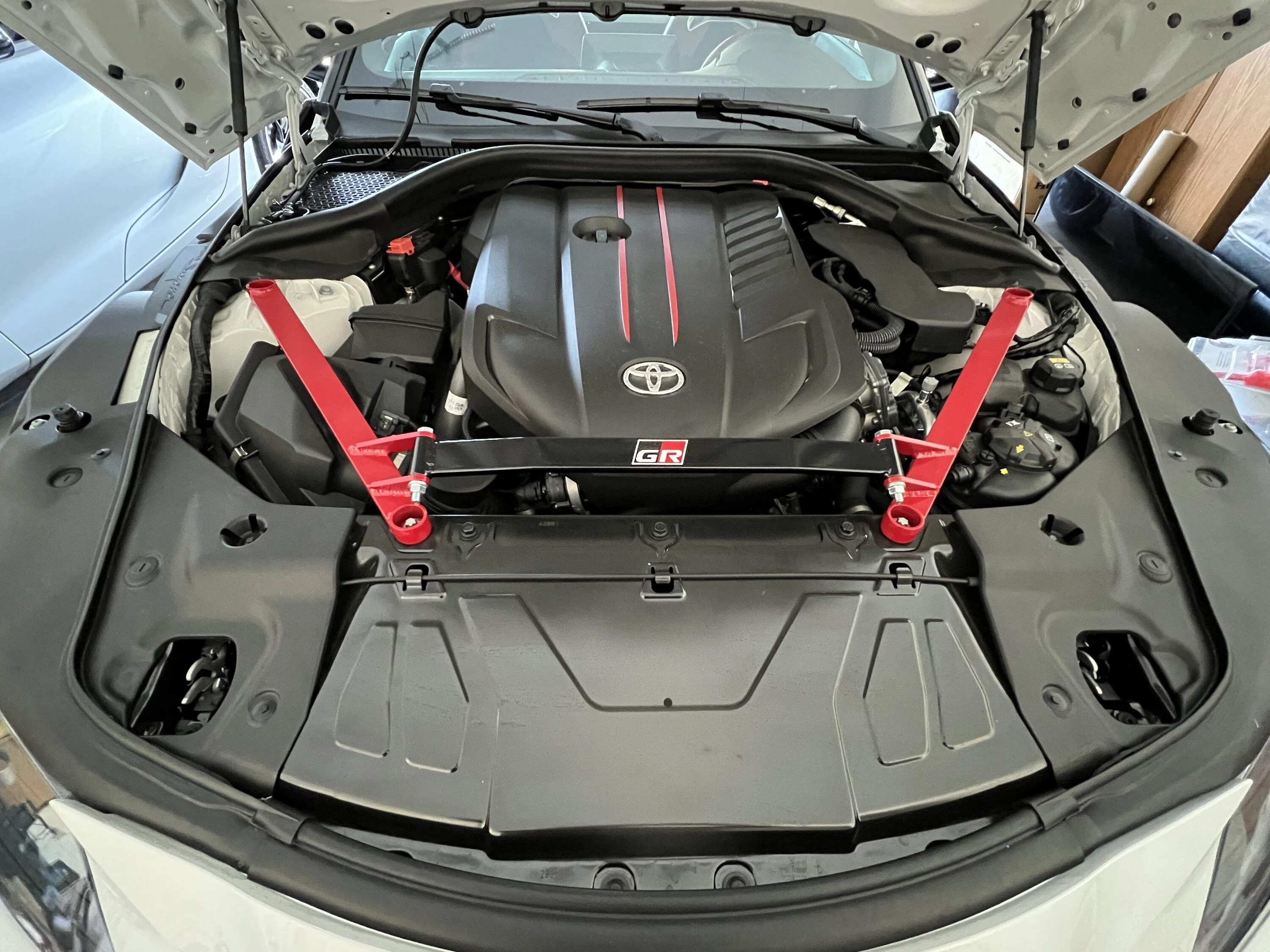

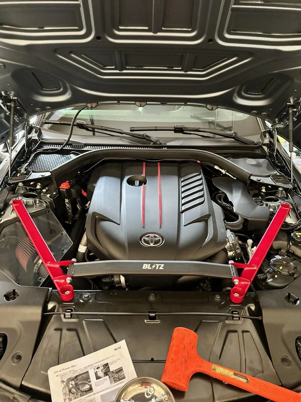

So close to mine! I can really only see a couple tiny differences in the logo, connectors bolting the 3 pieces together and the weld locations.
These should have been added to all new Supra models not just the special edition. The new tie bar setup is leagues above the 2 popsicle sticks they put in there for all non special edition models.
Can’t go wrong either way! I just prefer the OEM parts when I have the option.

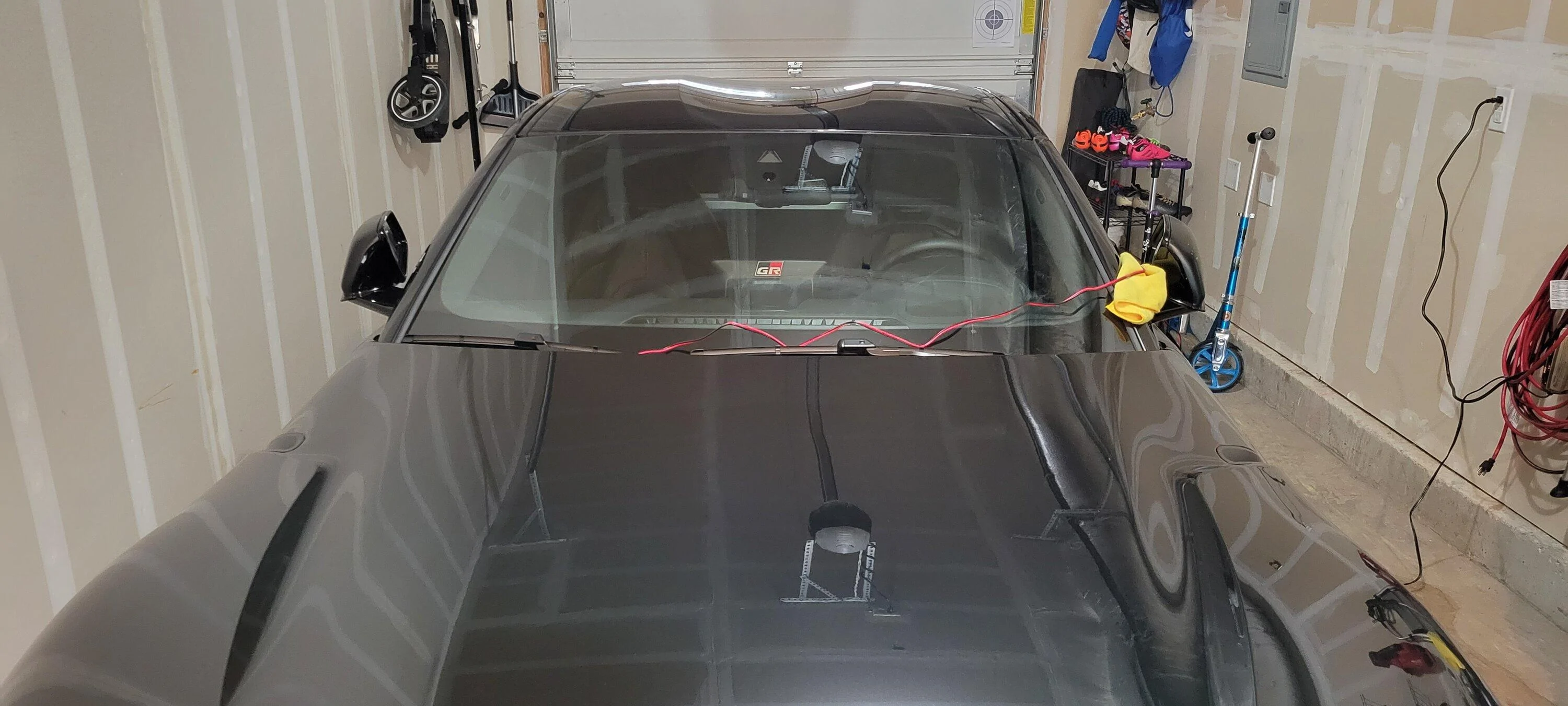

Finally decided on a place to place the GR emblem from the rear bumper. Had it origi ally on the steering wheel but the emblem was too big and looked off

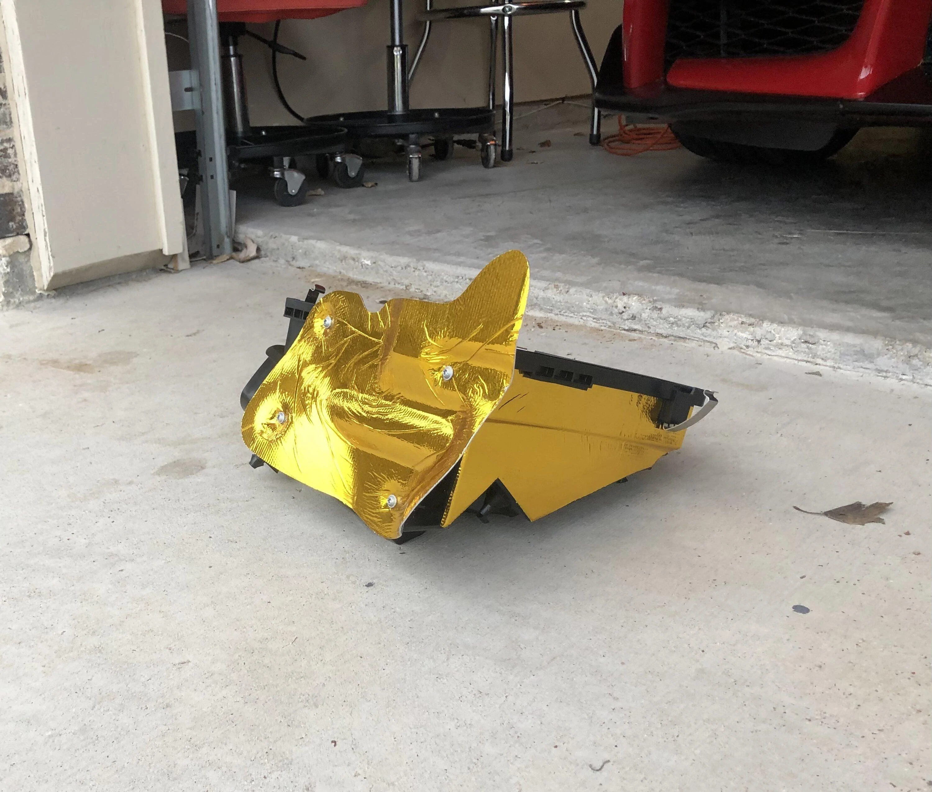

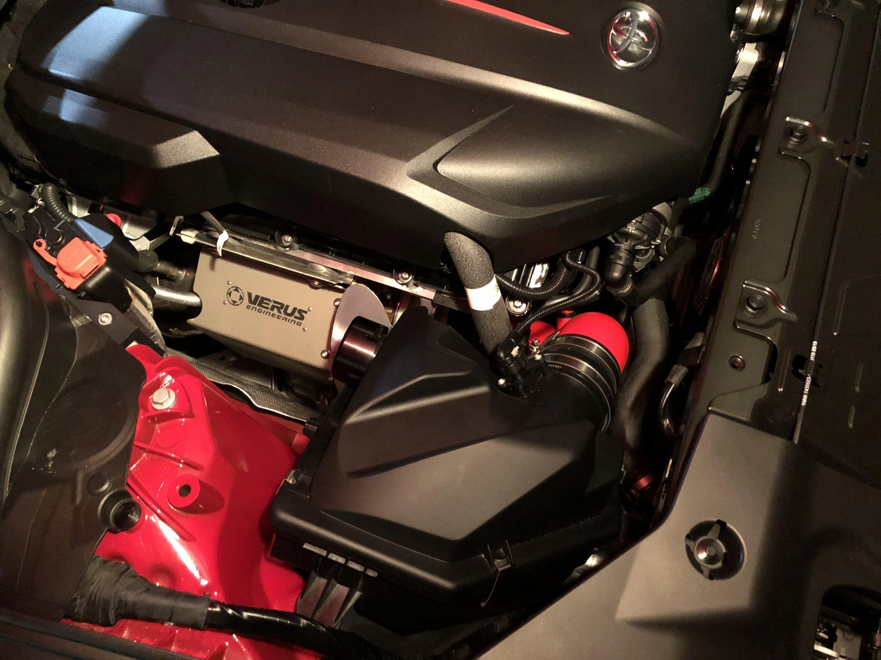

Prepared the intake for a Verus resonator delete, Verus turbo heat shield and FTP inlet pipe. Trimmed back the shield since there won’t be a resonator and add some additional heat soak protection.

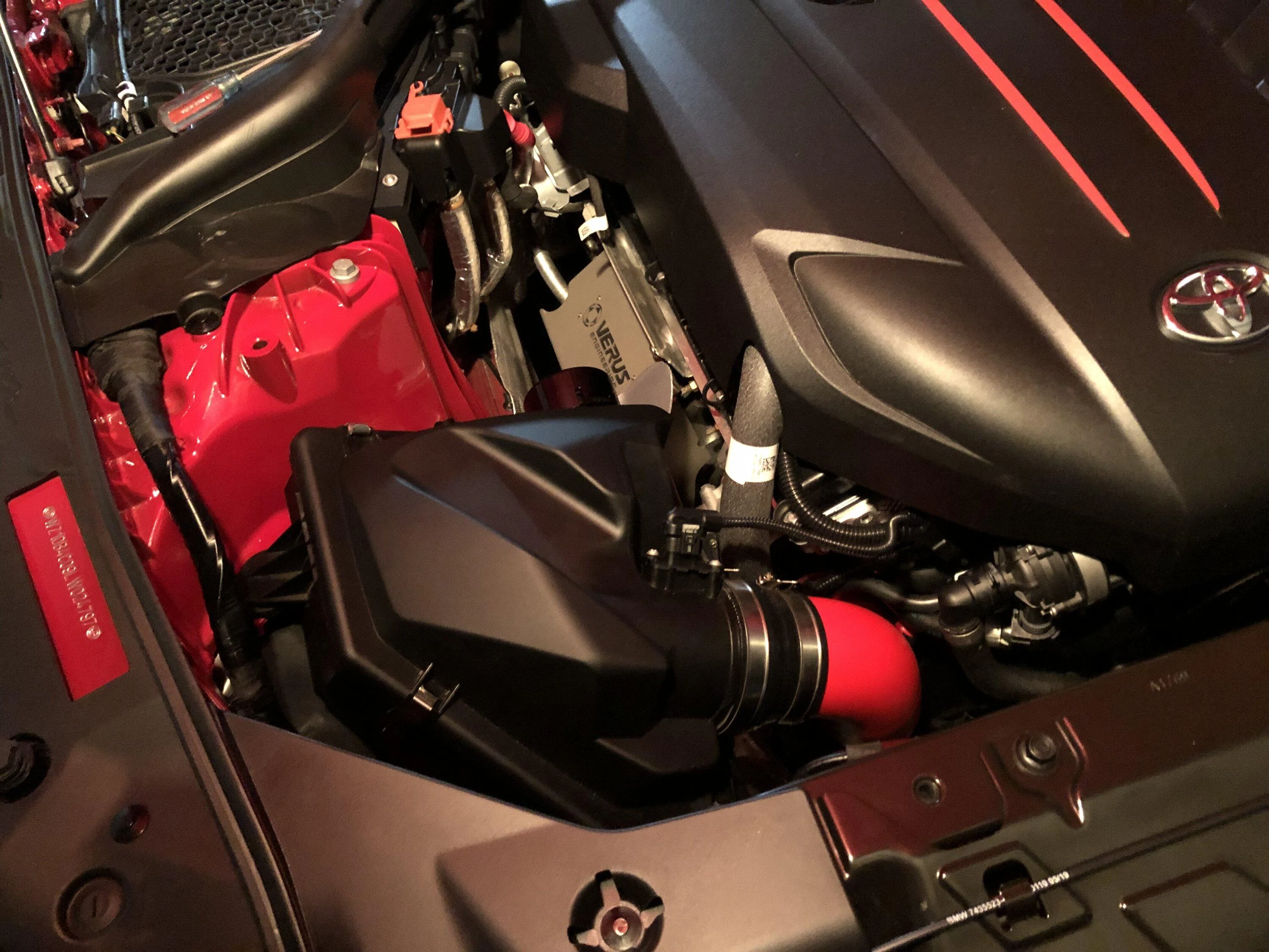

Finished with an HKS drop in.

That part you trimmed is actually one of the more important bits that helps shield the turbo manifold heat from the airbox. Probably won't be too bad though since you are also installing the Verus shield.

Exactly, the Verus heat shield will make up for that easily. And I added the gold to the side of the air box facing the direction. ;)
