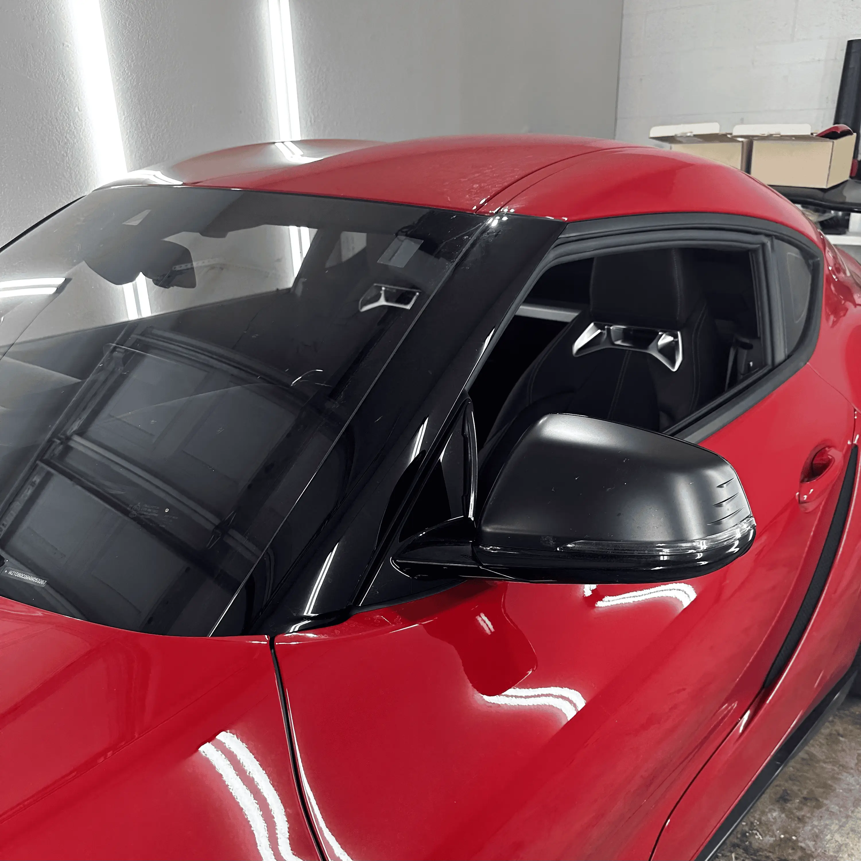

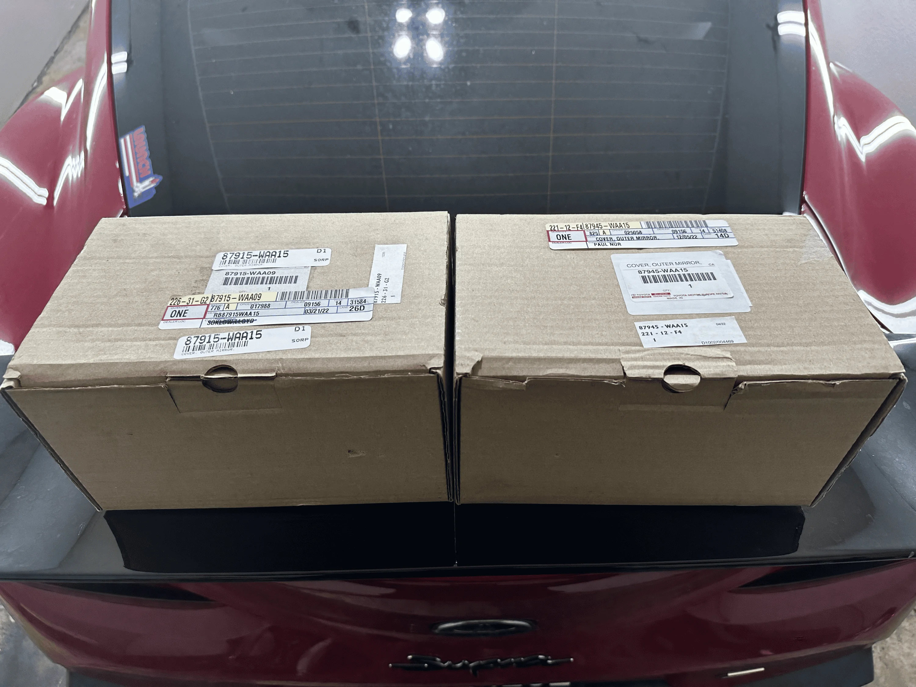

A must OEM replacement for renaissance red Supras IMO. Fun fact, launch edition Supras that come with the red mirrors are renaissance red color code. Why they didn’t come factory with this option? Lol I am not sure. Ordered this from Toyota.com and picked up in 2-3 days. Links to Toyota/parts numbers for the launch edition caps below + photos,
Part numbers,
87945WAA15
87915WAA15
Links to Toyota,
https://parts.toyota.com/p/Door-Mirror-Cover-Right/94215711/87915WAA15.html
https://parts.toyota.com/p/Door-Mirror-Cover-Left/94215713/87945WAA15.html

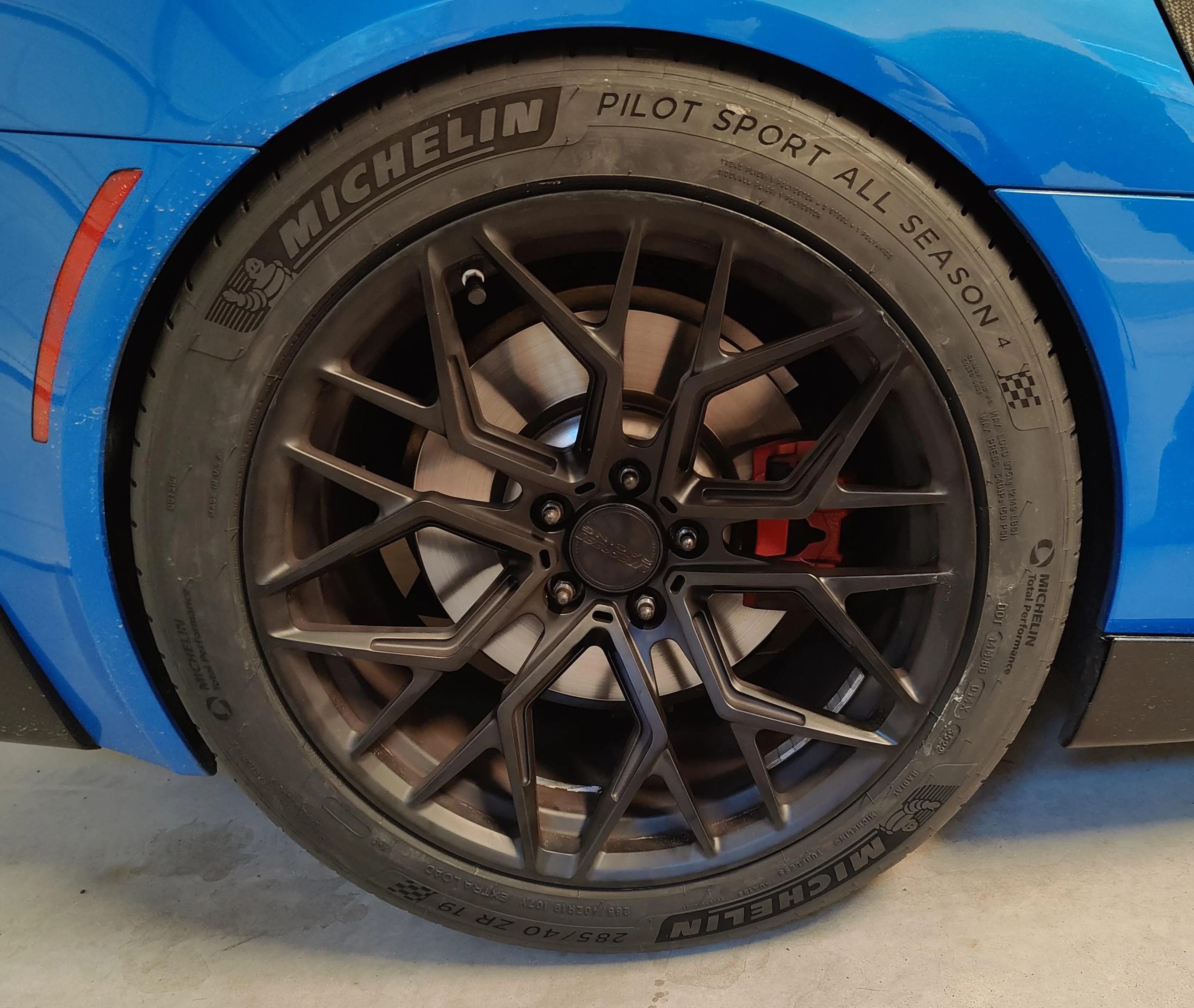

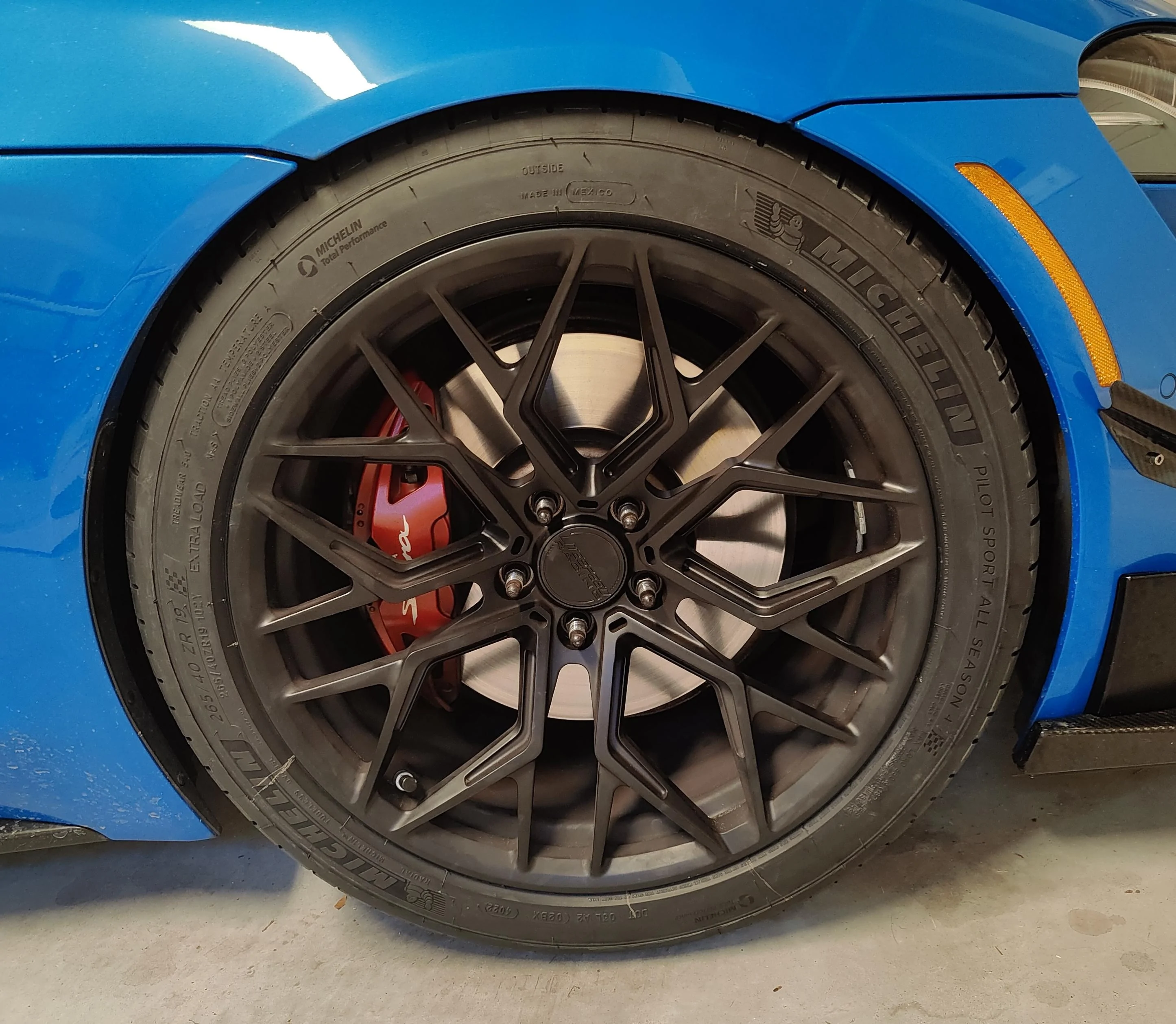

I purchased tires from Tire Rack which arrived today. So I call Clearwater Toyota to have them mount, balance the tires and perform a 4 wheel alignment.
Service writer quotes me $400 for the alignment(4 hours labor....huh?) $300 for mount and balance.
NOPE! ???
Tire Kingdom... $300 for everything. ?

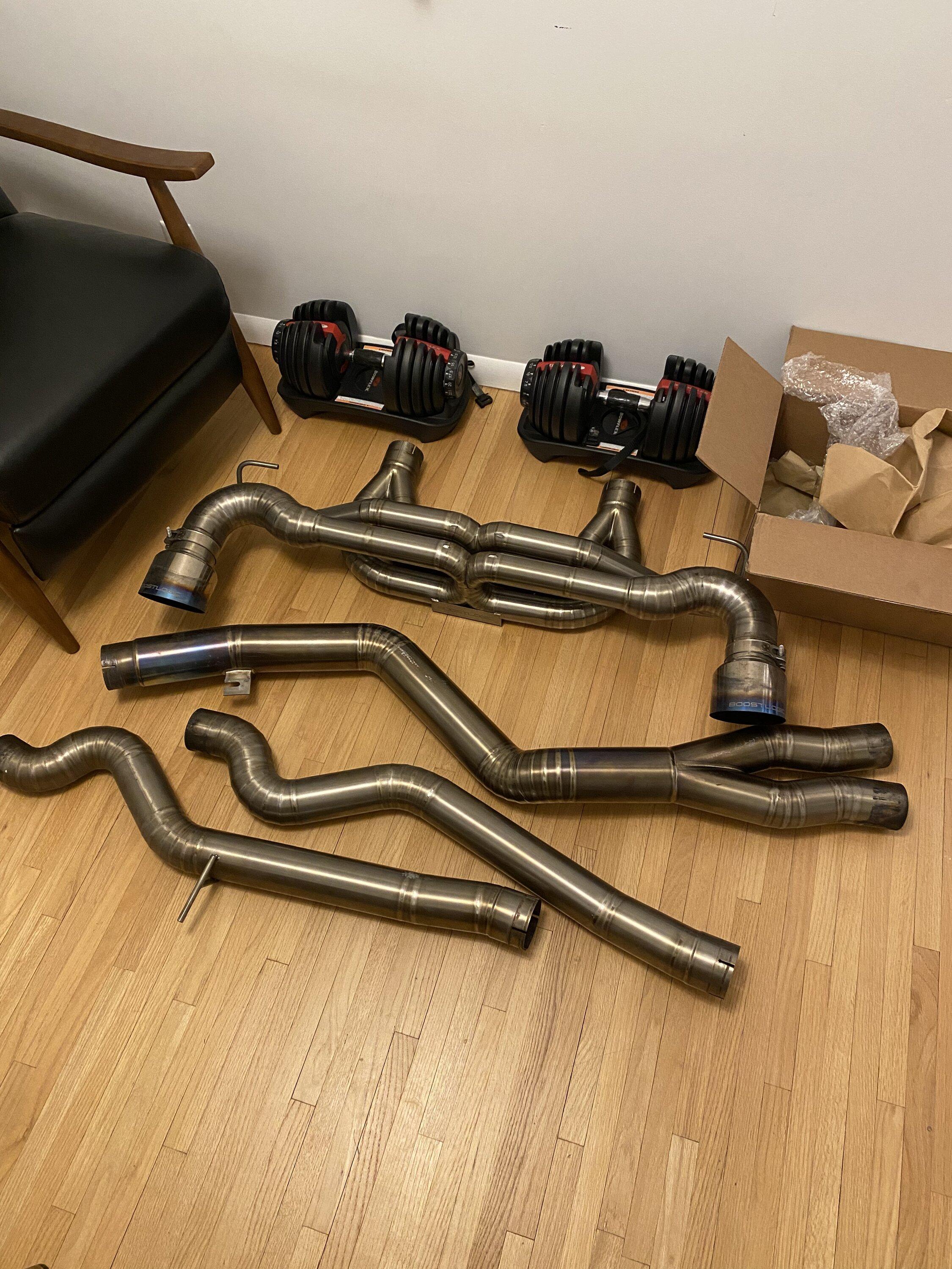

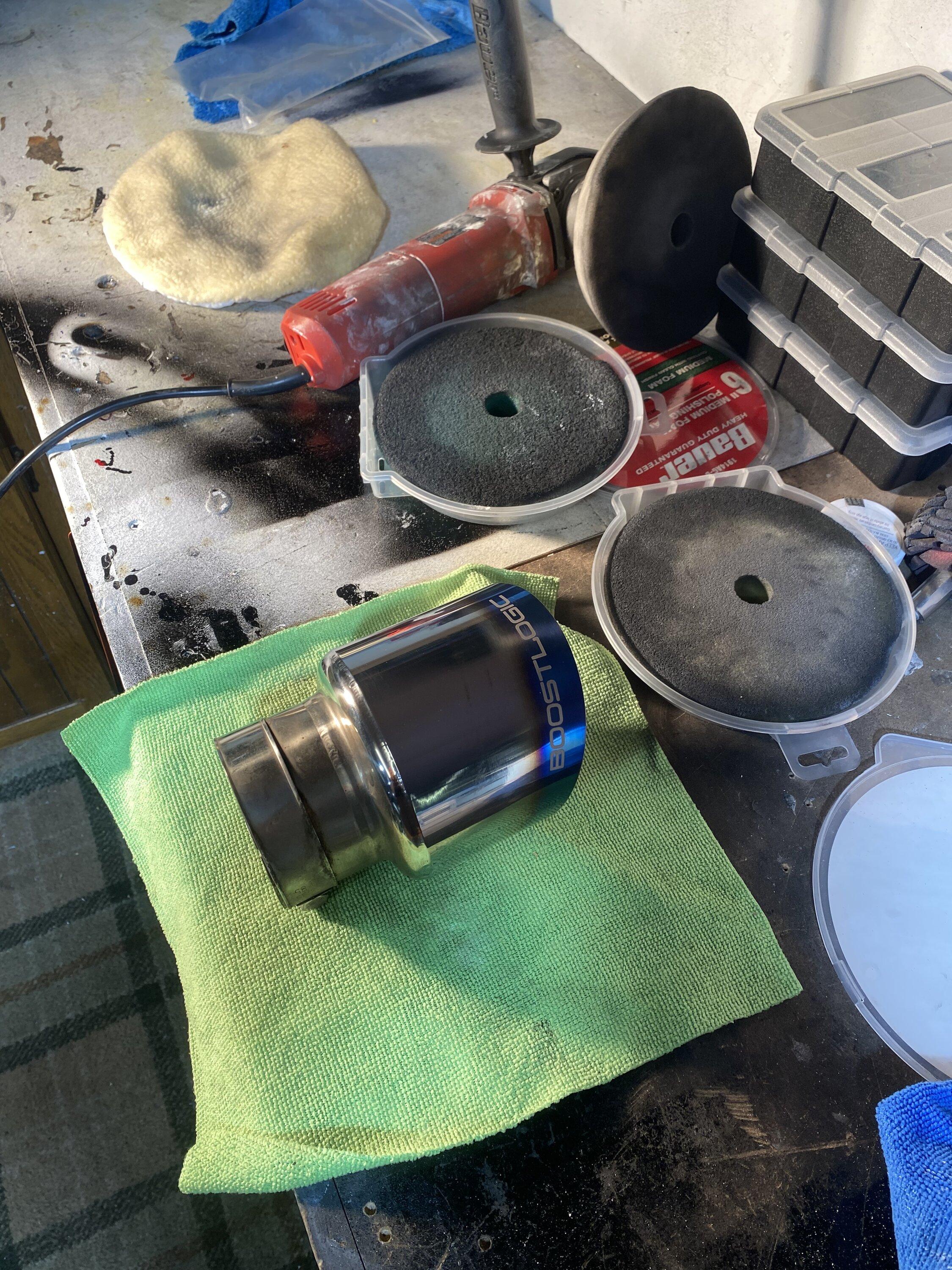

Polishing the used exhaust I bought ?
Its cleaning up like brand new, just need my buddy to lay a weld where it cracked along the seam (I guess this isn’t uncommon).
Excited to blow out my eardrums with this behind my catless dp! More pics after polishing and install
Question…do you sit in that chair and do curls?
Haha! Actually no, they are my wife’s weights. The chair is in cold storage there since the Christmas tree went up in its spot on Halloween night. I live in a mad house
