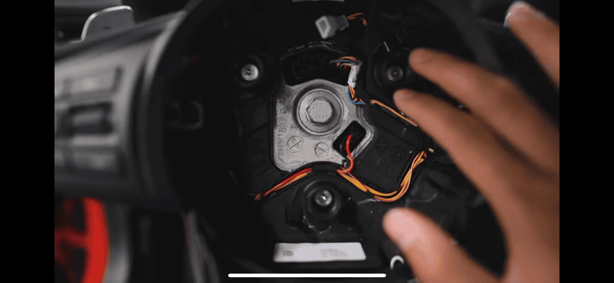

5/22, there was also no Loctite on the bolt. It is T60 if anyone was wondering.
Hey Paul,
Thank you for providing the size of the bolt... I couldn't find that info anywhere.
2023 MT here and have the same T60 bolt.

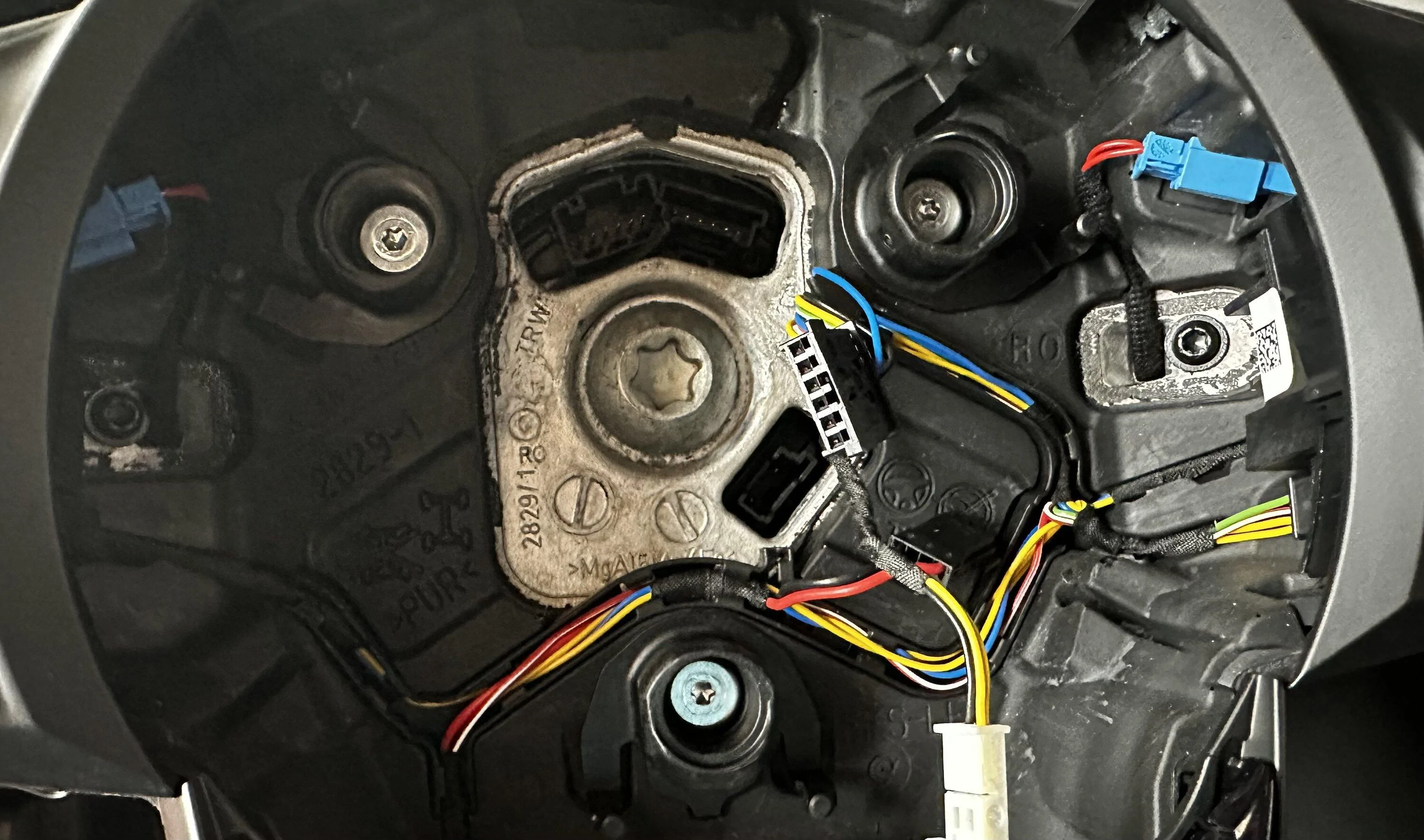

Im unable to untighten the t60 center bolt with a hand ratchet. It just turns the steering wheel when I attempt it. Mine seems to have blue loctite. I'm hoping am impact wrench will do the trick?
nibble
May 21, 2020
48
1,299
1,205
NJ
BMW, Honda, Toyota
It is very hard. It took me 2 breaker bars to unscrew it and i thought I was going to break something. having another person to hold the steering wheel helps.

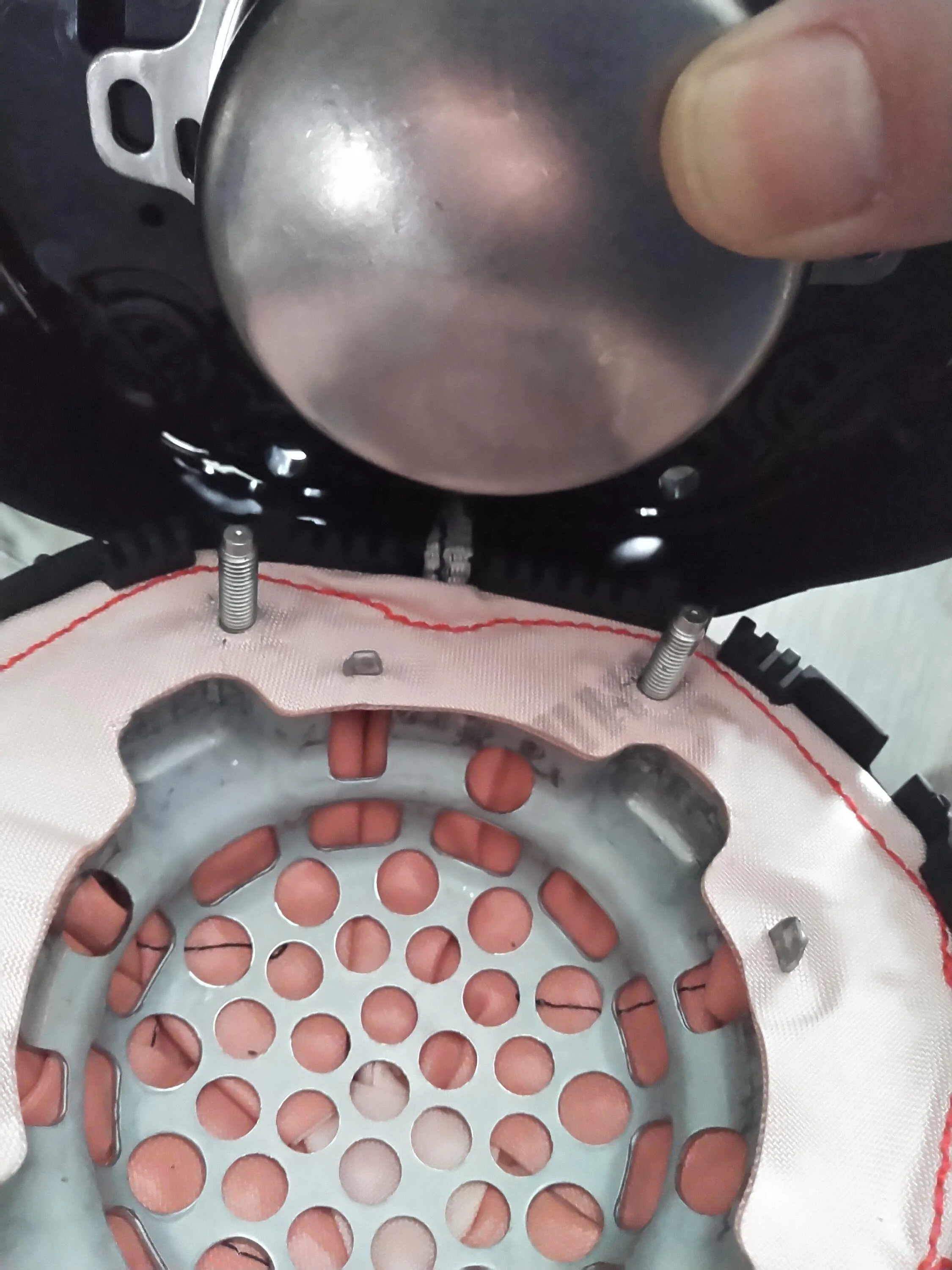

Do I just keep pulling this top away from the airbag, notice this rope looking like it's goes underneath the airbag
baagel
Oct 22, 2021
487
531
2021 Supra 3.0 Premium, 2023 Challenger Hellcat
If you're just trying to change your steering wheel there's absolutely zero reason to be fucking with the airbag that much
8,473
14,119
Yeah...... I'd never reinstall that airbag on to a street car. You've gone too far.

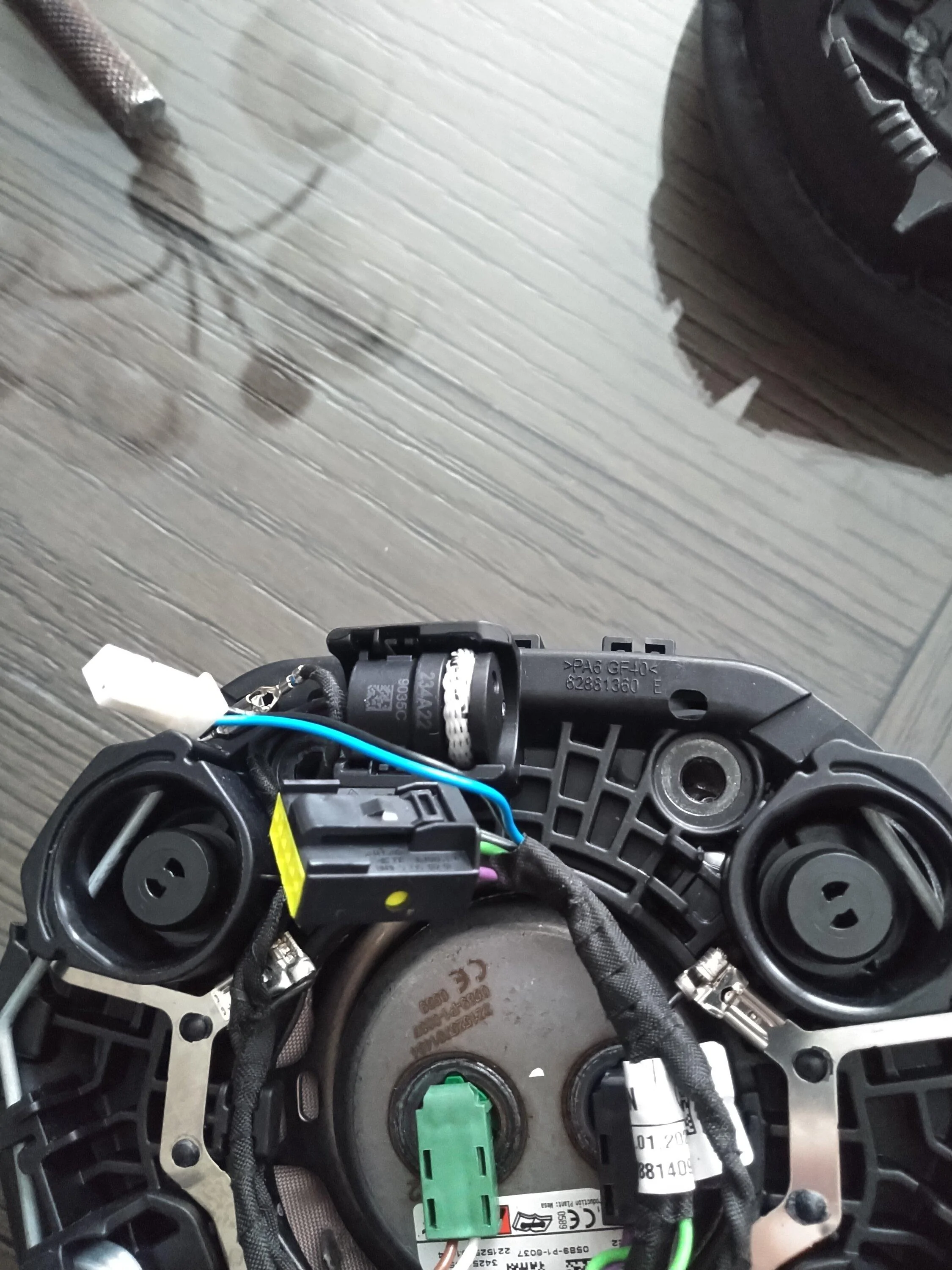

That's the process to install the custom airbag covers that NitroYellowMKV sells with his steering wheels. I figured it out though.
lucky phil
Phil
Jan 23, 2023
1,460
1,728
What was the solution? For those attempting to change the airbag cover?
