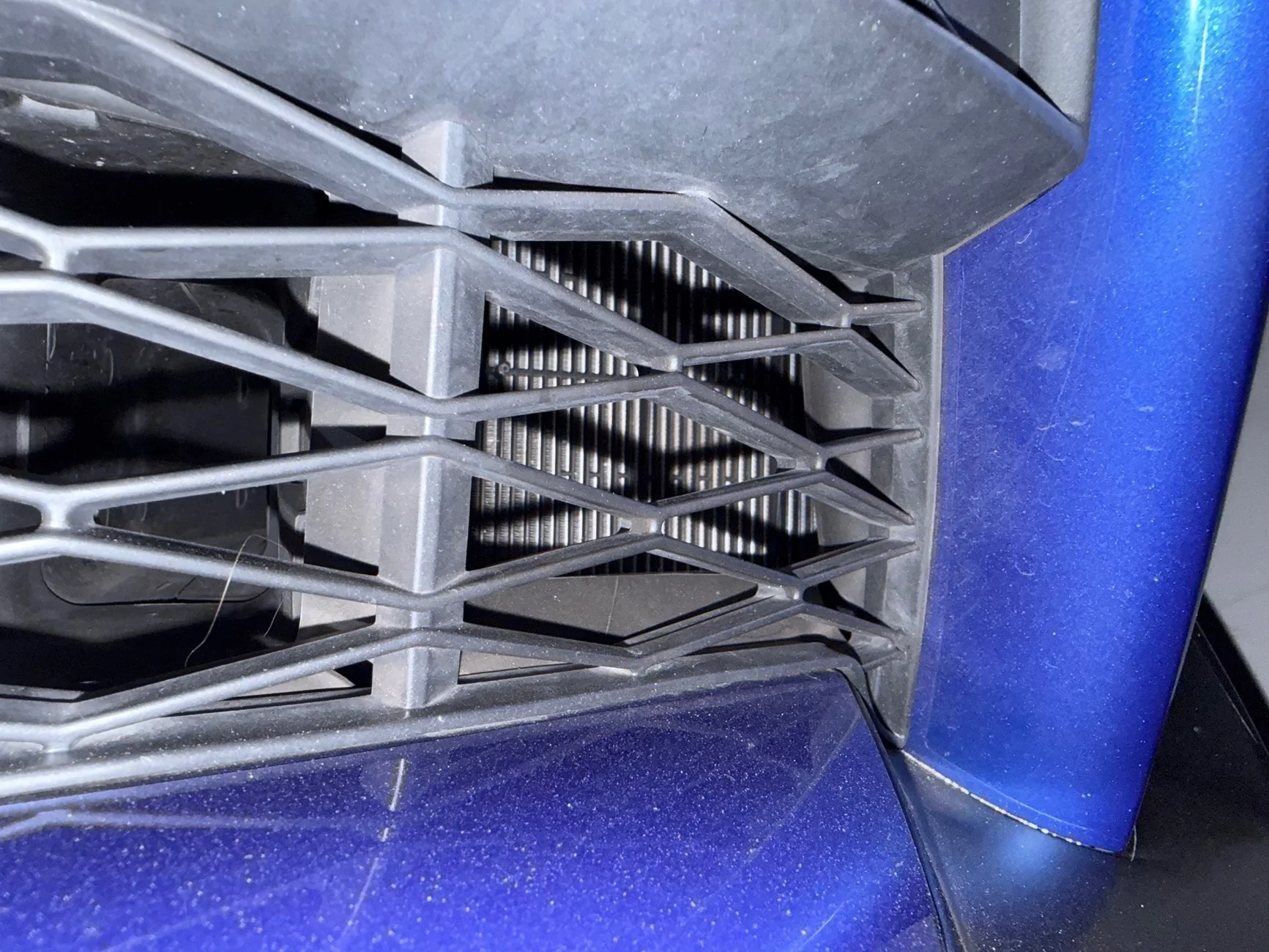

Why isn’t there a driver side radiator vent?

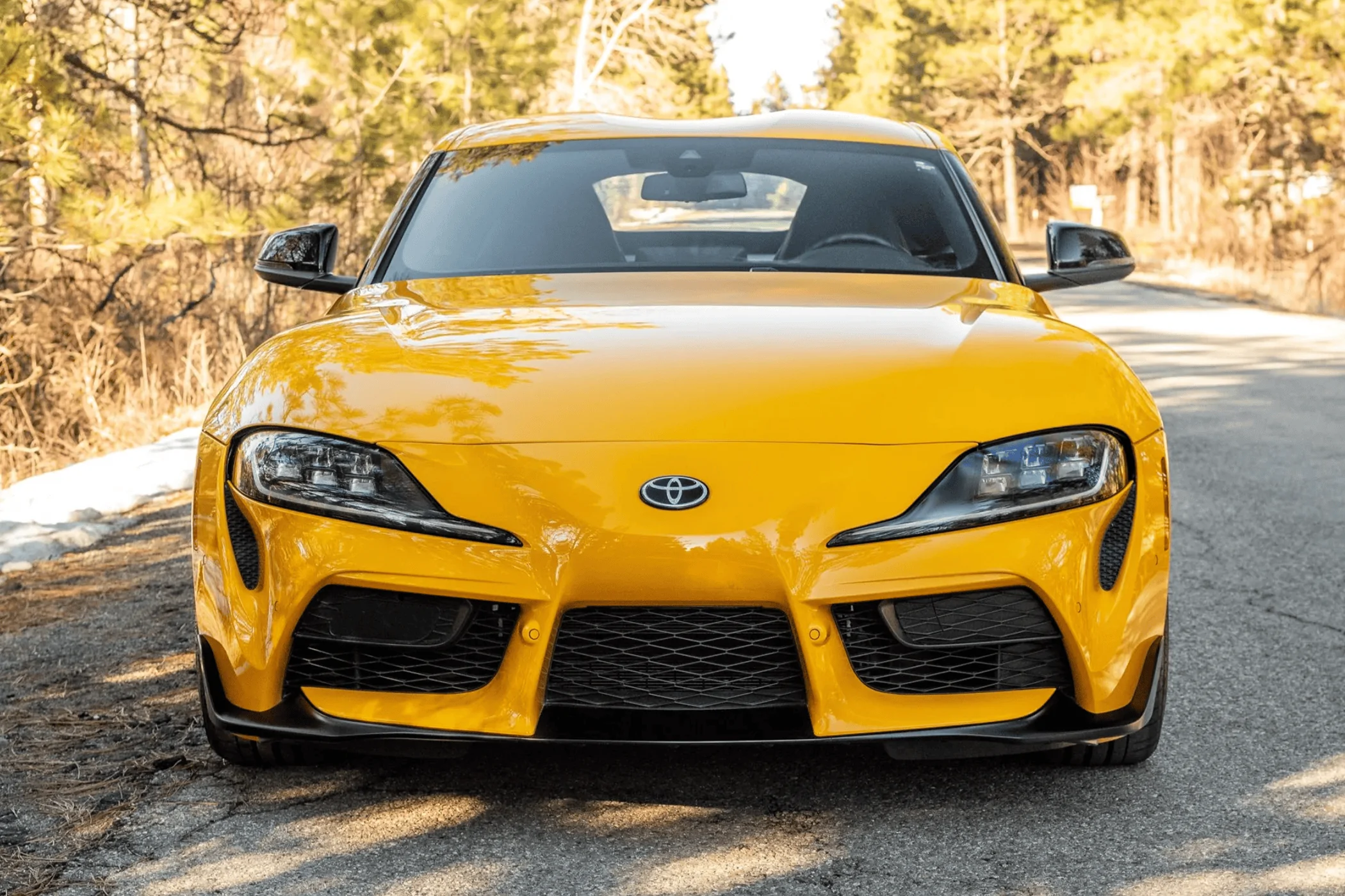

All 3.0L Autos have trans cooler in front and both Aux coolers on the sides. North American Manual Transmission 3.0L's also have both aux coolers. Not sure what other countries have.
No, the North American 3.0L B58 manuals have both aux coolers.

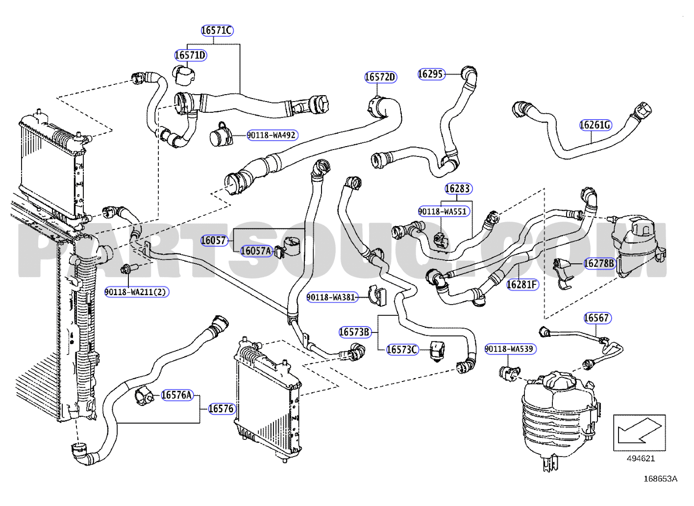

Must be an aussie thing because we have them on MT models here in North America:
MT parts diagram:
MT:
2.0:

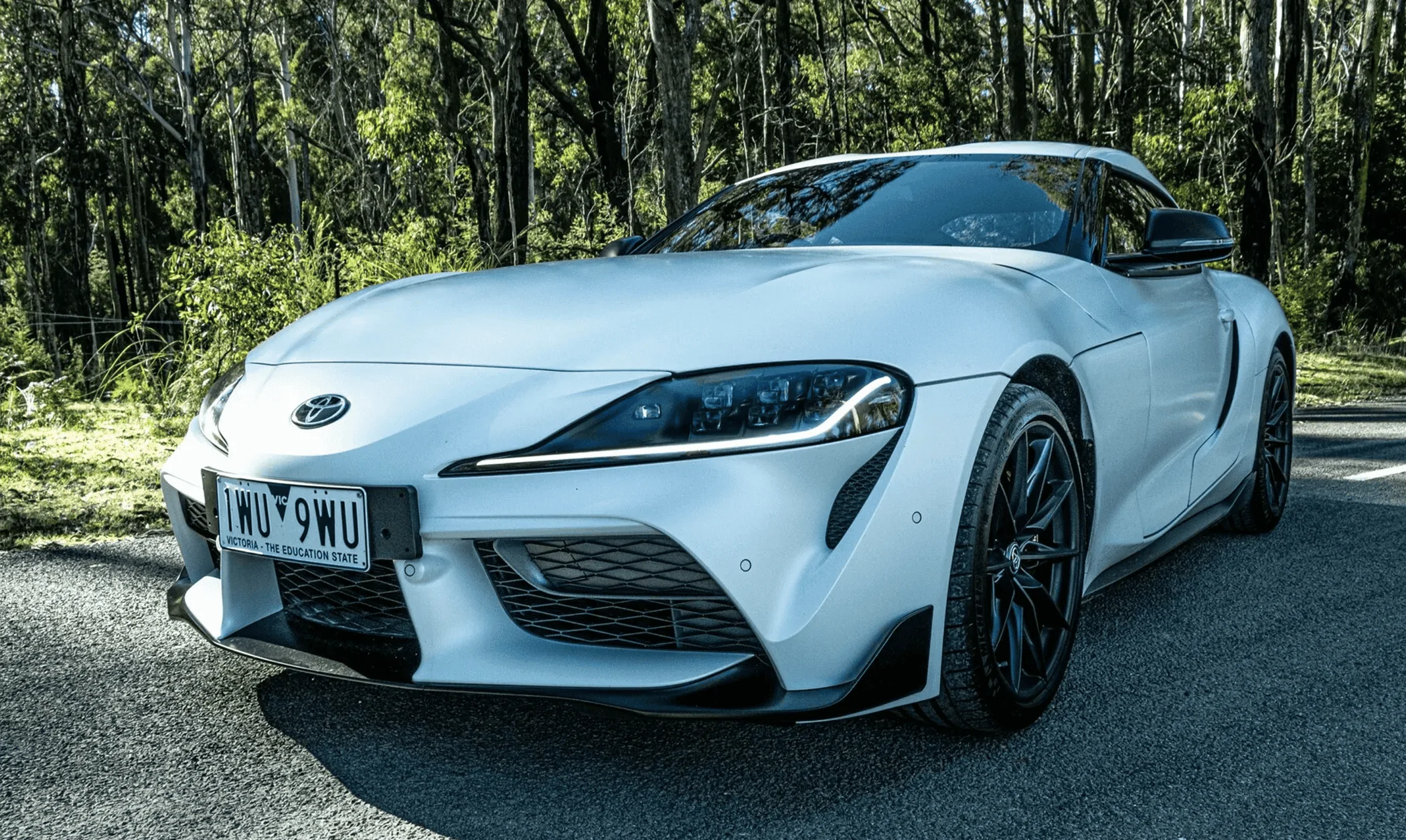

Just found some photos of the 3.0L Manual in Australia. It does indeed have it's left side blocked. Sucks for you guys!
I wonder if there's a differences in cooling between GT and GTS models, they seem to get the 285kw(382hp) motors like NA so it's pretty weird they don't have the aux rad considering how hot it can get there.

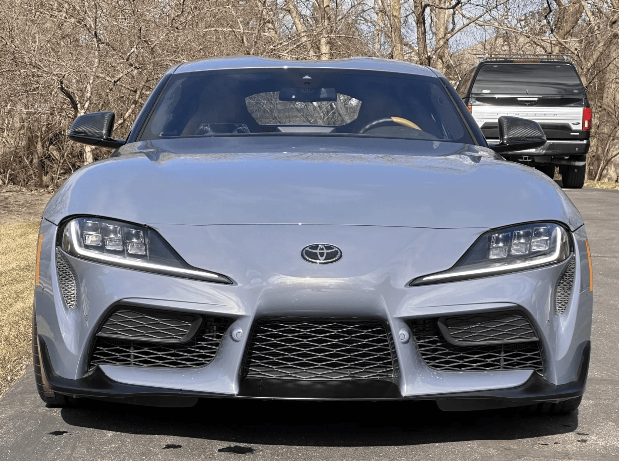

I have two aux coolers in my EU spec 2025 3.0MT (340ps).
It’s indeed strange the Australian spec don’t get it considering they have the 6 port 382hp version with the higher state of tune.

Have the 2026 Track Edition Manual (Australia) (known as Final Edition in USA).
No LHS Auxiliary Radiator fitted.
My primary purpose for this car is competitive track days.
While I avoid Summer track days it can still be quite hot in early Spring and Late Autumn.
Sounds like I am going to have heat soak issues considering this Aux Radiator is meant for the turbo side coolant circuit from my understanding.
Now the question.
Has anyone ever retro fitted all the parts to a Supra that does not have the LHS Aux Radiator?
The diagram already posted is a good start.
But I gather there is going to be gotchas as there are probably other parts differences in what is on my car that won't allow fitment of all the below.

I haven't done it but I costed it out a year or so ago and it's not that expensive to do. I think the parts came to 600USD or there abouts and it's in the main cooling system circuit. The only issue would be if the front support frame has the mounts fitted the rest looks easily doable.

Have you got the full list of parts?
Wouldn't mind having it.
I am actually heading out to One Raceway tomorrow for the cars 2nd track event.
It is only going to be a top of 23C so not exactly going to test any cooling out.
Main aim is to sort the handling for next year's NSW SuperSprint season. I

Both the left and right aux radiators are for the main engine coolant circuit from what I know.
it’s still a good thing to add if you’re gonna be pushing the car hard I reckon.

This might actually be a good opportunity to directly install the Verus oil cooler, which has a lot of data from the time attack community. The tricky part here is that you might be missing some bracket/duct hardware, however.

I agree. If the OP is gonna be doing more frequent track events, it would be a great opportunity to install the Verus oil cooler which is likely something that you would eventually need when you go into the warmer months.

Sorry no. I decided not to bother with it for my useage.

Well there was no cooling issues on the weekend with the single aux radiator.
I leave the dash in diagnostic mode looking at the oil and coolant temp and saw nothing silly at all.
120C on oil and 105c on coolant after 11 laps is pretty darn good for a stock car out of the box, although it did only reach 24C during the day. And a cool down lap or two results in oil dropping rapidly back down towards 100C.
Have a December track day down at Phillip Island. I doubt cooling will be an issue there as it is such a high-speed circuit. And being out on the ocean I'm sure there will be 4 seasons in the one day.
But yes I agree. It may be a better opportunity to look at oil cooling rather than the 2nd sub radiator. Have always found in other previous cars that an oil cooler is always more effective than any radiator upgrades.

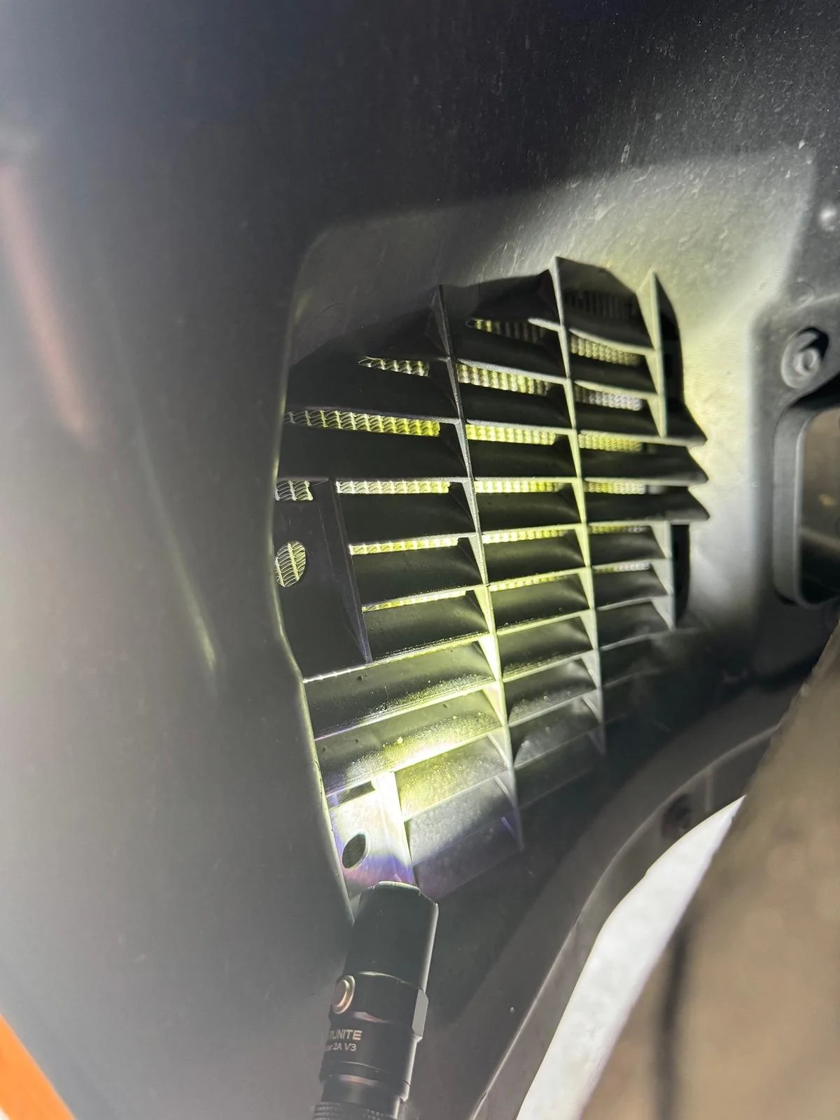

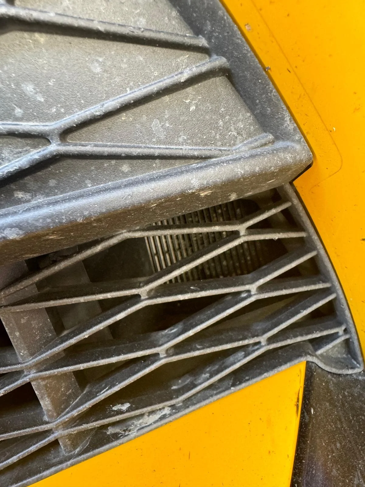

Definitely do not have the air duct in that side of the bumper. It is fully blocked off on the front side and the guard liner is not perforated.
So essentially would be up for the LHS lower grill and guard liner to make anything work.

It can get pretty hot here in December. Last year we had a 45 degree day (That's 113 in wierdo US units) that literally melted my Type R's shift lever cables. 😓

Nice result Luke, 120 on oil and 105 on coolant after 11 laps on a stock car with just the single aux radiator is better than I expected. Would be really interesting to see the same numbers from the December day if it ends up being a hot one. Keep us posted.

So essentially would be up for the RHS lower grill and guard liner to make anything work.
Don't you mean left hand side?
8,831
17,323
The GT4 Supra race car deletes the second aux cooler for something else. I think you guys will be okay.
